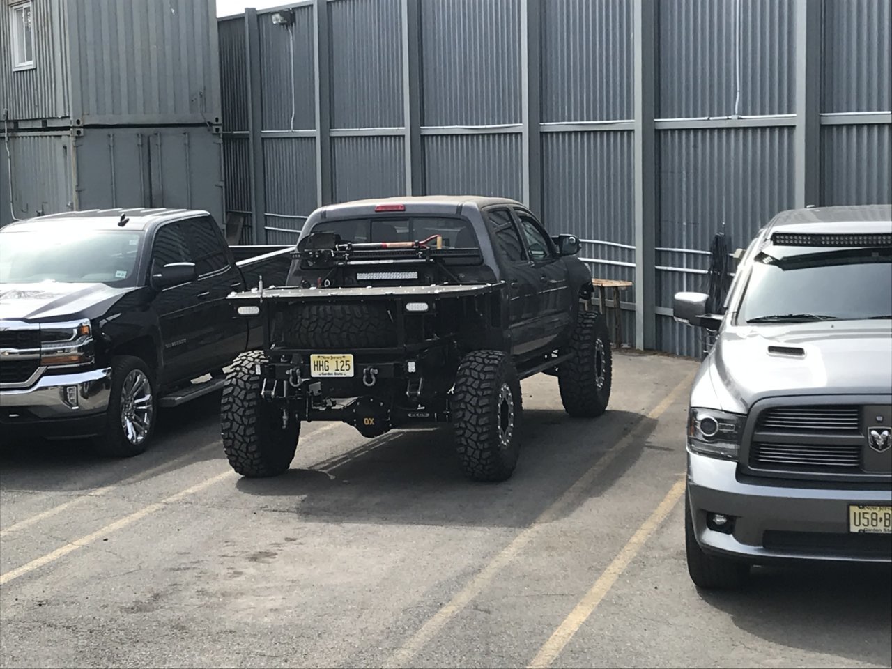

    Full size trucks? PFFFT
    Nimble9, 13txtaco, Cooktop86 and 13 others like this.

    Looks great, how did the drive feel with the newer heavy shoes on?
  15. Apr 12, 2019 at 8:04 AM

    Felt great power wise.
    I’m getting a pretty decent wobble from the wheels I think. Looks like I’ll have to put the Beadlocks away until the day comes when it’s solely a trail rig.
    I’m going to throw my spare OEM tires and wheels on to be sure. But, that most likely what it is.

    The elusive double cab flat bed model, only available for a select number of months. Me gusta
    Nimble9, Bastek, MY50cal and 2 others like this.

    I am getting to undergo some serious cutting/tubbing and appreciate your help. Of note, I tried using dynabeads for the first time in lieu of weights. The good - they actually balance out the wheel quite well and you just need to apply the proper amount according the size tire. This may be offset by the welded rim and have no affect, but it does work well on the tires. The bad - they take a decent amount of centripetal force to get where they need to go. So DD or around town it is fairly awkward and wonky. The highway balances them out well and rides quite smooth. 0-30 (unnoticeable), 30-55 (awkward and wobbly), 55-80 (very smooth, which explains why truckers have such success using them)

    I’ll post some pics later of the tubbing process.
    TBH, I got in over my head. Jo n graciously came up and pulled my ass out of the fire, making and fitting the panels.
    I was overthinking it. Couple that with my lack of patience...
    I’d like to believe, that now that I’ve seen the process, I could do it myself next time.
    I can weld the sheet metal fine. Getting those damned panels to fit? That’s a whole different thing.
