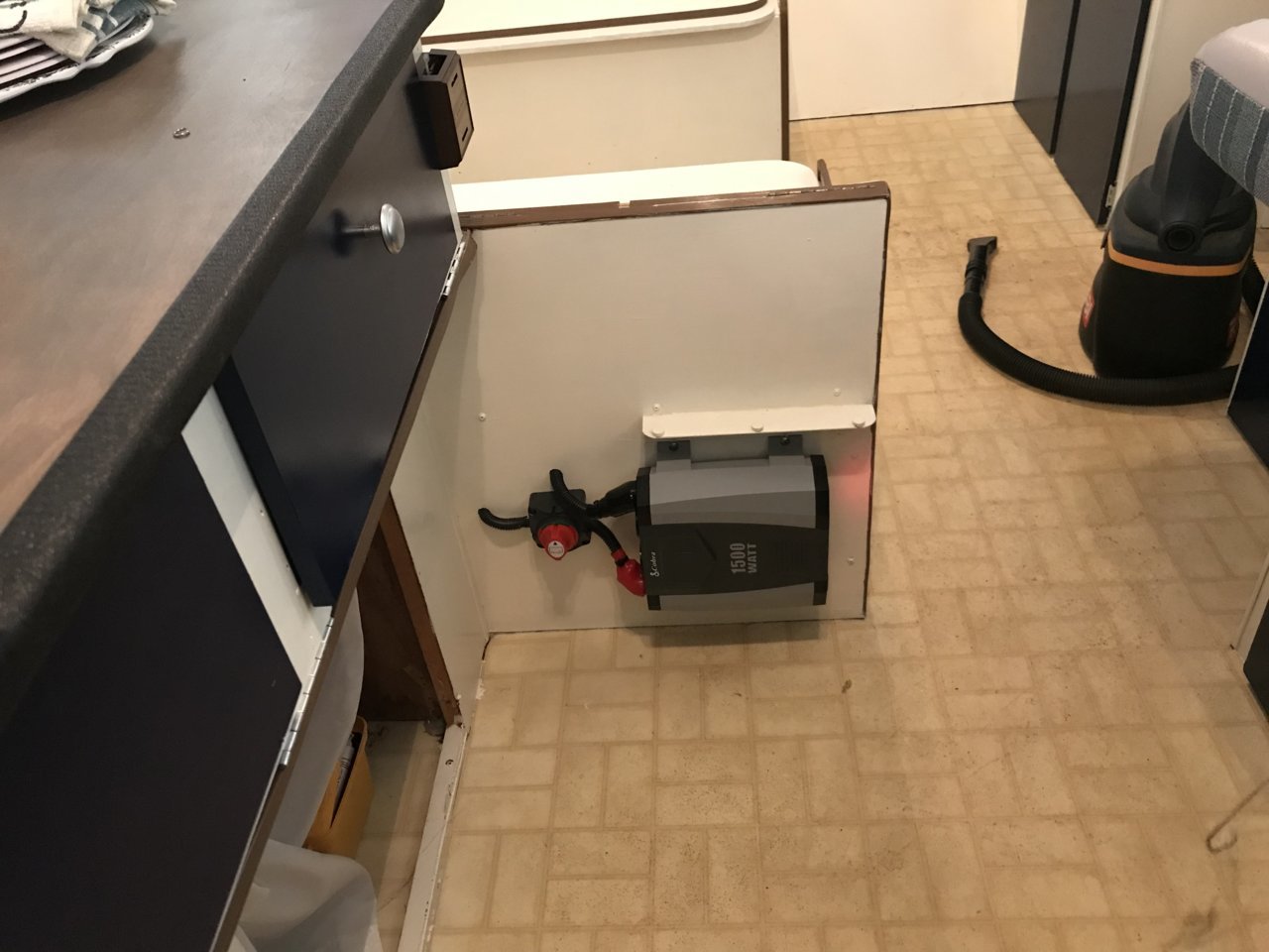

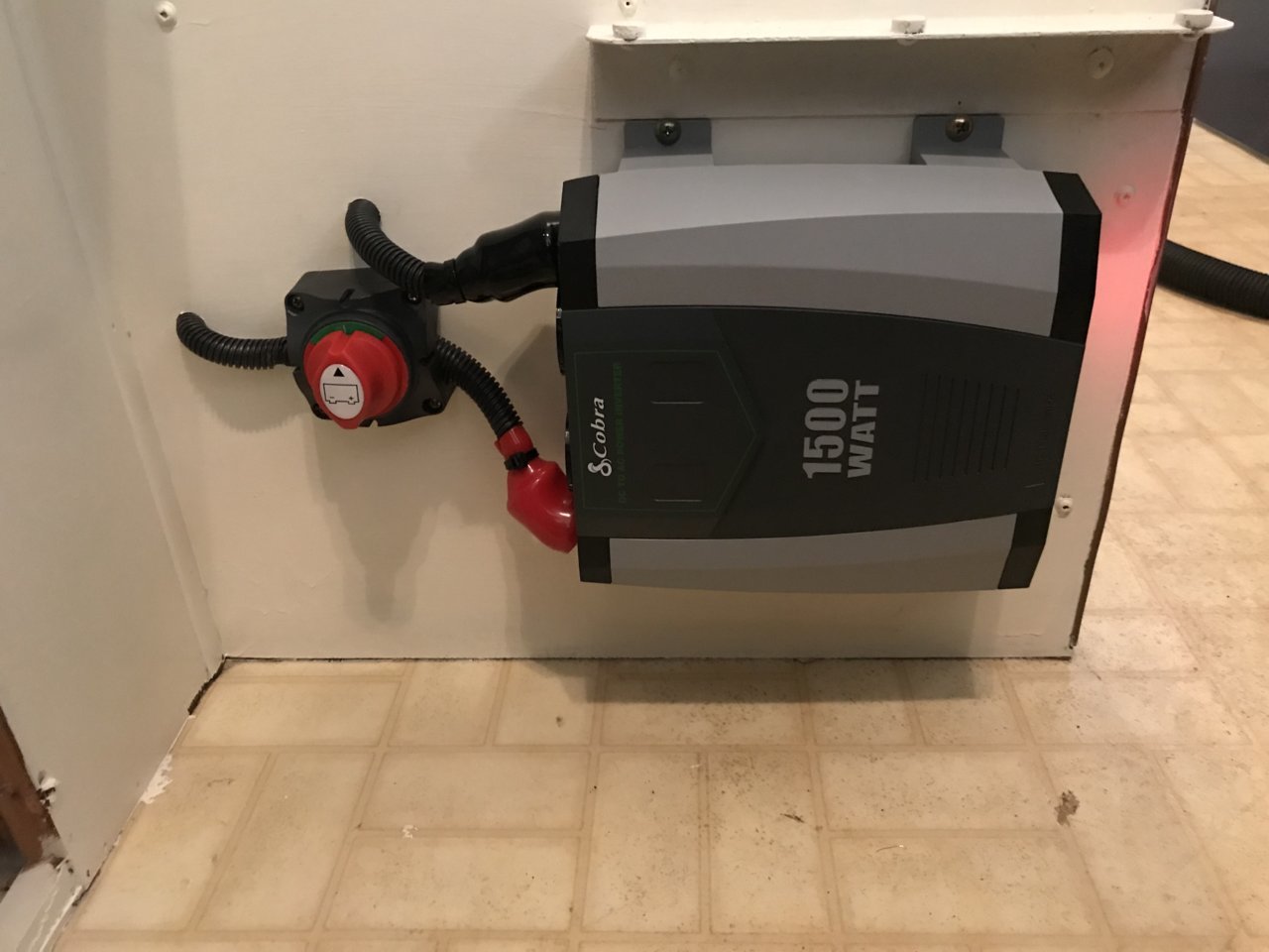

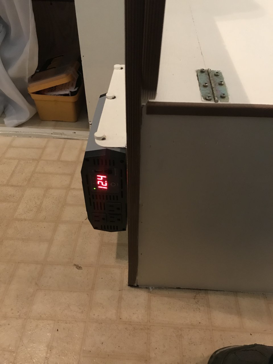

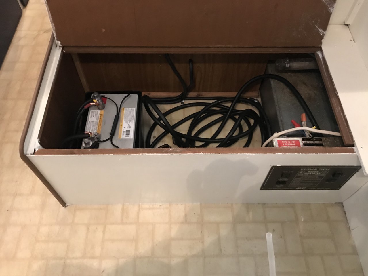

    The camper has power. The factory inverter runs the furnace and lights. The new inverter gives us some outlets.
    The camper has its own outlets, but they only work on shore power.
    The long coiled wire is the shore power plug.

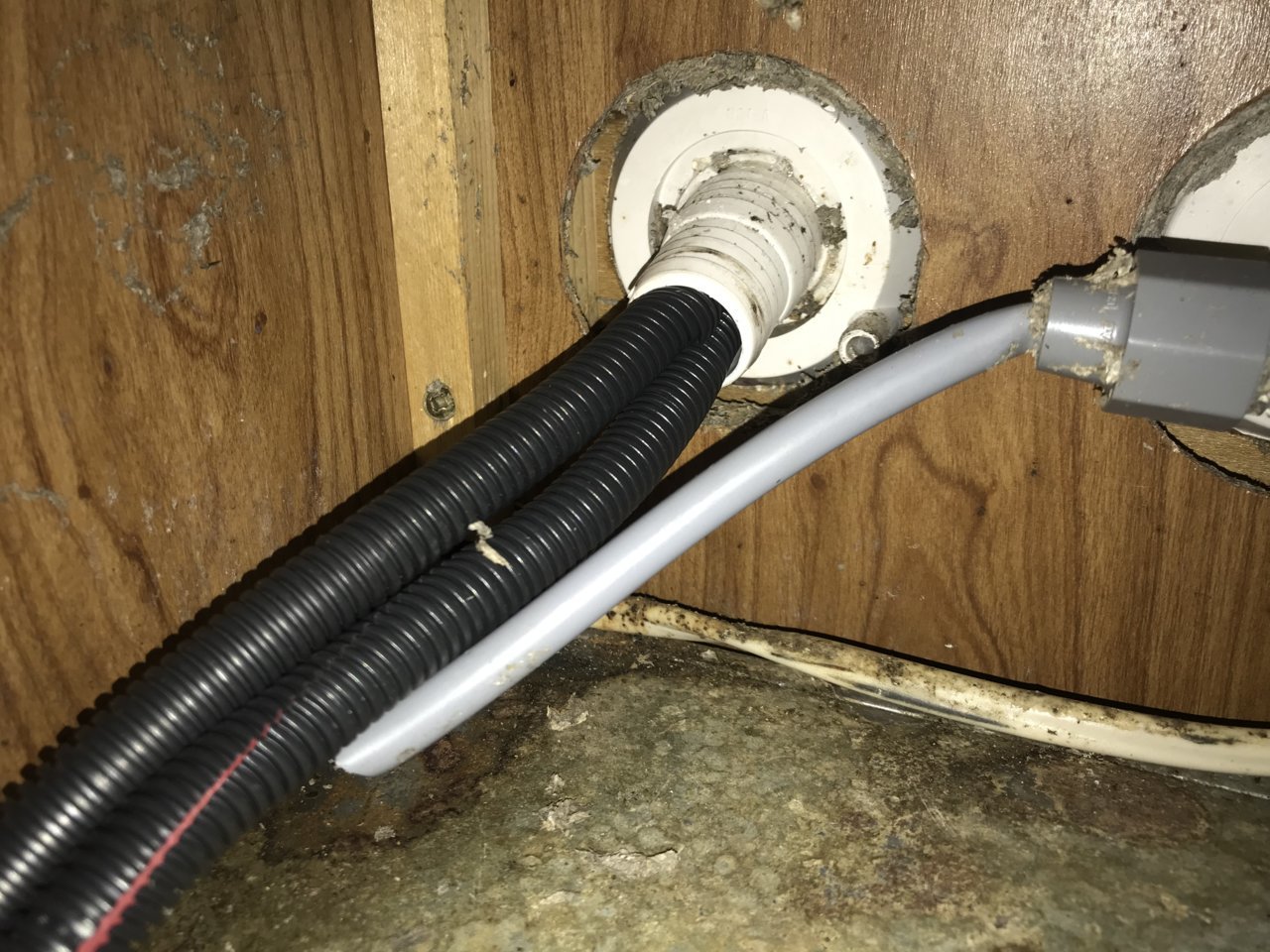

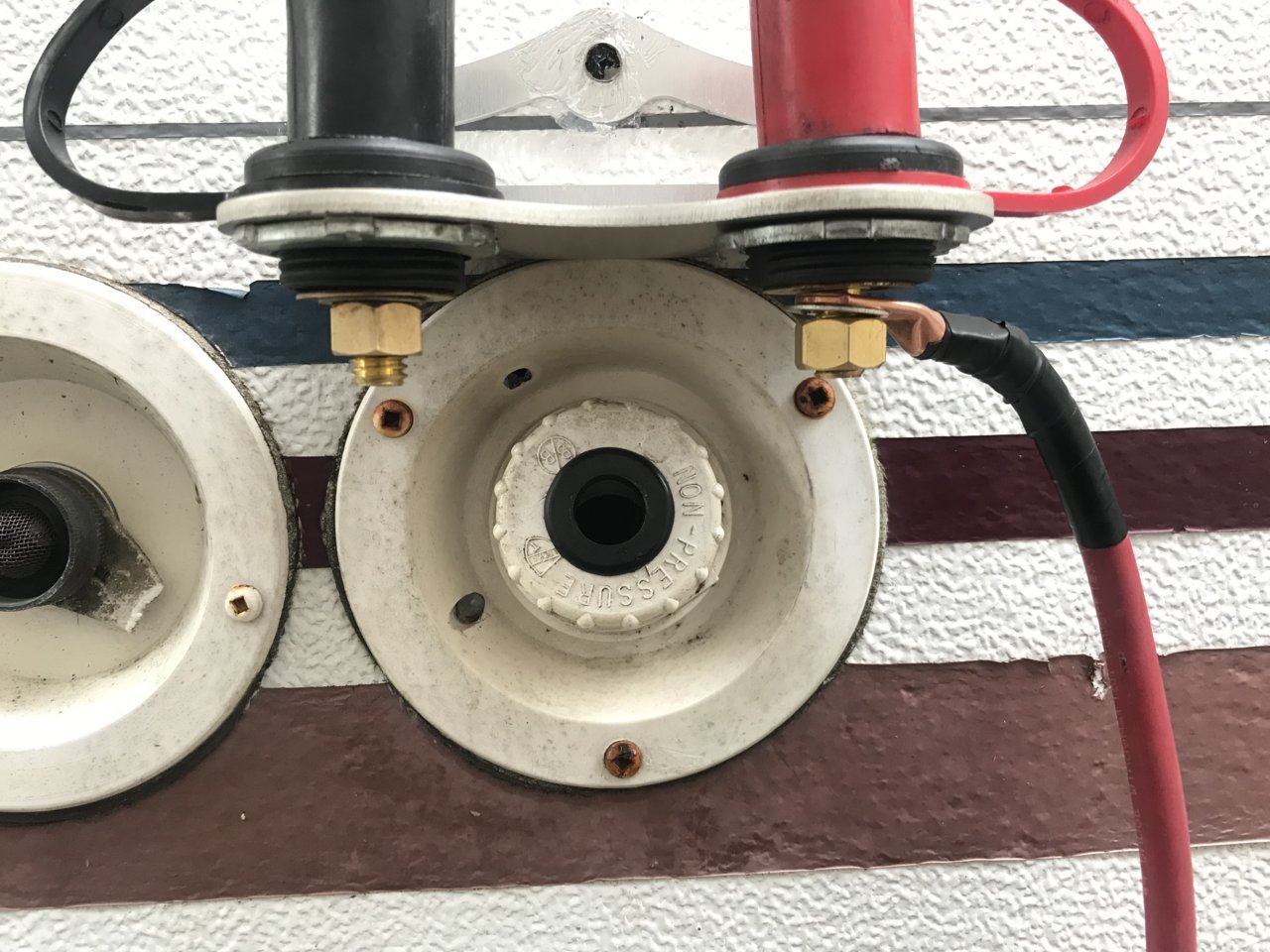

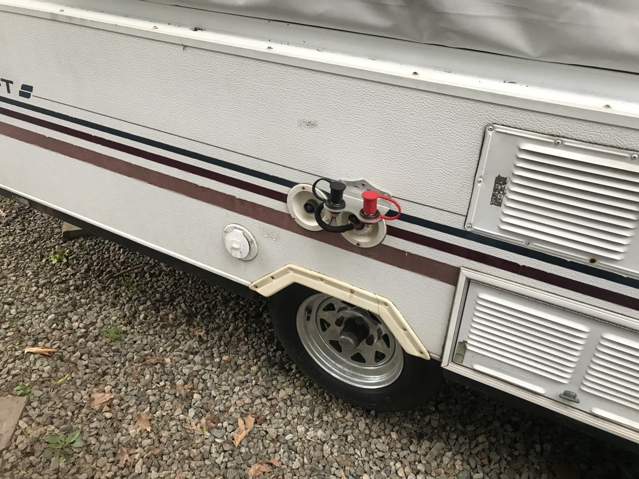

    I remembered that I had an unused remote battery post set just laying around. So, I figured I might as well use it.
    This will let me use my battery tender or charger without taking the battery out. It’ll also allow me to charge the battery with jumper cables in a pinch.
    The old fill connection for the water tank that I removed ran right into the compartment that I put the battery in. I figured it would be pretty dumb to drill a new hole. I just took a hole saw to the cap and put a grommet in it.

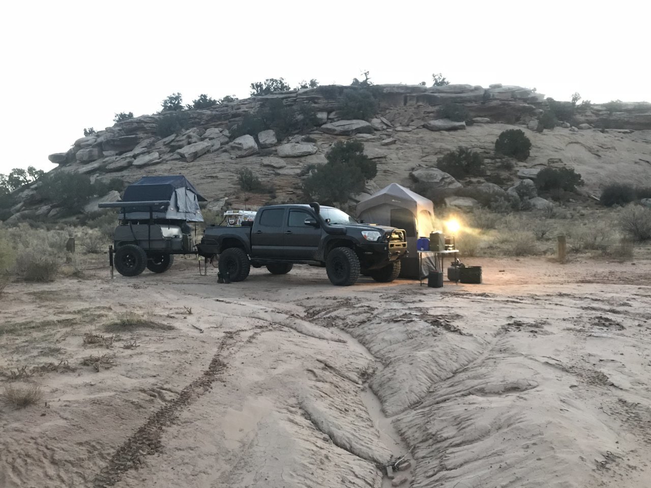

    Onion Creek was suggested to me by @Wheelspinner . That’s worth a look. It’s not technical at all, but the scenery is amazing. It actually changes like four times.
    I had to stop and get a pic here.

    It goes from that, to oddly formed grassy areas, to crisscrossing the creek, to flat sandy areas. The colors of the rocks change drastically.
    I can’t do it Justice with a description. You just have to see it. It’s awesome.
