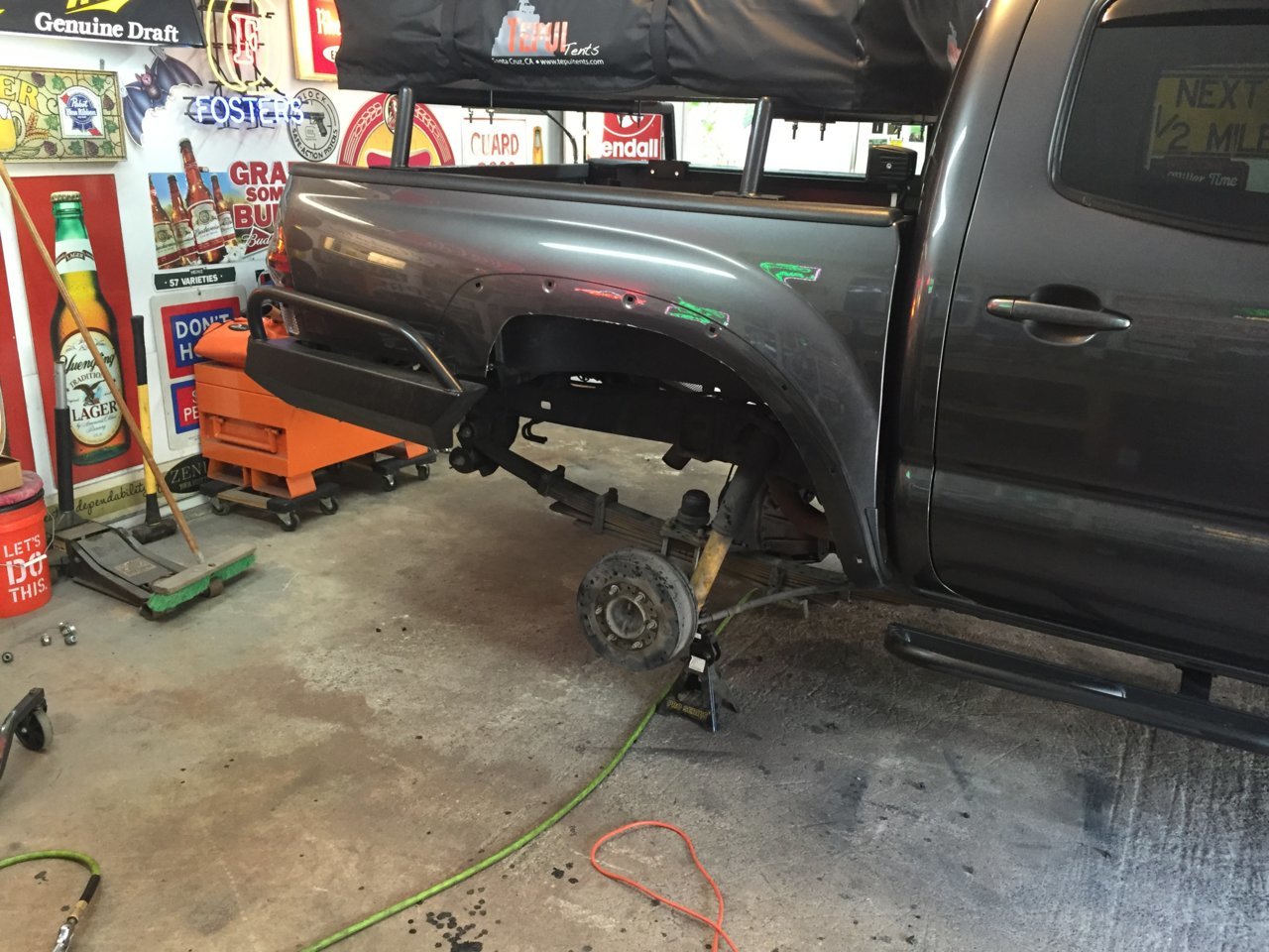

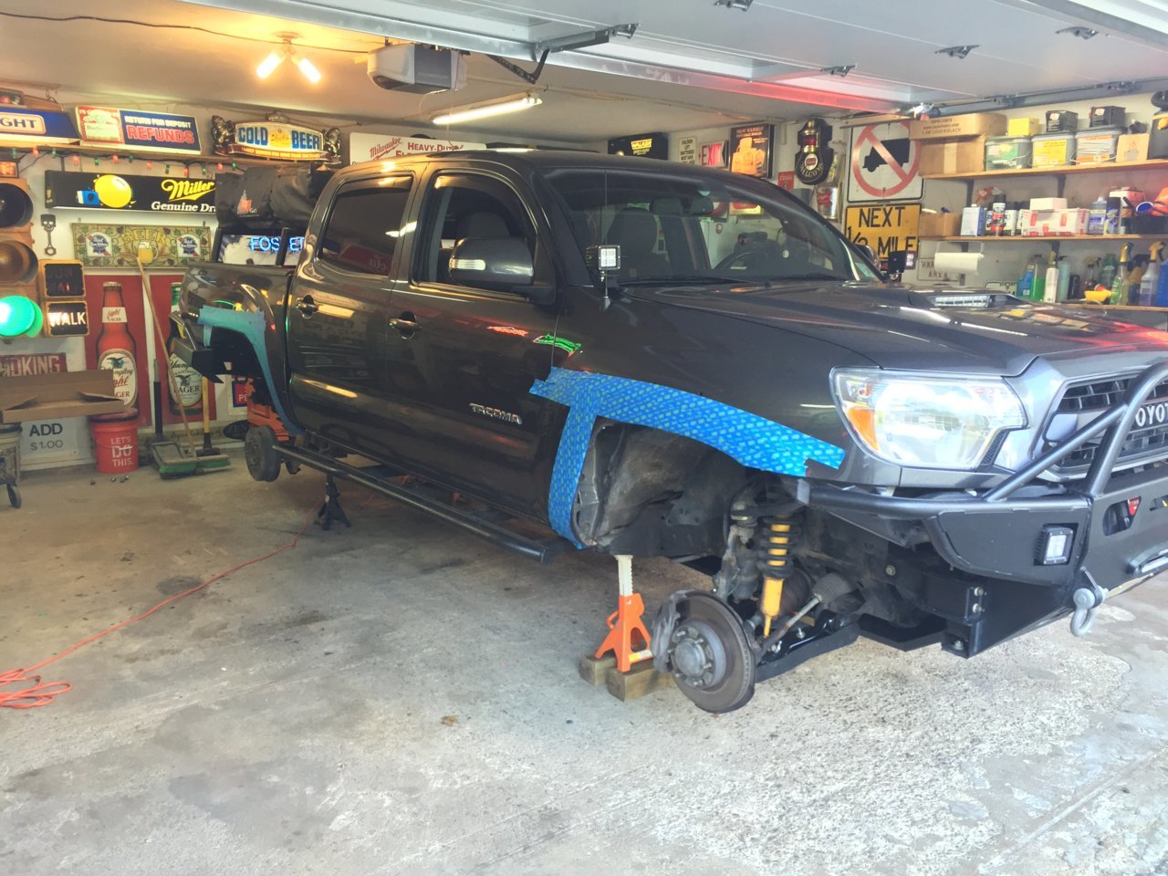

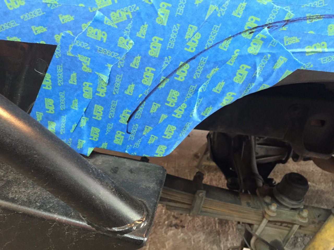

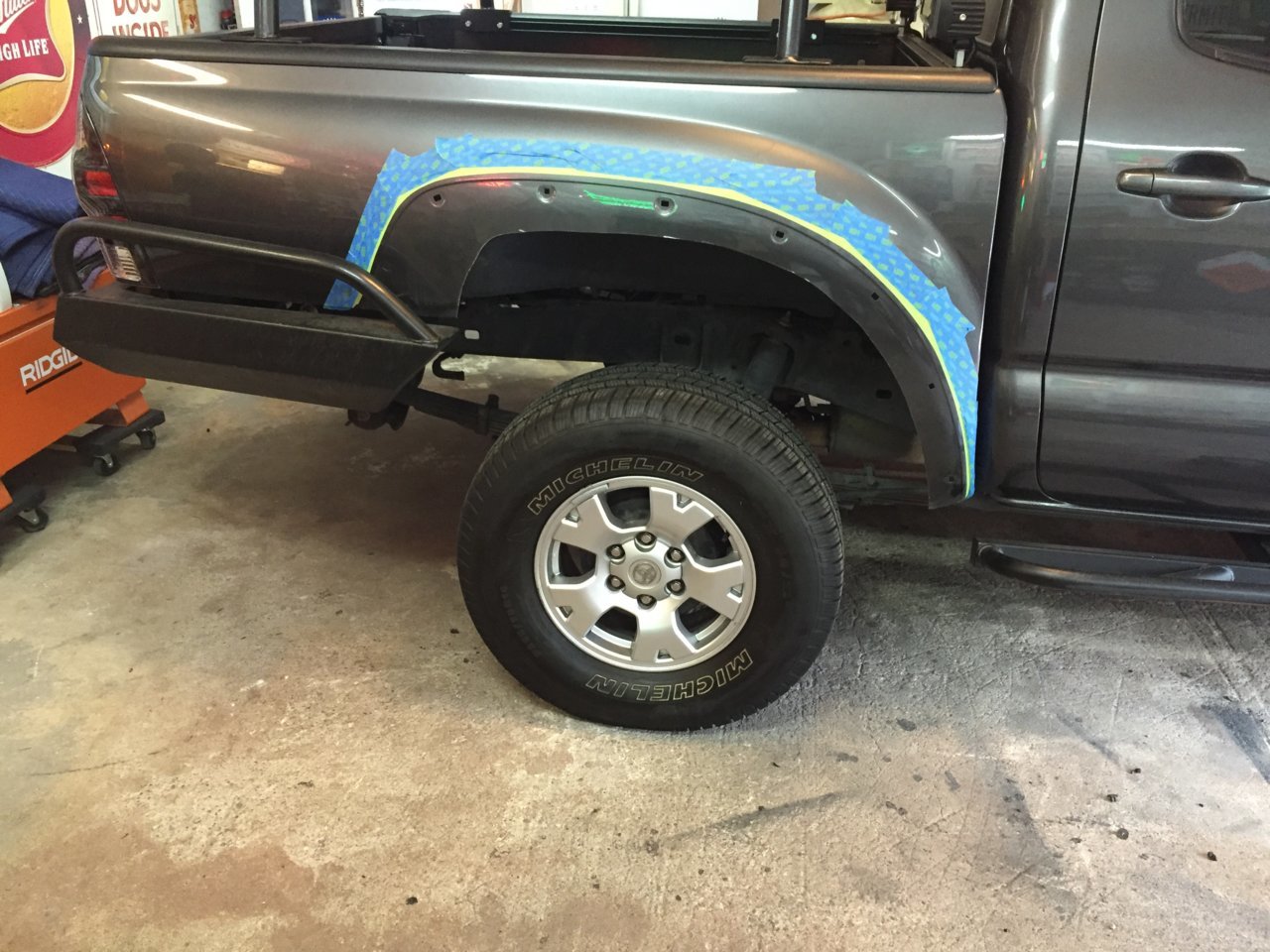

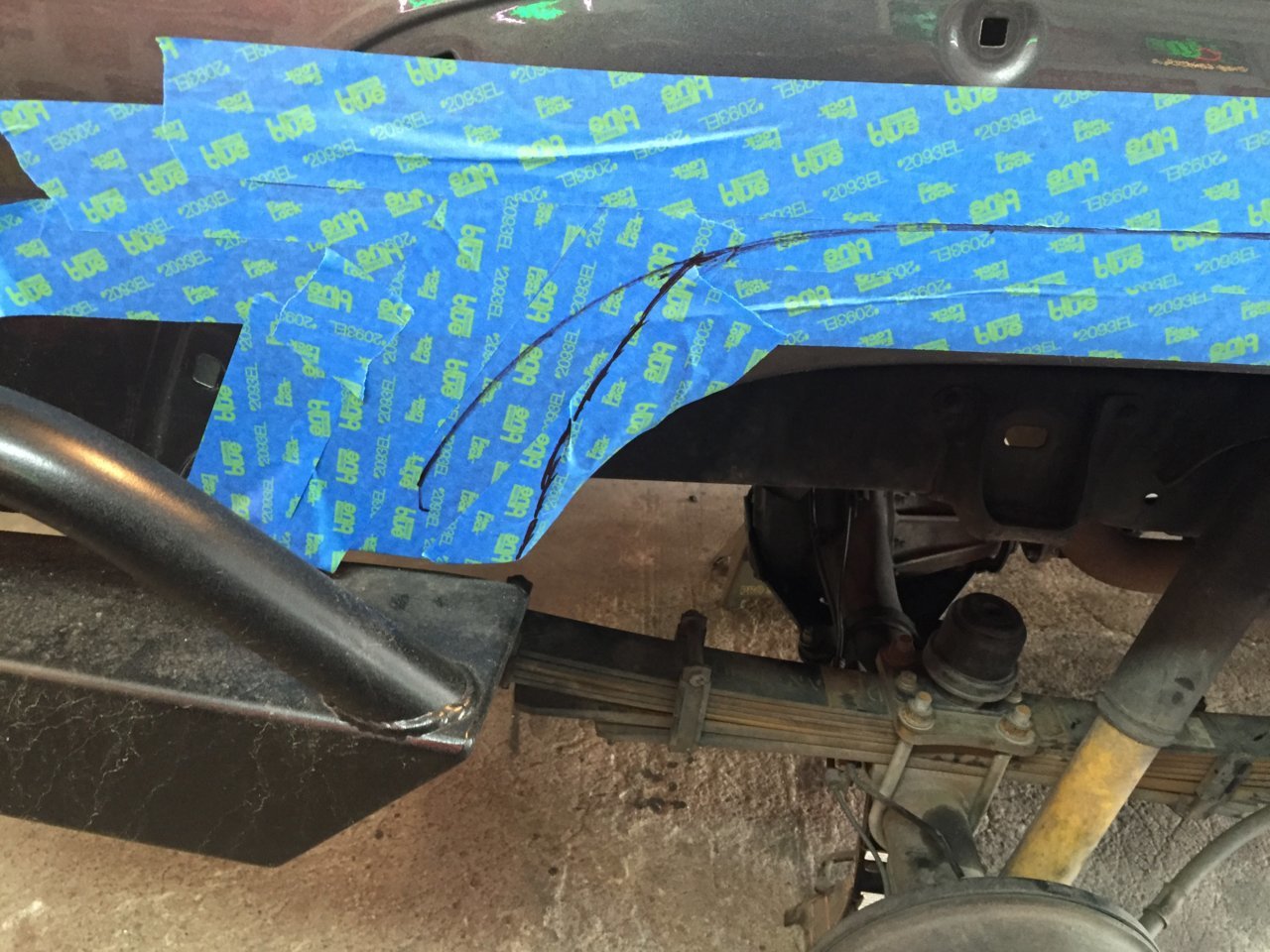

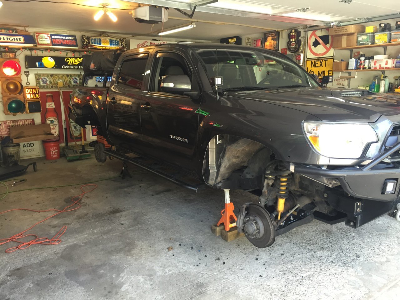

    This is all that I have from doing 35s.
    The cab mount is now relocated to clear the 37s, but for 35s I actually ended up grinding it back more up top than in the picture below.
    To draw the cut line, get a stick of wood. Drill two holes in it big enough to stick a sharpie in each hole as far apart as you want your cut to be. Run one sharpie along the bottom edge of the wheel opening while letting the second sharpie draw the line. I believe @cynicalrider has a picture of this. I stole the idea from him.
