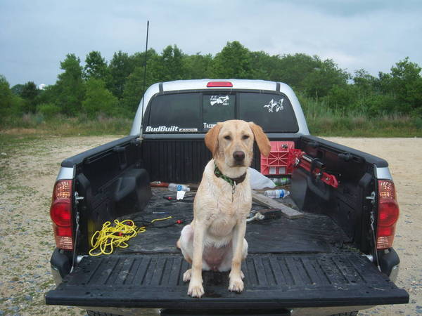

    A 5/8 bolt will fit inside the rails on the bed. you just need to remove the mounting bolts to get the head to slide down the track. Then use a flat washer and a nut to secure the bolt to the rail. Then you will have to use a 5/8 drill bit to make the hole in the high lift round instead of oval, use another flat washer and nut and you have a hi lift mount for about $4.00. I did it on my truck for my huge hi lift and it worked fine.

    This is the best pic i have right now.... You can see where it was mounted.
