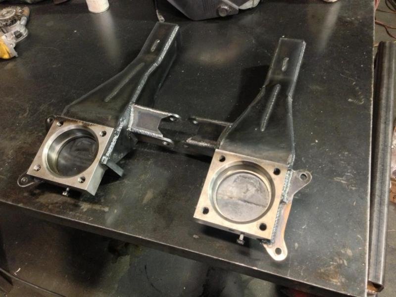

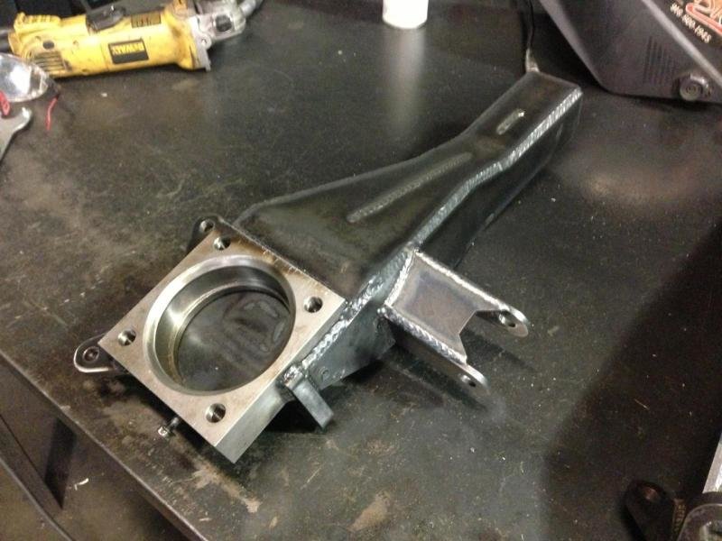

    Heres some pictures of the spindles LSK built. I will say, if I planned on getting spindles, I prolly would have done the kit with a vertical uniball but I may do that in the future. Anyways, here are the spindles. They will work on a stock application. There will be two types. The first will be like mine with double sheared hiemed steering upgrade for stock length steering and long travel steering. The second kind will use the stock ball joints. They are made out of thicker stonger steel than camburgs but only give 3" of lift. They will work with the stock ABS sensors. Call LSK for pricing if interested.

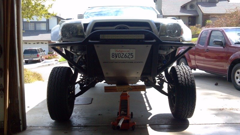

    pics of ride height pleaseee

    Ill take some tomorrow. When I got the truck back, it didn't settle so I have to take new ones. :)
