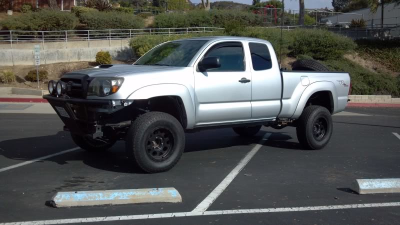

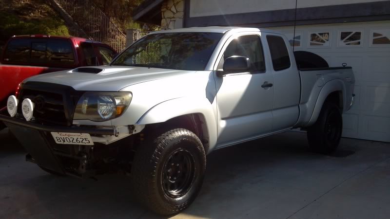

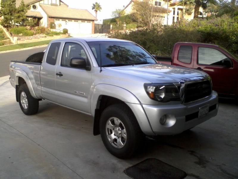

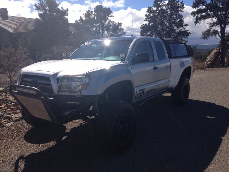

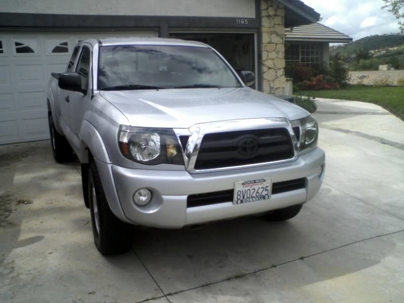

    Hey guys. I thought since Ive gotten a few things done to my truck I should show it off. Its not much compared to some other guys on here but it is still a work in progress. Let me know what you guys think!:D
    Got her used in Costa Mesa from a AutoTrader add. Came with 75k miles and a 13,500 price tag. It is a 2005 Tacoma TRD Offroad.
    What she looks like as of NOW!

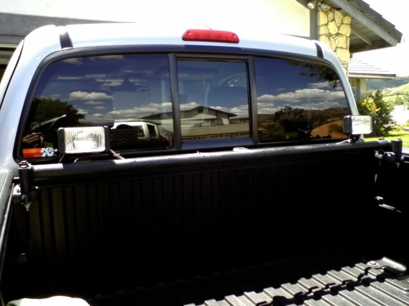

    -Demello Offroad Bed Bar

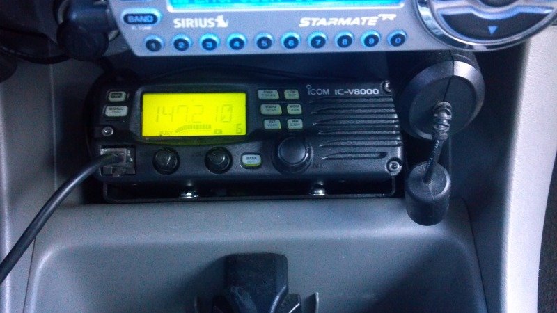

    -Icom IC-V8000 dual band ham radio

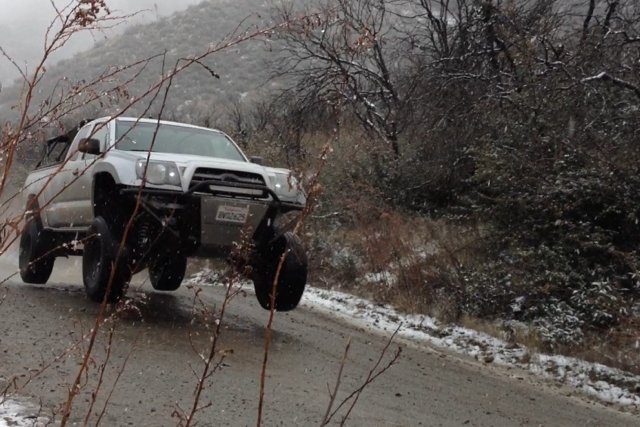

    First day drove it to school!

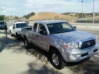

    First, I wanted to see what she could do stock so I took her on a trail run at Cleghorn with some buddies.

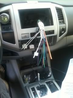

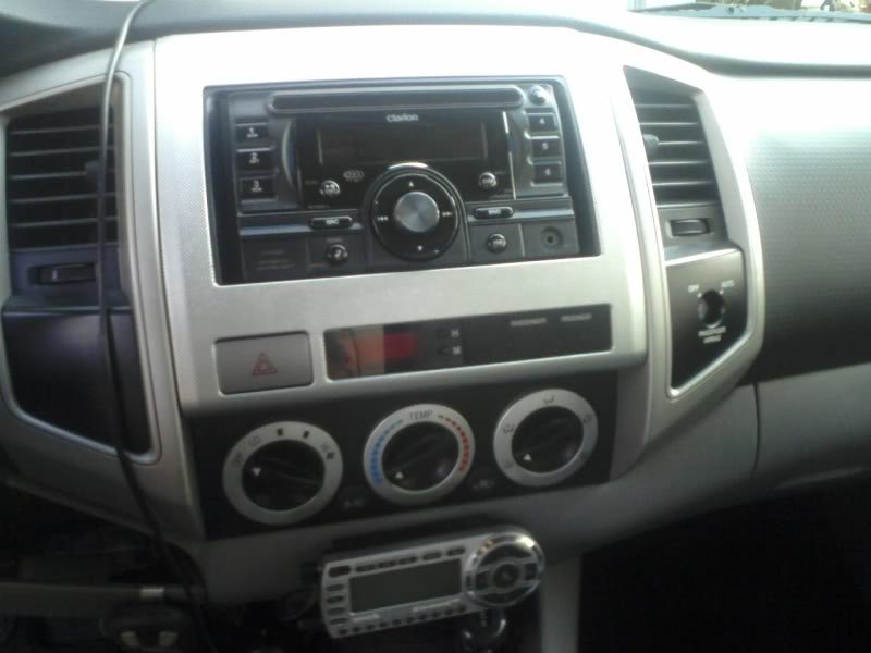

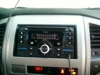

    Then, my cd player kept spitting out cds so I figures, why not get a nice one that nobody would want to steal. Its a Clarion unit.

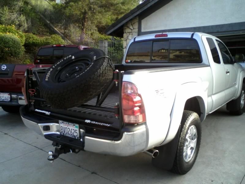

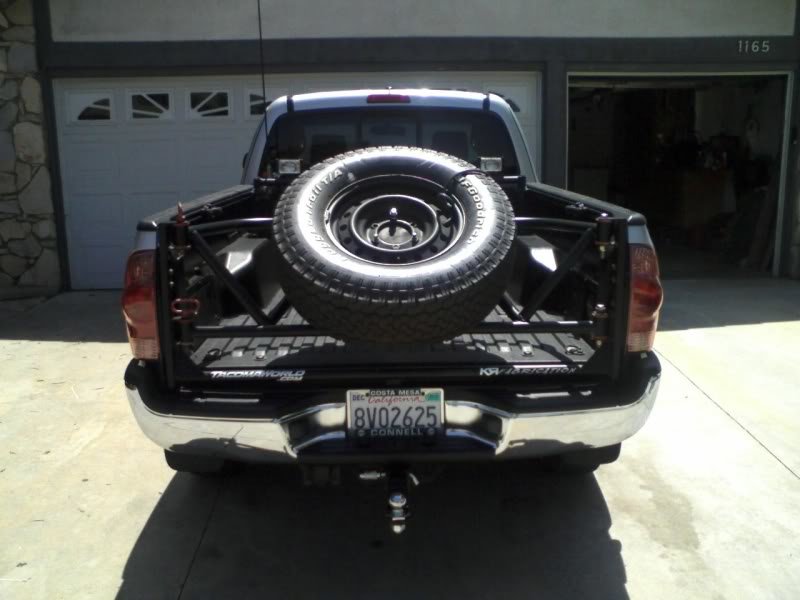

    Then came the KRFAB tire gate. I got this from RCFreak because I plan on upgrading rim and tire size. Plus it looks awesome!

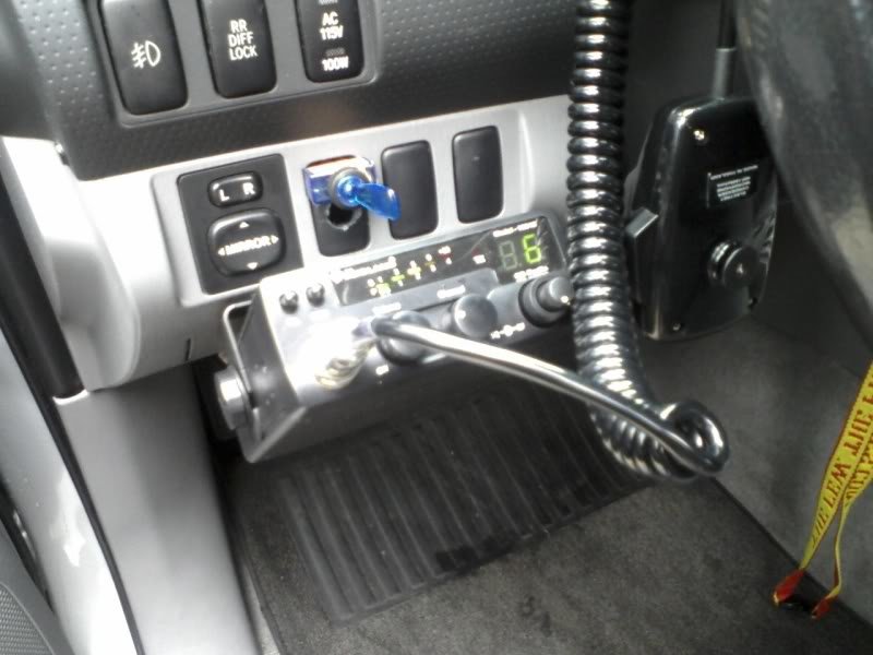

    then I bought his cb set up. Nothing super special. Just a normal 40 channel cb.
    then I replaced the ugly job I did on the switch with a new carling switch. I just filed out the hole a bit and it fits perfect! Thanks 4wheelparts Azusa!

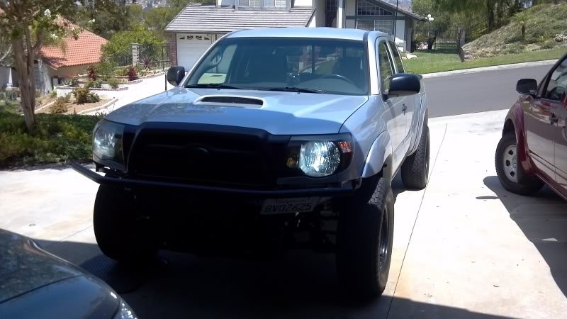

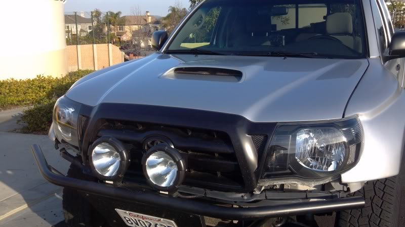

    Then came a new BLACK grill. Thanks Shiftin2Sixth

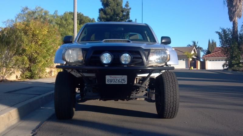

    Picture of the rear how it sits now since I got a couple of q's on it.

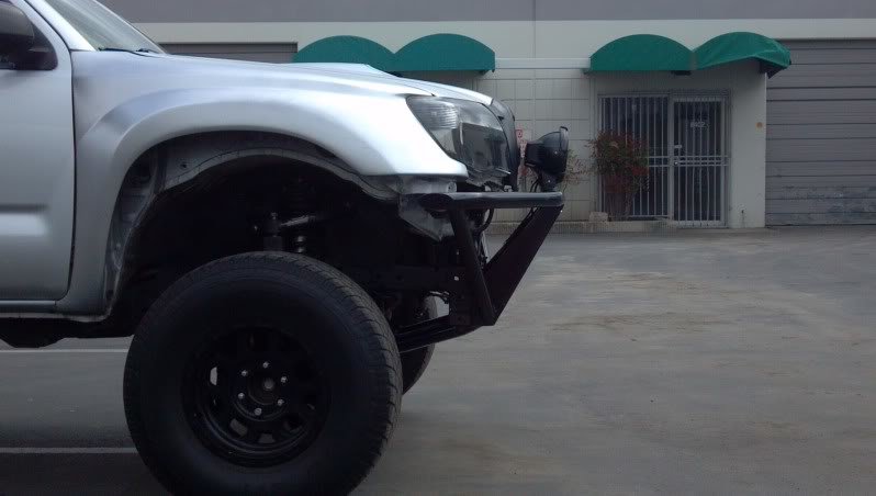

    Old bumper from Engage Offroad. Thanks Vitang!

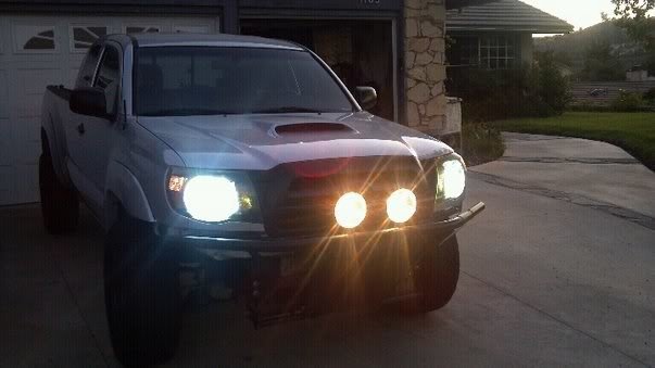

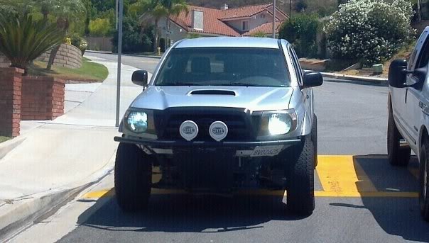

    HIDs - 5000k All mounted up!

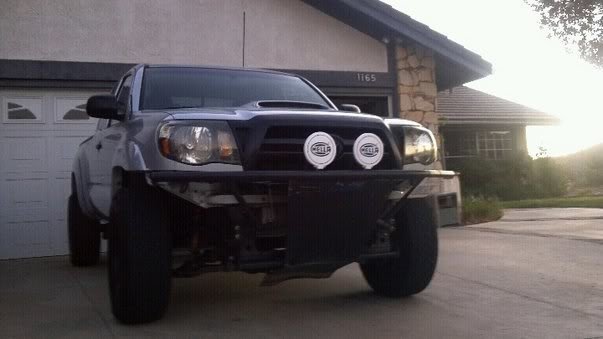

    Got new Hella 500s and installed them to my stock foglight switch!

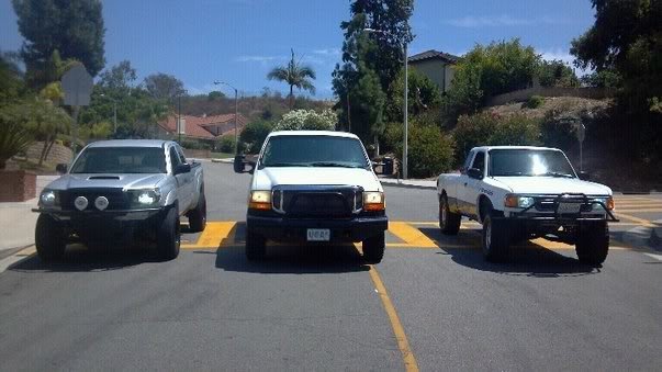

    Foundoffroaddead and I bored and decided to take up a street and take some pics

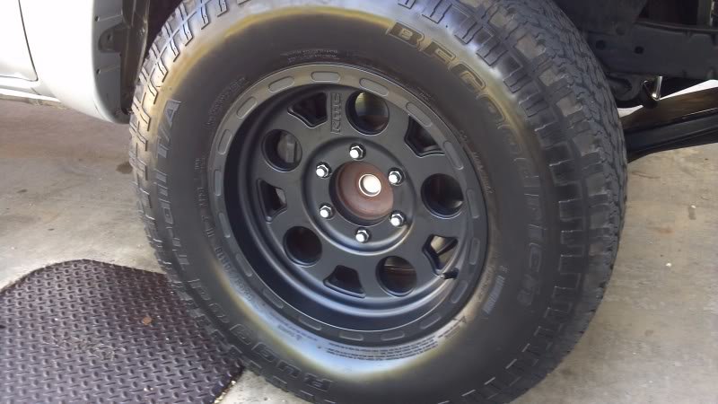

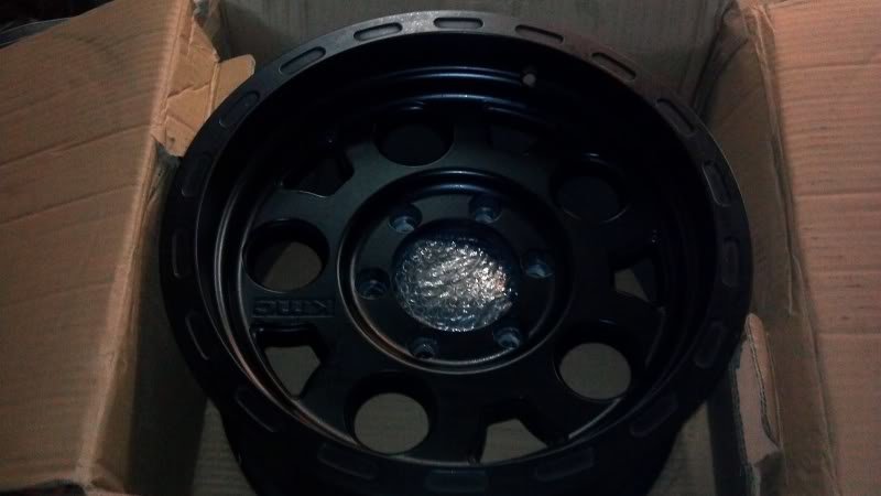

    Better Rims - KMC Enduros
    Mounted

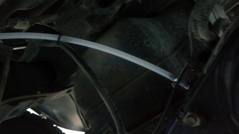

    Diff Breather Mod
    The electrical tape was used to cover up the silver hose clamp and is merely to blacken the color of it. Does not hold on the breather!!!

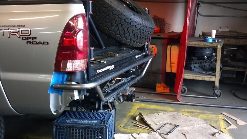

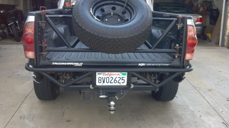

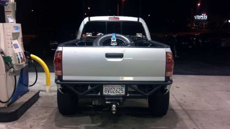

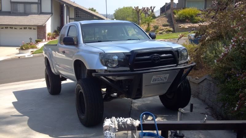

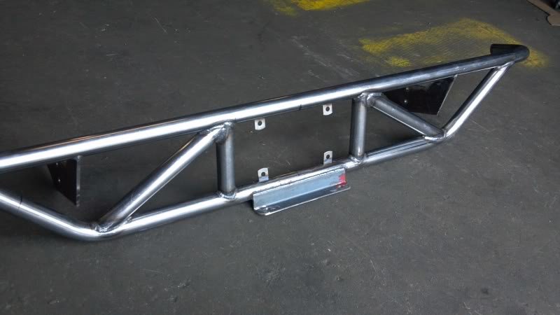

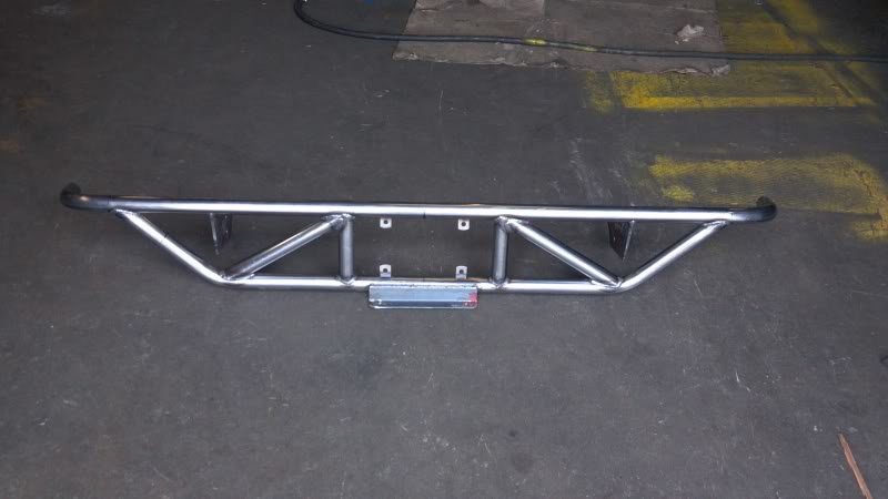

    Got my rear prerunner bumper made! Will be painted soon!
    Also they are FOR SALE! - http://www.tacomaworld.com/forum/so...-05-12-custom-raer-bumper-starting-300-a.html
    Final Product!
    Thanks to Jerez, Anothony250, Manwithoutaplan, Blawkhawke88 and Whippersnapper for all the help with the install. I seriously coulnt have done it without you guys. And thanks Ryan for letting us use your girlfriends house. Also, thank you very much socaltrd for the really generous deal. There's no way I could have gotten this lift otherwise.

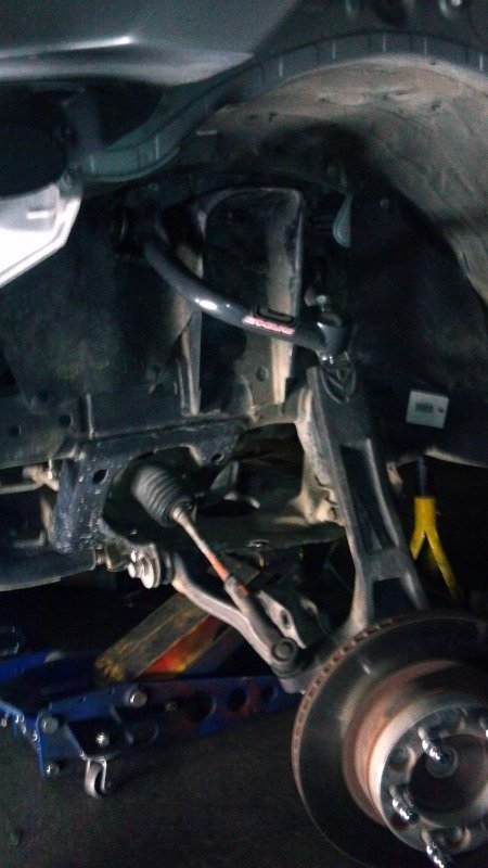

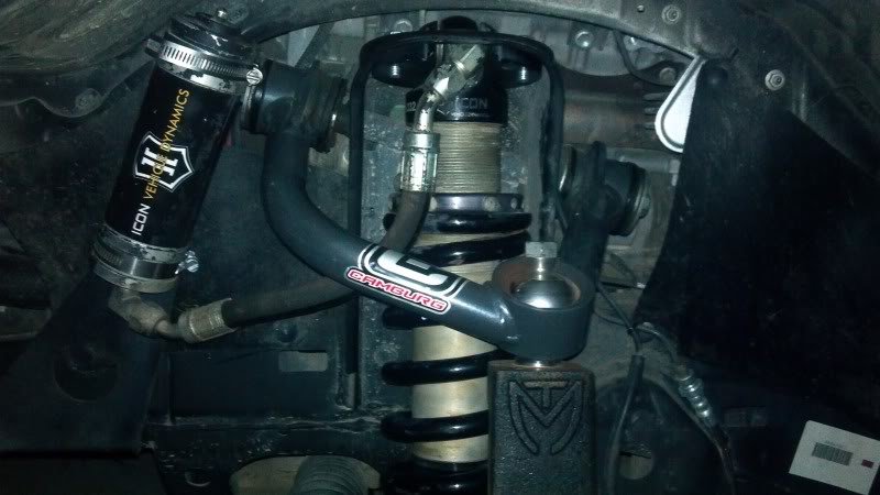

    THE LIFT- Camburg Performance UCAs 1" Uniballs, Bilstein 5100s all around, and All pro 3" expedition leaf pack.

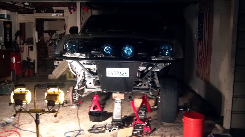

    Jerez did my fog and locker lights since they burnt out. Thanks again man!

    Opened up the scoop to let air in. (mostly to make it less fake)

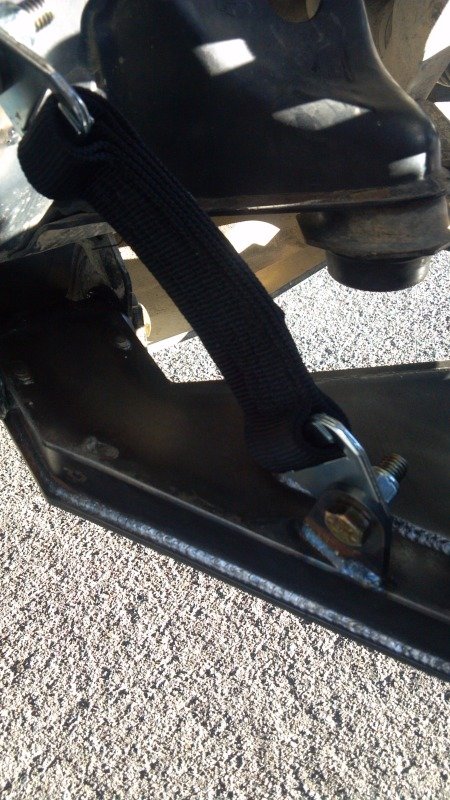

    Made a tie down for my CB antenna for when I enter parking structures.

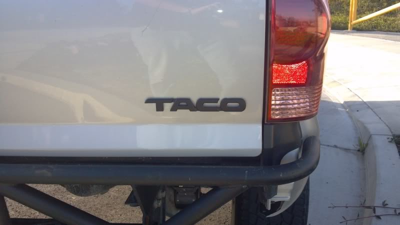

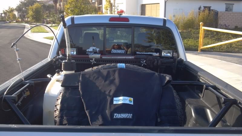

    Got bored and added my old Taco logo to the tailgate.

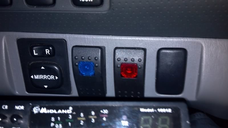

    ABS Bypass Mod (Red Switch)

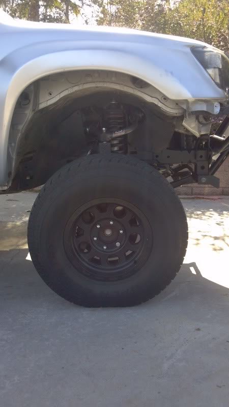

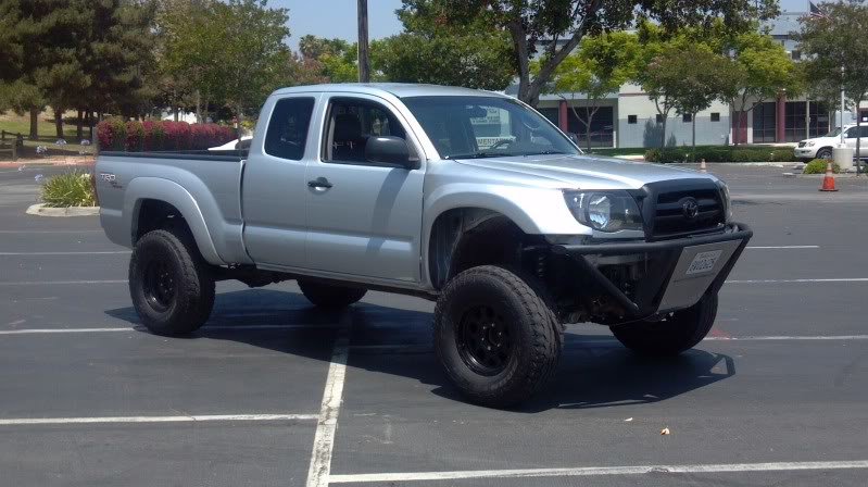

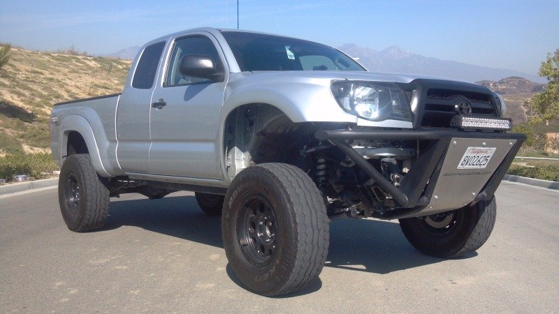

    4" Maxtrac Spindle Lift. Bilsteins were set at 2.5 at this time. They are now set to 1.75

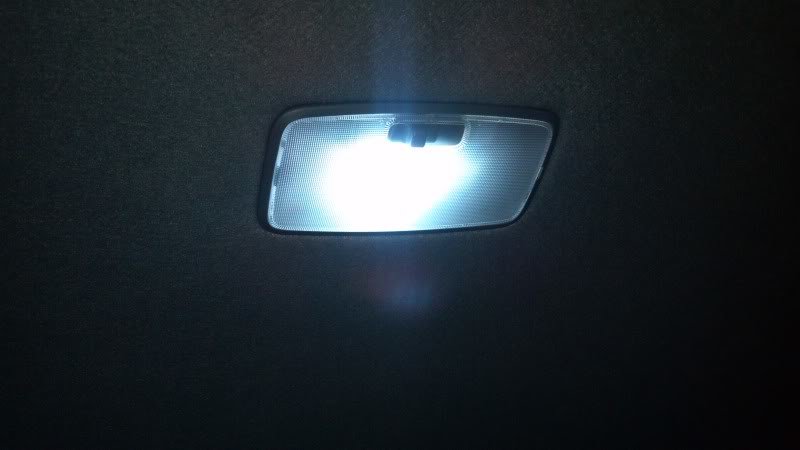

    Got interior LEDS, parking light LEDS, and switchback blinker LEDS from csjumper2003 THEY ARE WAAAAY BRIGHT!!!

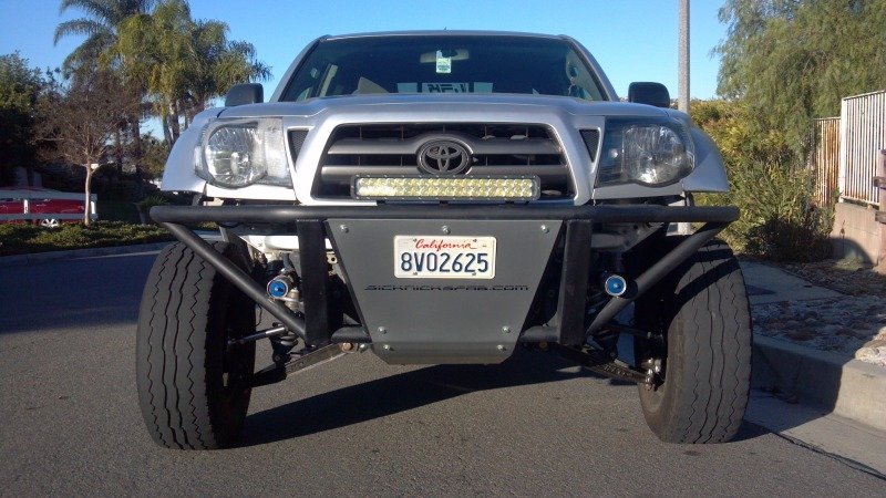

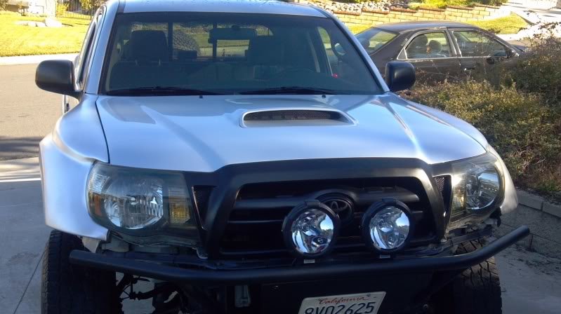

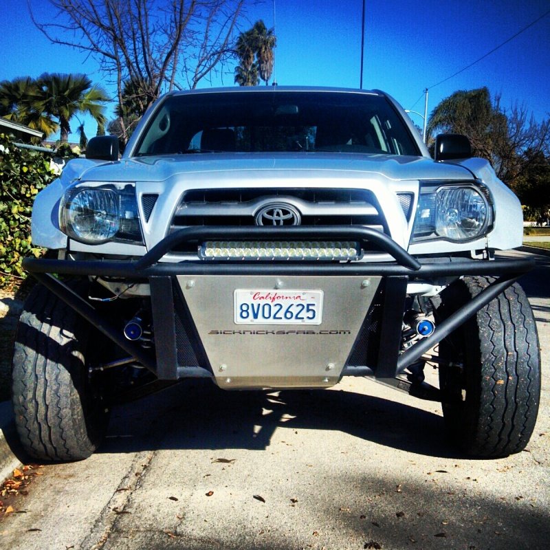

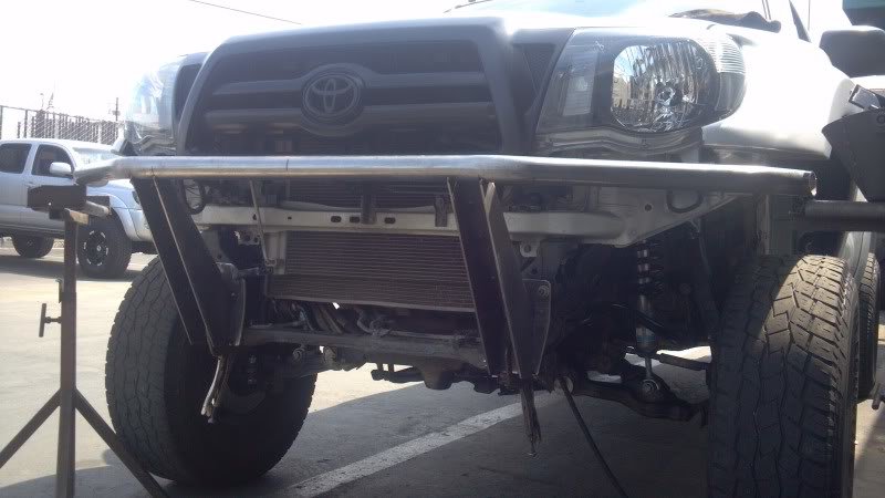

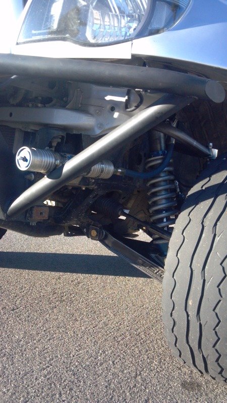

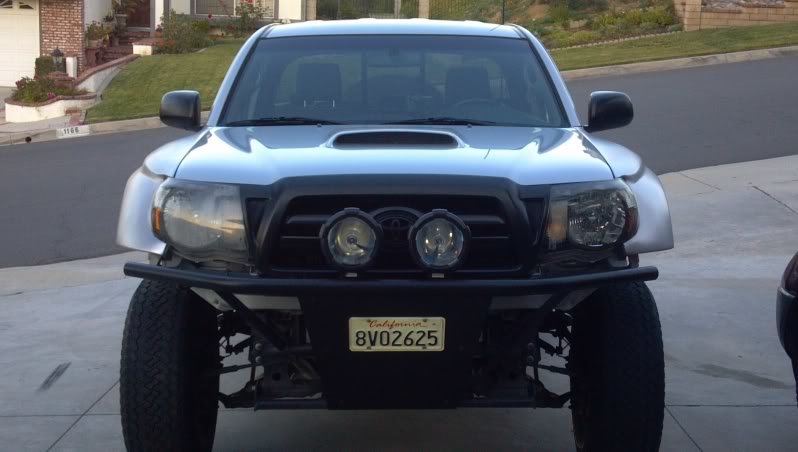

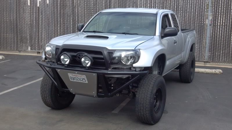

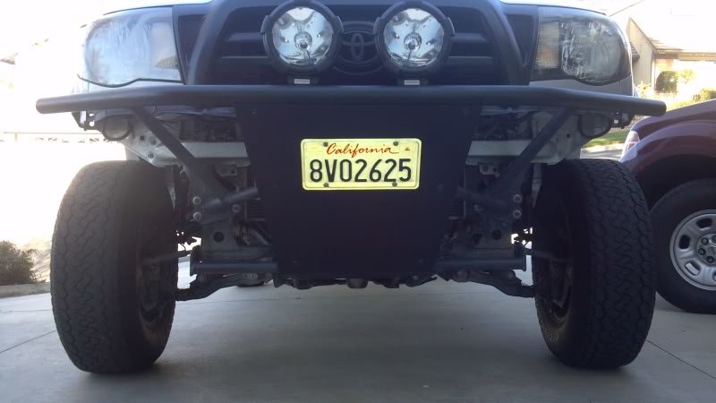

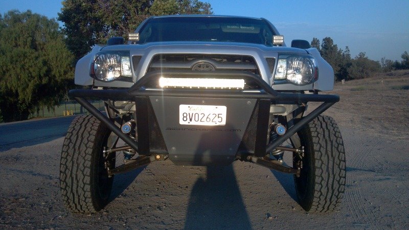

    New Bumper from Sick Nicks Fabrication -

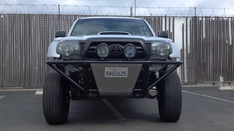

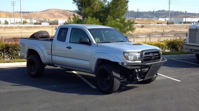

    -Sold my rear bumper (New one will match my front and will use sheet aluminum.)

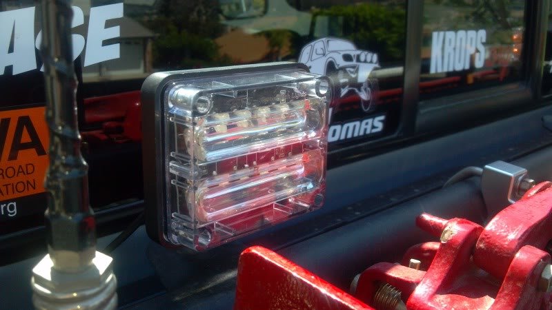

    Got some chase lights from SpeedTechLights.com. Awesome lights. Thanks for hooking me up ProForce (Anthony)

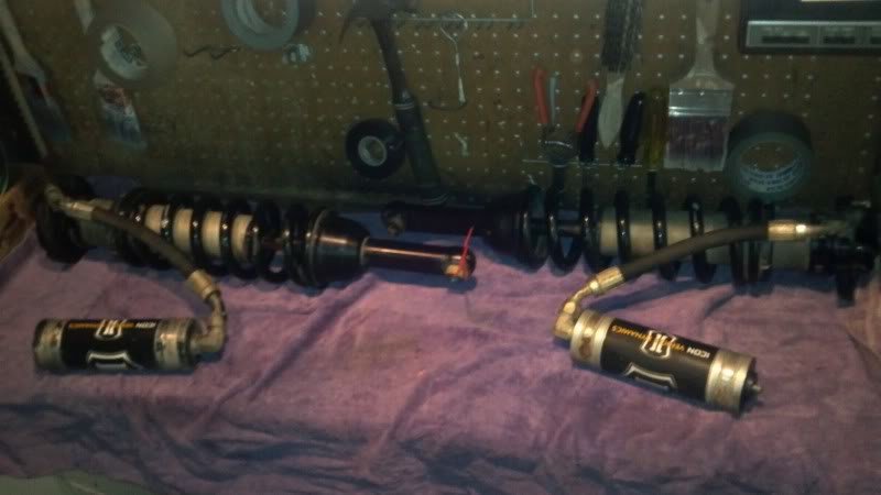

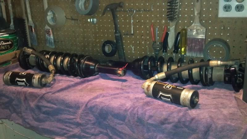

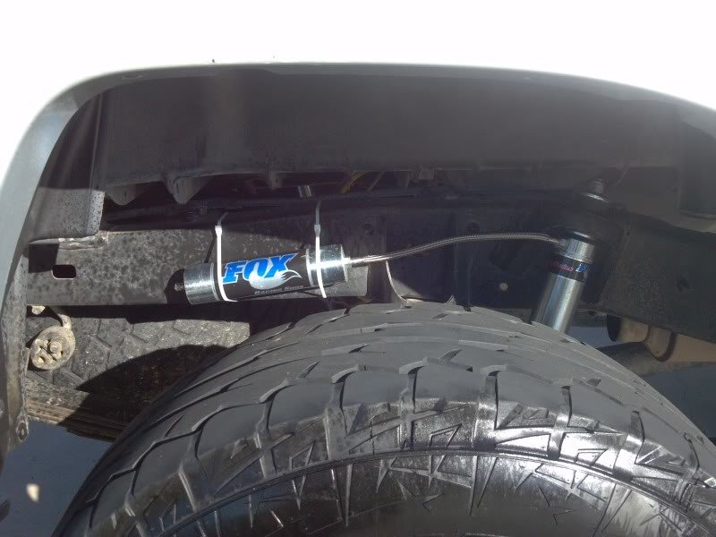

    Bought some used 2.5 Icon Resi Shocks for $300 bucks and cleaned them all up!
    Coilovers are way high because they are extended travel and increased spring rates. Gunna try lowering them today but if they are still high, ill change out the spring.

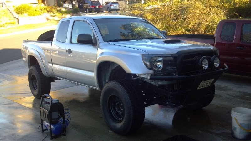

    Here's a couple pics from this weekend. 8-24/25-2012

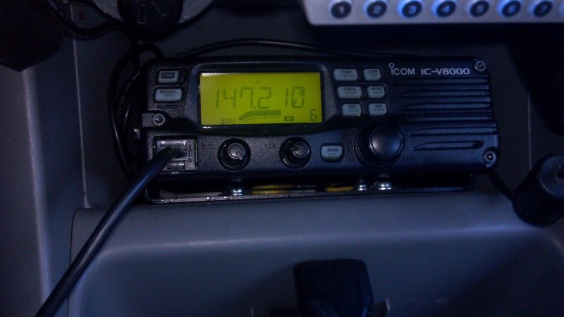

    Got a 2 meter HAM race radio (Icom ic-v8000)

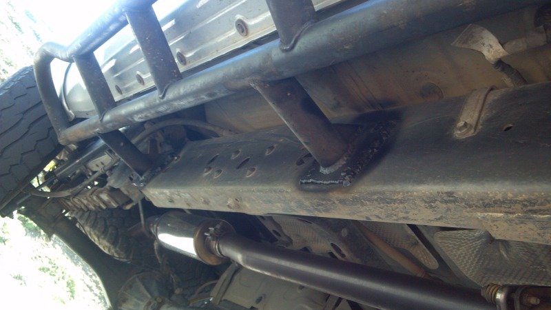

    BIG Thanks to Sick Nick's Fab for welding on my 4xinnovation sliders

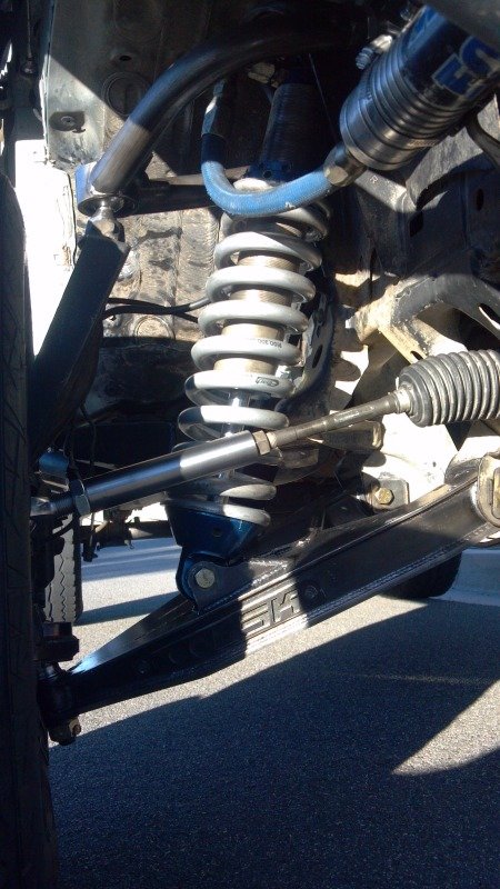

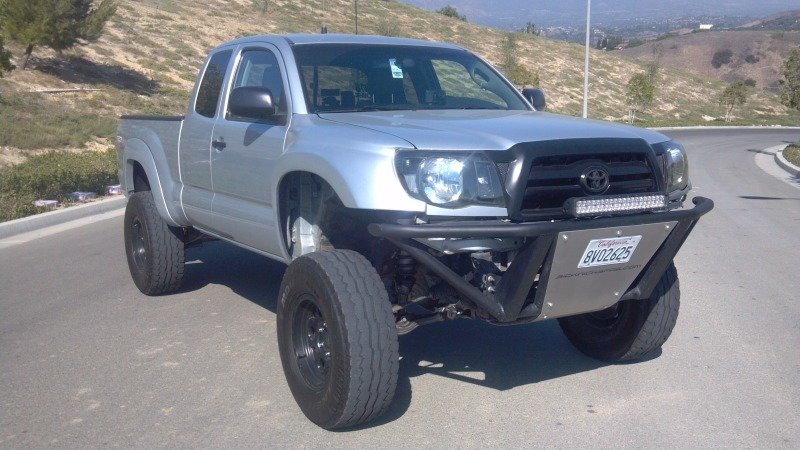

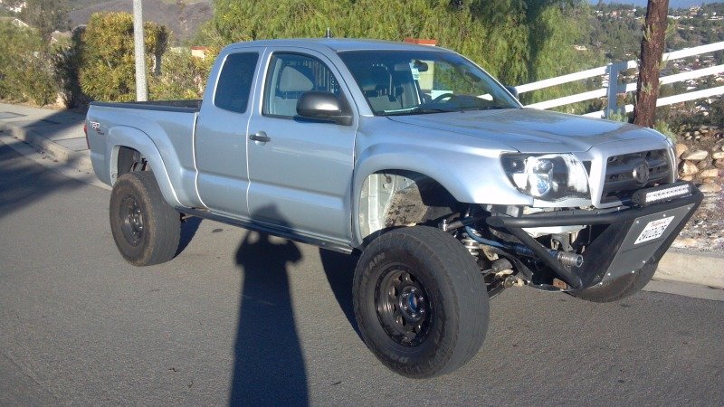

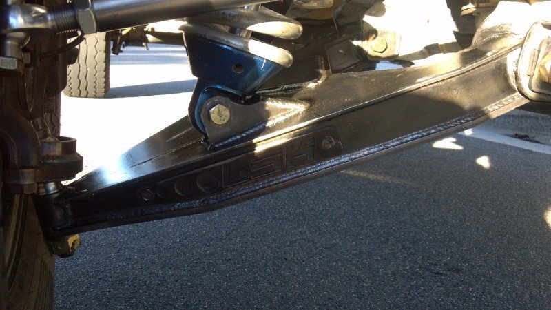

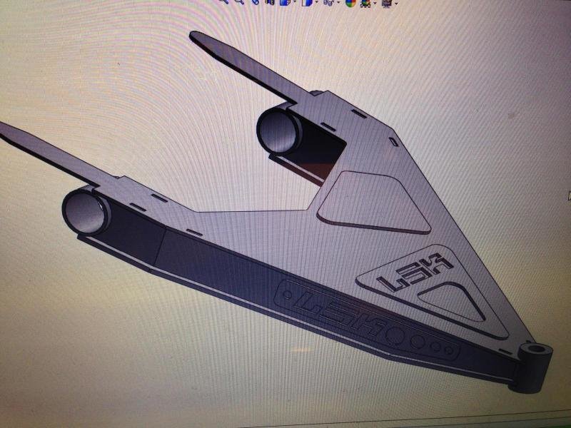

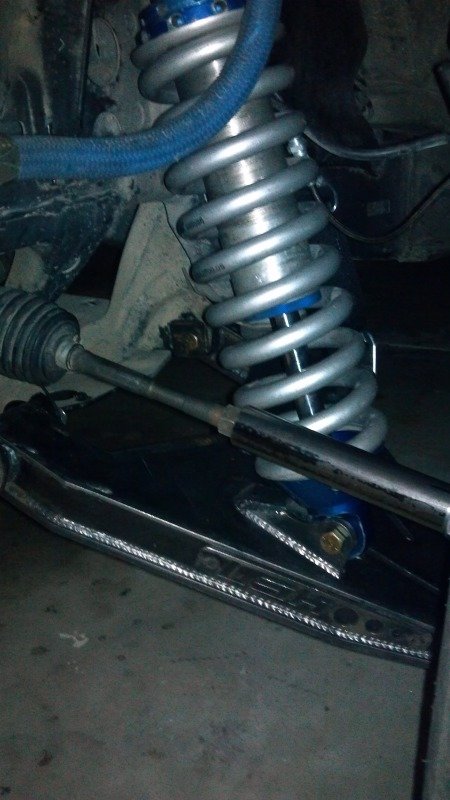

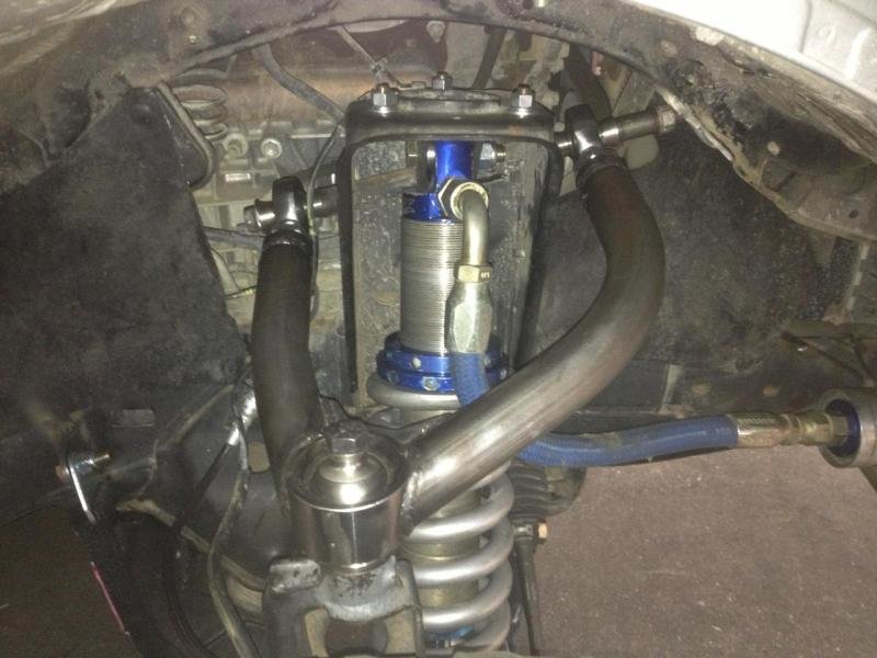

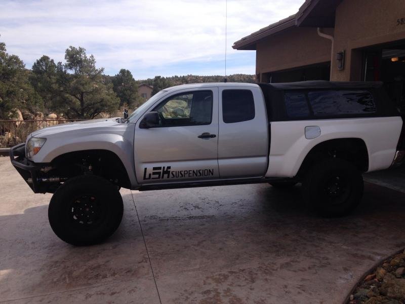

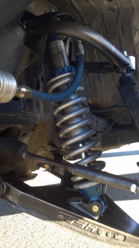

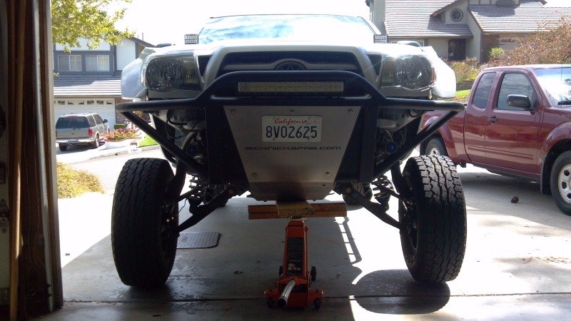

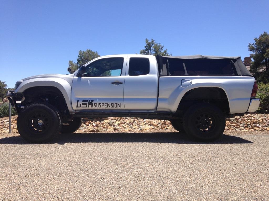

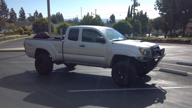

    Hi guys. As many of you already know, I recently decided to pull the trigger on a longtravel kit. At the time, I had enough for the Camburg kit that I wanted but after thinking about it, I wanted something different. I then approached LSK here on the forums about doing a prototype kit for my 2nd gen. They automatically accepted the challenge. Seeing these guys work is pretty incredible. Most of these guys are younger college students but don't let that fool you. They are extremely familiar with doing suspension work and everything that goes into designing like stress tests, full CAD drawings, ect. Overall, I would do it all over again. They designed my kit, plasma cut all the pieces out, welded everything together, hand machined the steering extensions, bolted on the kit, cycled it (to get the travel numbers), aligned it and had me out driving it in less than a week.
    The 2005-Current Toyota Tacoma LSK long travel kit is 3.5" wider than stock and utilizes fully hiemed upper control arms and a 1" uniball. The lower arms use Delrin bushings and are bolted to a 1" lower uniball. The kit itself is made out of 3/16" inch steel while the bottom is made out of 1/4" steel. It is fully mig welded together on all sides. The lower cam tab bolts have been eliminated and instead use boxed spacers so you will never need to worry about having a mechanic align your truck. It can all be done at home with a jack and a tape measure. Kit is FULLY bolt on except for the limit strap tab. Now for le pics!:D
    COILS ARE TOO SHORT I KNOW I KNOW!!!!

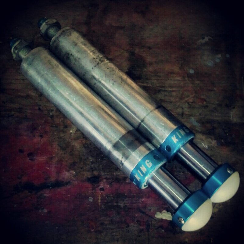

    LSK mounted my King 2.0 2" bumps. No more hard hits at bump. :)

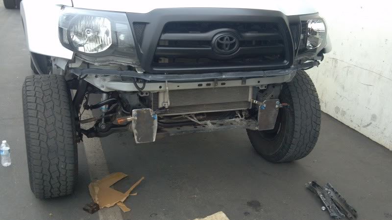

    Added a light hoop and some more protection to the radiator. All work done by Sick Nick's Fab
    Adjusted my preload a little bit

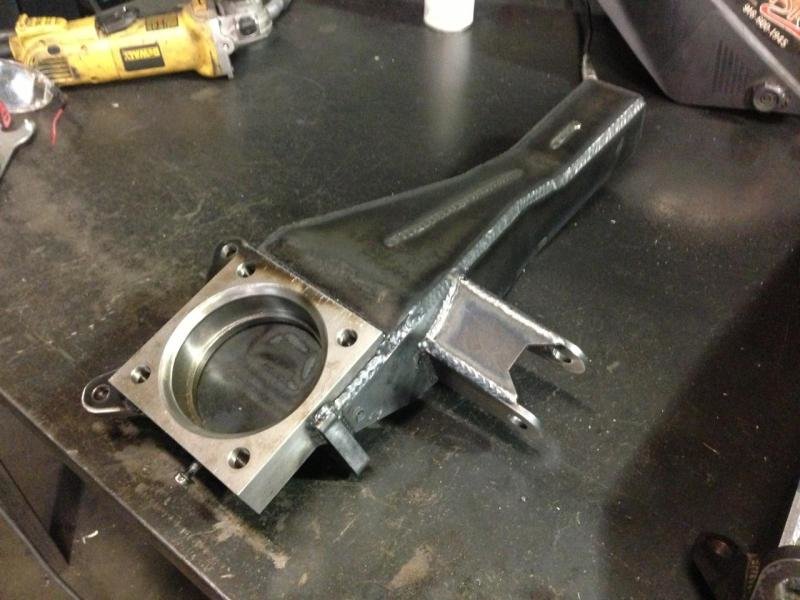

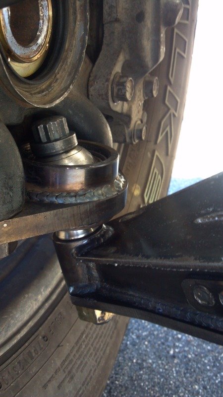

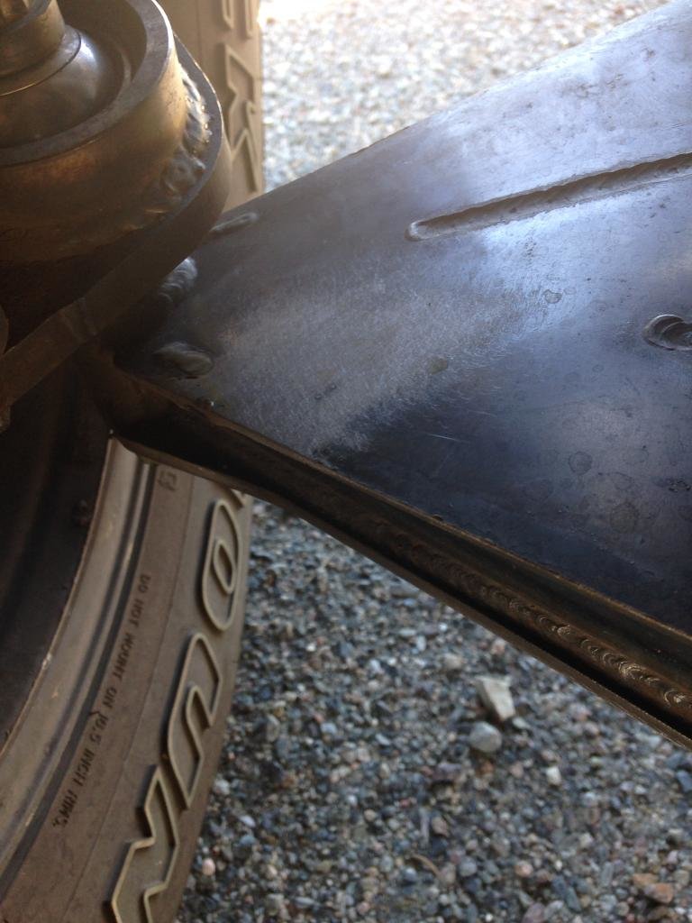

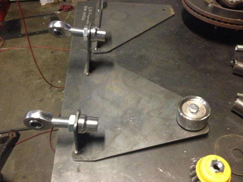

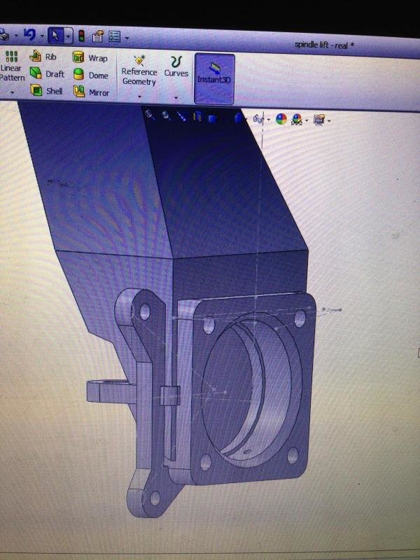

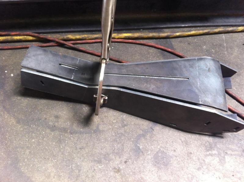

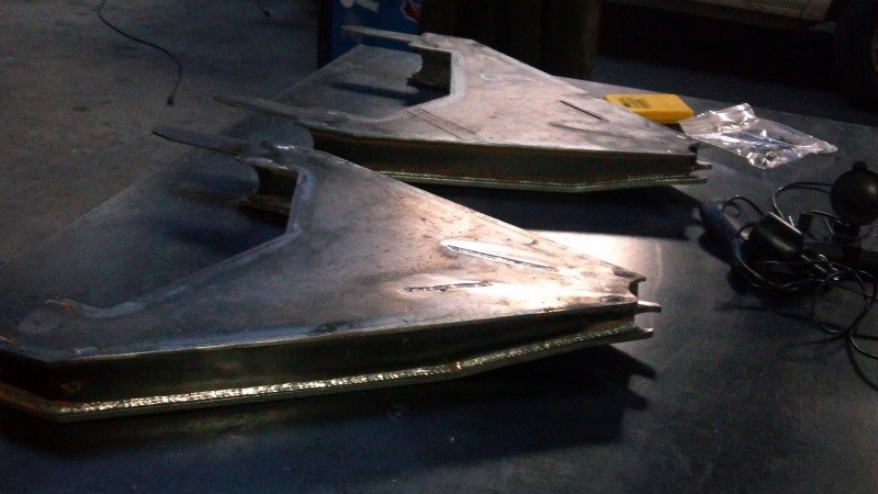

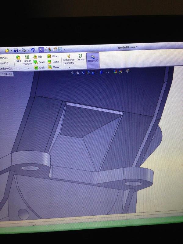

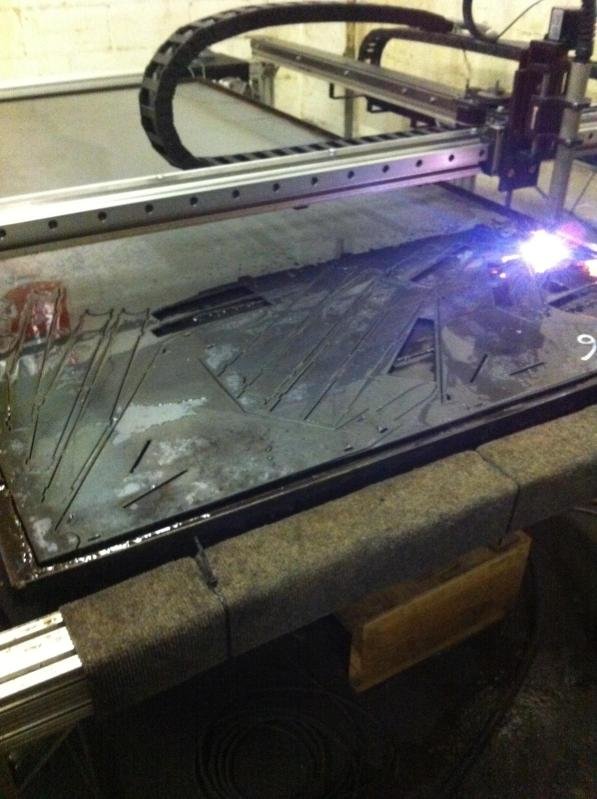

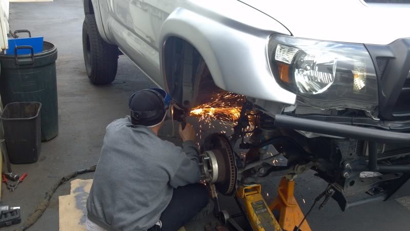

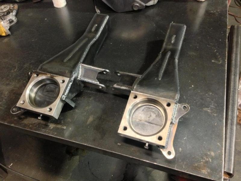

    LSK's Progress on their 3" lift spindles. :) Constructed out of 3/16" cold rolled mild steel and fully reinforced inside and out. 4x4 spindles are coming right after these are made (which will be soon!)

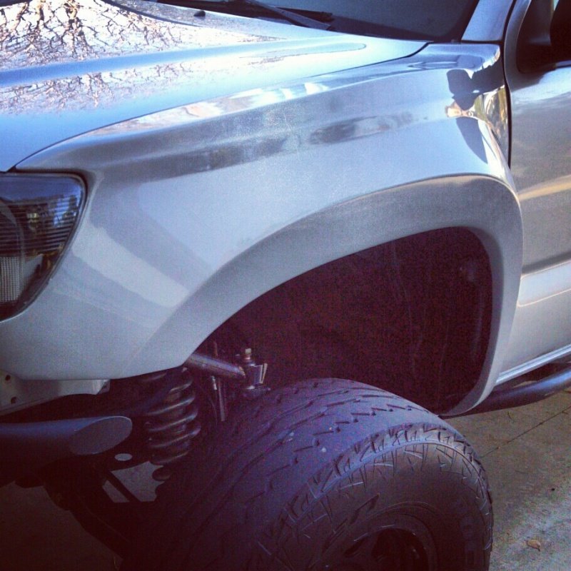

    Also got some Fiberwerx fenders for $80 then got them professionally color matched.

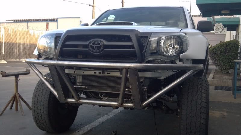

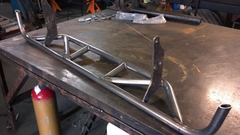

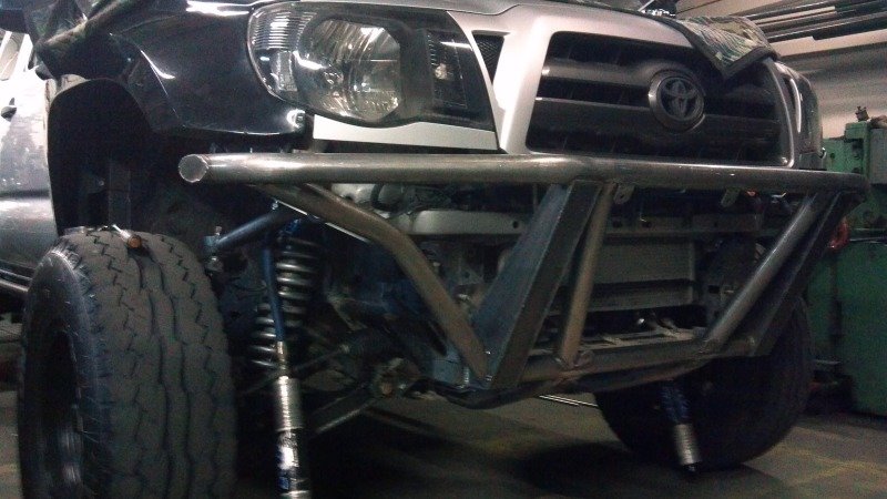

    Lastly a pic of a prototype bumper from Sick Nick's Fab. :)

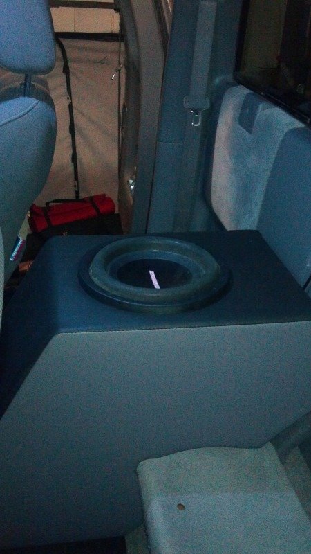

    Had a member build me a sub box. Hits WAAAY harder than my little box I had.

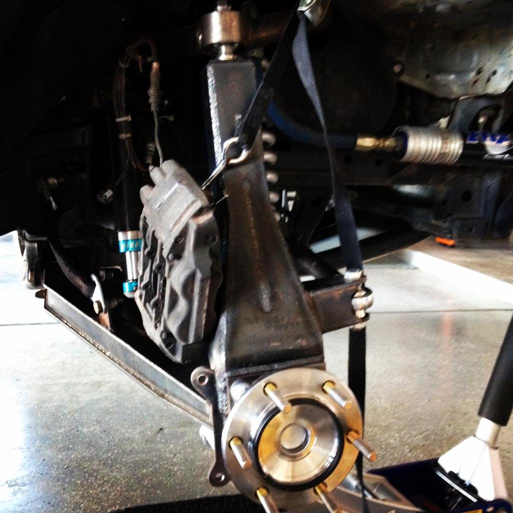

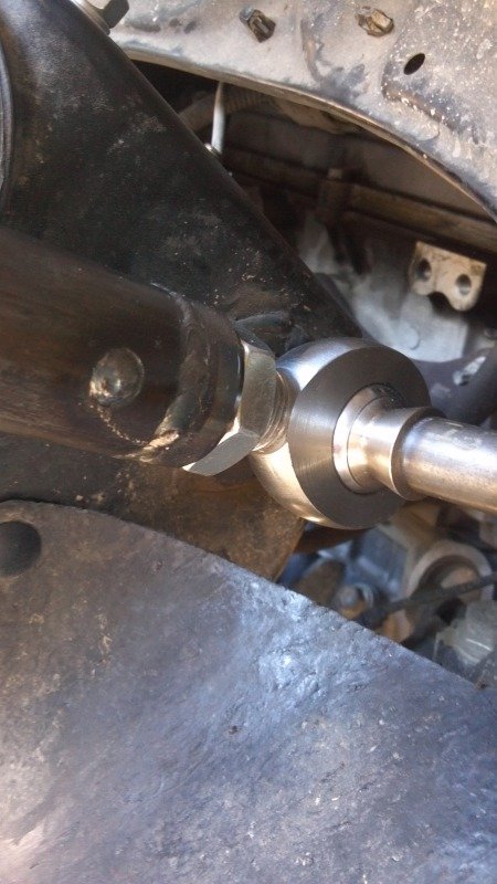

    Heres some pictures of the spindles LSK built. I will say, if I planned on getting spindles, I prolly would have done the kit with a vertical uniball but I may do that in the future. Anyways, here are the spindles. They will work on a stock application. There will be two types. The first will be like mine with double sheared hiemed steering upgrade for stock length steering and long travel steering. The second kind will use the stock ball joints. They are made out of thicker stonger steel than camburgs but only give 3" of lift. They will work with the stock ABS sensors. Call LSK for pricing if interested.

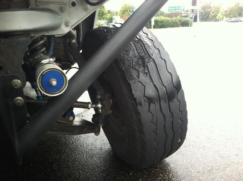

    Had a little mishap when driving to home depot

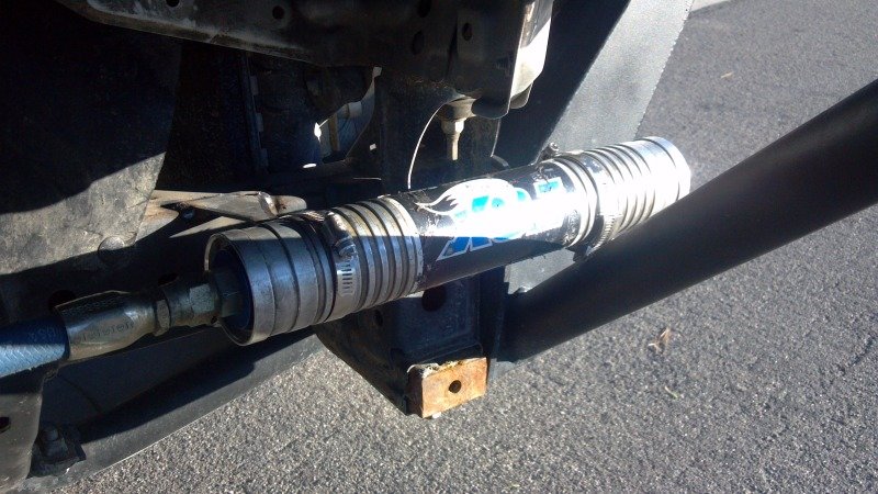

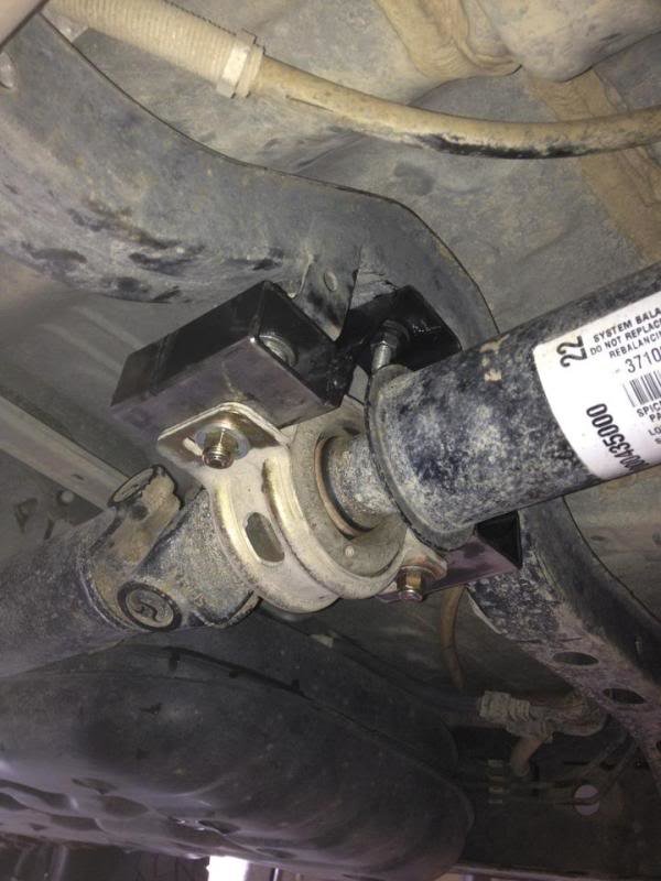

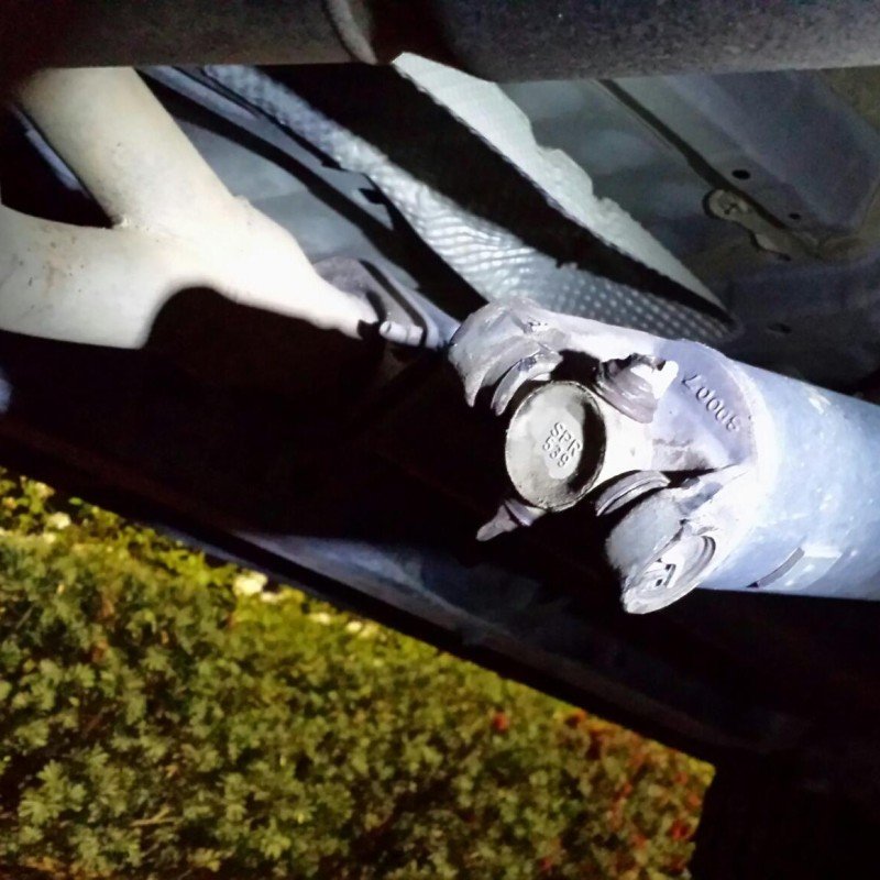

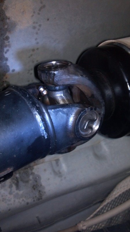

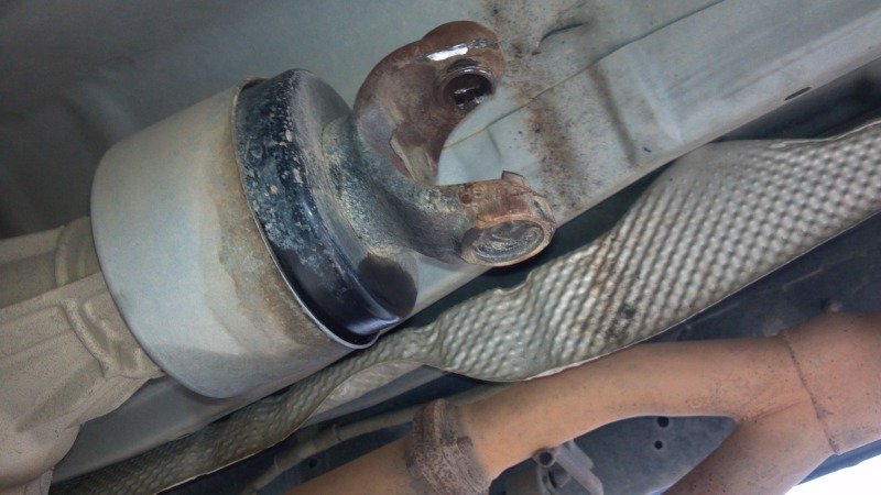

    So I removed the driveshaft and took it to a specialist who upgraded all of my current U-Joints to stronger ones with grease zerks so they wont dry and turn the needle bearings out like these did.
    (NOTE: The grease under the truck was residual grease when the u-joints were packed.)

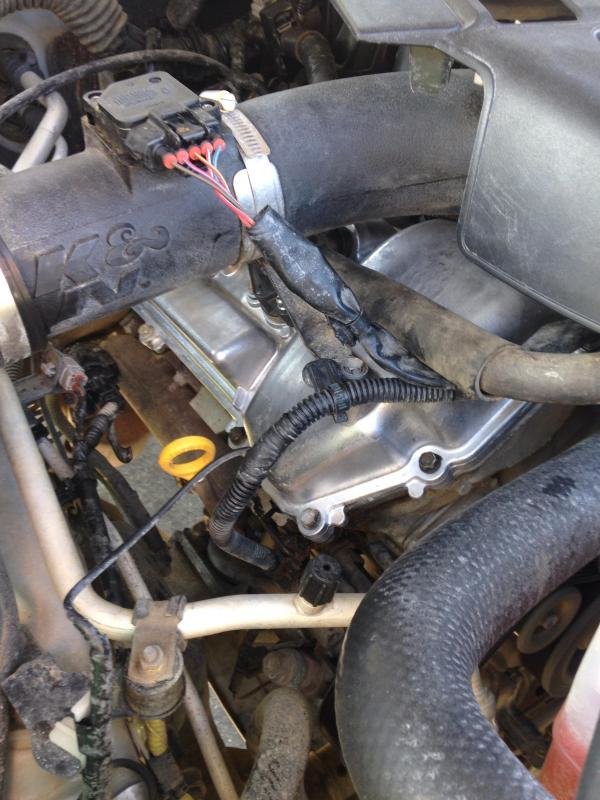

    Previous owner stripped a couple coilpack bolts and water got in when I was cleaning the engine. Had to buy new valve covers because I didn't want to use a hiel coil and the seals were seeping a little bit of oil so I knocked out two birds with one stone. (got the engine dirty again. lol)

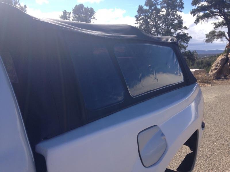

    Bought this Bestop from a member on here for $100 shipped. Was very pleased to see that it was in fantastic condition and the windows looked like they were never put on!

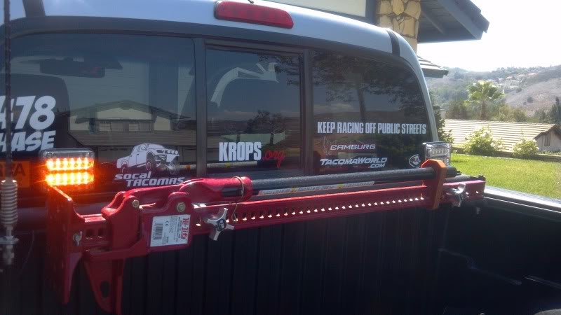

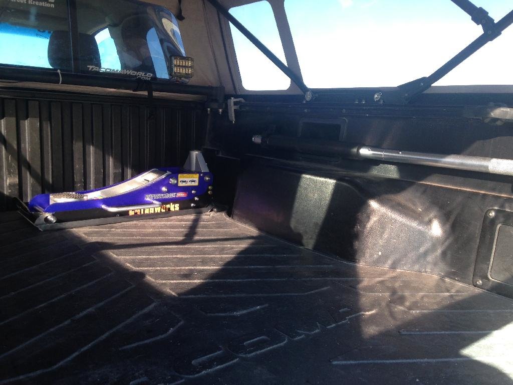

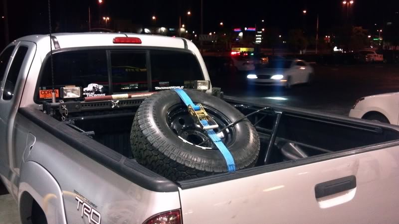

    Mounted my 2 ton harbor freight jack on the c4 fabworks jack mount/skid. It's pretty cool. Has a quick release and a way to put on a padlock. I used 4 2" 1/4" thread to mount it and it didn't move at all while I was off-roading today. I'm going to either tack the nuts on to the bolts or add security nuts so nobody can steal it by in bolting from the bottom. Also got some quickfists to mount the jack handle in the bed.

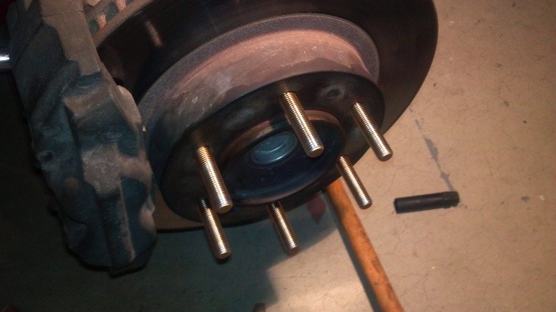

    Since I have been getting a lot of PMs about this lately, here is the info on the ARP race lug studs:
    ARP Wheel Studs part number: ARP#070-100-7715
    This is where I ordered mine.
    http://www.jegs.com/i/ARP/070/100-77...oductId=747558
    You will need 3 sets for the front because they sell them in packages of 5. I had to run a 1/4" wheel spacer because my extended thread Gorilla Lug Nuts would bottom out. You could go my route or buy some open end lug nuts. 12mmx1.5 is the size for our trucks. STOCK LUG NUTS WONT WORK

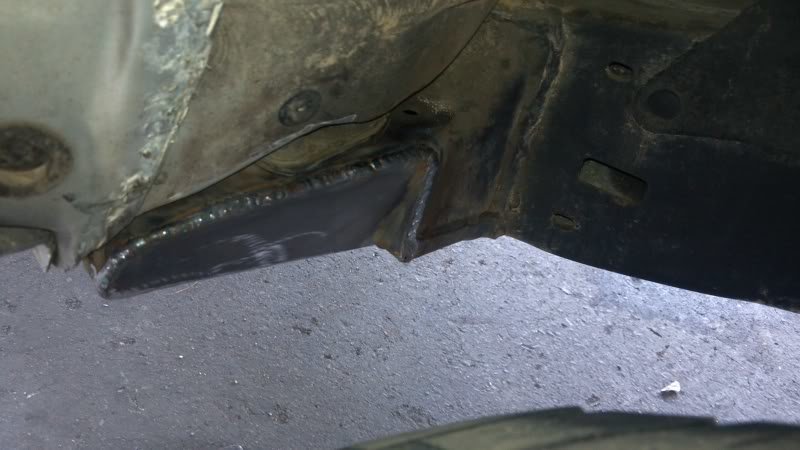

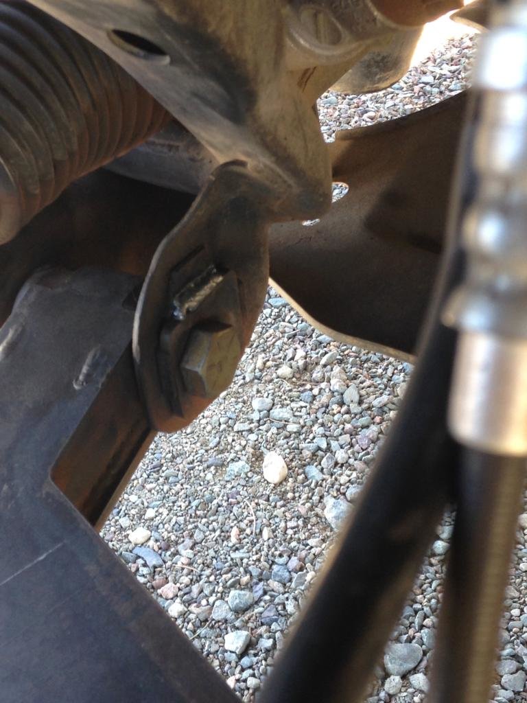

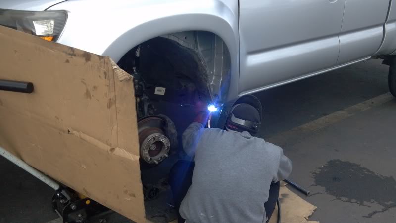

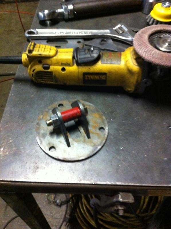

    Had a little issue with one of my cam tabs bending over so I had LSK weld all of the tabs.
    Before

    After
    14DBB3CE-3BB4-4991-B5EC-78A4D14A2E66_zps_c7ed94e6972c04ea4171901a412070aff332757d.jpg
    C8206314-3899-4B3B-A8A9-91266A8FFC1A_zps_46bf16e490efc1012abd17f4defb7cb58b7ab7bf.jpg
    I also had an issue with the uniball plate hitting the LCA so we limited the steering and fixed the LCA.
    EBFF316E-6F72-4E1A-9545-02CA4AA518CE_zps_c706ce8d4a0e35b3a8e55d763a9631313d528035.jpg

    Looks good bud!

    Estock
    Looks good man!! U need a lift n wheels next!! :D

    GETTING RIMS AND LIGHTS TODAY!

    Congrats! what are you going to be rollin on?

    Ended up getting Wheeler Procomps. I love them and all i did was trade my old ones. Im happy with them because I wont be angry if I mess them up offroading. I think they look awesome!!! Thanks again Curt!
