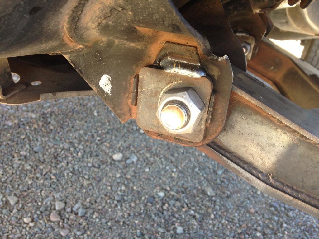

    Had a little issue with one of my cam tabs bending over so I had LSK weld all of the tabs.
    Before

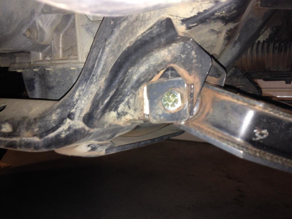

    After

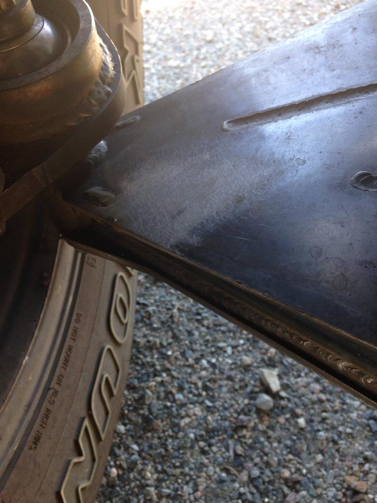

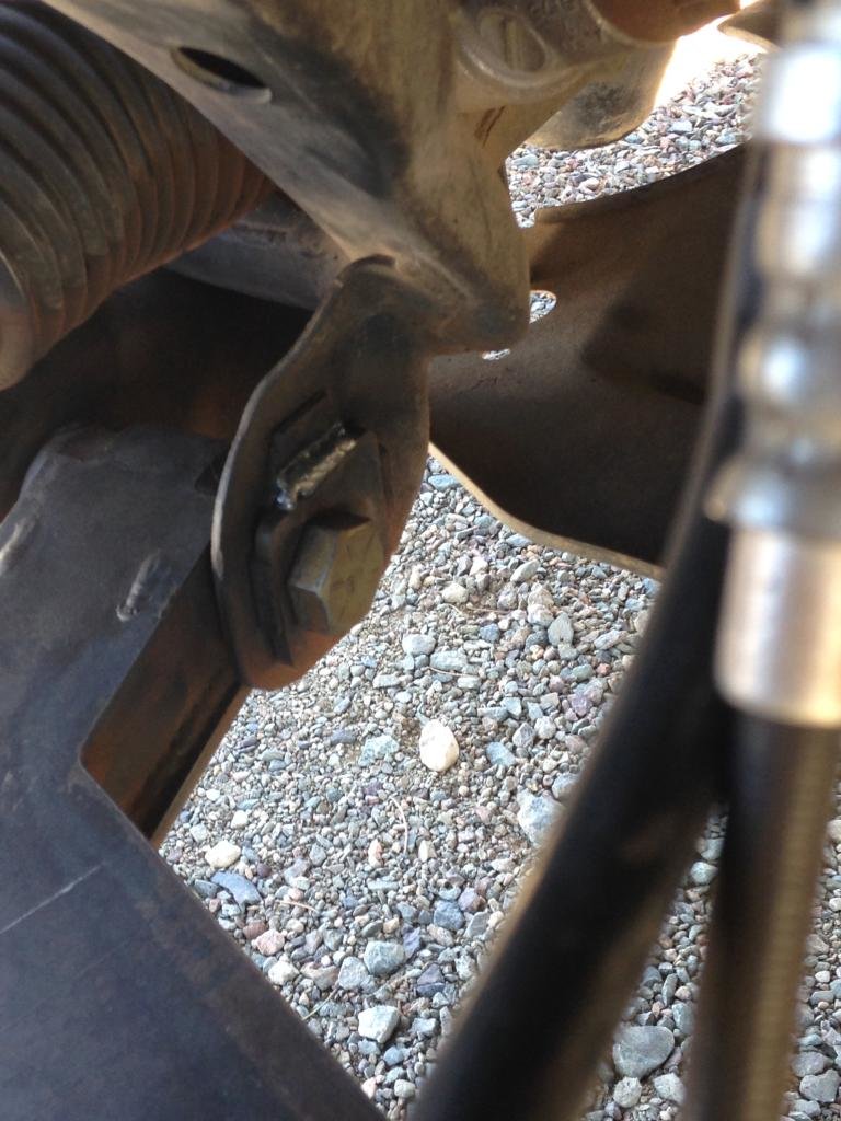

    I also had an issue with the uniball plate hitting the LCA so we limited the steering and fixed the LCA.
