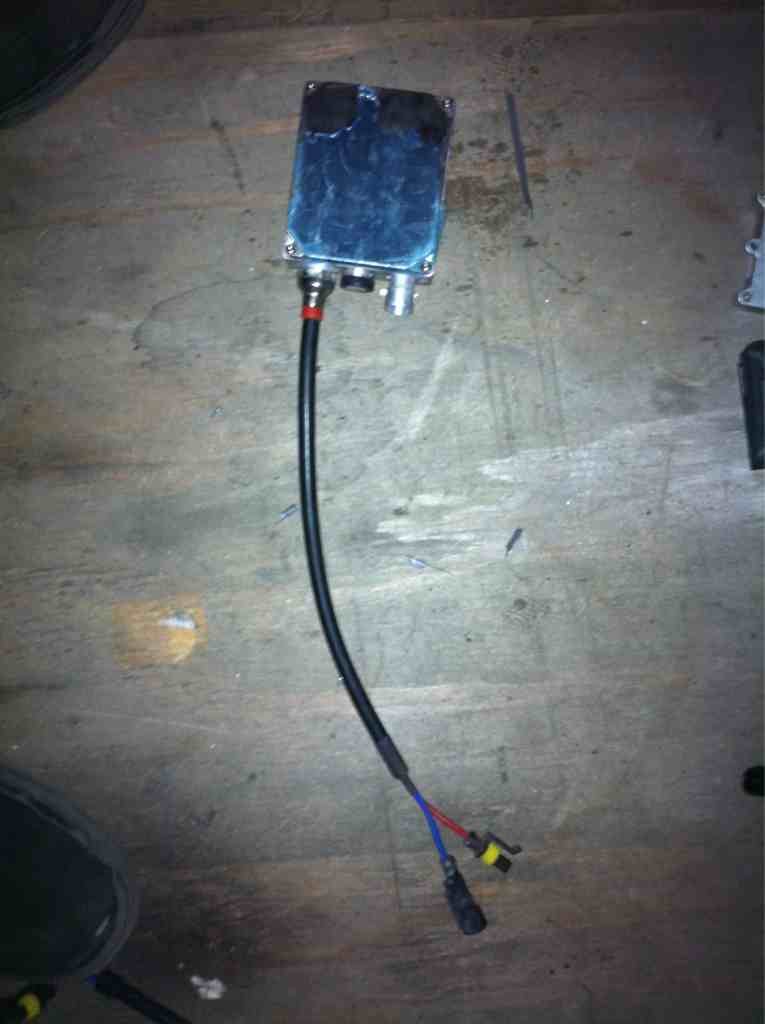

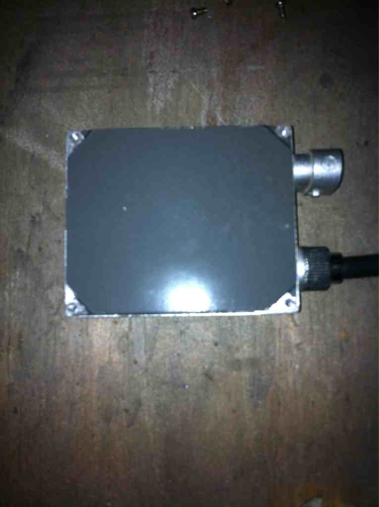

    First up, unknown brand

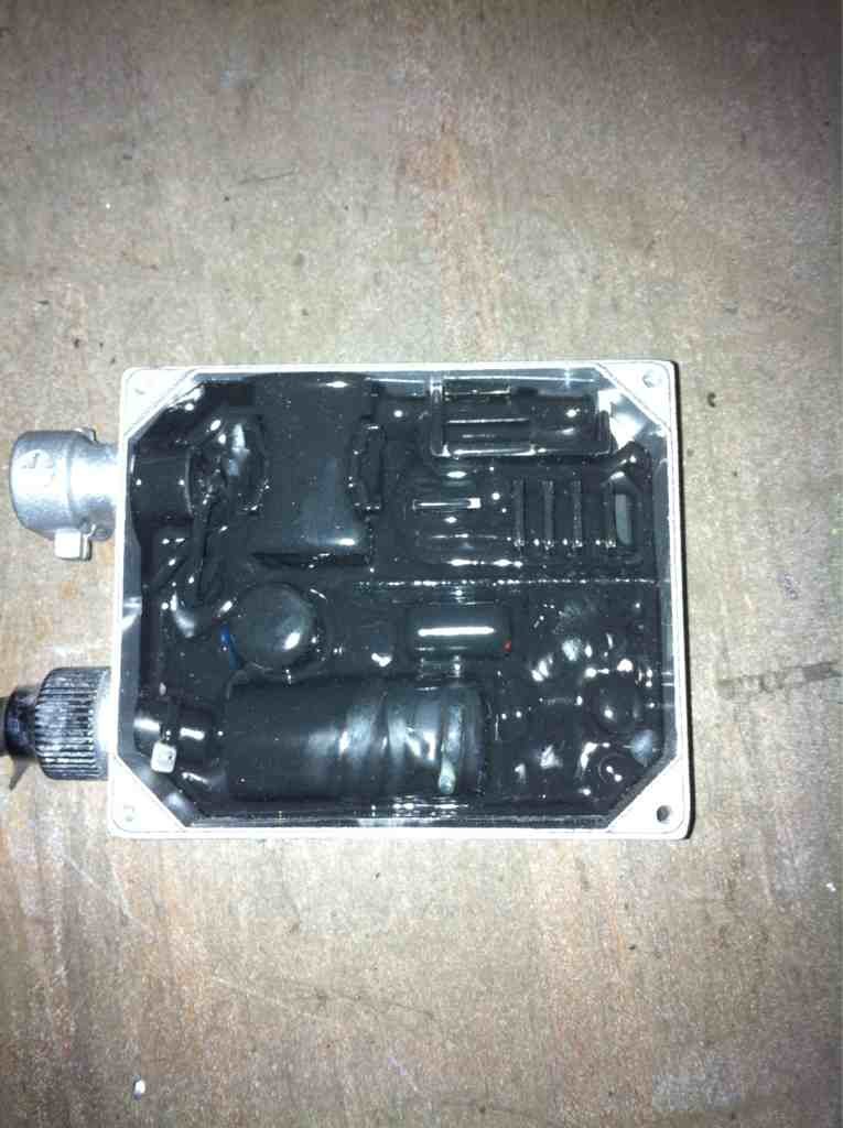

    Heavy ballast, feels solid, not flimsy metal. Was very difficult to pull the metal covers off to see the internals.

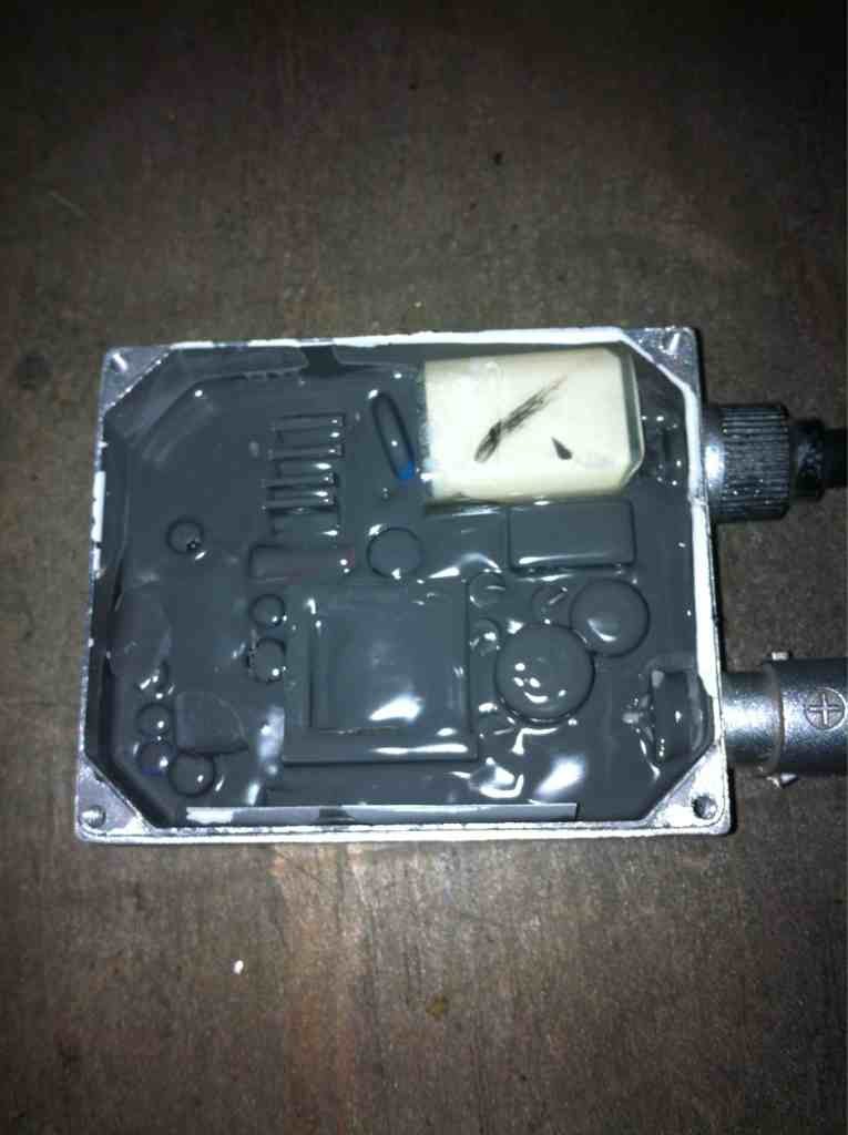

    Completely stuffed with silicon on the back side

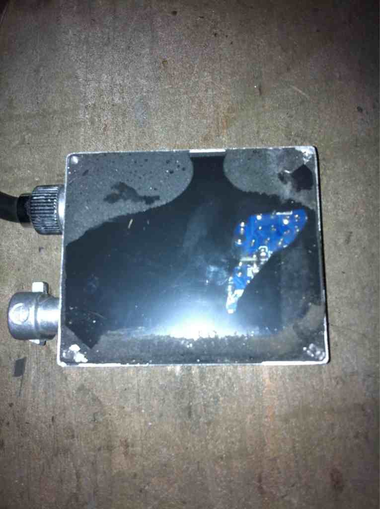

    Very thin layer of silicon on the front side. Igniter (white box inside) is completely exposed to the elements

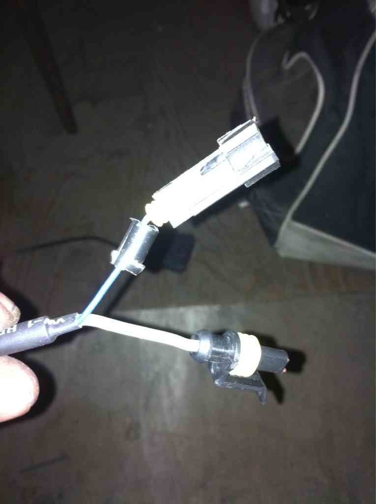

    Good wire thickness to support the high voltage

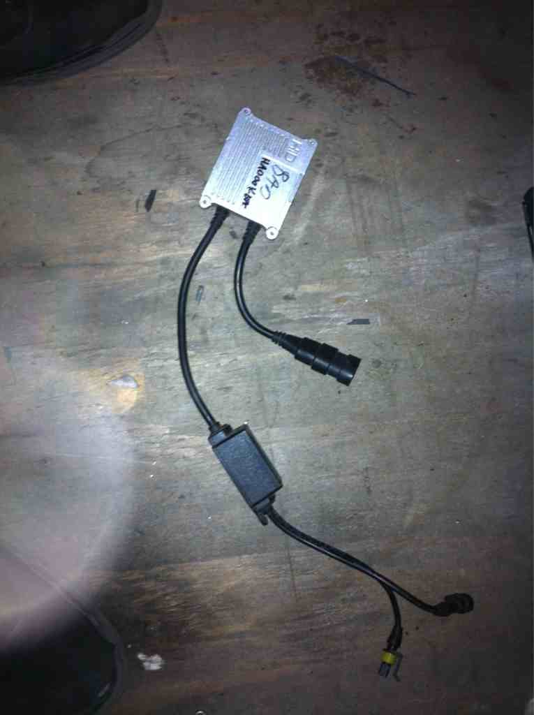

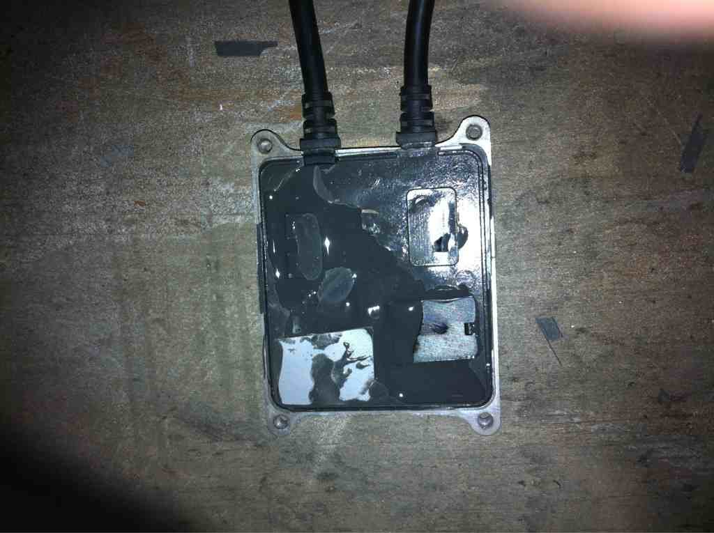

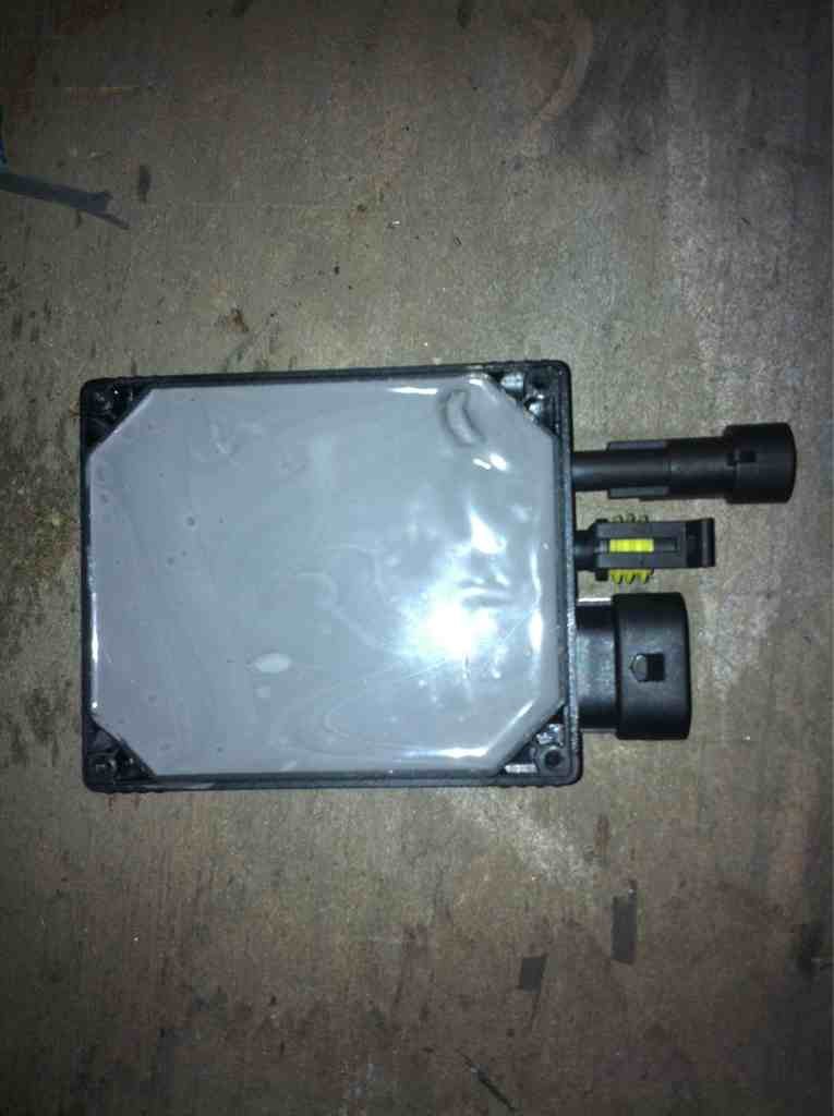

    Second up: DDM "Raptor" ballast
    Semi difficult to pull metal covers off. Filled with water on the inside, but ballast still functions properly
    Back side completely filled with silicon
    Front side metal cover was very easy to pull off
    Silicon looks like it was sloppily splashed into the ballast. Everything is covered except for half the igniter.
    Nice thick wires to support the high voltage

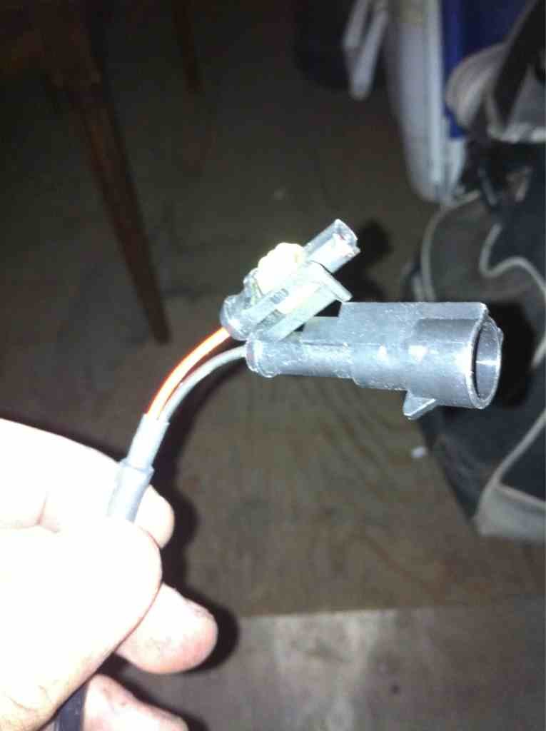

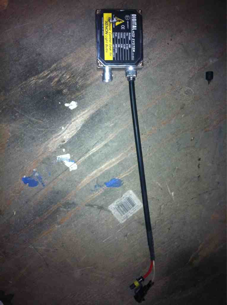

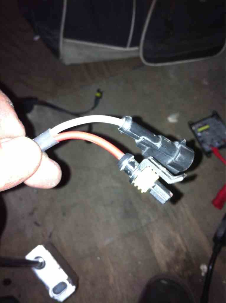

    DDM/ Apexcome Old Style Slim Ballast
    Back cover really easy to take off. Fell right off when the last screw came off
    Inside completely COVERED with silicon except for 1 little piece. However, the silicon does flake off to the touch. It is not completely filled
    Igniter is basically impossible to pull apart. I'll get back to you guys on this one haha
    Nice thick wire. Cheap knock off "AMP" connectors

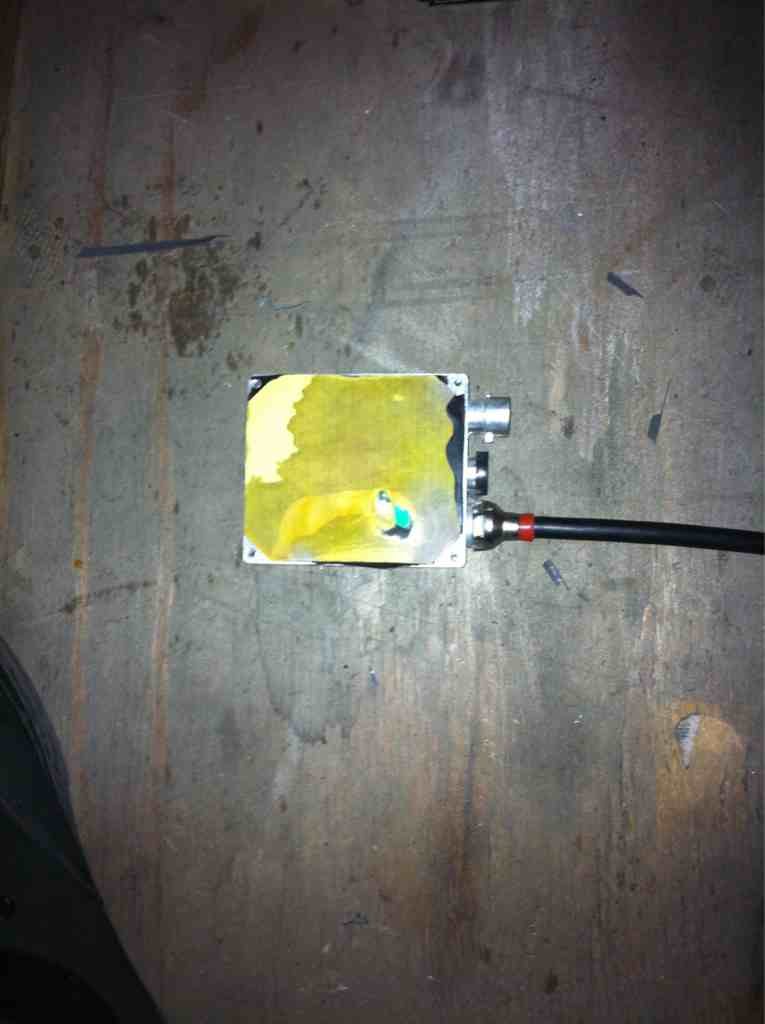

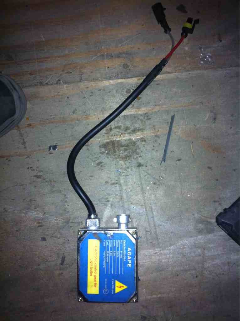

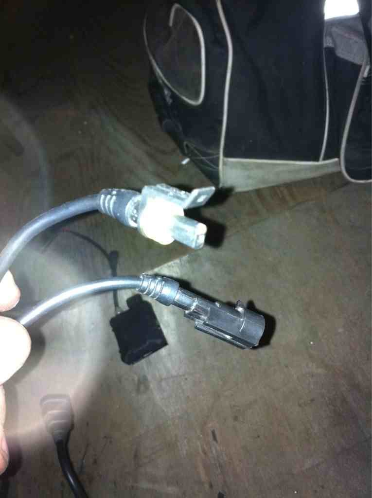

    Agape Brand
    Front cover was almost impossible to take off. Actually broke a screw driver doing it
    Very well coated. Really thin layer but it is very durable.
    Back side has some type of clear plastic cover with silicon on top of it. Idk the philosophy behind this but it's not a very good design. Little scratches and tears in the clear plastic and water can get into the computer board
    Plugs and wires look very nice. Thick wires

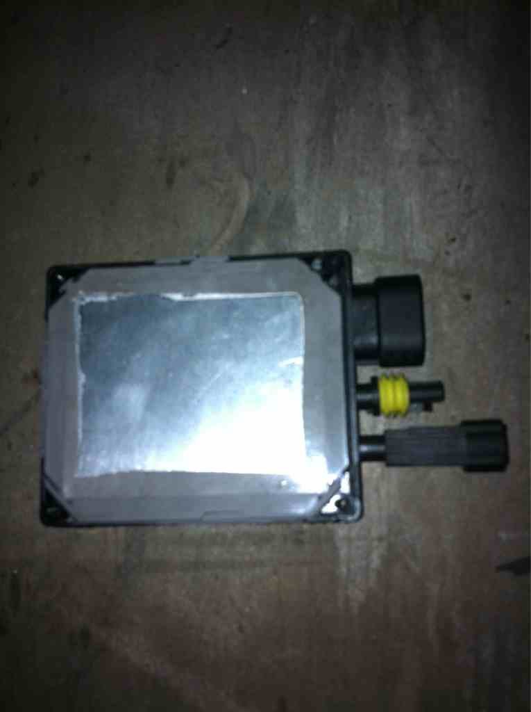

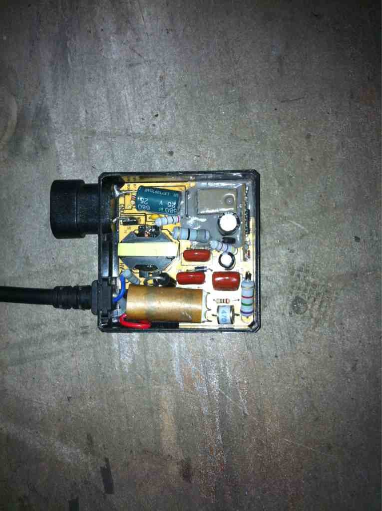

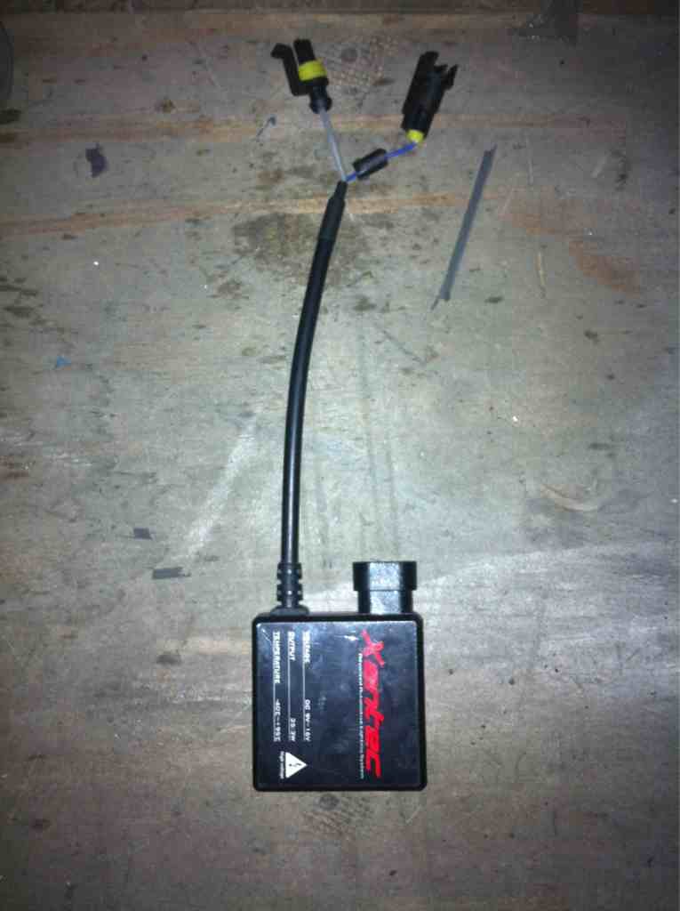

    Xentec
    Only ballast I have personally ever seen with a plastic casing. Feels very cheap
    Tore the front cover off with my fingers (held on with clips. No screws or sealant) inside has absolutely 0 waterproofing and very horrible soldering points. Everything about this ballast seems cheap and very Lo quality.
    EXTREMELY skinny negative wire.
    One of the worst quality kits that I have ever seen

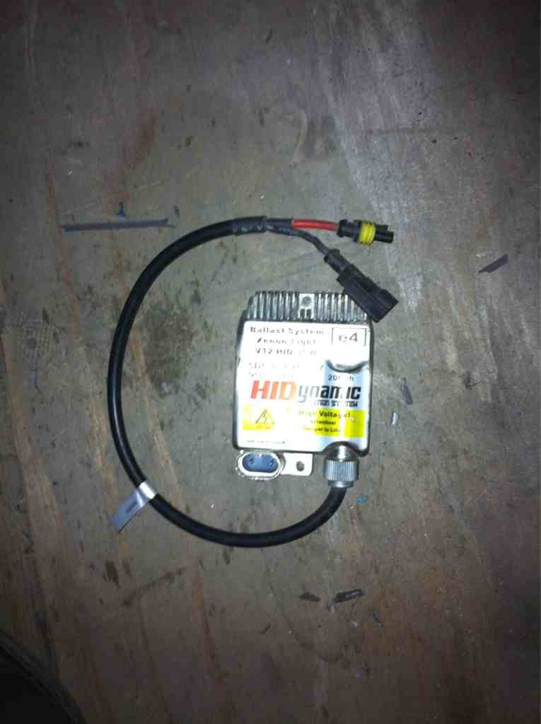

    HIDynamic
    I'll get back to you guys on this one. Screws are all stripped out

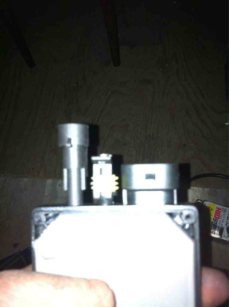

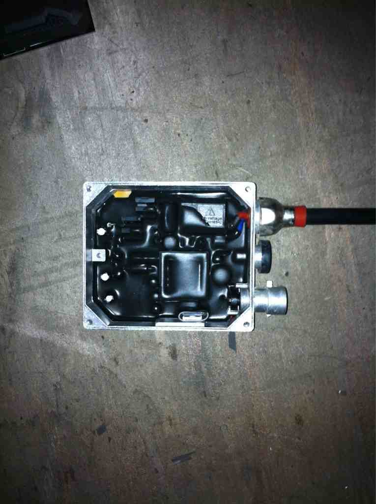

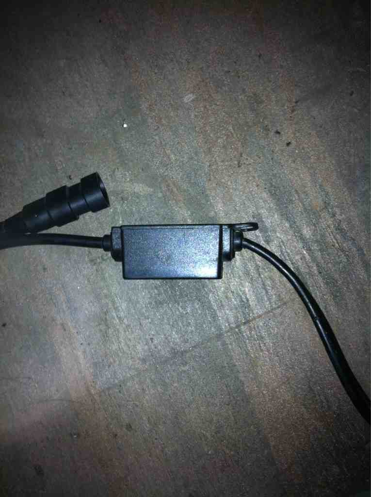

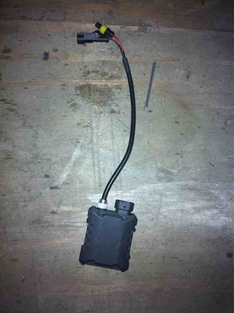

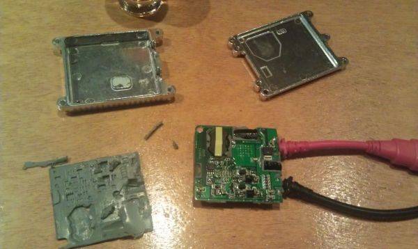

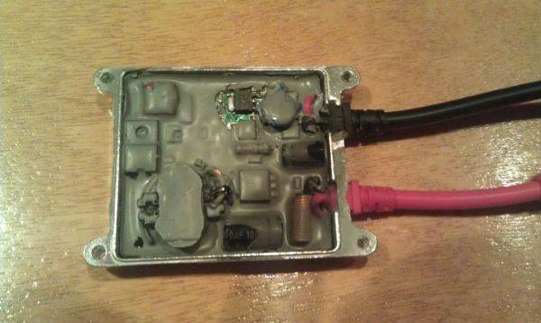

    Here's a Kensun kit off Amazon.
    It unscrews easily. The parts completely missing was from me picking at it before I started taking pics but you can see how thin it is, barely covering in some spots and not covering in others.
    The back side had a much thicker coat. You can see here where I pulled the whole thing off. It was nice heavy coverage. Too bad the other sucked.

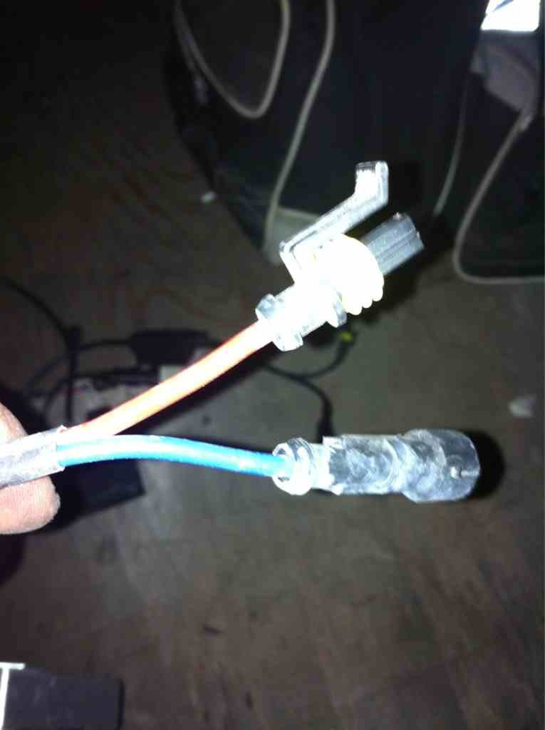

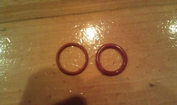

    The connectors are the same as just about all the others. I've gotten them without the connector boot before too, so be warned. It's not a big deal, but it can happen. I've heard it happen with others though as well.

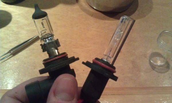

    One thing I want to point out is the bulbs. They're a bitch to get in. It's not the tabs on the bulb, it's the giant o-ring. If you swap it with the o-ring from the halogen bulb you're replacing it's still water tight, as long as the old o-ring isn't in terrible condition. You can see them here for comparison. Most of the time I've been able to mash the new big ass o-ring in there. I was pushing so hard with these I was nervous I'd break something.

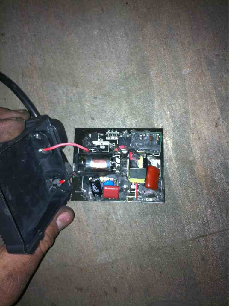

    My son had lighting problems the other night. It ended up being the anti-flicker capacitor that clips into the wiring harness. CarID.com puts just a little heat srink on around the capacitor but, nothing on the ends so water can get in there.
    Anyway while working on his system, I took one of the Nitto ballast apart and the insides and outsides are identical to the G.G. Lighting ballast. I took pictures but, have to upload them at work because I don't know how on a iPad :(
    Also, if anyone is wondering 1998 Tacoma does not need the anti-flicker capacitor.

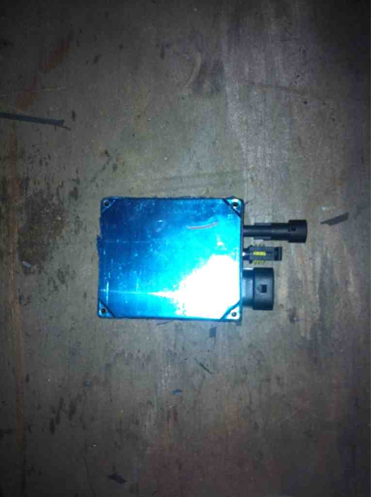

    As promised for future reference, this is the picture of the CarID.com Nitto Ballast. They look like the G.G. Lighting Ballast.
