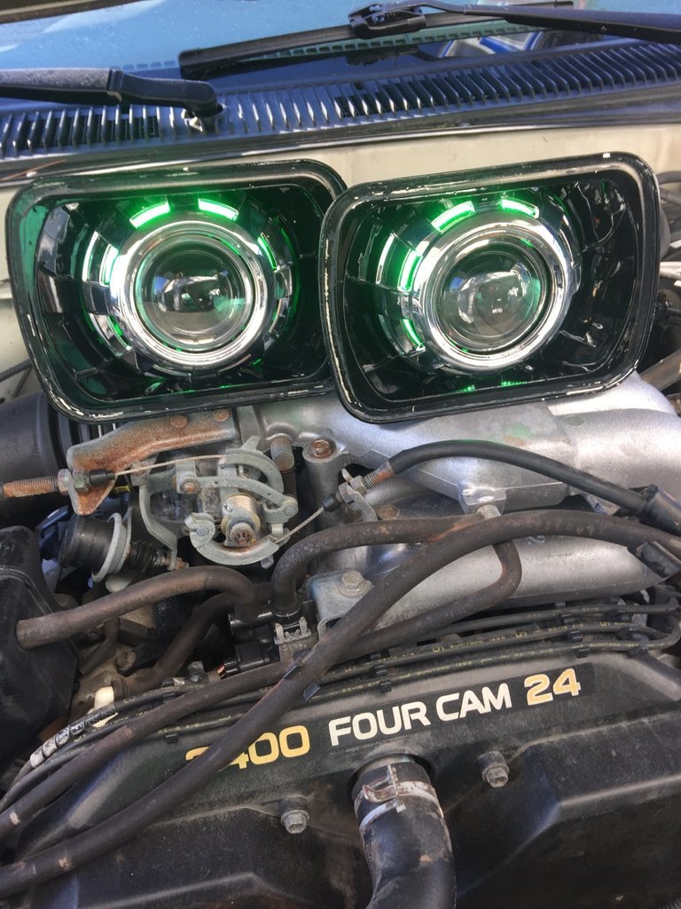

  16. Oct 7, 2015 at 7:32 AM
    #16
    Minnetacoma
    Minnetacoma Well-Known Member
    Sep 29, 2013
    #113537
    751
    Elliott
    Minnesota
    96 tacoma sr5 with oe sunroof
    3.5 fabtech suspension lift with dirt logic shocks, Wheelers Alcon 8 pack rear leafs with extended brake line All pro rock sliders Cbi DIY front bumper with m8000 winch Cbi bushmaster 1.0 non swing arm 33x10.5 BFG mud terrains Skid row front skid plate Trs headlight retro fit fxr 2.5in projectors with rbg halos Audio/electrical upgrades K2 73ah lithium battery Big 4 upgrade 300a Ohio generator alt Alpine type r 6.5 coaxials in front Alpine type s 6.5 coaxials in back Alpine double din touchscreen Digital designs z3 15” subwoofer Digital designs m4 amp Alpine ktp 445u behind the dash amp for speakers 152db
    Did your headlights perform better with stock housings or now that you have projectors

    They were brighter with the stock housings but I wasn't happy blinding everybody. I even lowered my headlight to where I could see just right in front of me cause they were so bright. That is why I got projectors cause they have a projector "cut off" and you don't blind drivers but when you put the lights on high it raises the projector to just a regular HID bulb and you can see just like and ordinary HID set up. I even bought a set of LED headlights but got retrofits before I ever got a chance to install them. The guy I sold the LED's to loves them. He said they are super bright and the light throw is great. Plus with HID's you have to have so much more wiring and components to your system. Here are the LED's I sold. So simple. I got my HID system from @theretrofitsource and it is top quality. So when I bought the retrofits all I had to do was switch the bulbs from an H4 to a mini h1 and harnesses. Just plug n play

    So if you mean perform better is bright af than yeah a regular HID system is brighter but I didn't like blinding everybody. And if you have the projector cut off dialed in right they are just as good. Here are the projectors I installed in my truck from LS15 on TW
    Just wondering I also have retros haven't tried them out at night yet tho... I did my own retrofit... I went with the retrofit sources frx stage 3... So needless to say my projectors are a bit deeper but should have amazing illumination at night... Can't wait
