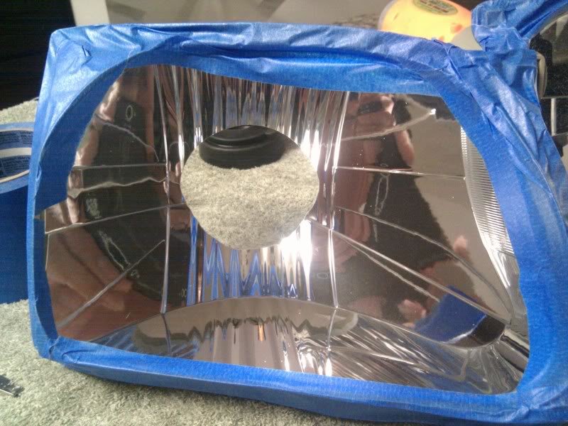

    how much of the headlight assembly did you have to chop out?
    so the shield needed alot of trimming too?

    it will look something like this after cutting.
    I'm not done since the way most people mount it using the 4 bolts do not seem like they will hold up to prolonged vibration.
    If you're planning to do this.. do yourself a favor and buy a set of brand new replacement OEM style hosings from Amazon for like $55/pair. the quality is pretty darn good. I wouldn't dare do this to my OEM Toyota ones.

    mine are the mini gatling gun shrouds that come included with the kit.

    RYU, thanks for the pic.....i'm definetly getting the mini kit....i don't have the patience/skill to delicately cut up the light like that lol

    np. it was a lot more work than I expected. i do a ton of night driving so i'm hoping it will be worth it. i'll have about 6-8hrs total into the project once i'm done. :(
