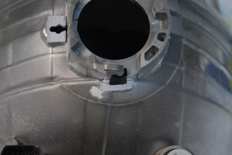

    The question I can not seem to find the answer to, well two actually, is how do you know where to drill the holes to get a good horizontal alignment and second, do you have to cut out the lower section of the bowl out to fit the wires or is this for the projector itself??

    Tough question for the first one. I put the projector in the bowl and lined it up the best I could using the horizontal and verticle lines in the chrome portion of the bowl used for projecting the Halogen light beam. Believe me this was the hardest part of the install. Basically the second point of no return.
    The notched out square that you feed the wires through will be there when yoy remove the halogen shroud.

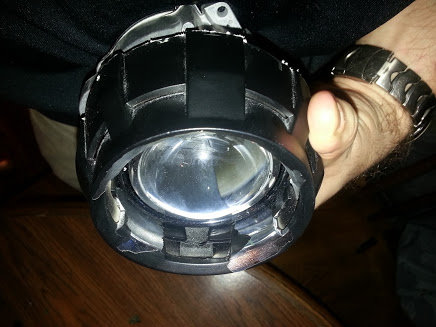

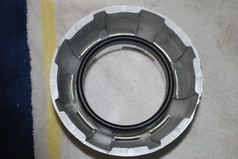

    I have the first projector roughly mounted to the first bowl, but now yet glued in & have run into some shroud fitment problems.
    Did you guys use the centric rings when installing the shrouds? My gattling shrouds are lose by about a centimeter without them. But when I put them on the FX-R's the tabs inside the shrouds barely fit & I can't slide the shroud down to get the lens somewhat even with the top of the shroud. If I push any harder, I'm sure the tabs inside the shroud will snap off, and even then I think the inside diameter of the shroud will still be to small. I've already trimmed half an inch or so off the bottom of the shroud. This is the case with the mounted projector as well as the one just sitting on my table.
    Any thoughts?

    Yes I used the shroud rings and I used the high temp sealant to glue them to the projector and the shroud. I did not want them vibrating off the projector. The bead of red, in the pictures, is the high temp sealant.
    Is this the information you were looking for?

    How close was the inner rim of the centric ring to the top of the shroud? The closest I can get it is about an inch apart, if I try and slide the shroud on any further I'm sure I'll snap the tabs on the inner part of the shroud. I was planning/expecting to have the inner rim of the shroud somewhere between flush with the lenses and about a centimeter from it.
    It was all I could do in those photos to keep the shroud on with my gut & one hand while taking the photo with the other. If I let go, the shroud will pop off and get a couple inches of height easily. Even if I did clamp it down for gluing I don't think it would be good for long-term durability. The centric rings positively latch into place & I was expecting the shrouds to do something somewhat similar, or at least a firm fit that needed to be glued in place.
    P.S. Even scuffing, cleaning really well, priming, then painting isn't enough. You need to remove the chrome from the shrouds with bleach or oven cleaner it looks. Sadly the massive chipping & flaking of the paint is even worse in person than the photos. Will work on that after I get the mounting sorted out.

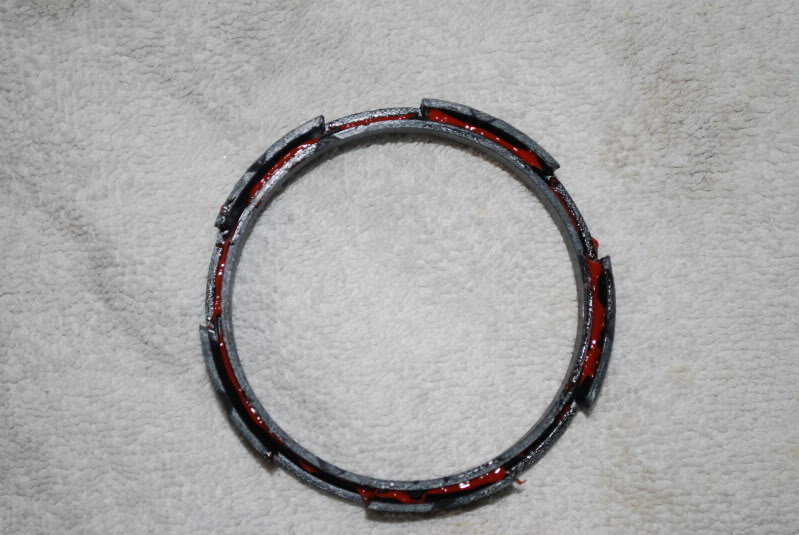

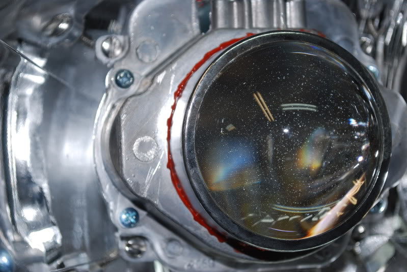

    Here are two pics of the ring pressed on the shroud and the ring is seated all the way down into the shroud.
    When I put the shroud on to the progector the shroud was seated right down to the surface of the projector. During the course of my research I had read a few instances where guys had to remove some of the back portion of the shroud to make it fit into the reflector bowl and at the same time be fully seated on the projector. That was not the case with my retrofit.

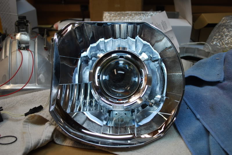

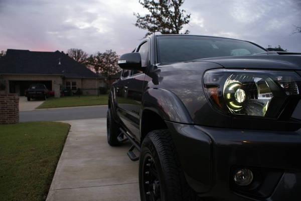

    This pic, not the best due to the CCFL being illuminated, shows the shroud on the projector sitting in its final resting place in the reflector bowl.
    I still felt the shroud might vibrate off so I did use the high temp sealant to glue it into place. So far I have not had any issues after 9 months of driving around.
