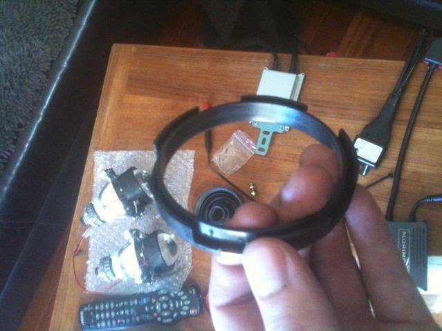

    where do these go?
    please no butt jokes

    inside the shroud there the shroud centric rings

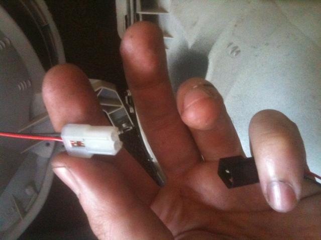

    ok, that was an easy one... how about the 2 plugs that dont fit when wiring together the mini retro...

    no that was easy, i just disassembled the thing and got it through without drilling...
    my questions is I got both projectors, one with a white plastic end and the other with a black one...
    the black one fits into the wiring harness but the white one has no where to go...
  17. May 3, 2011 at 5:15 PM
    #777
    takaya49
    takaya49 Pacific Rim Mushrooms
    May 27, 2008
    #6909
    242
    Brent
    Vancouver BC
    tacos
    Fox C/O long travel shox with resi, piggy back fox rears, TC UCA's, ICON AAL, Addicts/17 toyo MT, Mr. Marv set up,
    here is a pic of each projector end piece from each projector

    That white connector is backwards. Use a small precision screwdriver and push the metal pins out of the harness and reinsert through the other rounded ends. I disconnected/reconnected mine when i fed the wires through the bowl instead of cutting/soldering the wires back together.
  19. May 3, 2011 at 5:57 PM
    #779
    takaya49
    May 27, 2008
    #6909
    242
    Brent
    Vancouver BC
    tacos
    im an idiot... just figured it out before i read the post... exactly why I shouldnt be doing these things...
