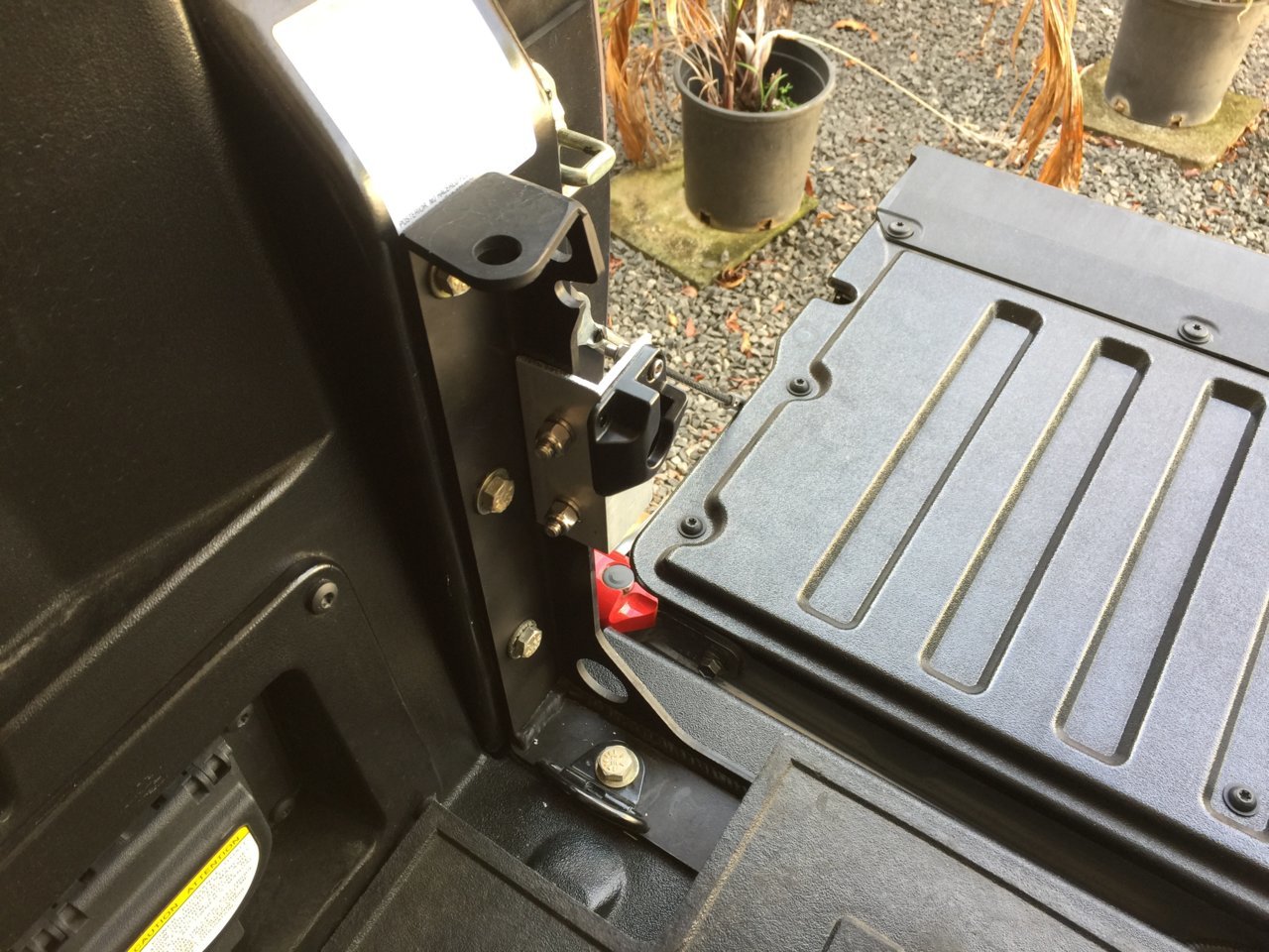

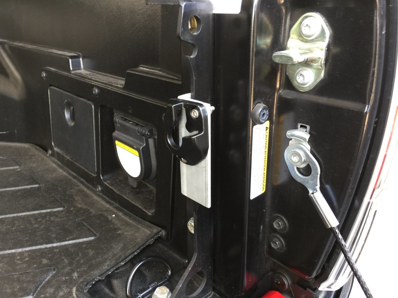

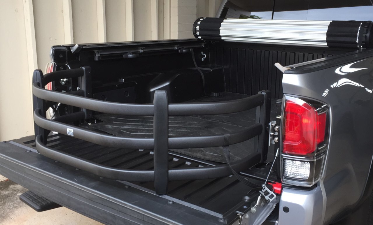

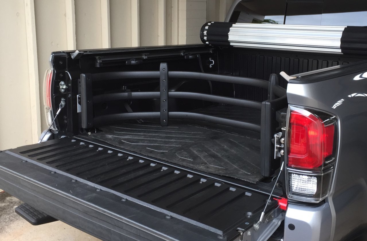

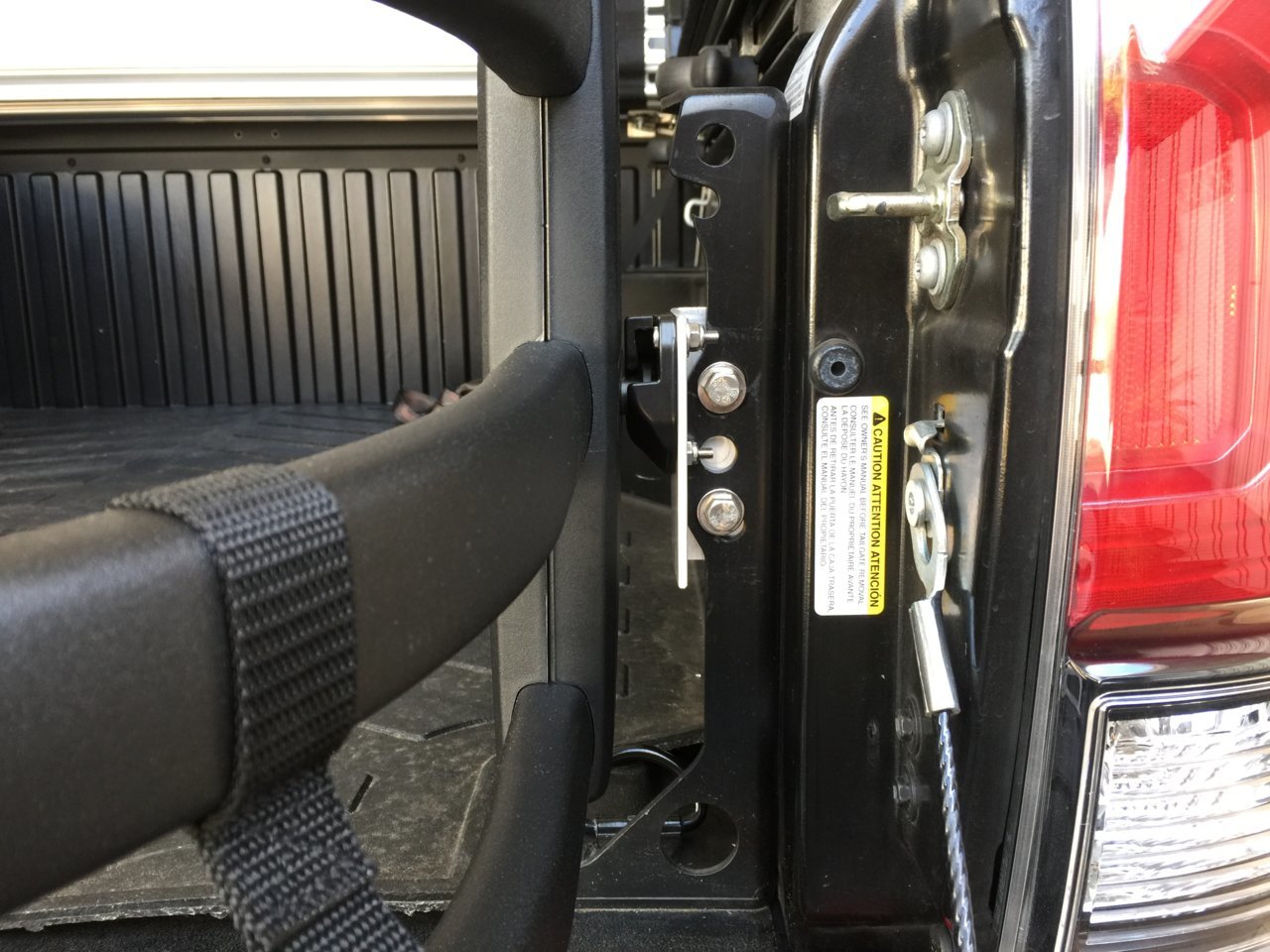

    This is another take I used to mount my Bed Extender (AMP Research). I am using ATH Bed Stiffeners. Luckily I was able to use the existing holes (mid tie down points) which didn't bother me as I can still use the top and bottom. I got some aluminum angle cut down to size to use as brackets, used stainless steel bolts, nuts and washers. You can drill holes in your bed stiffeners if you don't have any but I am not sure how comfortable you would be doing that. I would have drilled them if ATH didn't have any. The bed extender width can be adjusted to accommodate the narrower opening because of the bracket. The link that Malvolio provided gave me the idea. Sorry for the large photos.

    Mokeiko, great mod. As I also have ATH stiffeners, I'm going to copy your idea : ). What dimension angle did you use? Looks like 1 1/2 x 1 1/2. thx.

    You are correct. 1-1/2 x 1-1/2 aluminum I picked up from a local hardware store.
