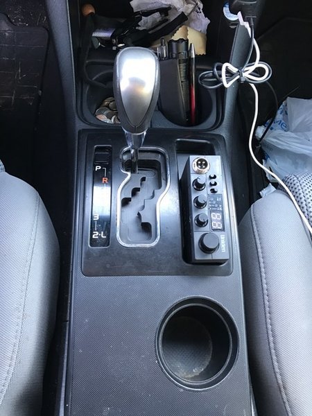

    Loved the idea when I first saw it had to give it a shot. Turned out pretty good.

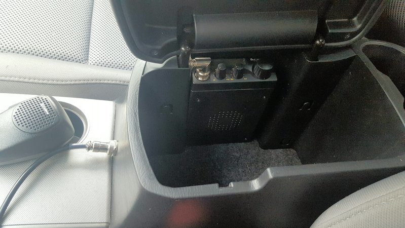

    I have this same setup! what size drill bit did you use for the mic going inside the armrest?
  17. Mar 7, 2017 at 7:56 AM
    #117
    mattgecko
    mattgecko The LED Lighting Guy. MattGeckoLEDs.com
    Jul 5, 2011
    #59337
    13,093
    South San Jose, CA
    2011 DCSB O.R. 4wd TRD Super Charged
    I probable used a large unibit.
