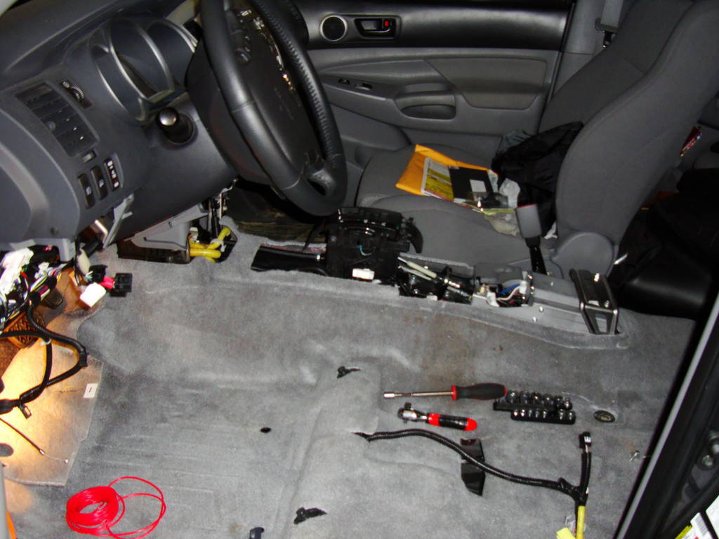

    Step 1:
    Disconnect the battery!!!
    Tear your interior apart: seat, lower dash, center console....everything.
    Honestly, it's not that difficult.
    Remove the seat and unplug the harness underneath.
    Center Console:
    Pull up on the cup-holder basin to remove it.
    Unscrew the shift knob and unclip the center gearbox cover and remove the (4) black screws.
    Lift the carpet-thing inside the storage box and unscrew the (2) bolts.
    The whole center console assembly should separate and pull apart with a little finesse.
    Lower Dash
    Pull out the little storage bucket :)notsure:) to the right of the steering wheel.
    Flip down that little panel to reveal a hidden bolt (+10 INT).
    Pull the scuff-plate trim up.
    Remove the foot-rest thing right by the Parking Brake.
    Unscrew the rubber cap-screw and remove the lower kick-panel.
    Remove the (2) bolts and "gently" pull out to unclip the lower dash assembly.
    Unplug any connectors.
    Don't forget about the TPMS plug and hoot-latch cable.
    You have successfully gutted the driver's seat area. Drink a beer :cheers:

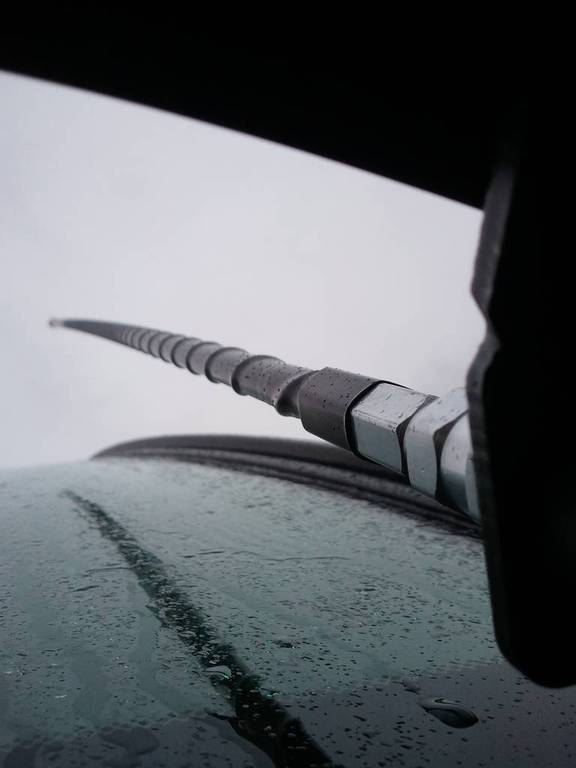

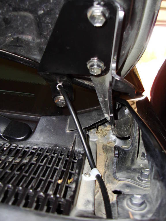

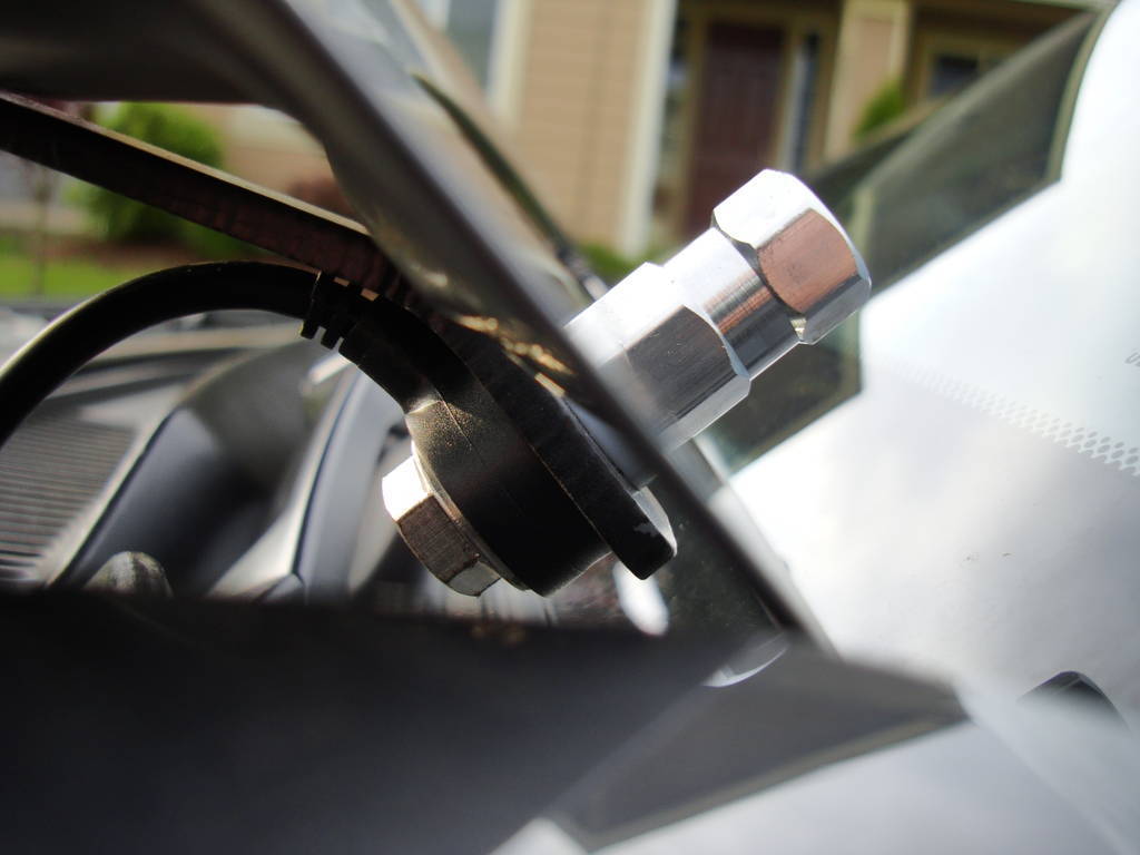

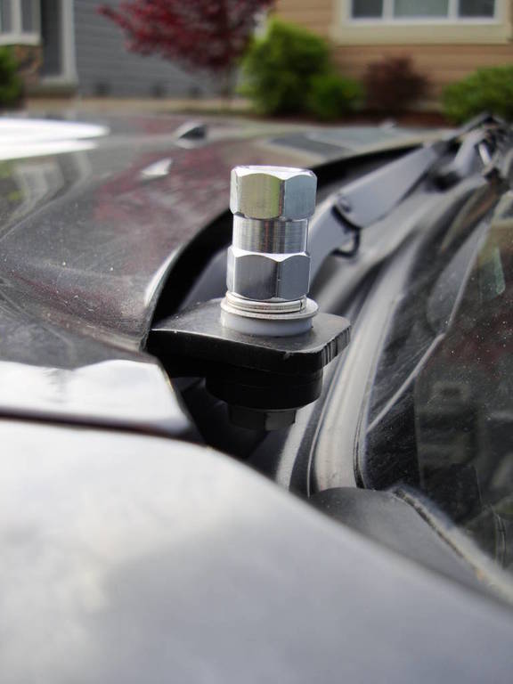

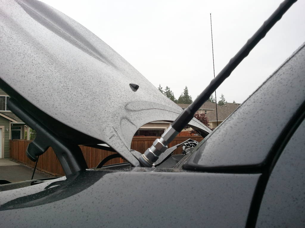

    Install the Relentless CB Antenna Mount. Don't undo both the hood bolts. I removed the top hood-hinge bolt first, and bolted up the antenna mount, then followed with the lower bolt. That way your hood won't shift.
    Install the Firestik Stud Mount using the longer 1.25" bolt that was included with the Coax. Follow the order printed on the instructions:

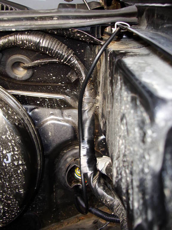

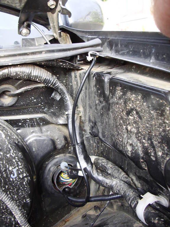

    I ran the coax under the plastic cowl, and secured it with zip-ties and electrical tap to insure it wouldn't kink or rub on any edges.
    *NOTE: There are a few sharp edges in this area so be wise where you
    secure the coax.

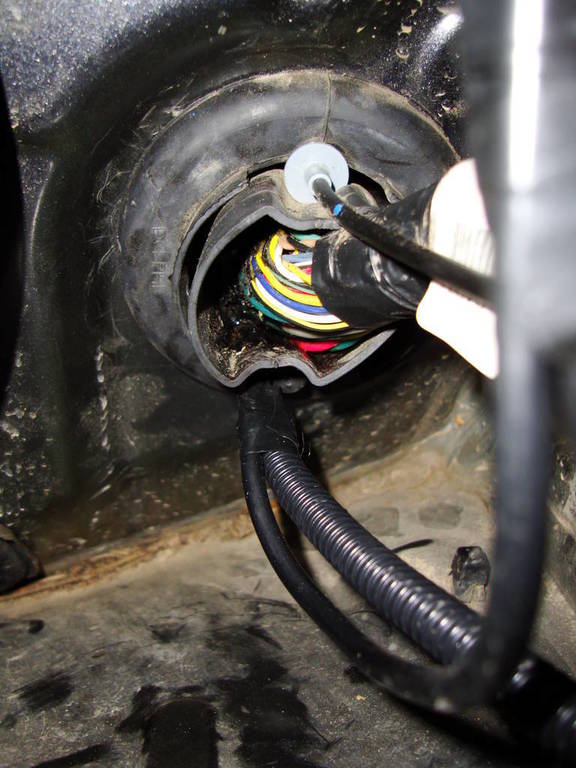

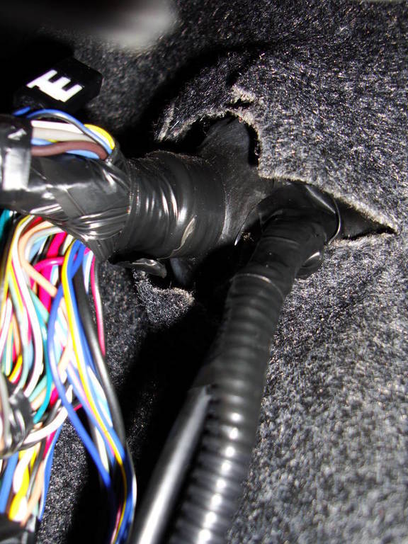

    I then poked a hole in the firewall grommet to run the coax and wires through. I found it was pretty easy to use a long screwdriver to poke through it, then widen the hole with some needle-nose pliers. I then wrapped all the (2) pos/neg leads in conduit, and taped them to the coax and gripped them with the needle-nose to pull them through.

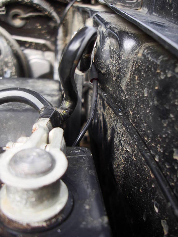

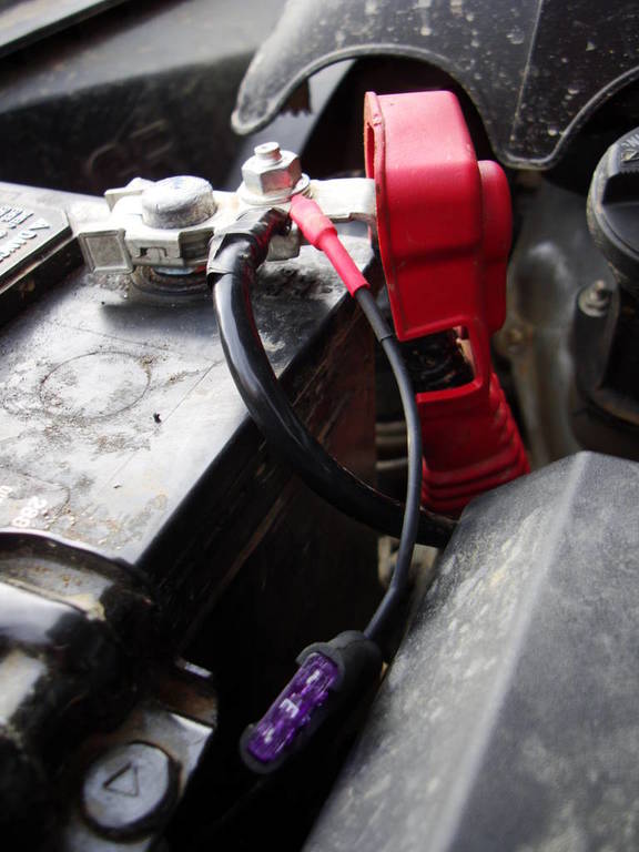

    Crimp and heat-shrink a ring terminal to your NEGATIVE wire lead and connect it here:
    Solder -or- butt connect the inline fuse holder to your POSITIVE and attach the other ring terminal to that as well and connect it here:
    *I chose to run my POSITIVE directly to the battery with a fuse in order to have CB operation even when the vehicle is OFF. This is optional, and you could always add a relay or tap into a switched power source.
    I used a 3-AMP fuse in mine, and wouldn't recommend anything higher to avoid burning out your CB.
    You should be done in the engine compartment....Drink a beer!!! :cheers:

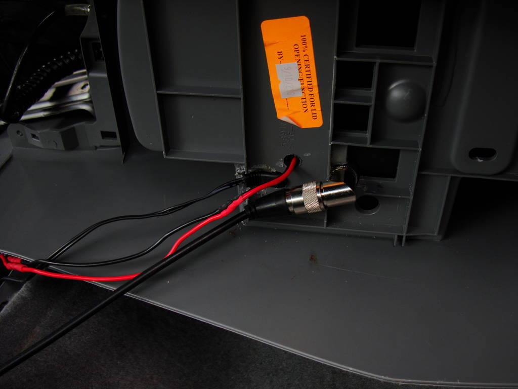

    Step 3:

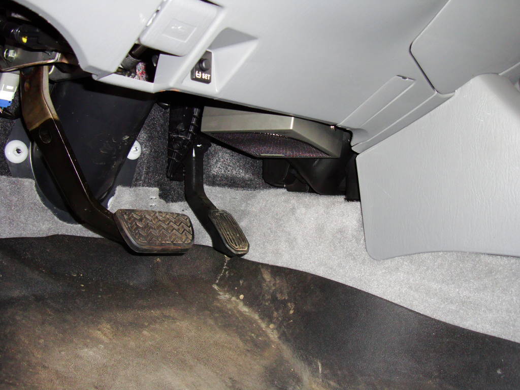

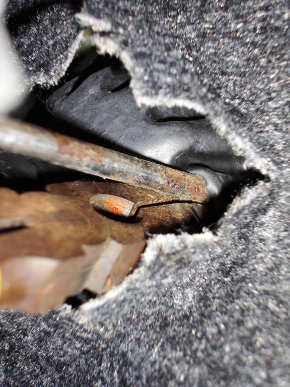

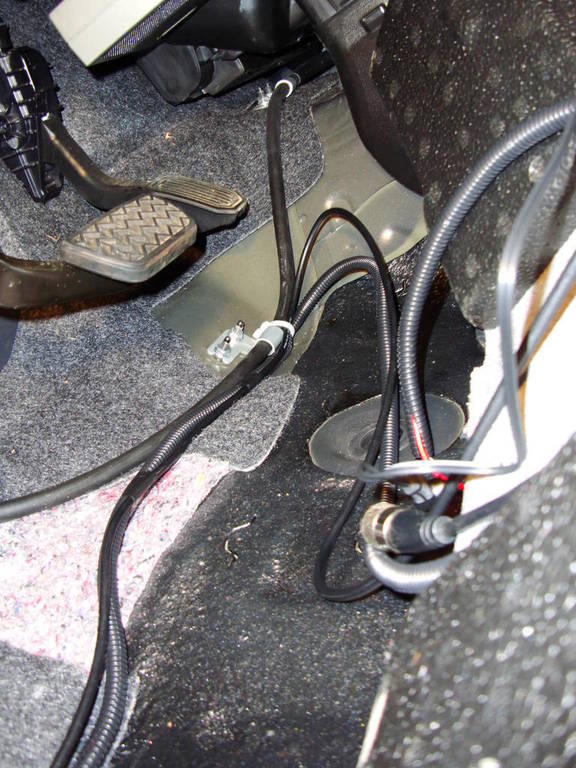

    Moving back to the interior again. I tried to wrap the rubber fire-wall grommet in electrical tape to seal it up well. After measuring the length of wire I needed, I finished wrapping the wires with plastic conduit and taped the shit out of 'em.

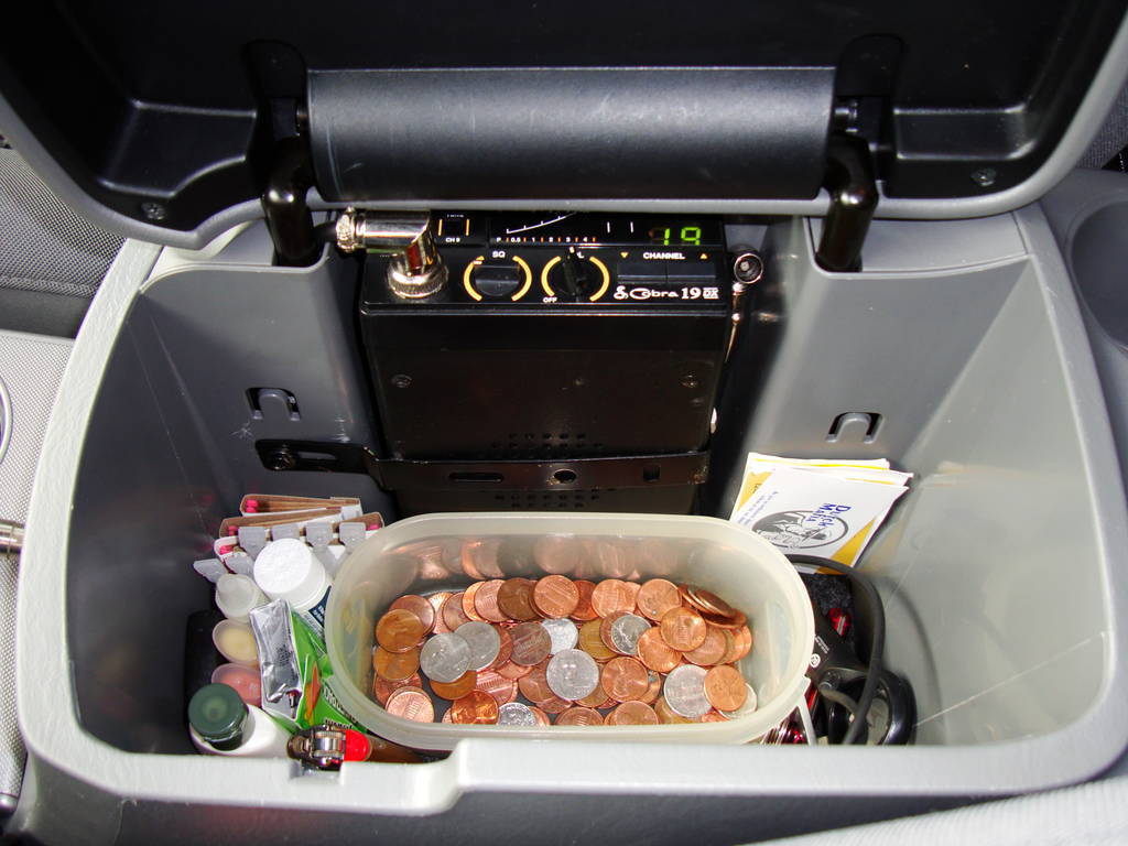

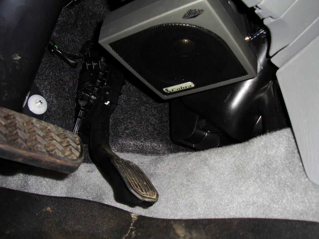

    Next, I mounted the external speaker. There were not a lot of options, so I mounted it above the gas pedal, attached the the plastic shroud panel covering the water lines. My foot clears it, but not by much.
    I pulled up the carpet to run the wires/coax underneath, and stuffed the speaker cable into the plastic conduit as well.
    I tucked it all along the inner-console area and everything was just the right length to reach it's destination.
    Now it's time to move on to drilling holes into the console box...Drink a beer :cheers:

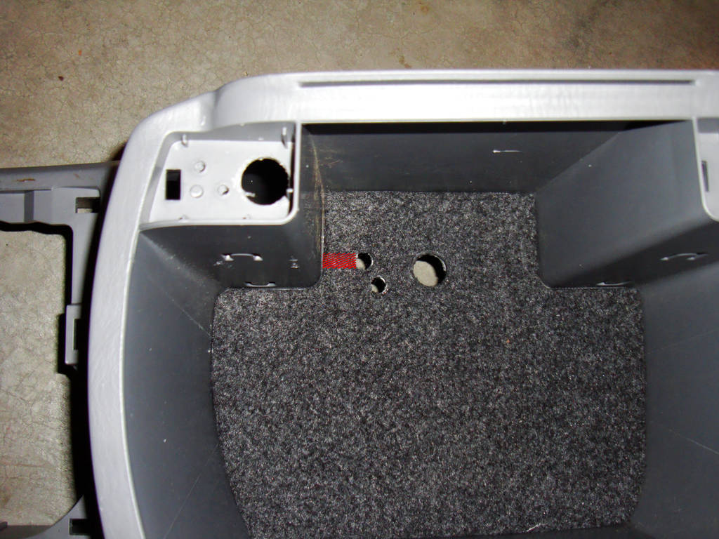

    Step 4:

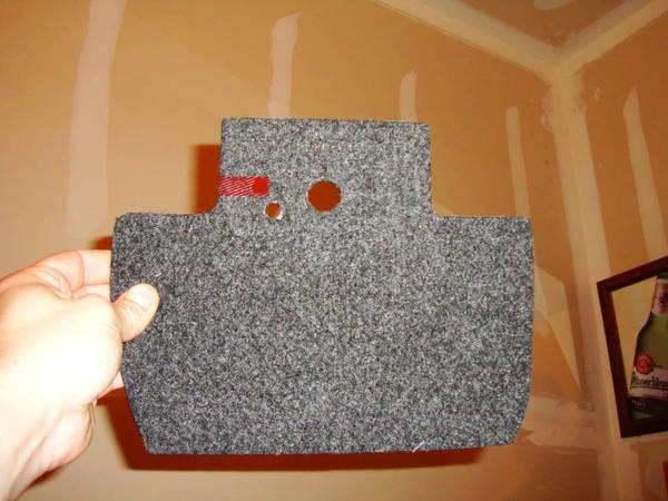

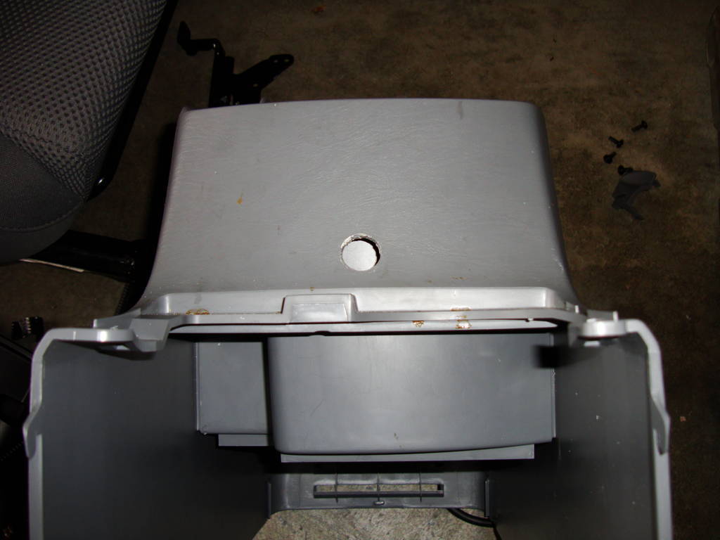

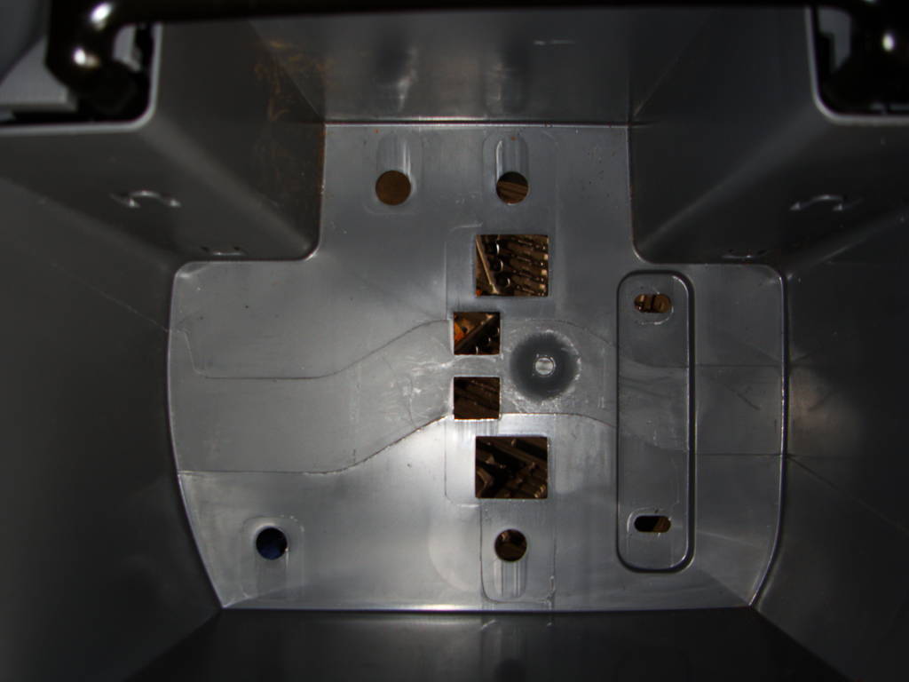

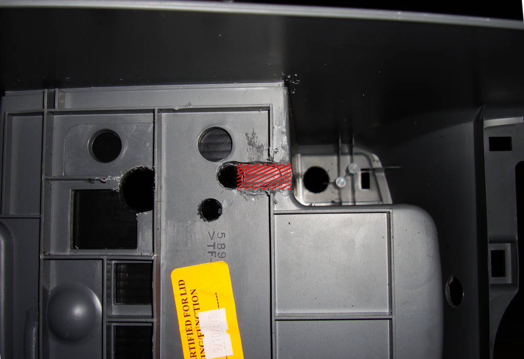

    Disassemble your storage box. Remove the lid, spring hinge assembly, the plastic corner pieces and pull out that carpet shit.
    I apologize, I didn't document any measurements for where to drill the holes, it was on-the-fly trial and error. But there are some things I would've done differently, and will note them as needed.

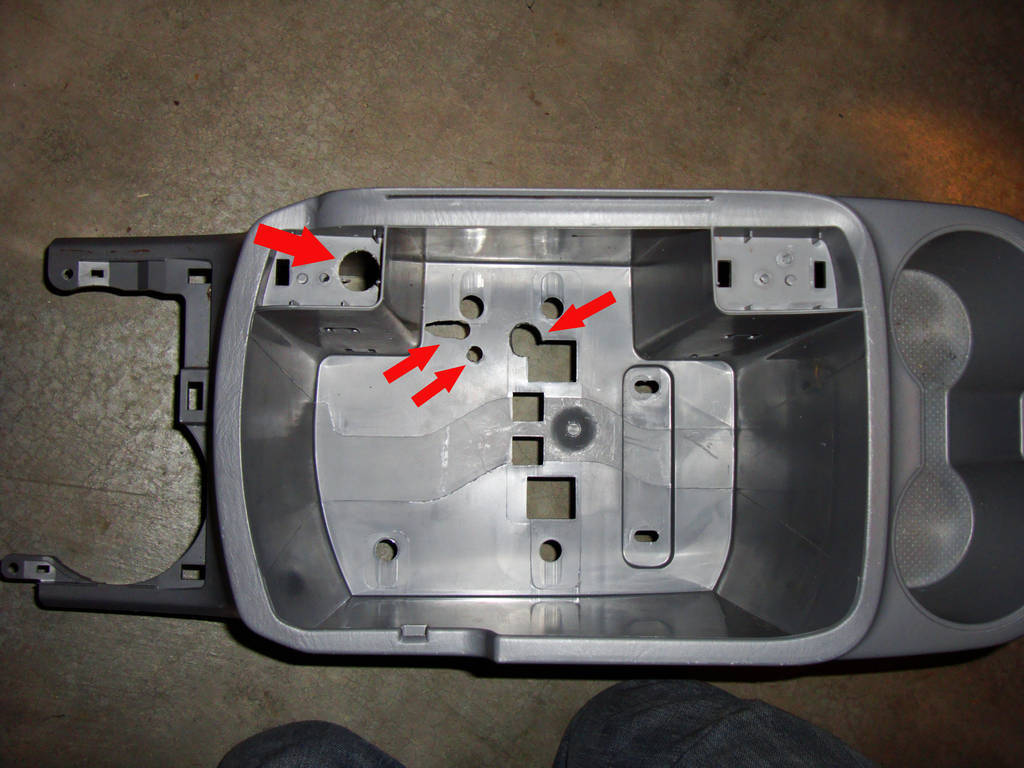

    I used the carpet piece my template, and noted where to drill. I needed holes for the UHF Antenna connector, power leads and the ext. speaker port.
    *NOTE:
    Cut out the areas in RED on the carpeted piece to make sure the speaker plug fits securely.

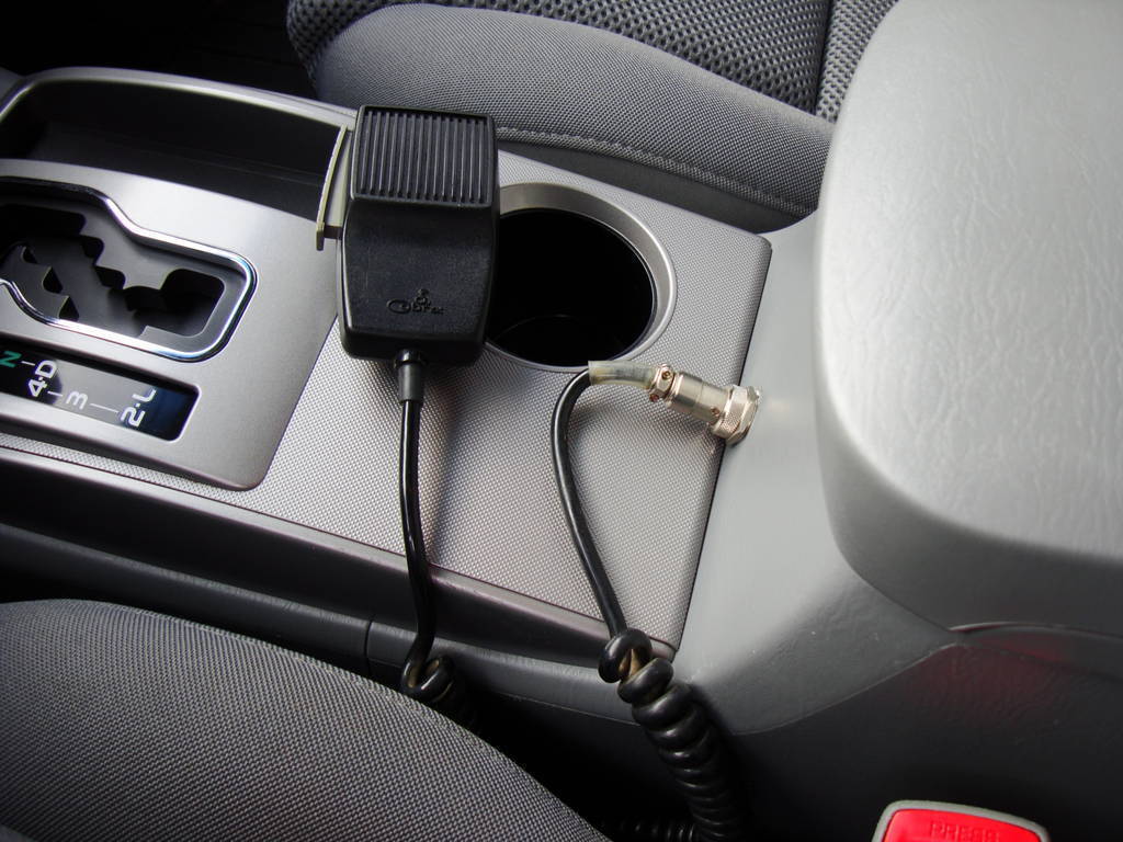

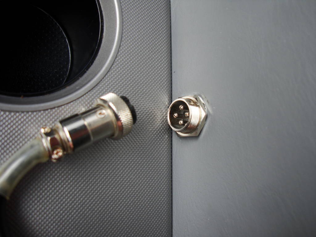

    I also had to drill out the top (right by the left hinge) to fit the microphone extension through. Here are my holes:
    Next, I drilled a hole for the microphone extension plug.
    *NOTE:

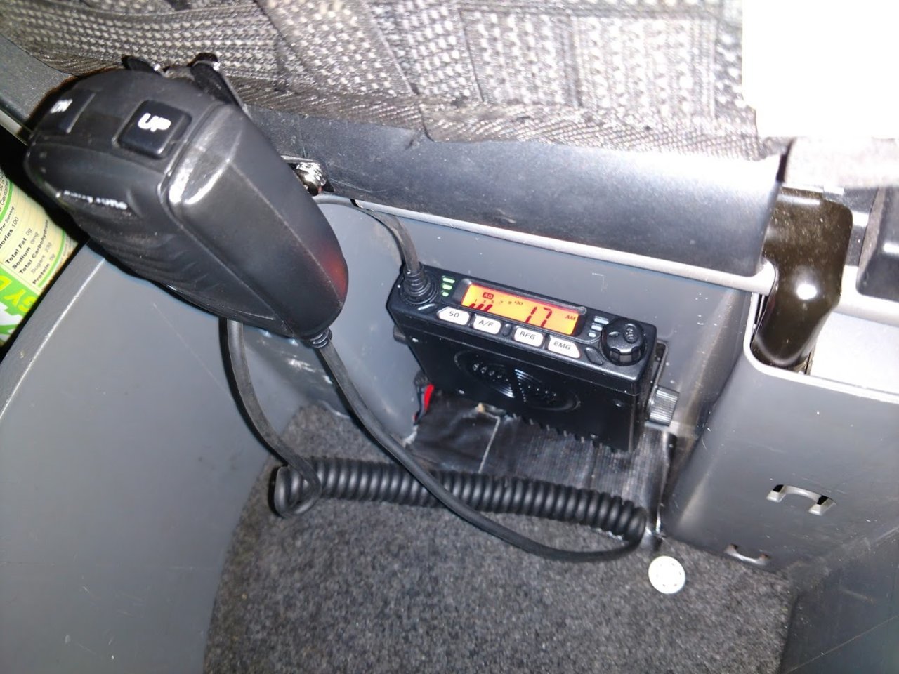

    Once again, lesson learned. The microphone plugs barely cleared the textured plastic when everything was reassembled. I would've drilled this hole 1/4" higher if I were to do it again. I lucked out that it still fits well, but it leaves little room for error.

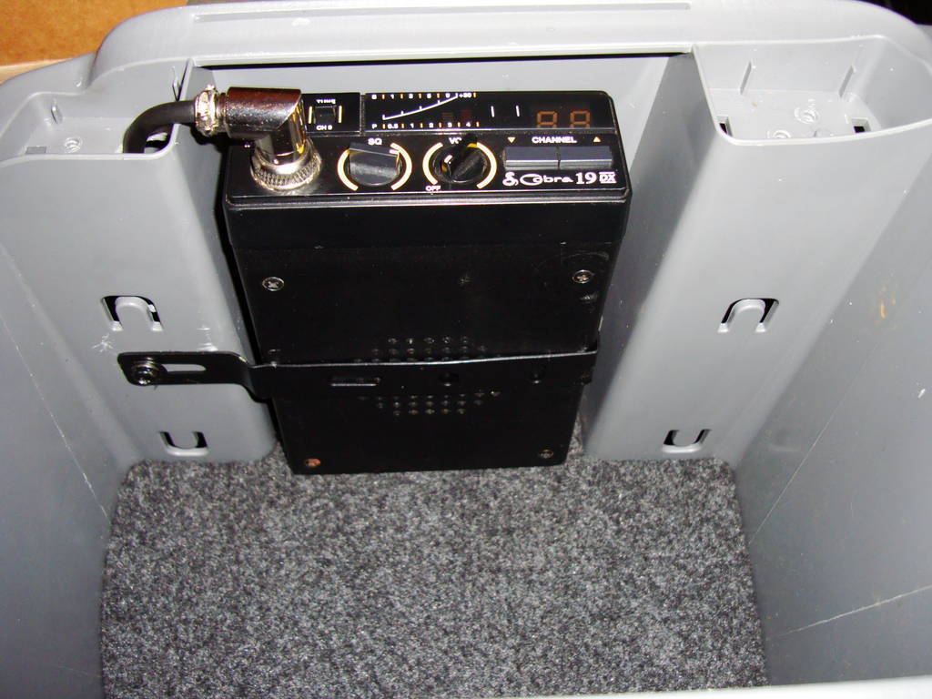

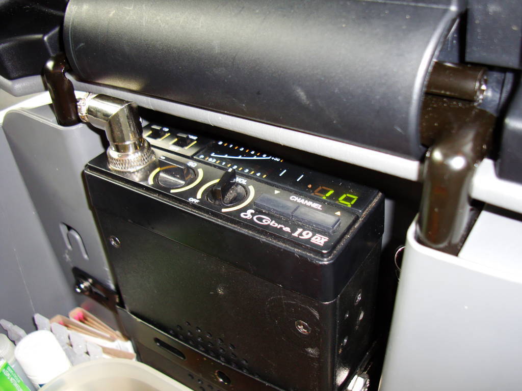

    Next I had to test fist the CB and everything lined up beautifully. I screwed the right-side of the metal mounting bracket into the CB, and bent the other side out. I drilled a small hole in the storage box, and used a small machine screw with nuts and lock washers to secure it in place.
    Once the bracket was secured, I ran my microphone extension cable, and threaded it through the hole.
    Then, I threaded the Right-Angle PL259 adapter to the bottom of the CB
    I was now ready to connect the antenna coax, POS/NEG wires, and plug in the ext. speaker (*again, I had to trim the carpet piece some more to fit the speaker plug all the way in).
    After tidying up, and making sure everything was secure, I plugged in the microphone, twisted on the antenna, and reconnected the battery. Turned it on and basked in the sweet aroma of sweat and success.....Drink 2 beers! :cheers:

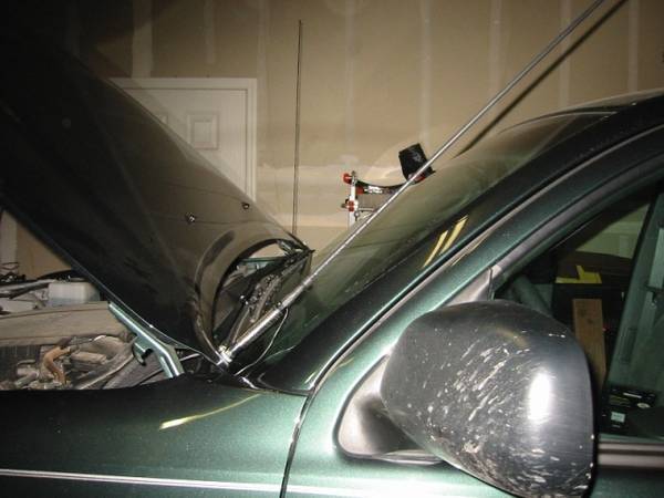

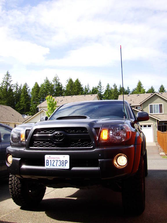

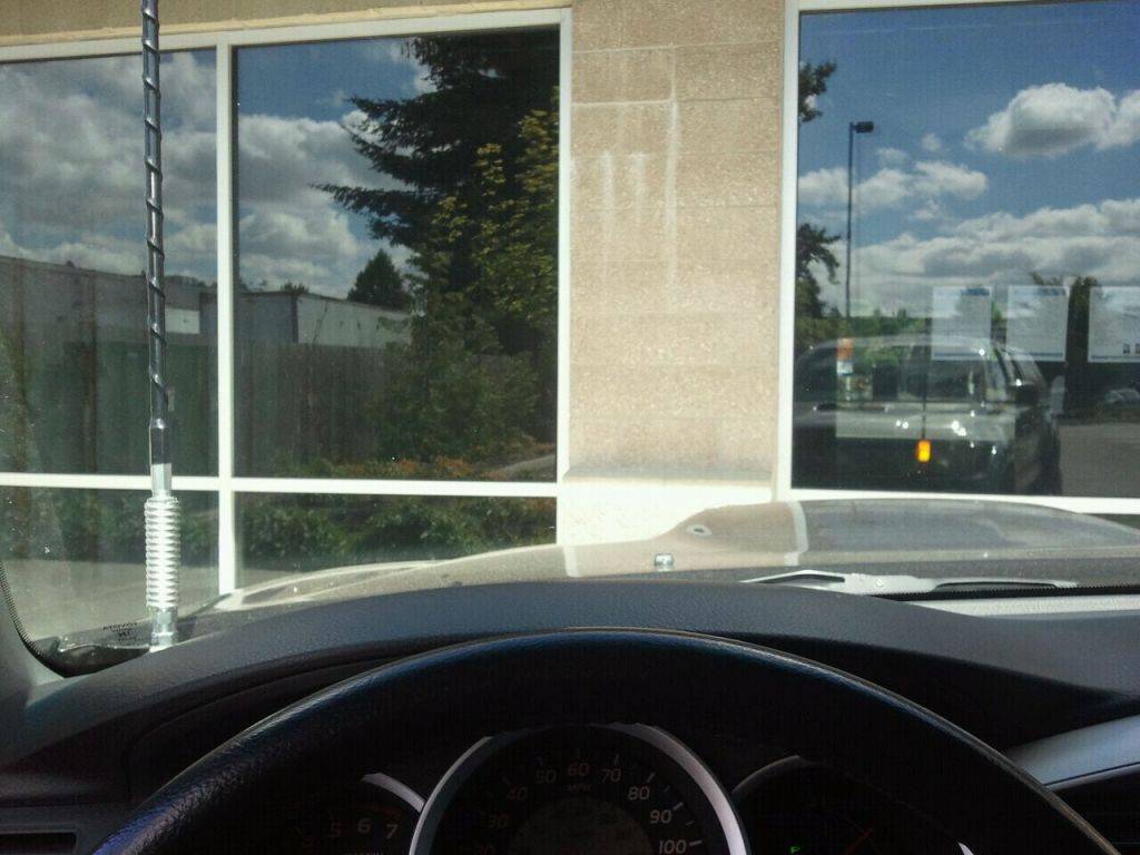

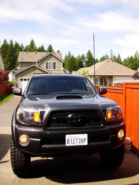

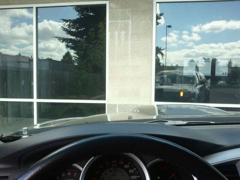

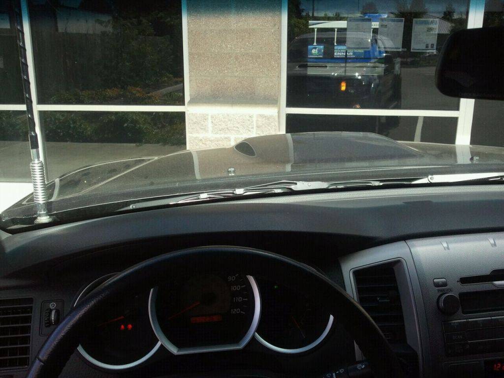

    Great write up! Does the antenna have to come off every time you open up the hood, or does it clear the windshield?
  6. Jun 4, 2012 at 5:24 AM
    LUSETACO
    LUSETACO Here for the Taco Pron
    Jun 27, 2009
    #18991
    11,315
    Dennis
    South Central Pee A
    2005 PIMP MOBILE
    Yes

    It clears the windshield just fine, I just didn't have it on when I took the pic.

    Now you need to remove your antenna to open your hood?
  12. Jun 4, 2012 at 6:35 AM
    Benson X
    Benson X [OP] My build thread sucks...
    Nov 13, 2010
    #46123
    5,678
    Ben
    Olympia, WA
    '11 MGM DC/LB
    If you don't draw blood, you're doing it wrong!
    see above ^^^
    *I will take a couple pics of the antenna mounted and the hood open. :thumbsup:

    No you don't need to remove it.

    Great job man! looks real clean and love how you wired the mic +1 for you good sir!

    That's a nice clean setup you got there. I like the mike in that spot too.
