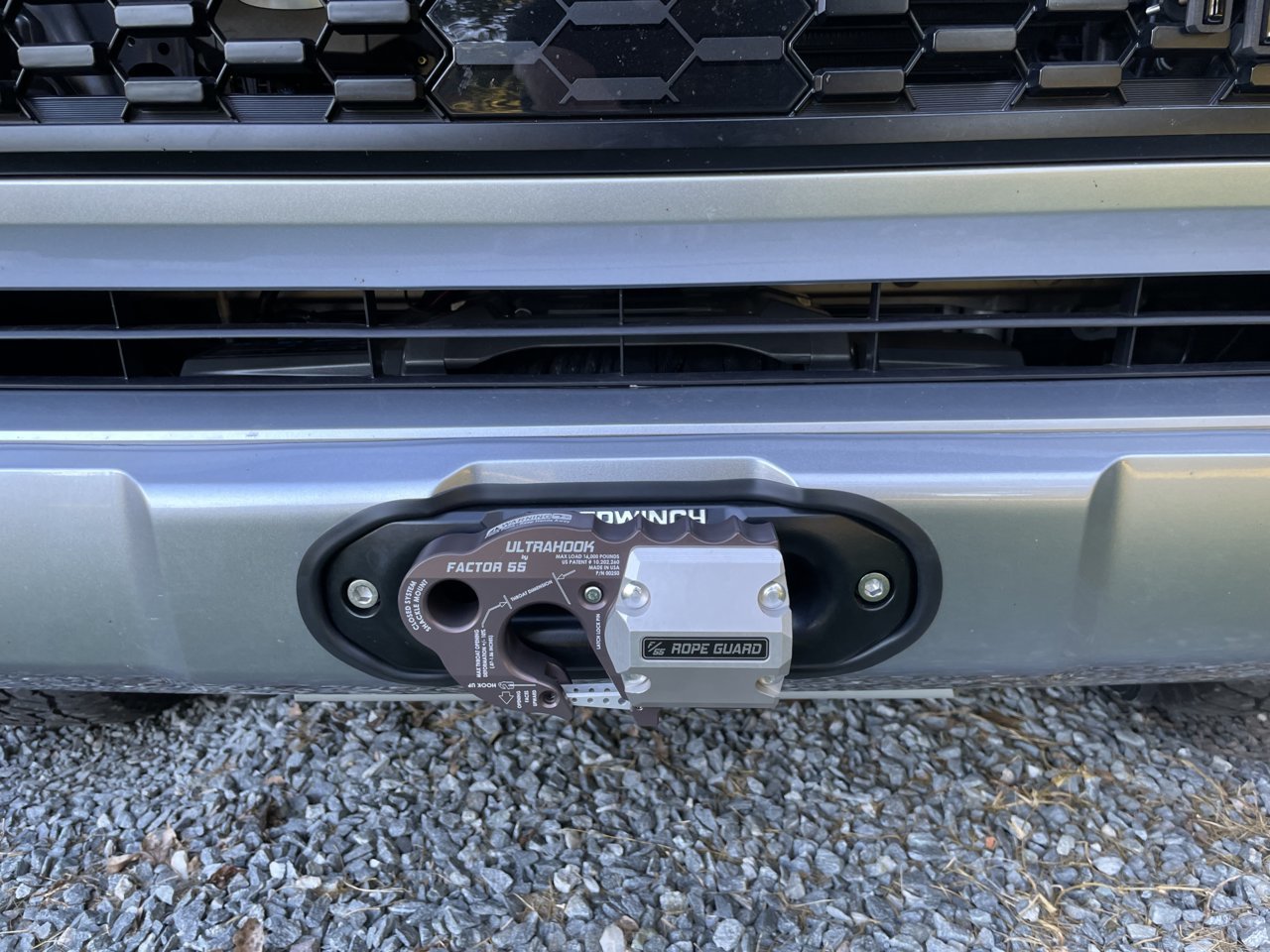

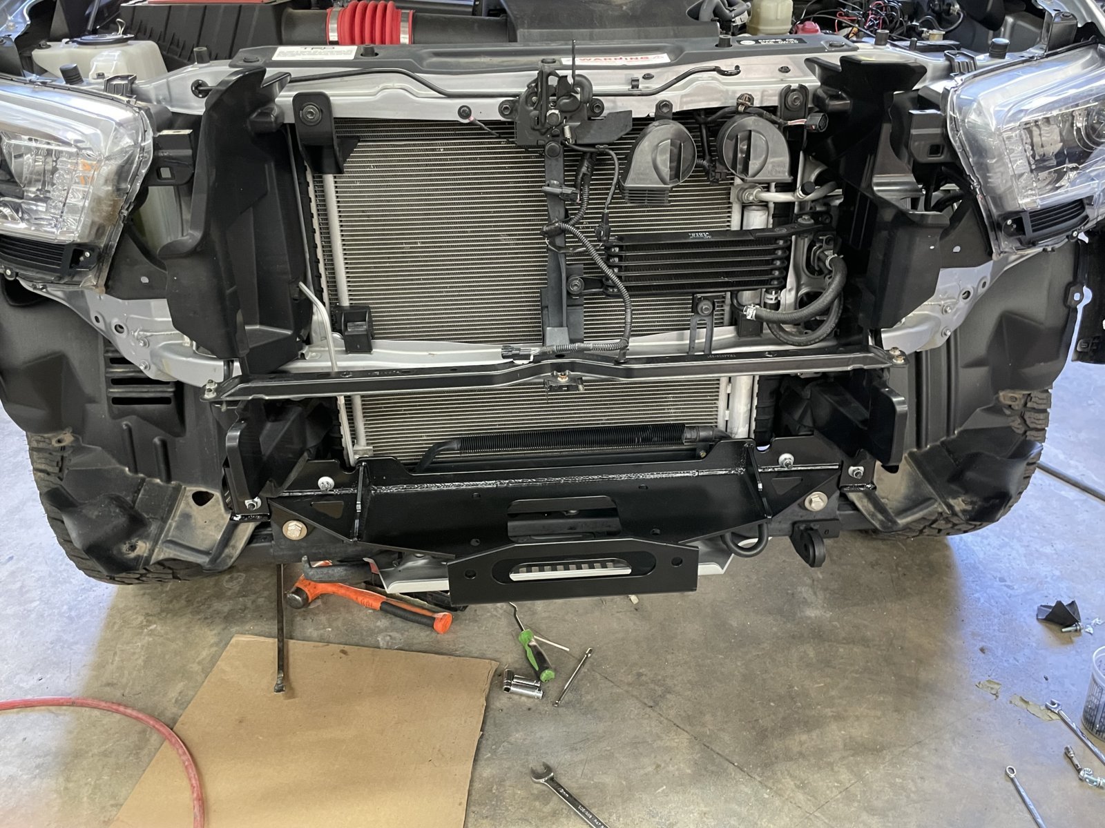

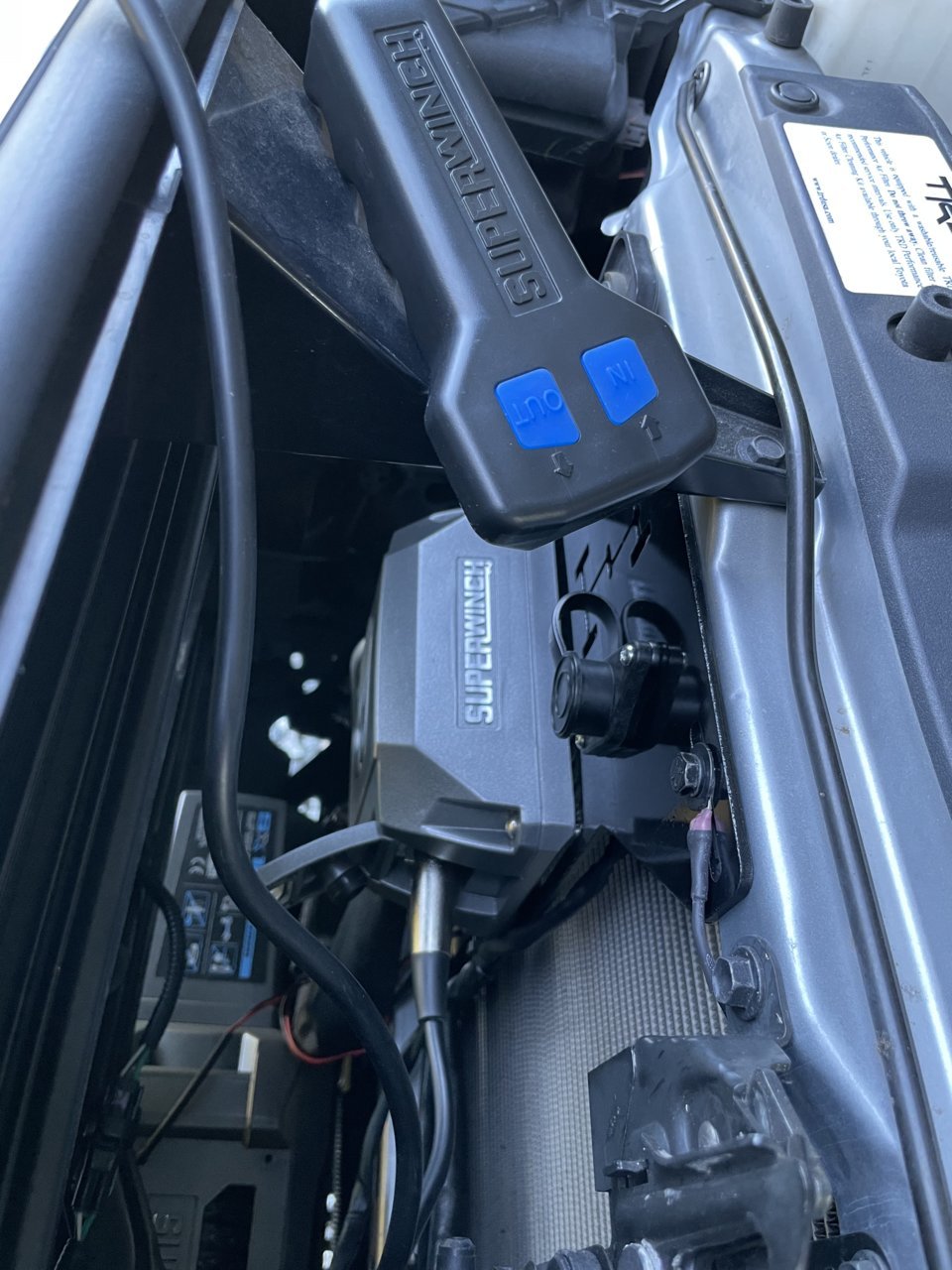

    Installed the hidden winch and wired. Test all remotes for proper operation.
    Used the Torque Engineering mount. This mounts let’s you retain the factory recovery hook. Only modification done was to grind some metal for the winch to sit flat on left side of plate.
    https://torq-engineering.com/products/toyota-tacoma-hidden-winch-mount
    Mounted the winch control box using the Manor Mount. This mount lets me hook up the wired remote with ease.
    https://shop.tandemoffroad.com/prod...oller-mount?rq=mk_toyota~md_tacoma-3g~yr_2018

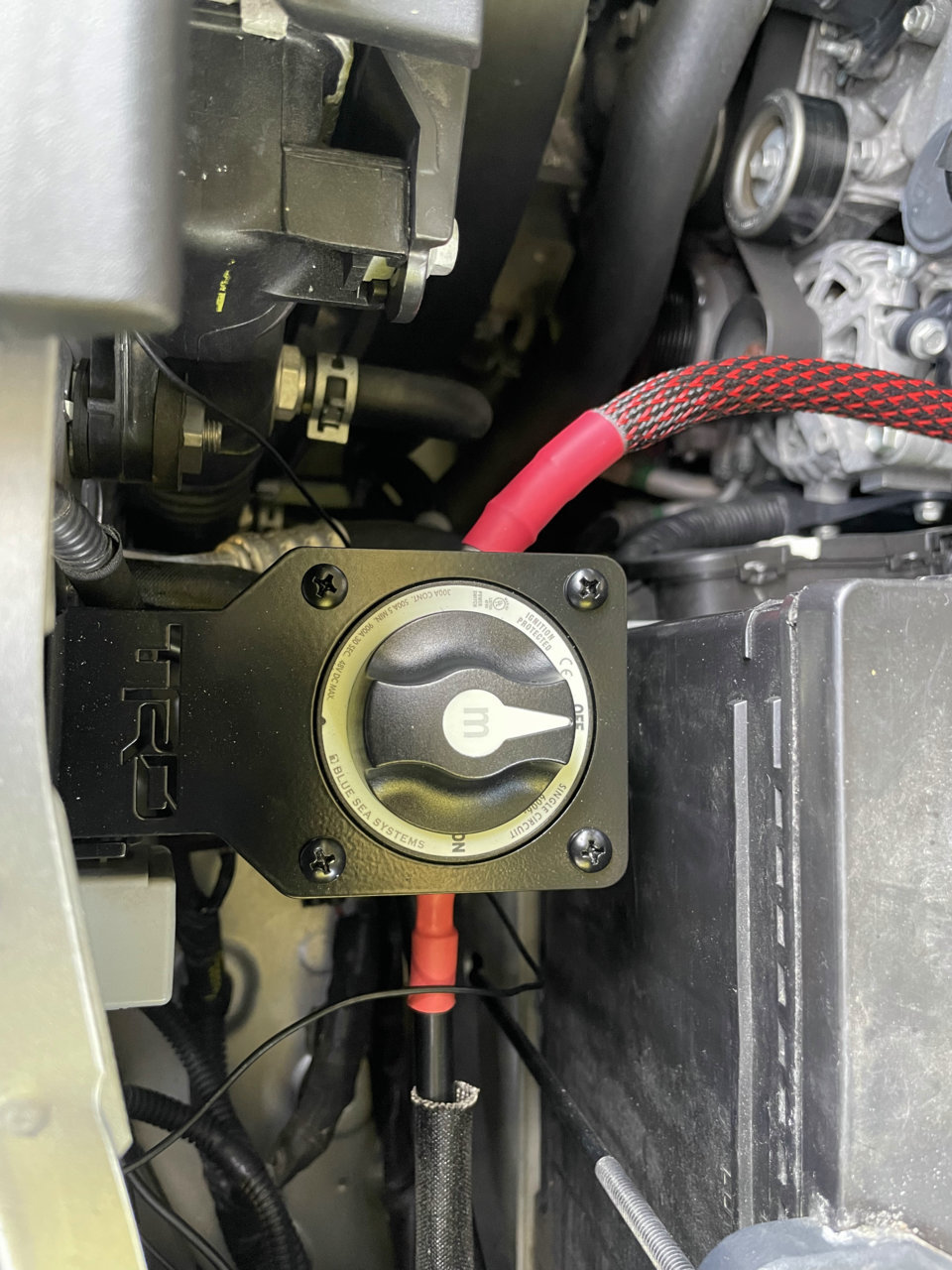

    Added a cut off switch from battery.
    https://www.lambtekinnovations.com/products/05-current-toyota-tacoma-winch-switch-bracket-kit
    SuperWinch Synthetic Rope 10,000lb with wired and wireless remotes, drum light, light in wired remote.
    https://www.superwinch.com/en/produ...0sr-12v-10000-lb-synthetic-rope-winch-1710201

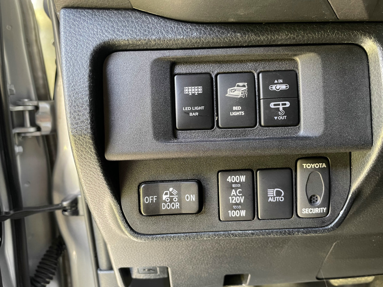

    Will be adding a dual switch left of steering wheel..
    https://www.amazon.com/dp/B092FJPXQJ?ref=ppx_yo2ov_dt_b_product_details
    Used this to trim around hawse fairlead.
    https://www.amazon.com/gp/product/B07BRYD9TQ?ie=UTF8
    Recovery Hook
    https://factor55.com/product/new-ultrahook/

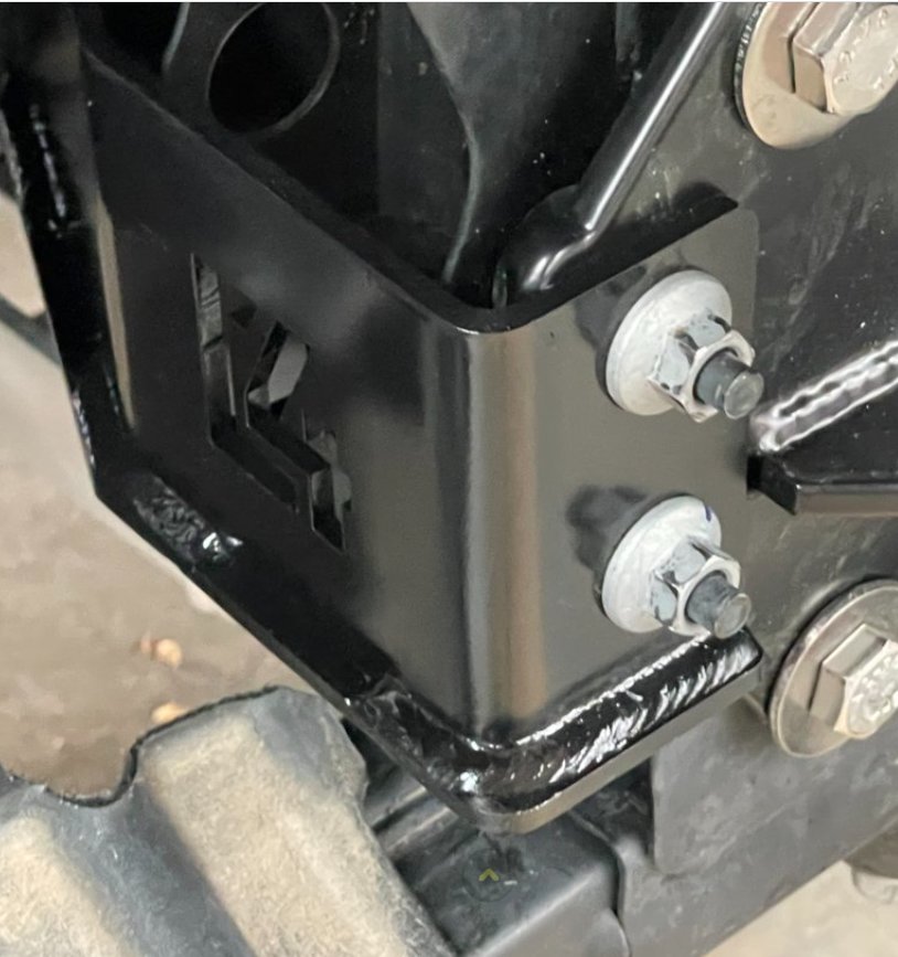

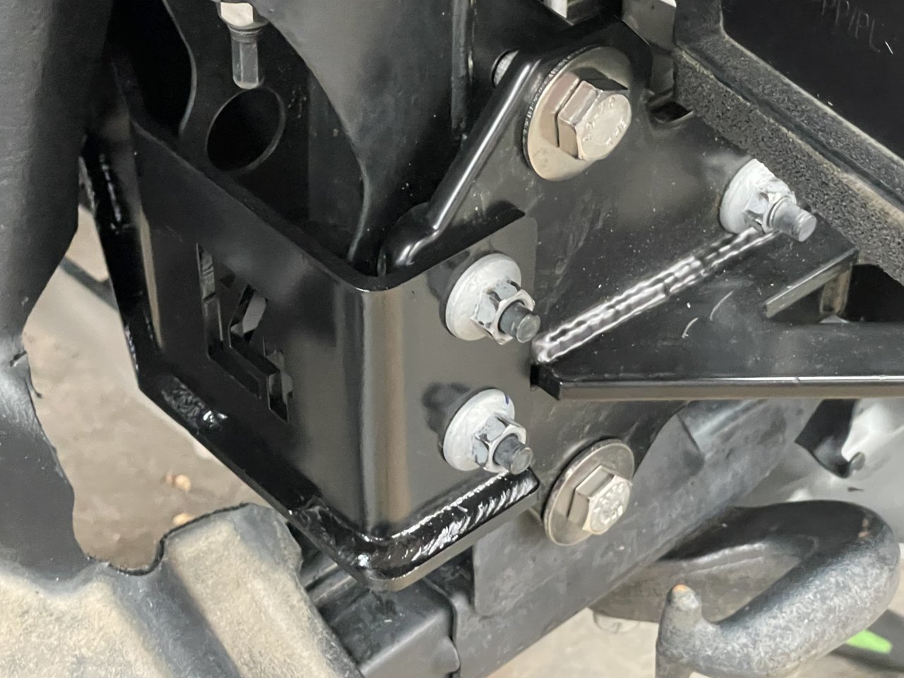

    Added these side brackets for better support when winching from the side.
    https://c4fabrication.com/collectio...nt-bumper-frame-support-brackets-3rd-gen-2016
    Before
    After

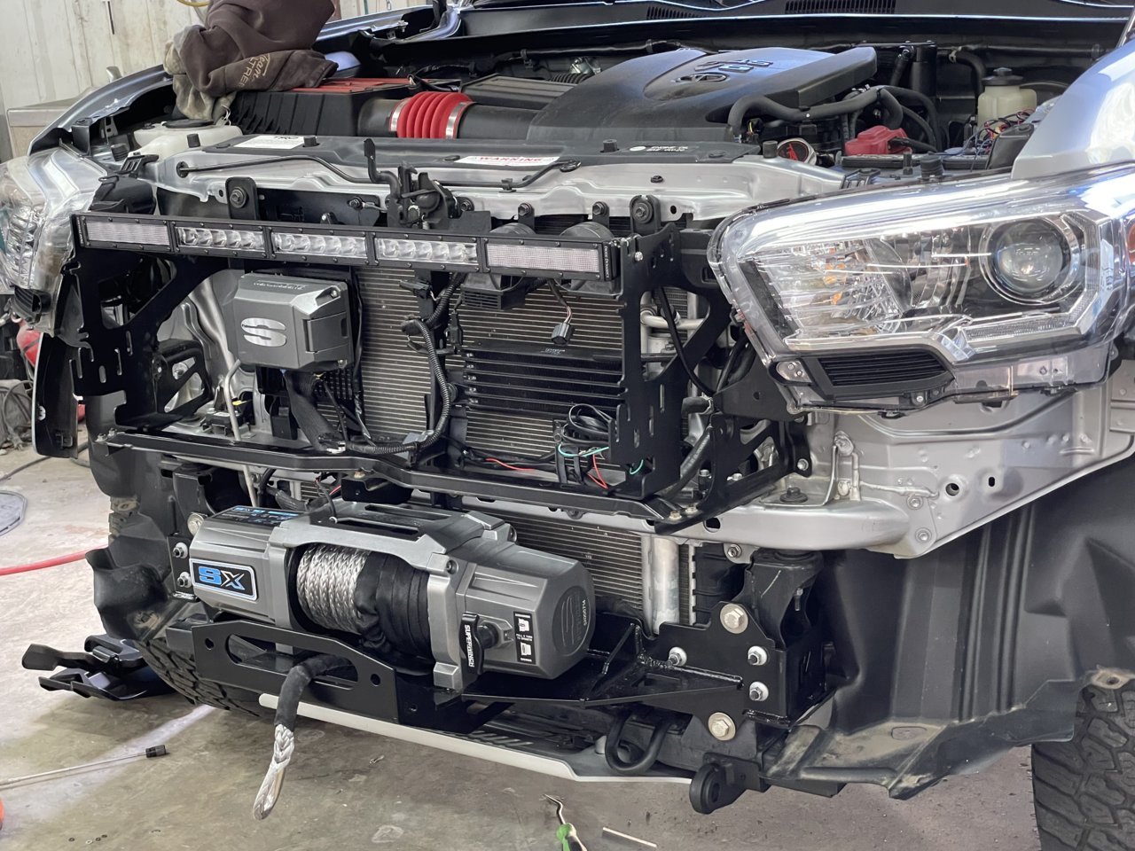

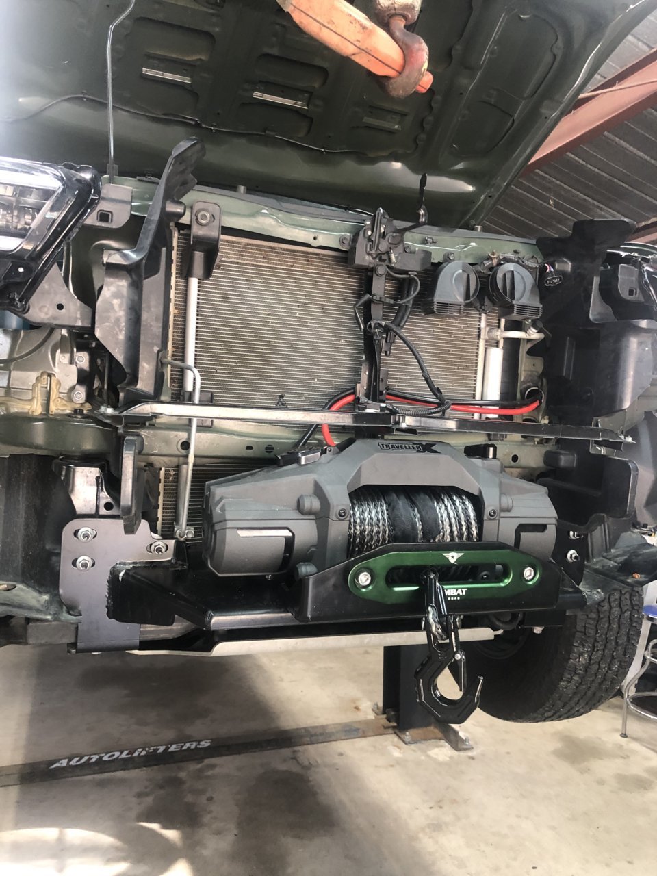

    whats the black heatsink looking thingy in the right middle of the radiator?
    i didn't think too much of it till now but do all winches mount that close in?
    these tacos don't have all that much in terms of cooling surface, my little 4cyl has the same size radiator..
    i'm curious to what effect that has when you are in arizona heat, slow speeds and winching

    The wires are for the dual switch from inside truck.

    @VicNic3 I'm wondering the same thing. Seems to be a lot of 'stuff' inhibiting air flow thru the radiator. Might be wise to monitor engine & transmission temps.

    My son has the same setup on his 19 and no problems at all in 100 degree summers at times in August in GA.

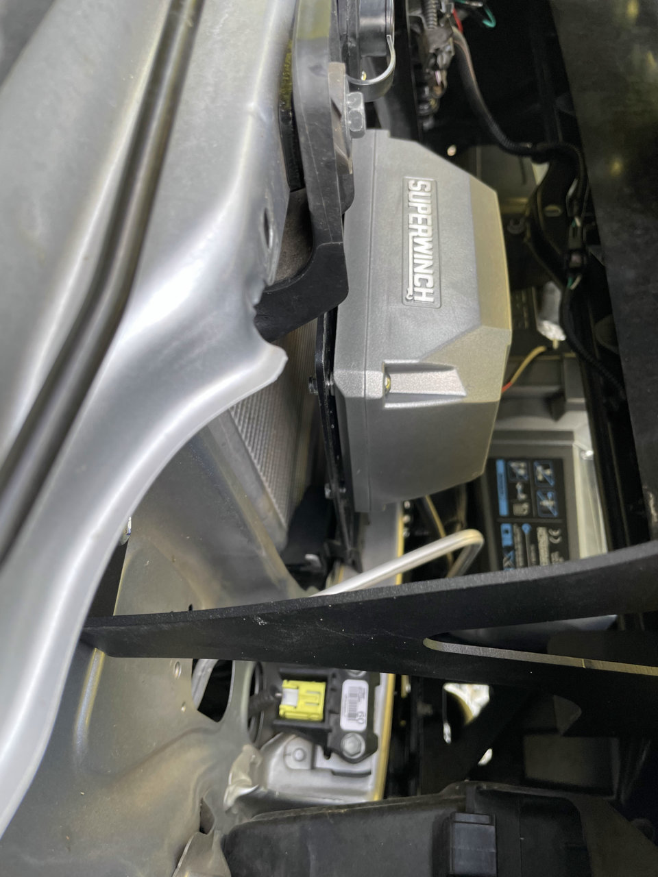

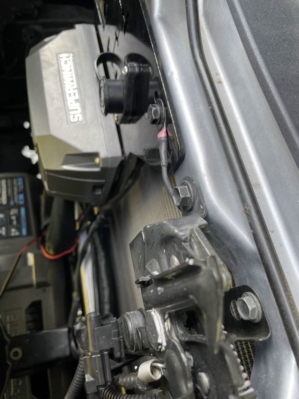

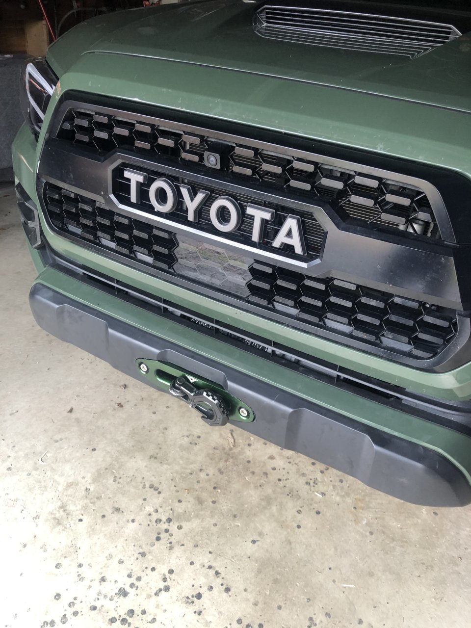

    There is a lot of room behind the piece supporting the winch control box. My son had this and no problems at all with cooling issues. Plus the lower grille is open also.

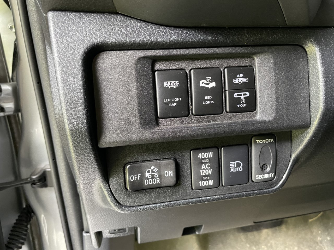

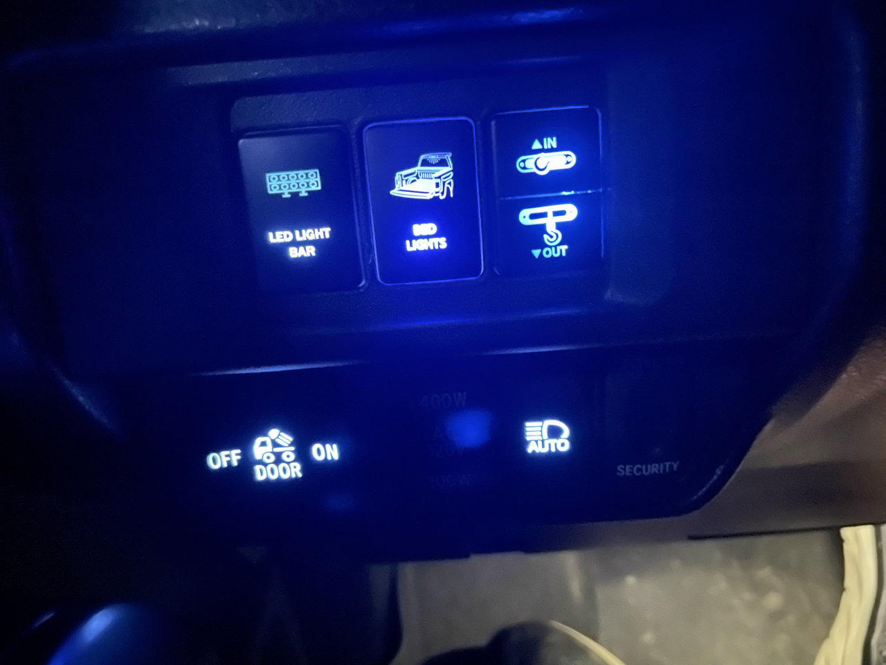

    Starting the wiring for winch switch 3F31DAE3-9A51-4D65-9382-A783C8A56620.jpgD848ECCB-495E-49B0-9D1A-0A7B6DD8AC4D.jpg

    You're not grabbing enough thread with those two outer nuts on the frame horn bolts. You need to drill them out and install longer bolts so that you have better clamping force.

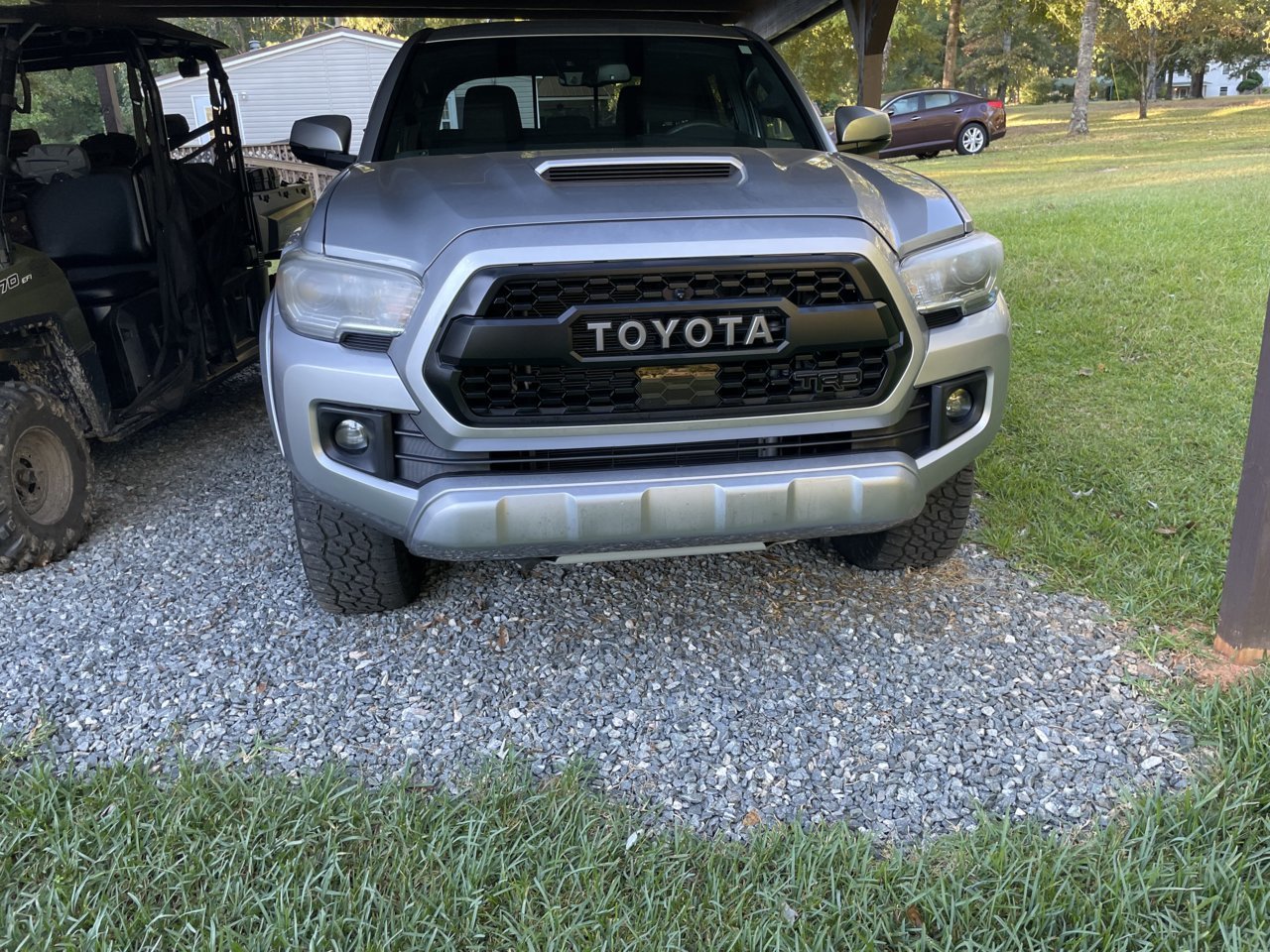

    Finished the wiring for the grille LED light bar.
    C86FCA03-6D12-4649-9EC0-2E442839B2B6.jpg 05419A64-5F12-4773-89C0-E1AA53558AE1.jpg
    Low beam lights on
    High beams on

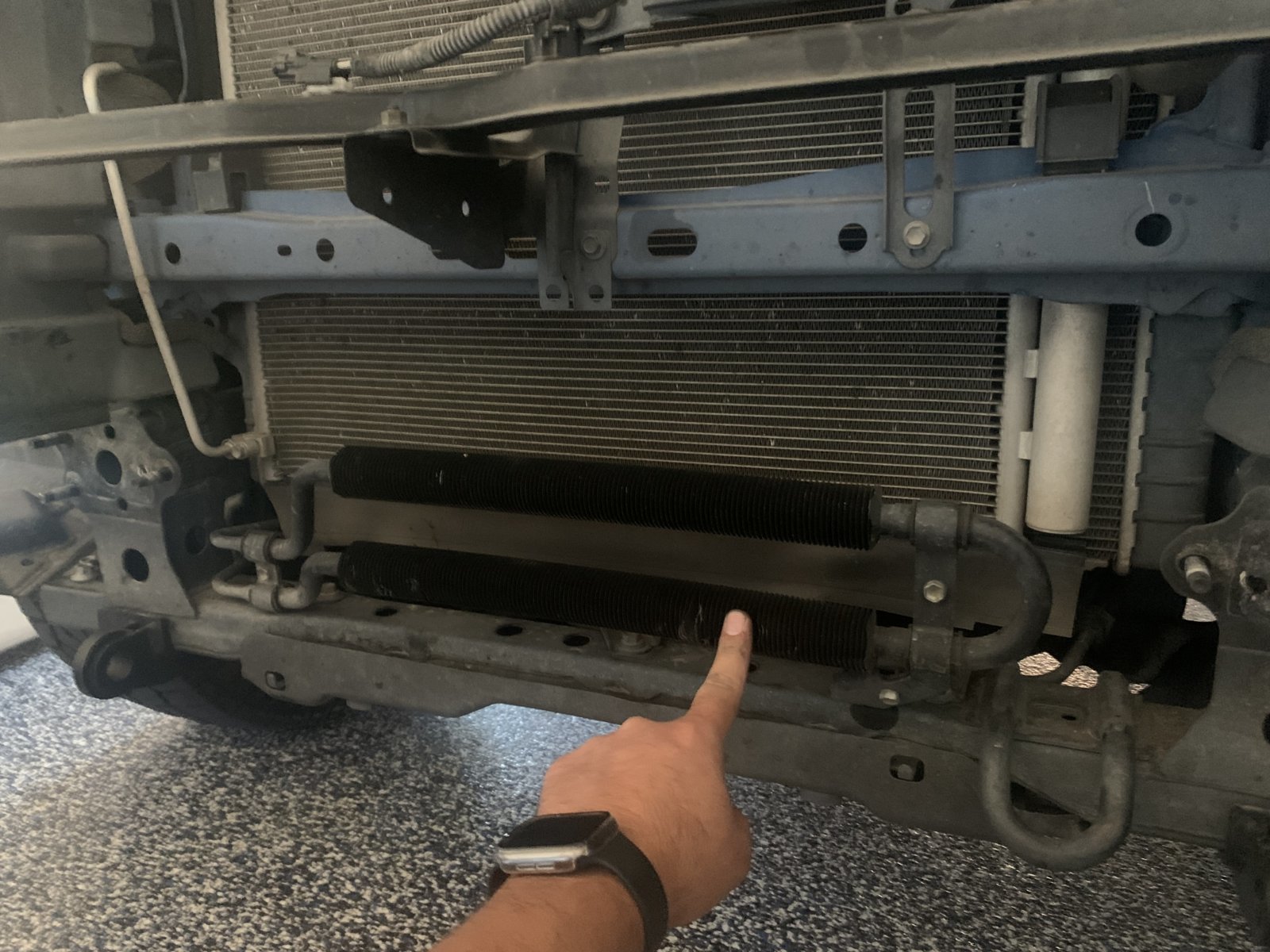

    Question: have you or anyone else in this thread had to deal with these? They are blocking my hidden winch mount by about two inches. Did you have to relocate somehow?
