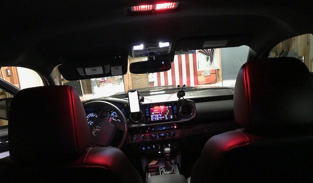

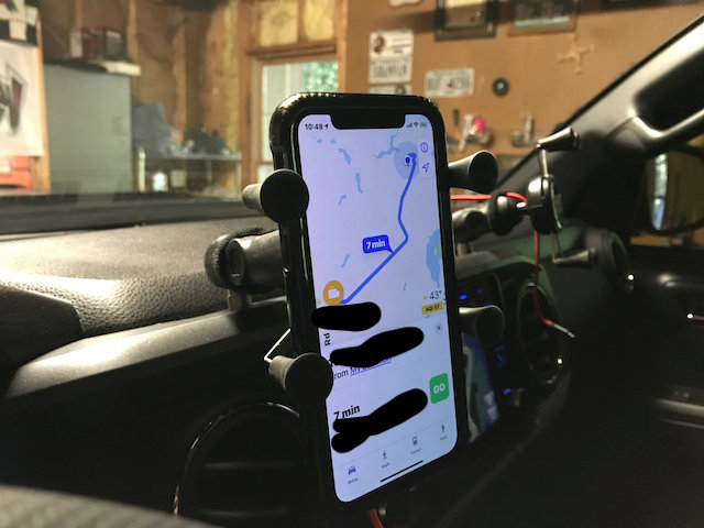

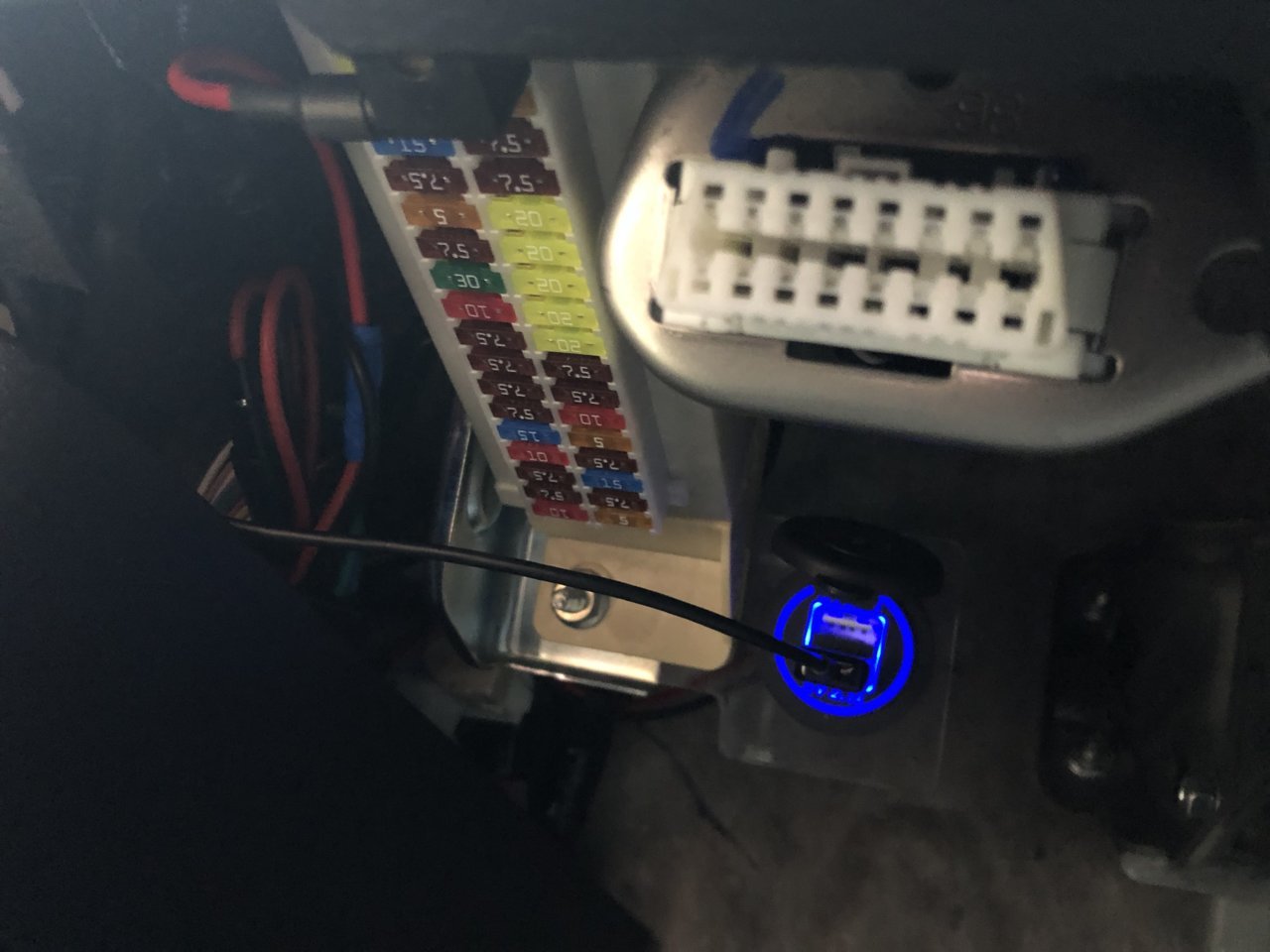

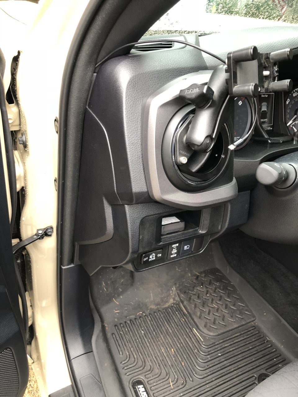

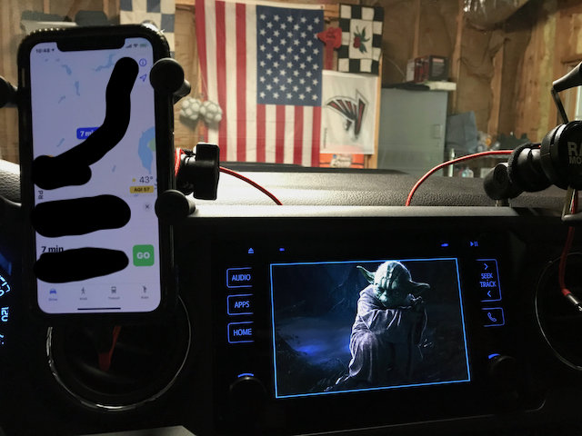

    I got this done a while ago but I'm just getting around to posting pics. Had a guy tap off of the lighter with a 2 port USB connector. He had to run it behind the head unit, which is only 4 screws to remove. Ran out of the DMM with w RAM Mount balls. I used velcro strips to attach the cable to the mount. Worked out well.

    Just use an add-a-fuse wired to a double usb outlet behind the dash then run the wire up the door trim.
