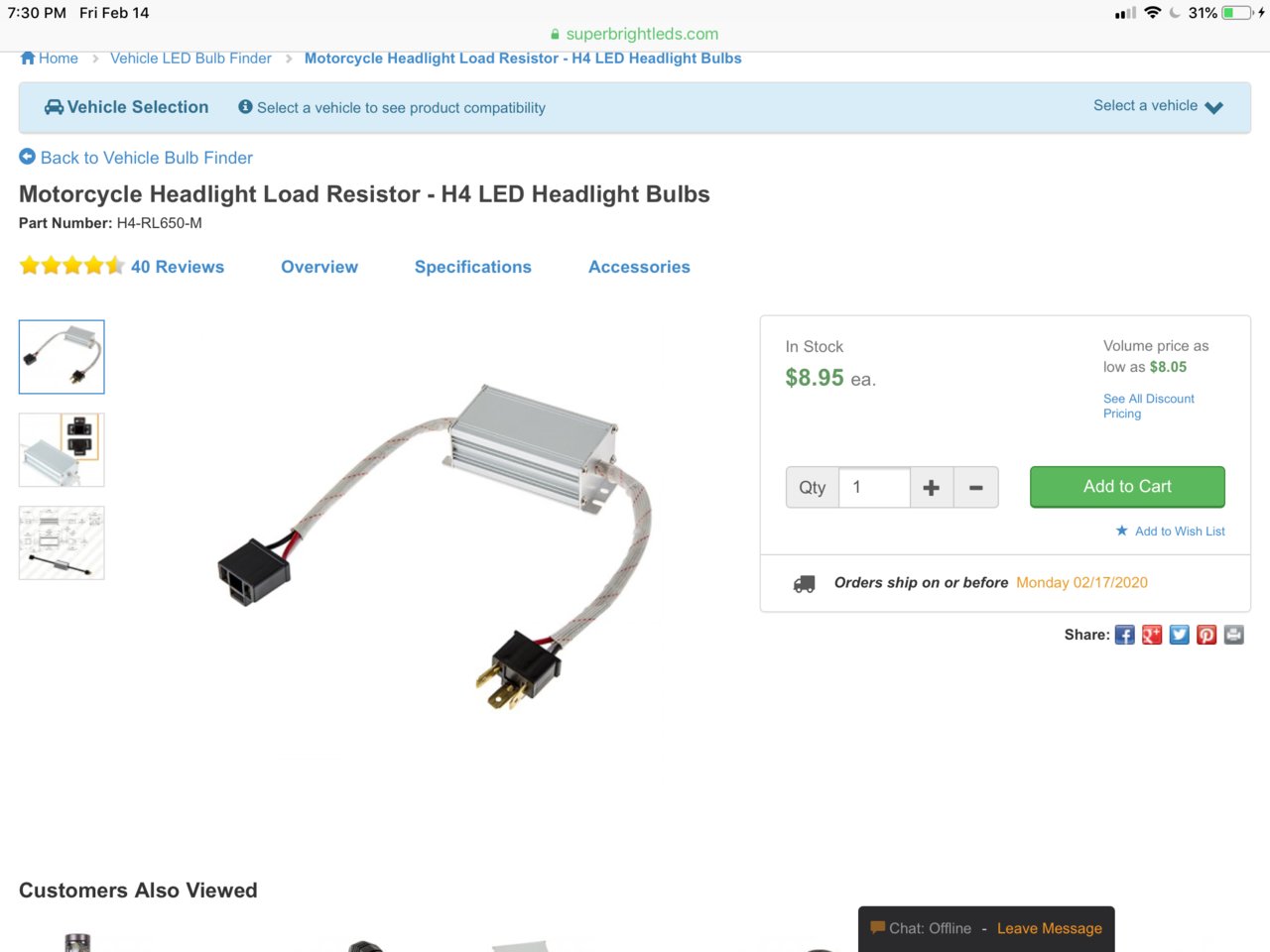

    I'm reviving this thread because just installed HID projector retrofit lights on my truck and I have this same issue.
    Everything works as it should, but no indicator on the dash. My led light bar, which I have connected so that it comes on with my high beams, doesn't work the same as it did before the upgrade, but it's switched so easy to turn on if needed.
    Will a resistor work? Do I need a extra large one, or will a couple watts work? I got the truck back together and the lights aimed properly, but would like the indicator to work right.

    Install one of these on the passenger side wiring harness and it should. Just make sure it doesn’t get too hot tho

    Thanks for the info! I purchased one of these from the same place you suggested, installed it on the passenger-side headlight harness and it worked perfectly! 10 minute install and now my high beam indicator works again. I love the LED headlight upgrade now.

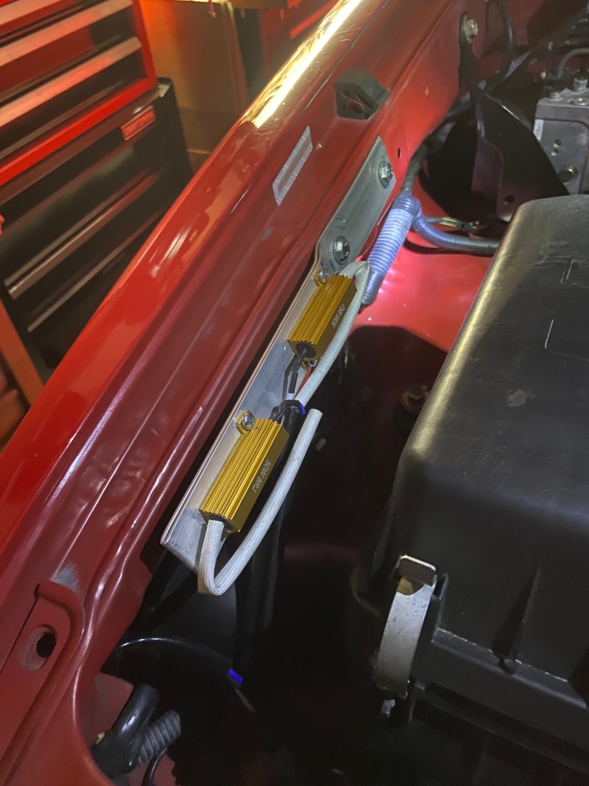

    That resistor will get hot AF, consider mounting it somewhere to help dissipate the heat and prevent it from burning anything that touches it. I used some 1” aluminum bar stock and fashioned this in about 30 minutes.
    Mark 1201[QUOTED] and MadNachos like this.
