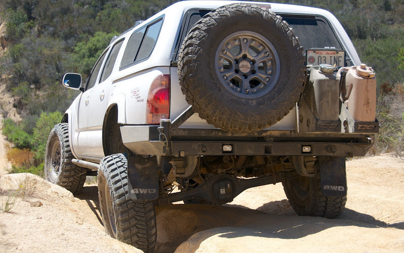

    CBI bumper cut for flaps. Flaps are cut down big rig units, and they are attached to the side support bar on the bushmaster bumper. I can't believe you are getting hassled for this in Montana! Are you trying to date the sheriff's daughter??

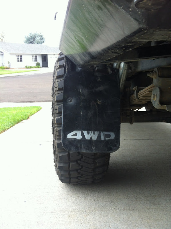

    I mounted my rubber to a piece of 2" x 1/8" aluminum angle iron. I used 1/4" bolts with nyloc nuts and fender washers over the rubber. That gives you something to bolt up under the truck somewhere. Good luck!

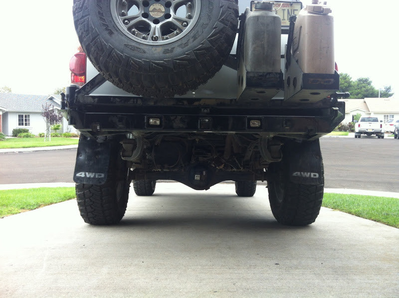

    1st gen mudflaps

    just drilled a couple holes to line up with the existing holes on the mudflaps. A couple nuts and bolts later and they were on. Now they dont do a whole lot of protecting, they are just basically a check in the box for the police.
