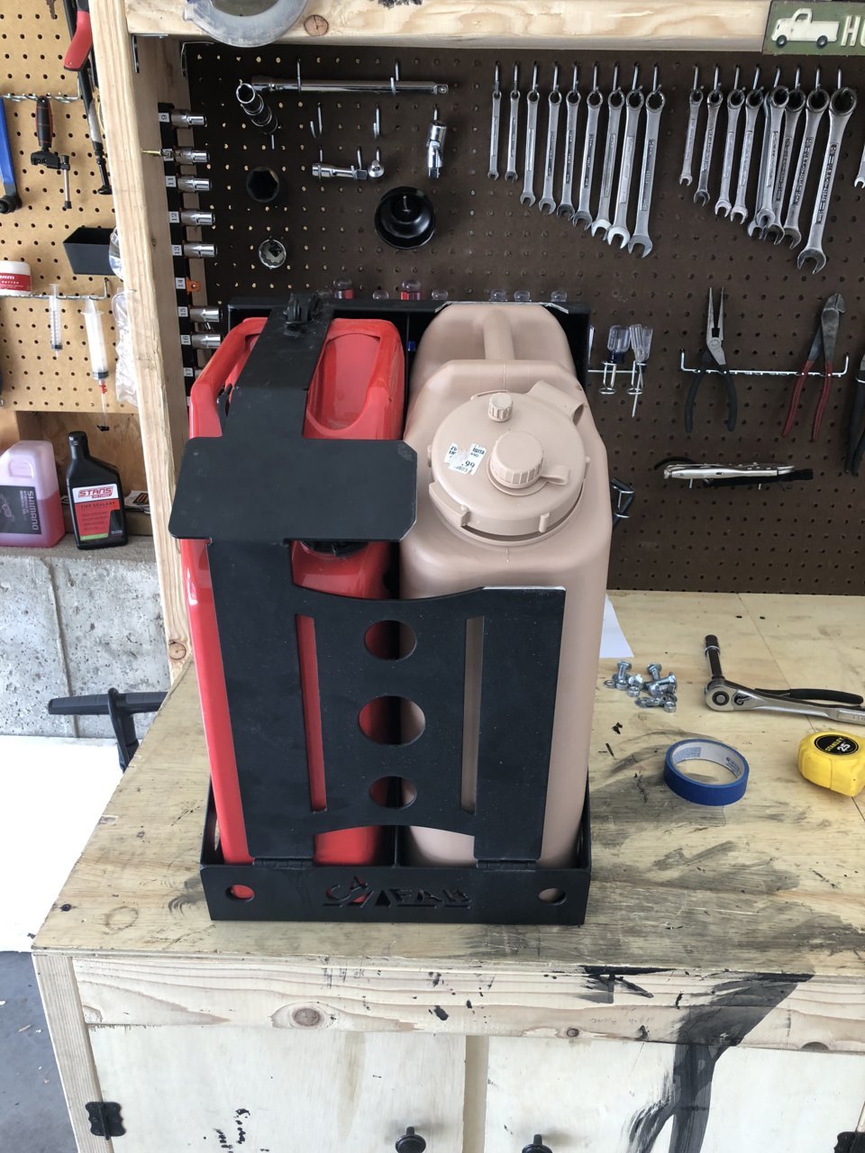

    Anyone with a C4 HC rear find a water jug that wits with the gas can holder? The Midwest gas cans fit, but I can’t find any sort of water can that will fit.

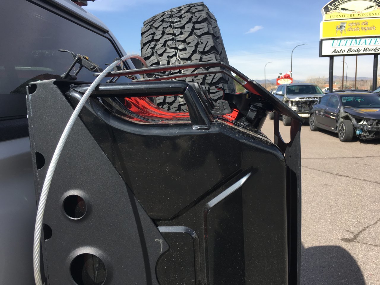

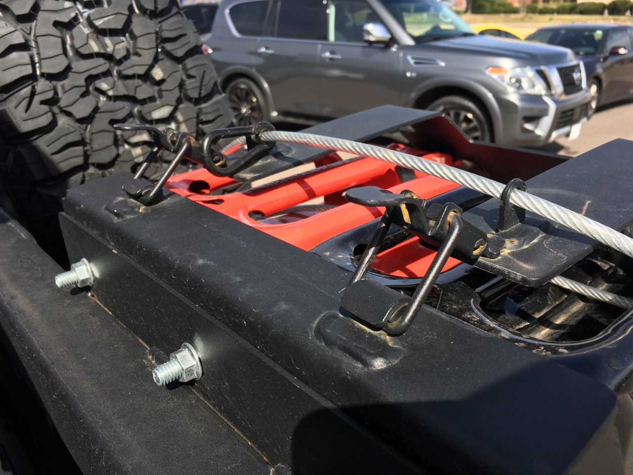

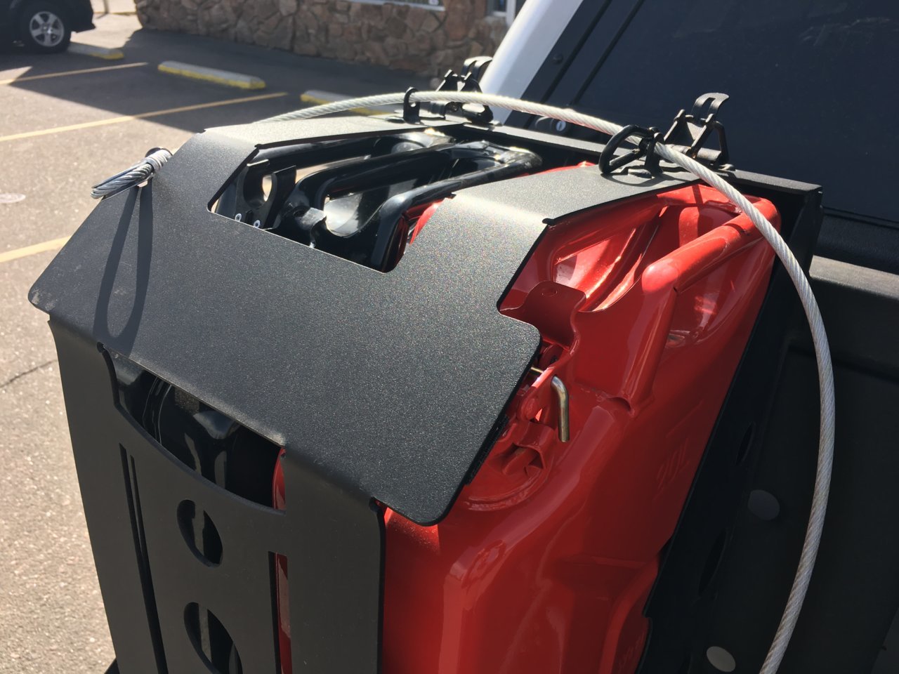

    I just received my Wavian/NATO (https://www.frontrunneroutfitters.c...0lt-red-jerry-can-with-spout-and-adapter.html) gas cans (red for fuel, black for water) and was stoked to get them in the C4 jerry can holder. Of course, I found out that they are too big for the hinged cage.
    I set up some clamps on the cage and bent the first angle out to fit the can spouts and then bent the two arms with buckles back down toward the latch receivers. Of course, they are now too far away to latch. For now I can latch the buckles in the open position and that keeps the cans tightly in place (a little 1/8" foam strip to protect from rubbing against the can makes it even tighter). I bought some vinyl coated steel cable and looped it through the lock points on the buckles and crimped loops on the cable ends - the cable runs through the cage and then through the handles of the cans themselves. Locked up tight.
    I'd post pics, but my truck is at the shop getting 4.88's installed while we're on vacation next week. I'll post some when I get back if anyone wants to see how I "solved" the issue.

    Modified mine to fit. Not the best solution. But it stays in there. Gonna have to work until I get a different can holder. Probably get a cbi one.

    Pics of my modified C4 jerry can holder below.

    Nice. Does it rattle open when wheeling?
    This is what I did. I just cut it. I plan on getting a CBI holder someday soon.

    No, the tension on the latches are really tight - no rattles on the cage, I looped some carabiners on the cable to be able to latch the lock down to minimize any clanking or rattling while I'm bouncing around.
