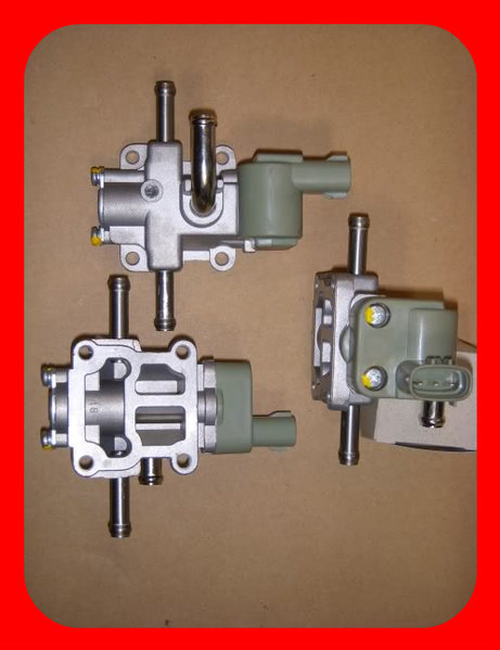

  6. Aug 1, 2010 at 5:50 AM
    #26
    Got Taco?
    Got Taco? 1st Gen Taco
    Nov 10, 2009
    #25736
    1,390
    Arizona
    1st Gen
    1998 Taco: RevTek F/R lift JBA cat back MagnaFlow cat K&N CAI Tundra 13WL brake conversion Redline hood struts Flex-A-Lite dual radiator fan Galaxy DX979 (barefoot), Wilson 1000 (thru-roof). 2012 - Finally "Bro-Lean" status since springs have negative arch. =( Current vehicles as of 2022: 1971 - Honda CT70 1976 - Puch N RIGID 1998 - Tacoma PreRunner (daily driver) 2001 - Lexus IS300 2002 - Lexus SC430 2002 - Lexus LS430 Ultra Luxury 2003 - Lexus GS430 2004 - Lexus LX470 (overland project)
    Your IAC (idle air control valve) is stuck open. It provides additional air for warm up then as the coolant temp rises... the valve closes and idle returns to approx 750ish rpm. Its the valve on the bottom of your throttle body with the coolant hoses attached to it. AC197.jpg

  8. Aug 1, 2010 at 8:43 AM
    #28
    AKTacoma
    AKTacoma [OP] Dedicated Crew Chief
    Jun 2, 2010
    #38279
    372
    Houma, Louisiana
    08 Tacoma DCLB
    Ohh good, I was about to say WTF is going on with my trucks lines?!
    I thought about that thing, but hows it get unstuck? Its starting to idle better, but it only idles a little below 1K with the A/C on, but with it off its back up at 1100 to 1200.. aren't the rmps supposed to increase with the A/C on? thinking it could be something with the A/C Idle up valve?
  9. Aug 14, 2010 at 1:16 AM
    #29
    Got Taco?
    Nov 10, 2009
    #25736
    1,390
    Arizona
    1st Gen
    Not sure if it can be manually unstuck as it appears to be a sealed (non-repairable) item. As for the decrease in rpms with the A/C on, the IAC would adjust and provide added air. I went thru the same scenario as you after I disassembled my engine and media blasted all my parts including my throttle body. I taped up all the openings/inlets but some of the fine media worked its way into that IAC valve and it was stuck open from that moment. After reading the repair manual, I found a passage in that manual that says something to the effect of "do not attempt to clean this valve". Once I changed that valve ALL idle problems solved. I opted to get an aftermarket one and it lasted approx. 12,000+ miles with no issues. Hope this is of some help.
