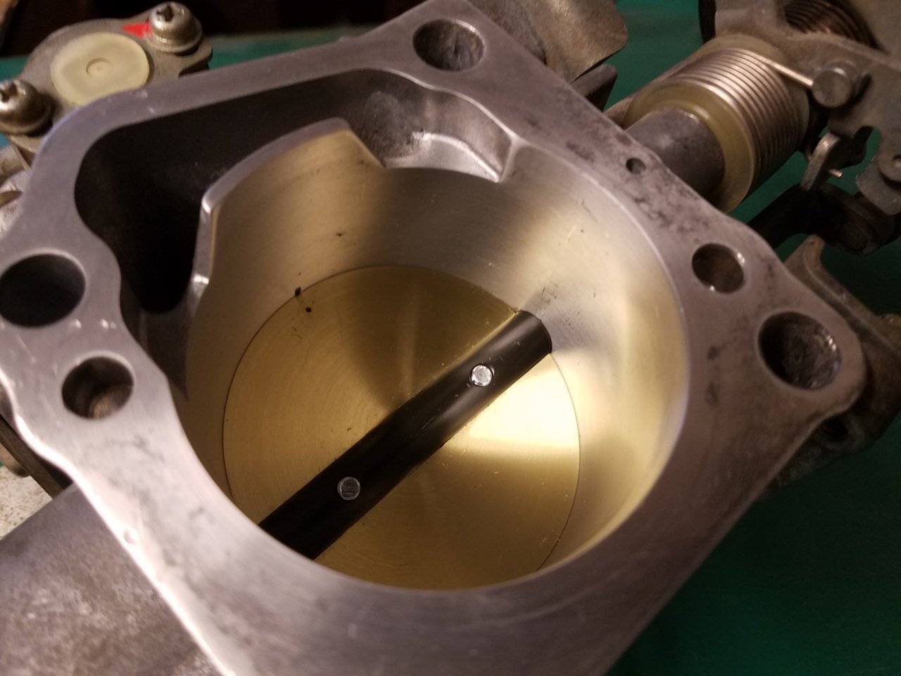

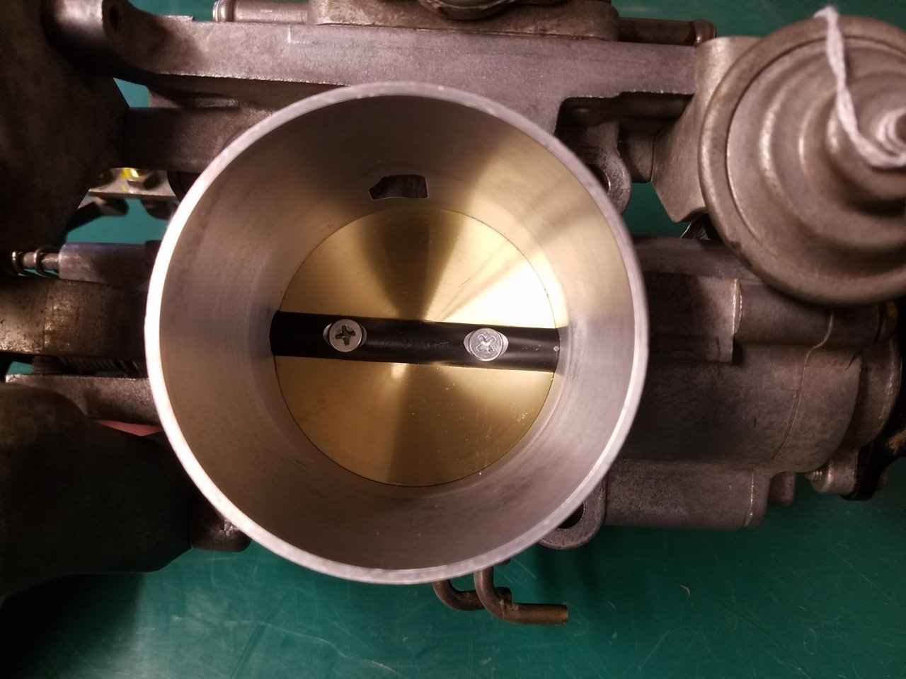

    Had mine bored and a new butterfly.
    No gaps anymore anywhere.
    He actually puts the whole throttle body in an ultrasonic cleaning tank too.
    Cost 125.00
