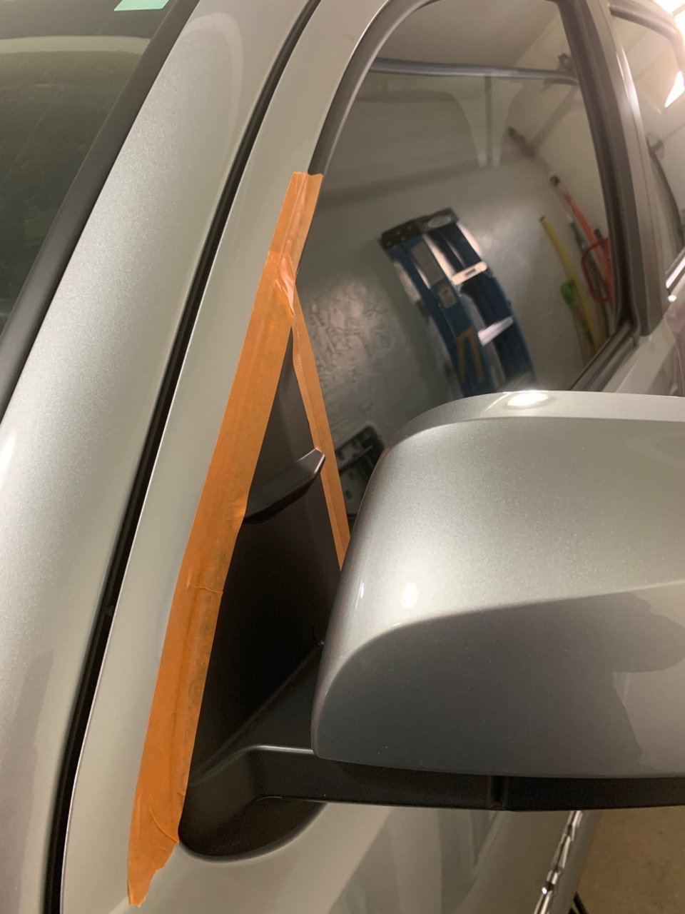

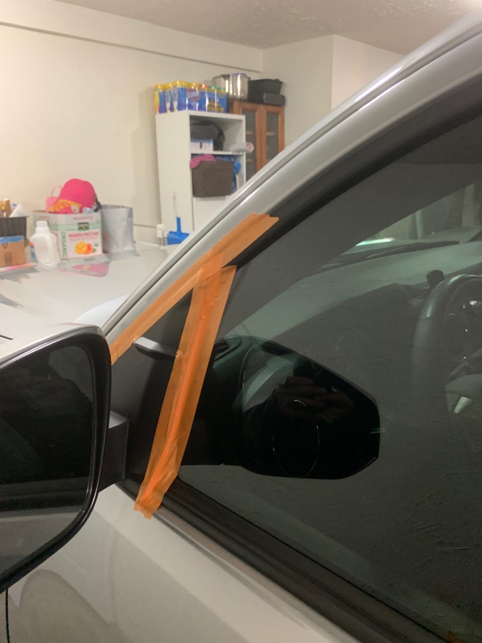

    I have 2018 Tacoma TRD 4x4 offroad double cab. I had whistle sounding on the driver side window above 40 mph. I went to Toyota dealer to check out and they told me that it is normal wind noise.
    I found a posting on other thread and found out that that sound is coming from driver side mirror. The sealing on the mirror is not complete and the air is going inside of the base of the mirror mounting and escaping from the rear side of the mirror base and causing a high pitch whistle sound.
    I taped mirror's base and the sound is gone. I didn't take back to the Toyota dealer and explain what is the cause of the sound and try to fix it. I just fixed it by myself. I use silicone sealer around the base and place the small rubber tube back of the mirror base. You can find a picture of how to fix it here.

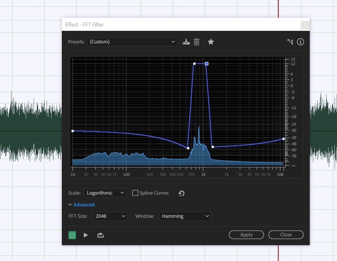

    I have a 2020 TRD OR DCSB with 6MT that makes a similar ringing noise. I consistently hear it when I'm going 48-49 mph, and it's most obvious when I'm cruising in 5th or 6th gear. It's not audible when accelerating or decelerating through those speeds, and it's not present at any one particular engine RPM.
    I confirmed using tape that it's not my driver door seal or mirror. I had a 2016 Limited POS that made all those noises, along with the LCA whistle. This is more high pitched. I recorded the sound and ran a FFT on it. I was able to isolate the noise I'm hearing ~900Hz. Here's a pic of the peak, and link to the audio file.
    https://drive.google.com/file/d/1rdDSGaRIatEN6yYtx2s0rZO5xD6mVkfI/view?usp=sharing
    To me it sounds like a resonance in the drivetrain but I have no evidence. I'll update if I make any progress.

    I have the high pitch whistle that SparkyTacoma has in post #43 on my 1 week old double cab, off road. Dealer could not isolate the noise. I found this post after trying painters tape everywhere. Taped off the mirror and it disappeared. I will likely bring back to the dealer to fix so they have a record of this problem. Don’t think I could have lived with this very high pitch annoyance.
    Thank you for posting this fix!
