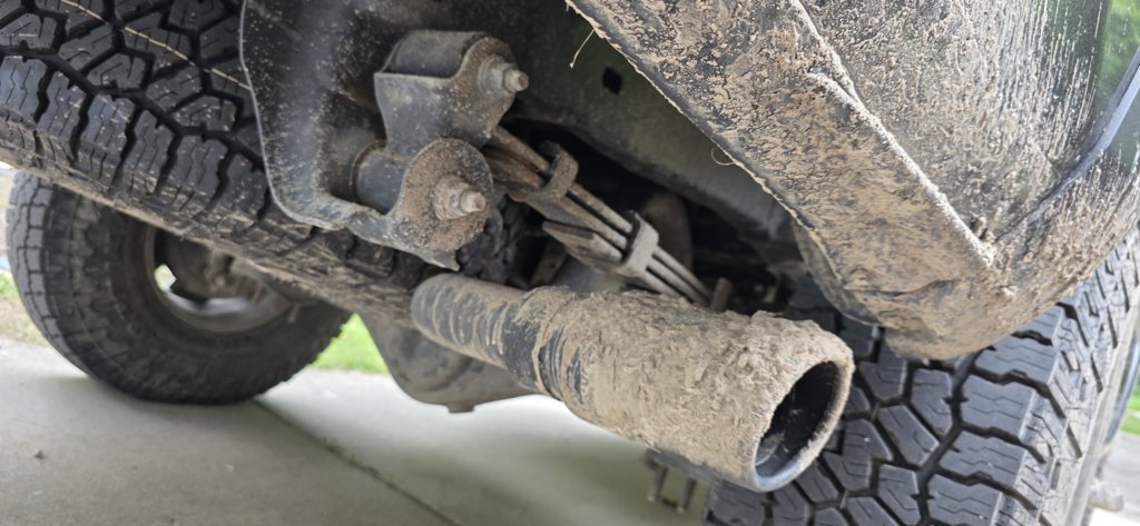

    I have been doing this for years with my formerly chrome tip. It holds up pretty good, but I drive on gravel roads here and there and my tires sling rocks. Typically I end up doing touch up once or twice a summer. Holds up well to being pressure washed. I did sand initially, and will do rough sand when its touch up time typically.
