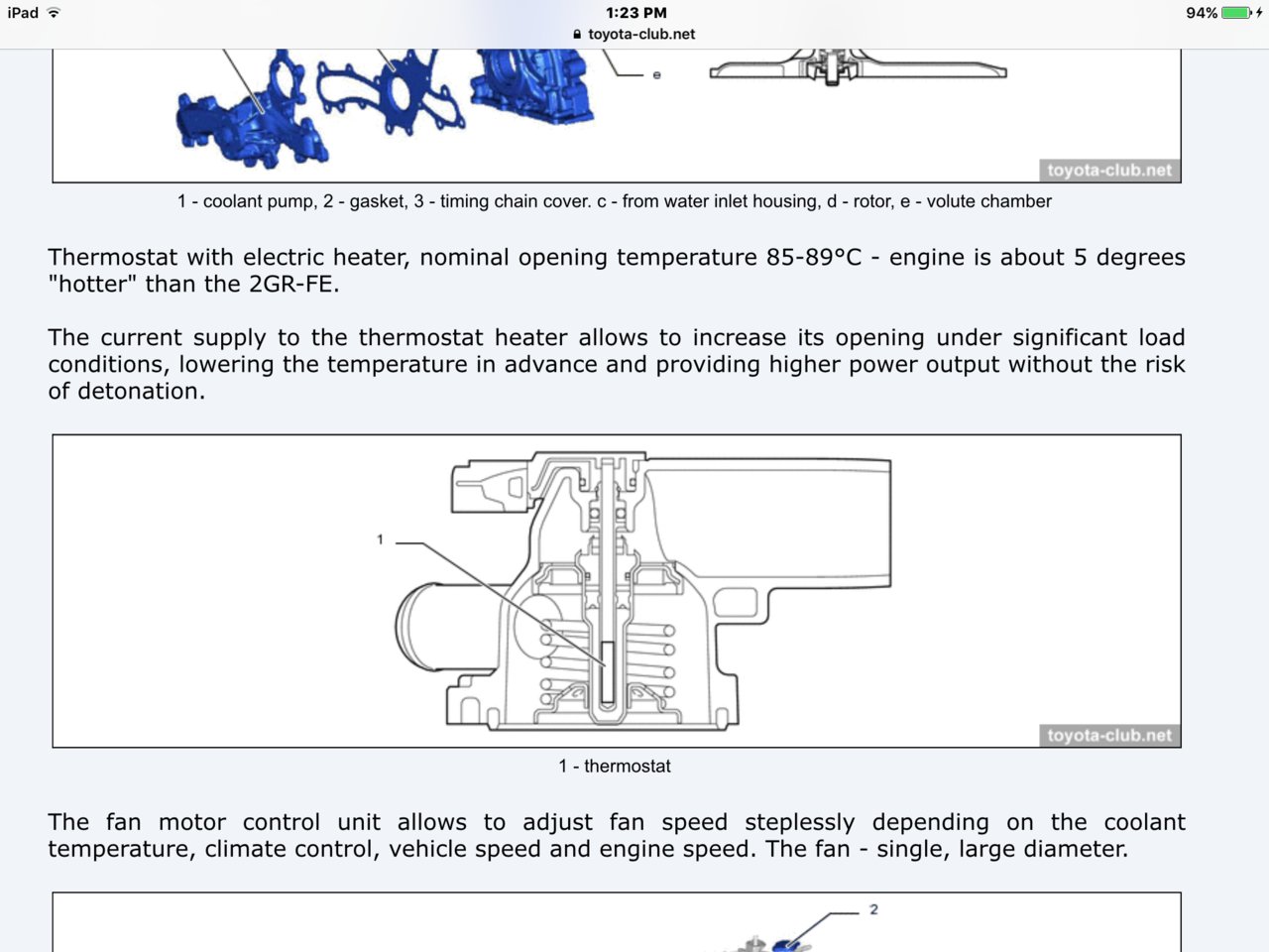

    Here is the thermostat.... extra parts, extra complex, and extra failures are a possibility. Hopefully this covers the issue and you do not have further problems. Coolant temp is on the back of the cylinder heads.
    BigWhiteTRD likes this.
