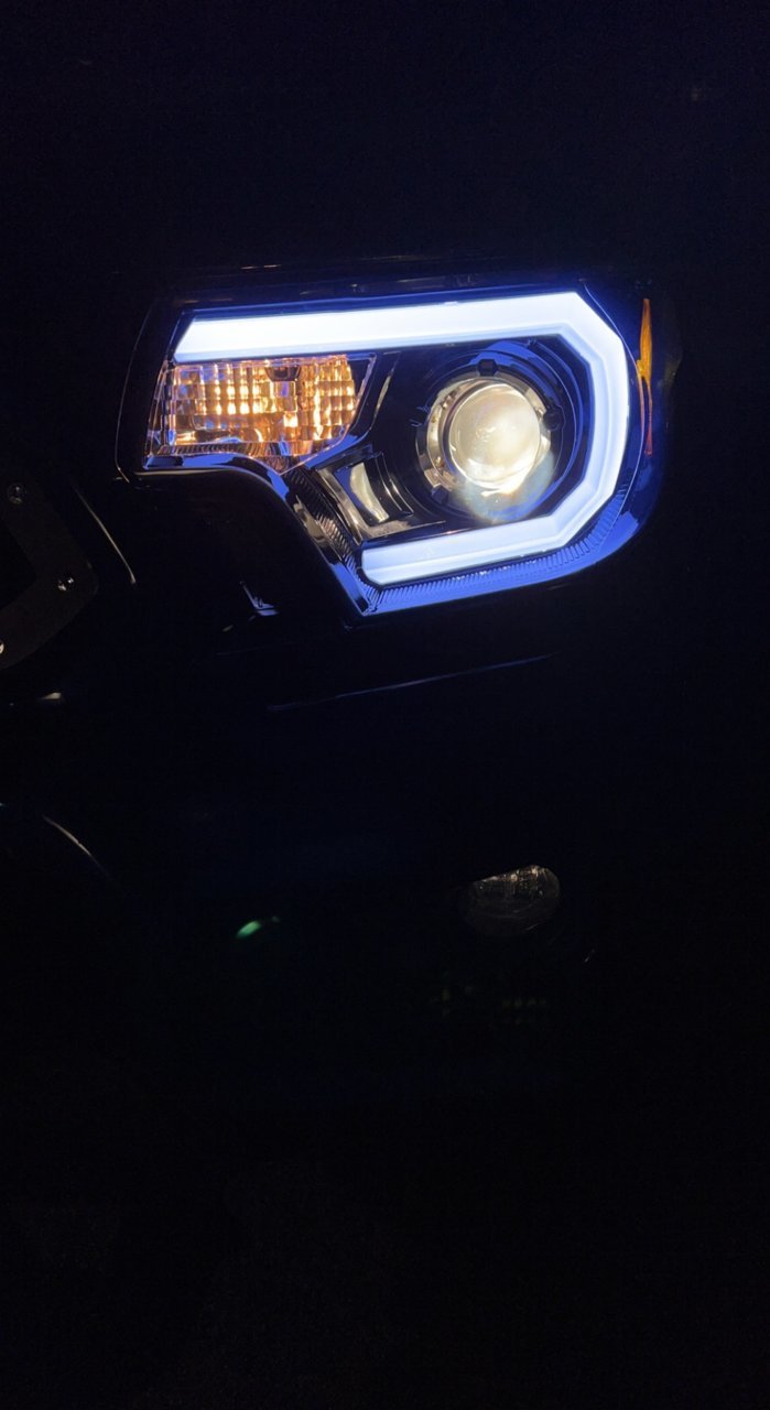

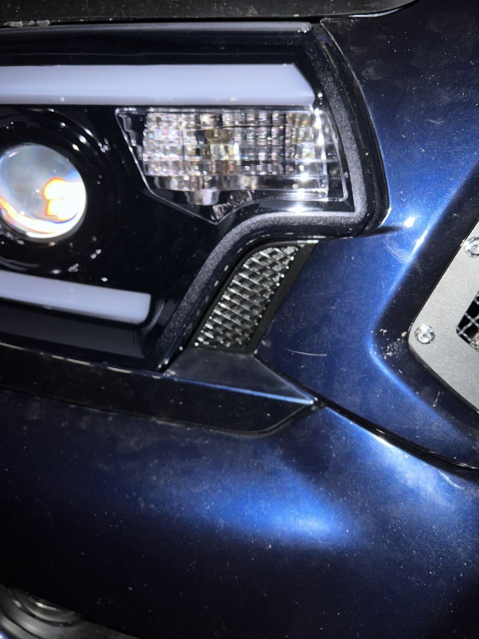

    Yeah no problem I don’t know why I didn’t post a picture to begin with lol. I put on with the headlight on and one off these photos were taken when I installed them so prior to the issue.75391834-23A4-4FAD-A603-9331C82C9992.jpg404DA3F2-5758-4933-BE25-8E3CDBE5CCF8.jpg

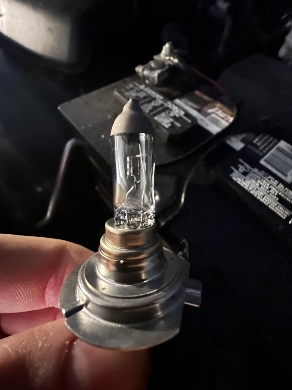

    I think Toy_Runner is right with the solenoid because of how the headlights are acting. Here is a picture of the bulb as of right now. I took a couple videos but can’t upload them to the thread. It seems to want to go the actual bulb brightness changes. But seems to get hung up on something and won’t lower back down. The passenger side is starting to do it as well.F474CABC-DABF-48CC-A1F4-134B13E4F8E6.jpg

    If they're a low/hi projector, can you try to use a separate 12v source or a drill battery or something right at the headlamp wherever the highbeam shutter trigger feed is located to see if the issue is with the headlamp itself or perhaps some sort of issue with the switching side of the highbeam circuit.

    Yeah I had another high low bulb at home I put in and tried and the issue is still there. It’s almost like there’s a shutter in the housing that opens and closes with my high low beams I pulled the dimmer relay and my headlights just shut off. I didn’t see any bad fuses though so I’m not sure what else to check before just going back to OEM ones.

    "Bi-"beam projectors do use a shutter, usually moved by a solenoid, to move the shutter out of the way for high beam. So the high beam isn't from a separate filament, but there should be another wire coming out of the lamp for the solenoid.

    There is so the weird thing is I pulled the headlight out and flipped my highs on and off the shutter moved in and out of the way no problem I put the bulbs back in and the problem started again. I have absolutely no clue what to do at this point besides take the loss and buy OEM.

    This is the weirdest thing I pull the headlight out of the truck with the bulb in it the shutters work no problem on high it’s open on low it’s closed. But then I put the housing back into the truck and the problem is back all of a sudden. Almost seems like some sort of wiring issue at this point because they shouldn’t work out of the vehicle but not work in the vehicle makes no sense.

    I actually think I fixed it I pulled the headlight housing out and the bulb and saw some scraping on the shutter I shook it around to see if anything fell out and it threw some dust around so I took a vacuum to it to try to get as much out and kind of pushed the shutter out with my finger. As of right now it works like a charm but I’m not sure how long this will work. Going to see how long this works and go from there. Most likely wind up with OEM again.
