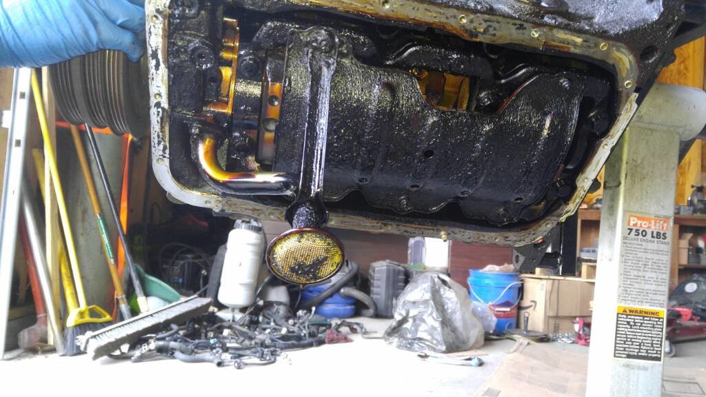

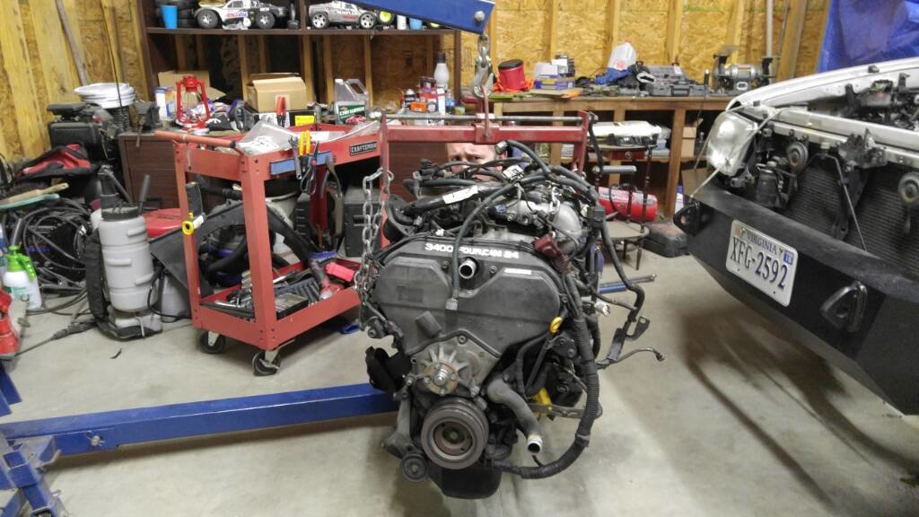

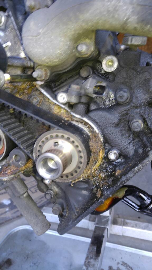

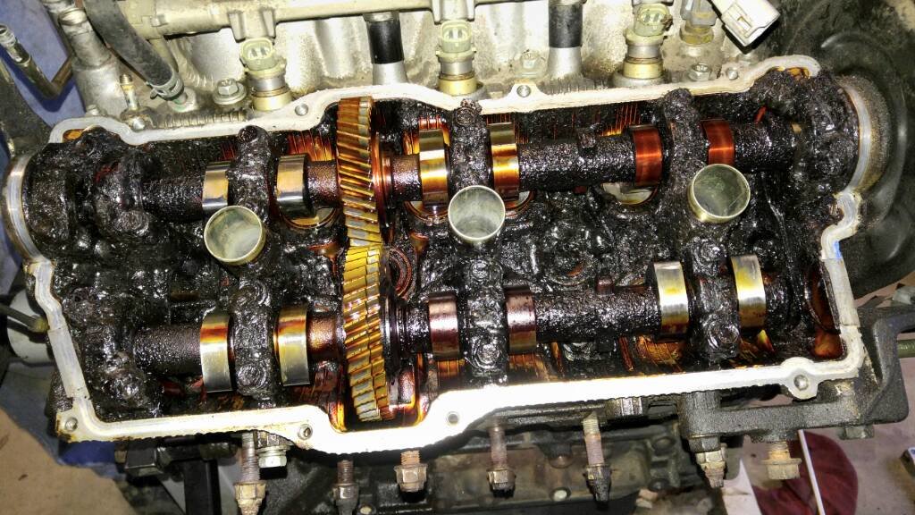

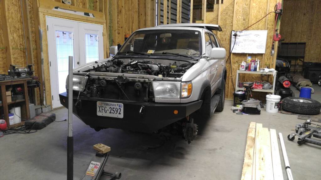

    One of my current projects is my best friend's 97 4runner. To make a long story short, He bought this truck five years ago from a guy that neglected it. It is likely that the previous owner never changed the oil, so by the time Robert bought it, the damage had been done. We did the passenger side valve cover on it a few weeks back, because it was leaking badly onto the manifold, so the truck always smelled like burning oil. We figured that in removing the valve cover, we were likely to dislodge some trash. So when we finished the truck up, we kept an eye on the oil pressure light. Sure enough, it came on, meaning that some trash had clogged a port or the oil pickup. So since we planned on pulling and rebuilding it this summer anyways, we decided just to yank it now.c7d7944d1fc0e7f0ed87f493cadd7b0e_edfc0922a06baa0402e0160e48f88725957c7317.jpg

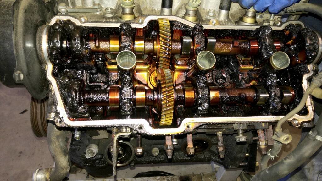

    It was absolutely stunning to see the buildup inside this engine from all the abuse it took. I really gotta give it to Toyota, because this thing was still running like a champ!
    Sure enough, the pickup was partially clogged.

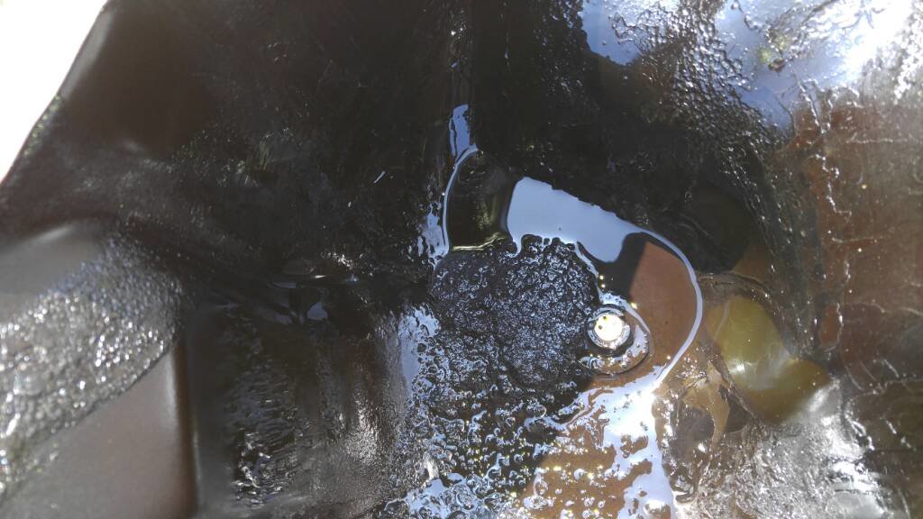

    That deposit in the pan is rock solid. I punched through it with a pick, and it was nearly an inch thick. (there is a small dip in the pan where it sits.)

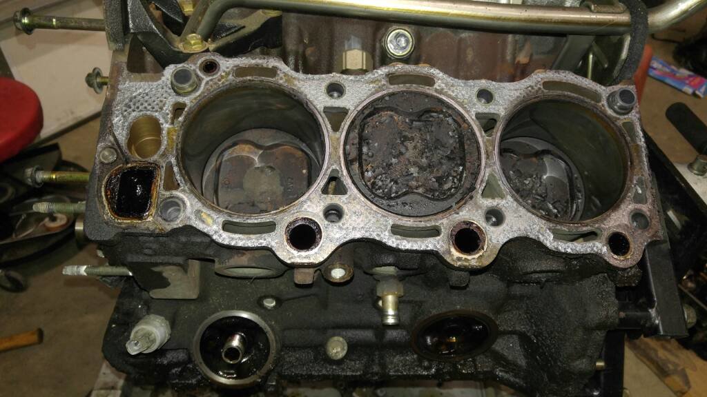

    Removing that head was the last thing we did last night. From what we can see, there is no egging or any major gouges.
