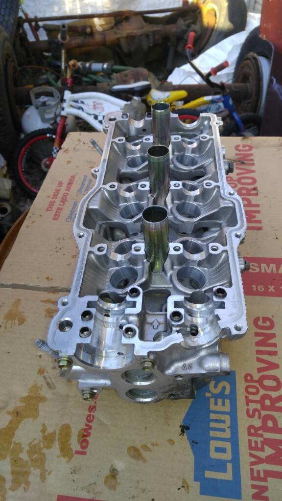

    It's pretty gnarly! The buildup comes off pretty easy, but getting rid of the varnish is interesting.

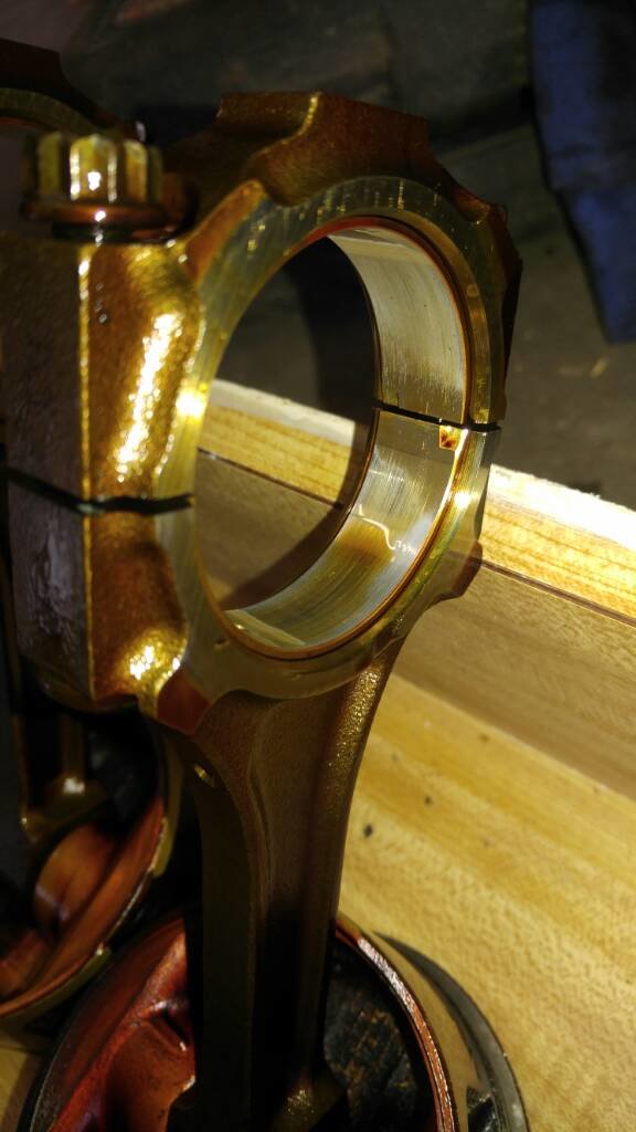

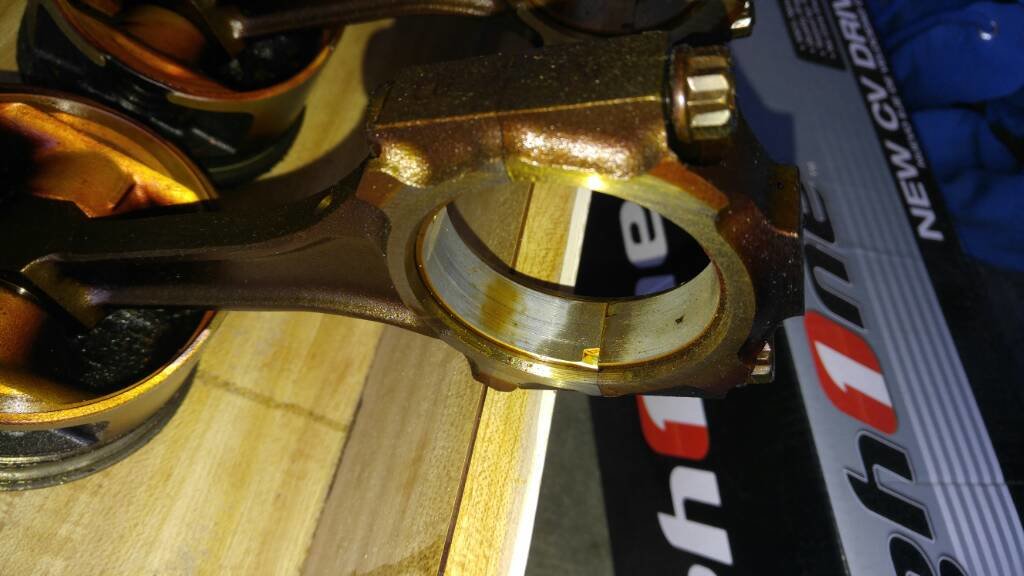

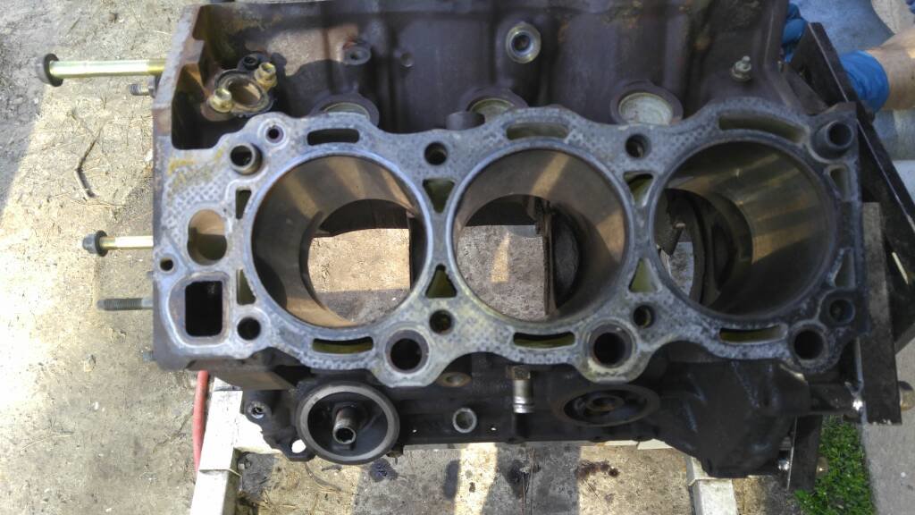

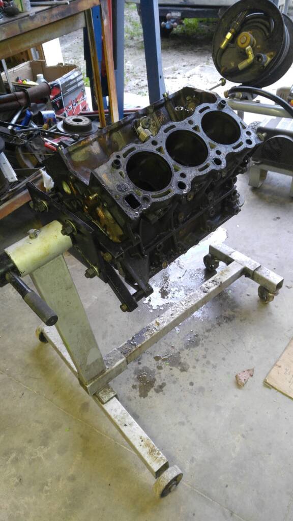

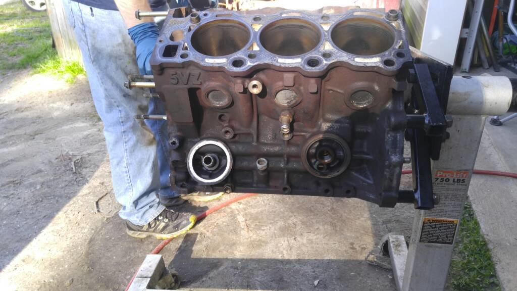

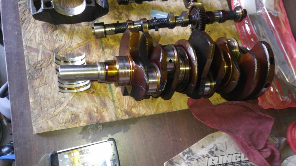

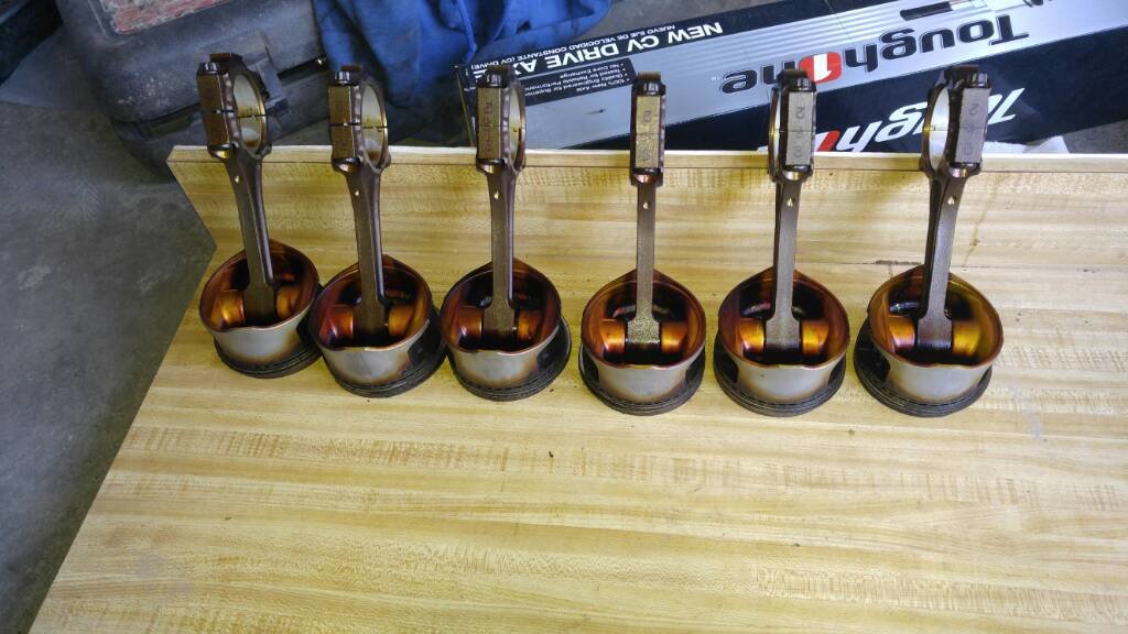

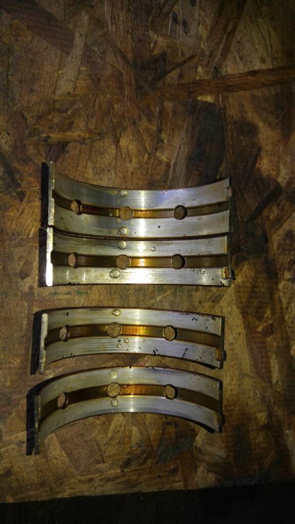

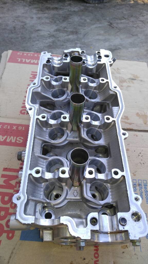

    Managed to get a little bit done on that 4runner's 3.4 this weekend, cleaning parts as we went.
    Bearings don't look horrible. Some scoring, but no copper showing. Edit: Not reusing them, just glad to see they are in relatively good shape despite the abuse this thing went through.
    Still have quite a few of these nasty suckers to clean. It's a tedious task.
    Went from this:
    To this:

  8. Mar 14, 2016 at 10:03 AM
    #28
    BlueT
    BlueT Well-Known Member
    Mar 30, 2009
    #15341
    5,615
    NorthEast
    07 Dbl Cab LB with LSD
    I moded 1999 Taco so much it had turned to Land Cruiser
    How many miles on that motor? I would still replace those bearings if you can.
  9. Mar 14, 2016 at 10:06 AM
    #29
    Fenwick1993
    Fenwick1993 [OP] Hillbilly
    Sep 1, 2012
    #85996
    10,125
    Not Fenwick
    Chesapeake, VA
    96 Tacoma 5Lug, 2015 PreRunner
    Stonewall is the fattest 5 lug slug ever
    We'll definitely be replacing em, only a couple bucks. Was just pleased to see they are in decent shape. It's somewhere around 240k hard miles. Neglected for most of its life until my buddy got ahold of it five years ago.

    Wow for 240K miles that is very good. Yeah I would go all new parts wherever you can, Remember to clean the sludge traps everywhere

    Yes! This thing is nasty as all get-out, but despite the abuse and all of the oil/trash deposit crap, it seems to be in great shape.
    Definitely gonna have to try cleaning the sludge traps like that guy in that video you posted did. That was neat!

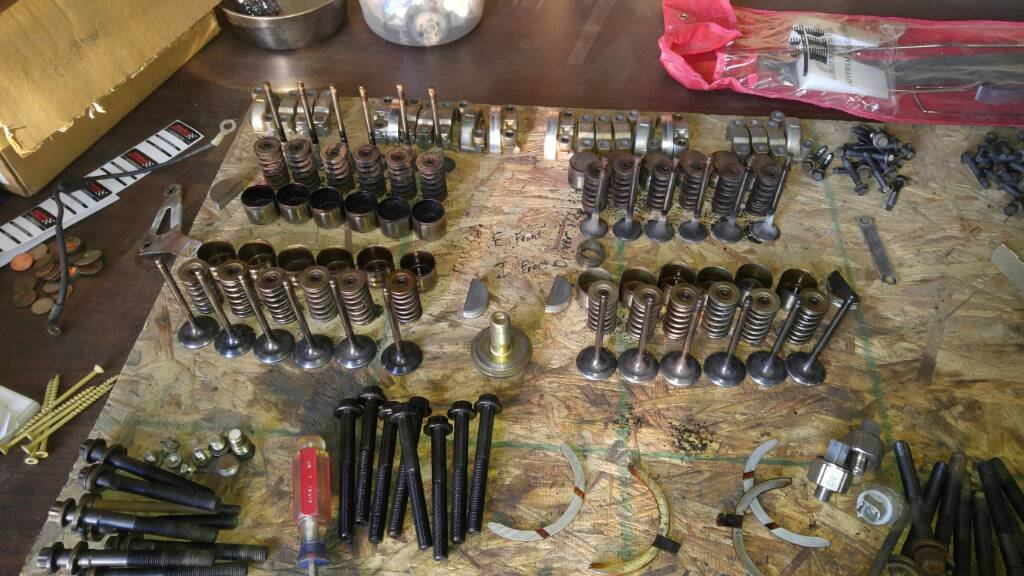

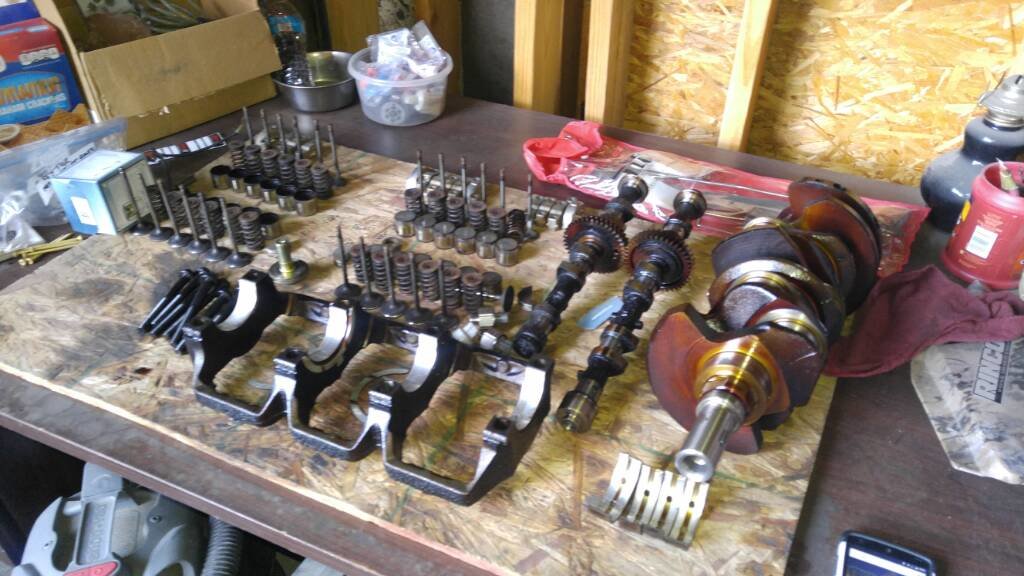

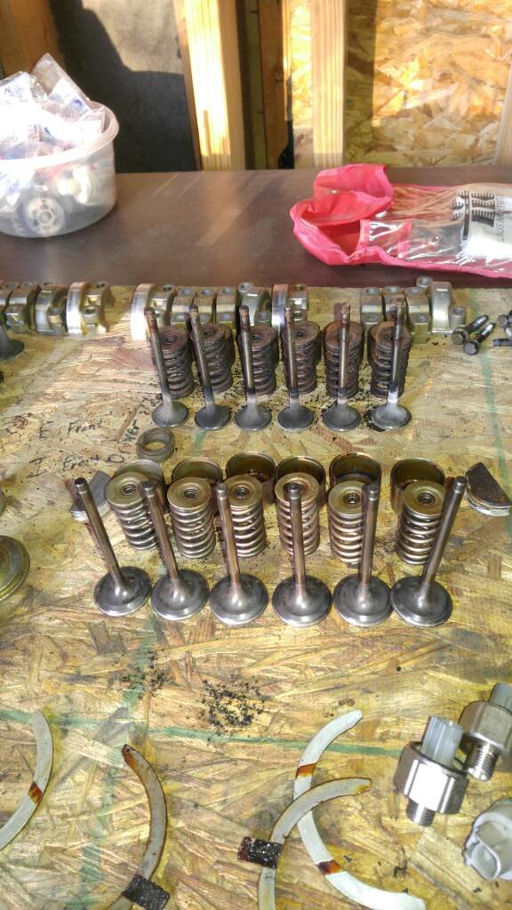

    It's been slow moving, but everything is torn down now. Now it is time for straightedges, feeler gauges, micrometers, and lots of parts cleaning. Going to clean everything as best as we can by hand, but we may be dumping everything in our friend's hot tank.

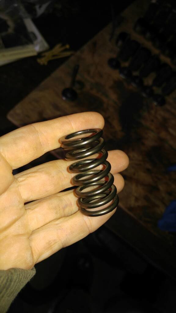

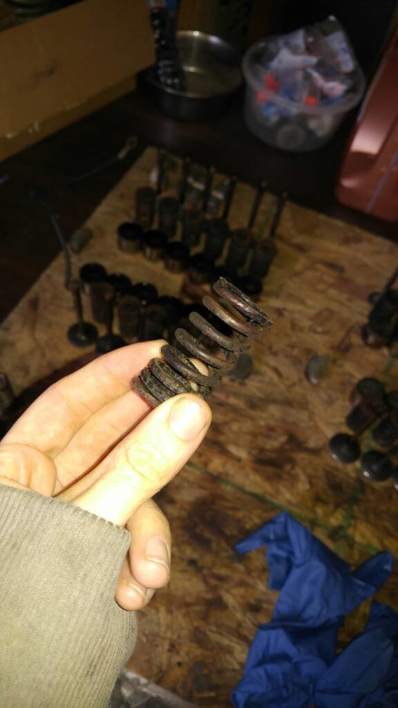

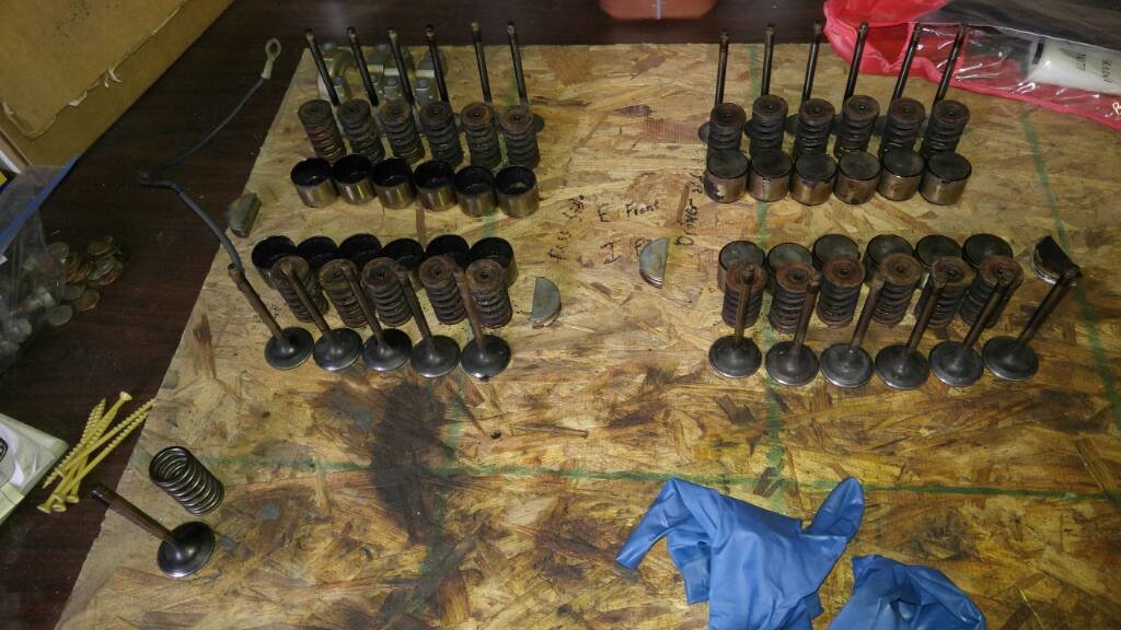

    Got a little done today.
    Hot tank didn't do shit.
    Front row is clean, back row is uncleaned.
    Tractorman, MQQSE, wanna taco and 2 others like this.

    Wow, too many parts throw it in the hot tank again!

    We achieved better results with a kerosene bath than the hot tank did. We were pretty much expecting magic from the hot tank. Kerosene and gas are amazing. We use kerosene to soak parts long term, and gas to do quicker cleans, such as on small items like valves.

    I prefer kerosene bath then a hot tank when I rebuilt my car's engine :thumbsup:
