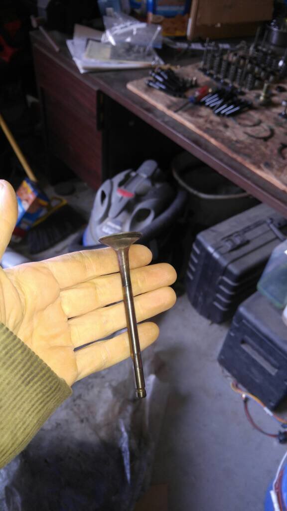

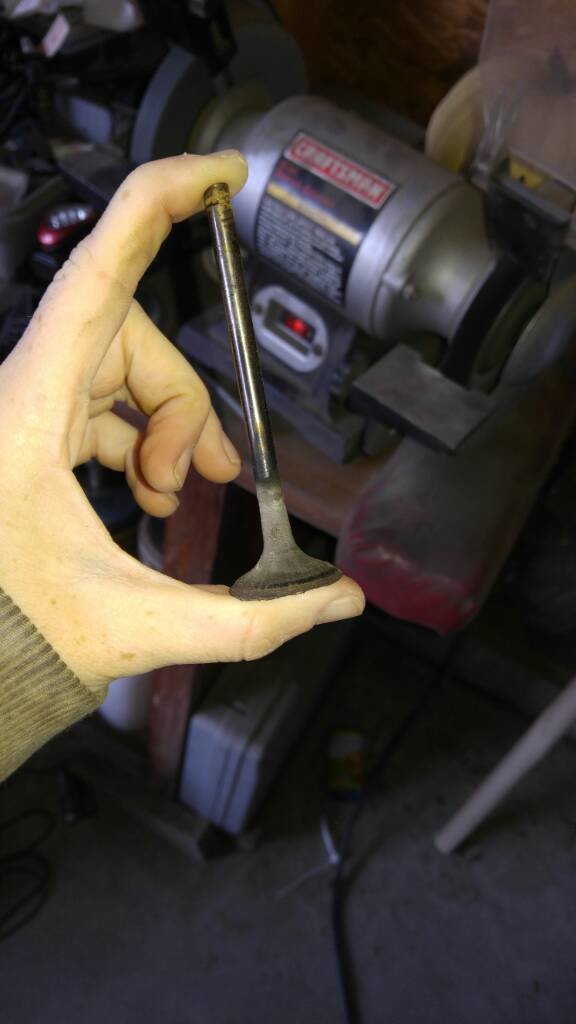

    Before
    After
    Edit: And these pics were taken shortly before I lopped off the very tip of my pointer finger. Unrelated work. :D

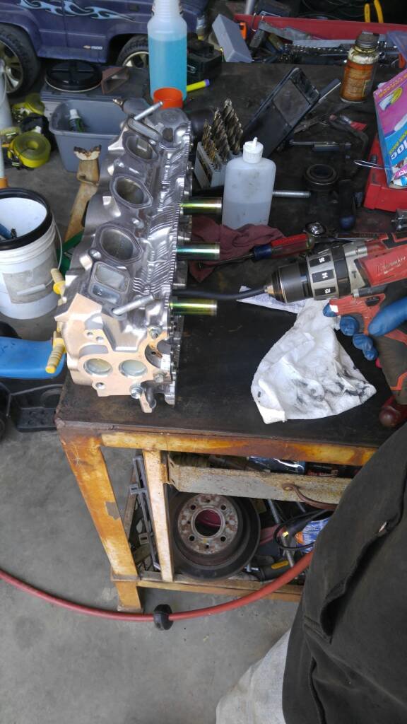

    Been slow going working on that engine. Between mine and Robert's work schedules, my side yard business, and Robert's three month old, hasn't been much time.

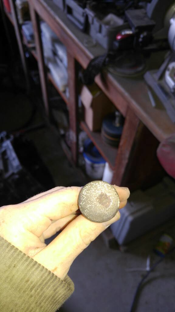

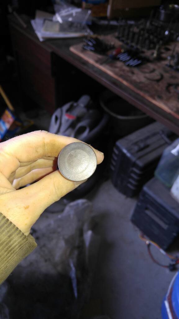

    Valve lap today. Some folks might be interested in how we do it. Stick the valve in, attach rubber hose, and stick the other end of the hose in the drill. Easier than doing it by hand, but the rubber hose allows the valve to seat itself properly regardless of the angle the drill is held at.
    Thought you might get a kick out of that, @BlueT.

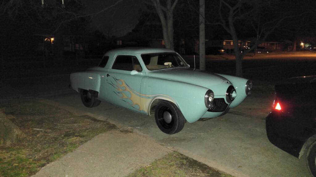

    When are you getting under the hood of that Studebaker?!

    My neighbor said hopefully soon. He just had the whole thing rewired a week or two ago. Whole new harness. Kinda glad I didn't have to tackle that issue!

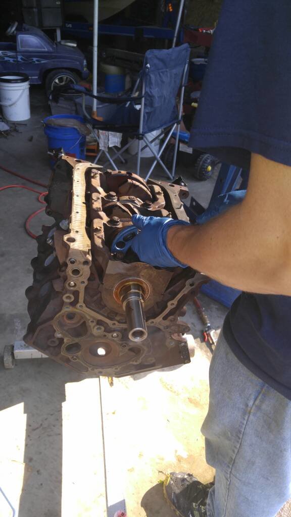

    07ca8c604bda0dfafe42c1861567cc77_7a0e8ff22cee1966e687b10d5c532b8fb841c998.jpgThis is where we stand now on the 97 T4R. Going back together. But realized that they sent us the wrong size rod bearings, so now we are waiting on those. :/

    Second, that Stude belongs in Car Porn because is. At least after that horrific flame job is gone.

    Neighbor says he wants to have it painted eventually.
