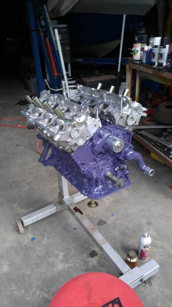

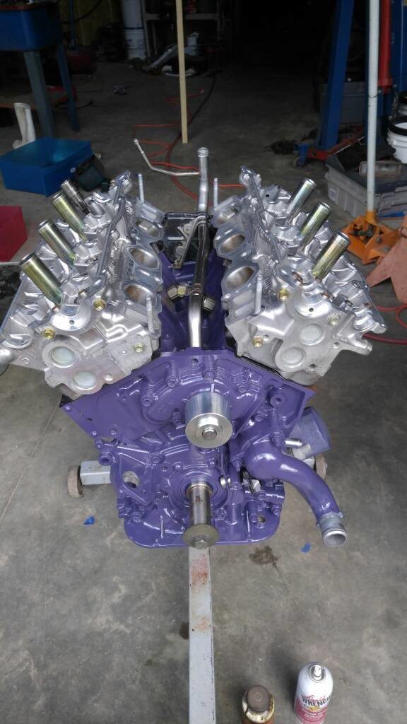

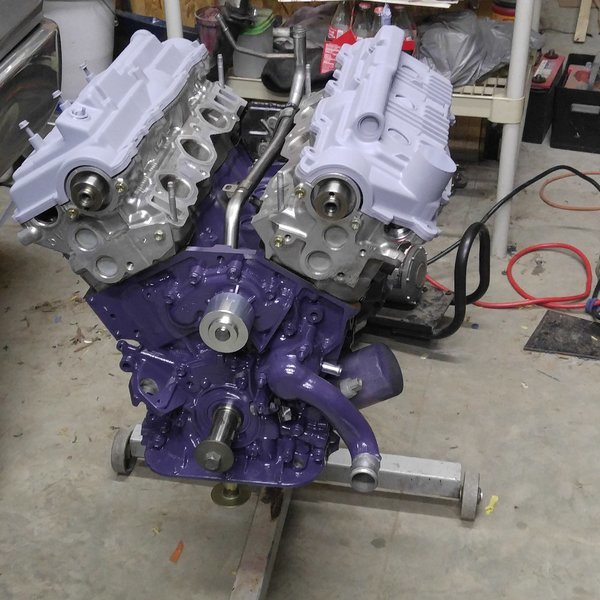

    Some pics from today. We might be slow as hell when we work, (crazy schedules, taking care of kids, etc) but eventually we get stuff done. And we always spend forever cleaning parts.
    Robert's wife wanted it purple, so we painted it purple.

    Ooohhhhh, shiny.

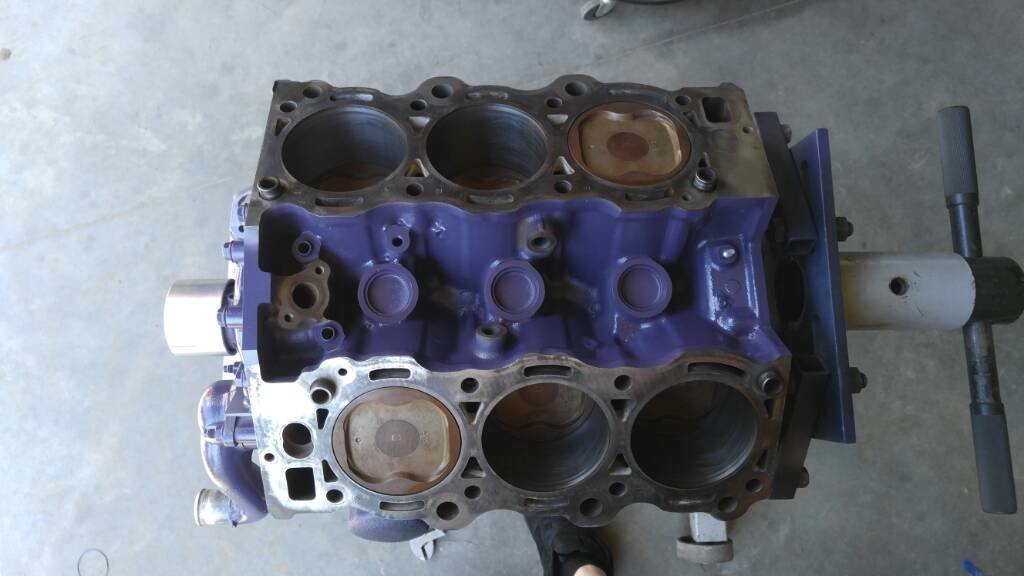

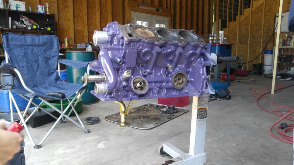

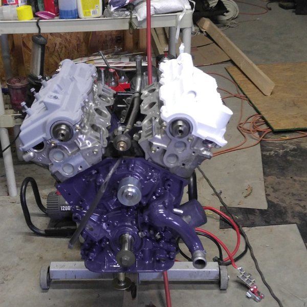

    I lied. Not as pic heavy as I thought this post would be. Most of the pics are of the same shit over and over again from different angles. :D
    Stonewall keeping the 4runner that is awaiting his rebuild company.
    Valve covers primered. Now trying to decide whether to paint em white like originally indended, or see if we can find a gray akin to the color of the primer, because we really like that.
    White or primer?

  9. May 25, 2016 at 9:41 AM
    #69
    TacoJova
    TacoJova Well-Known Member
    Feb 11, 2016
    #177914
    1,662
    Central Oregon
    21 Ram TRX Sold 2015 White DCSB Offroad
    Supercharger Hybrid audio stage 3 and stage 2 rear with 2 image Dynamics IDQ10's and alpine amps Bilstein 5100 with OME 887 Dakars and Icon 2.0 in the rear URD SPEC U Headers URD Y Pipe Borla muffler 18" Magnaflow Resonator Morimoto fogs
    Primer
    Fenwick1993[OP] likes this.
  10. May 25, 2016 at 9:43 AM
    #70
    Fenwick1993
    Fenwick1993 [OP] Hillbilly
    Sep 1, 2012
    #85996
    10,125
    Not Fenwick
    Chesapeake, VA
    96 Tacoma 5Lug, 2015 PreRunner
    Stonewall is the fattest 5 lug slug ever
    Yeah, I like it better, too. Hopefully Robert's wife likes it better too, since it's her truck. She's the mega decider.

  11. May 25, 2016 at 9:44 AM
    #71
    Fenwick1993
    Sep 1, 2012
    #85996
    10,125
    Not Fenwick
    Chesapeake, VA

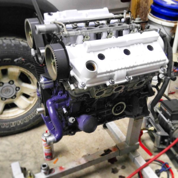

    Plus, I am scared of the idea of white valve covers. They will show every little speck of dirt or grease.
    scottalot and TacoJova like this.
  12. May 26, 2016 at 6:23 PM
    #72
    Fenwick1993
    Sep 1, 2012
    #85996
    10,125
    Not Fenwick
    Chesapeake, VA
    Well, Robert's wife decided she wanted white valve covers.

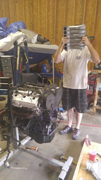

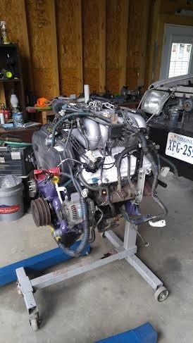

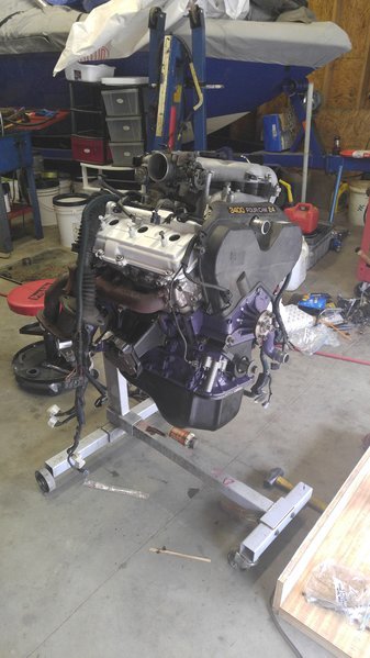

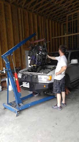

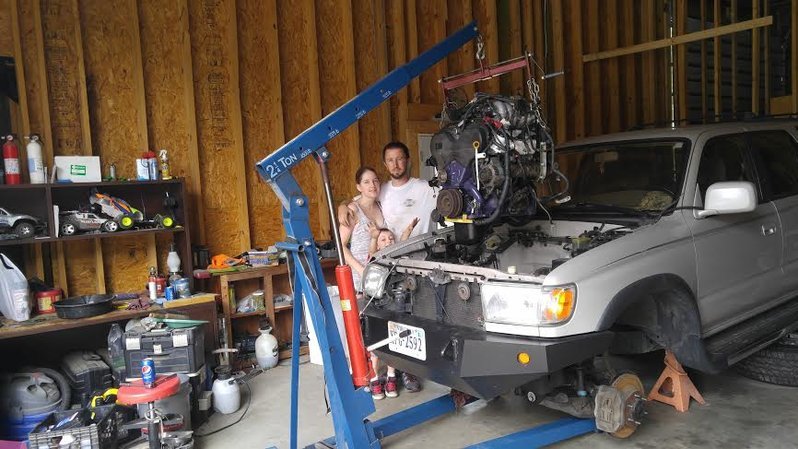

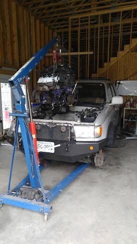

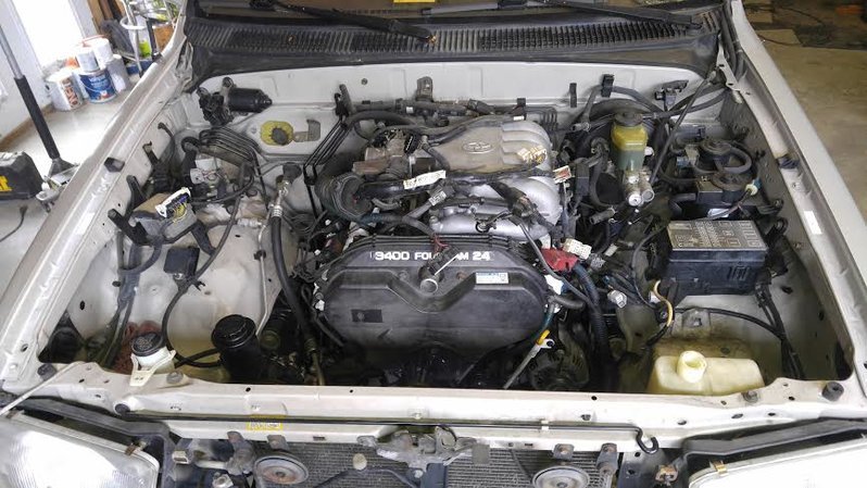

    Now for a picture dump!
    Spent most of the weekend working on getting this thing closer to being done, at least when I wasn't mowing yards and stuff. :D
    She's in there!
    Realistically, we could have this thing running tonight, but we can take a little break. Been a long, exhausting weekend of work.

  16. May 31, 2016 at 11:58 AM
    #76
    Rons01TRD
    Rons01TRD Well-Known Member
    May 30, 2012
    #79732
    1,142
    Ron
    Virginia Beach, VA
    2007 4Runner 4WD
    :thumbsup: Making progress....

    It lives!
