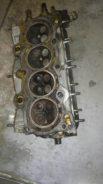

    Yeah, I think I'm gonna say that confirms that it's a blown HG. 95 Civic with 320k on the clock.

    Done AF with the head. Ready to go back on after being planed.

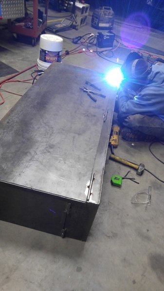

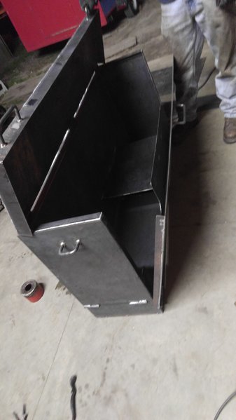

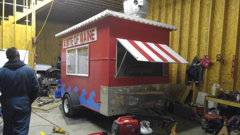

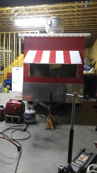

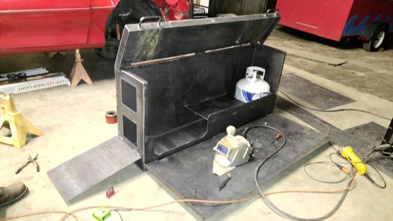

    Apparently we don't just work on cars. Now we work on trailers. We are going to build a box on the front of this trailer to hold two little Honda 2000 generators and a propane tank. The owner gave herself a hernia picking up the generators every day, so we are doing this so she doesn't have to move them.
    :welder:

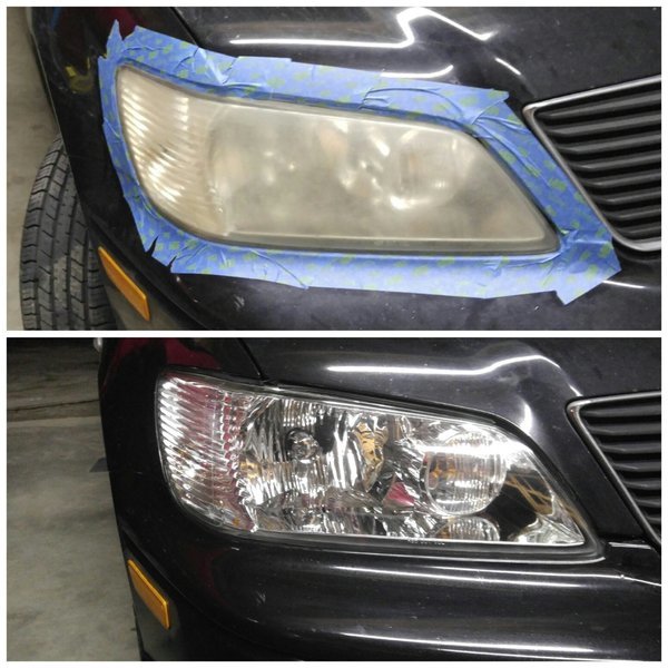

    PicsArt_02-11-10.15.49.jpg Many people have asked, so I'll let y'all in on the secret to hillbilly headlight restoration. First, you wetsand em with 3000 grit until they are smooth. Wipe em dry and hit em with air to get all of the water off and out of the tape. Then they will not be yellow, but still foggy. Then you hit em with a buffer in short bursts with compound, the bottle with a red hood on the front. The Meguiars helps to seal the plastic back up. Many methods work, but the Meguiars seals em, unlike methods such as using Off bug spray and toothpaste. :thumbsup:

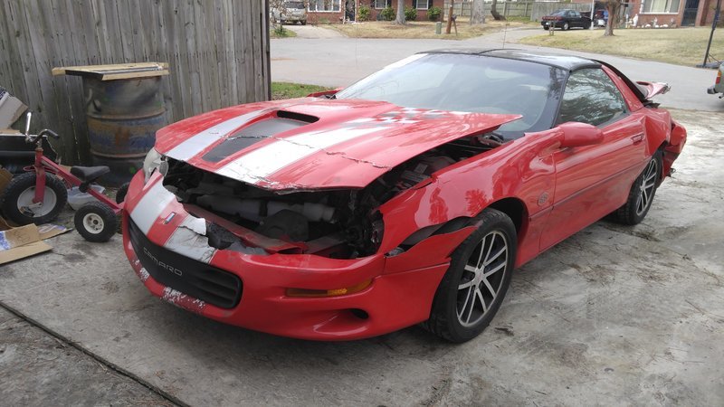

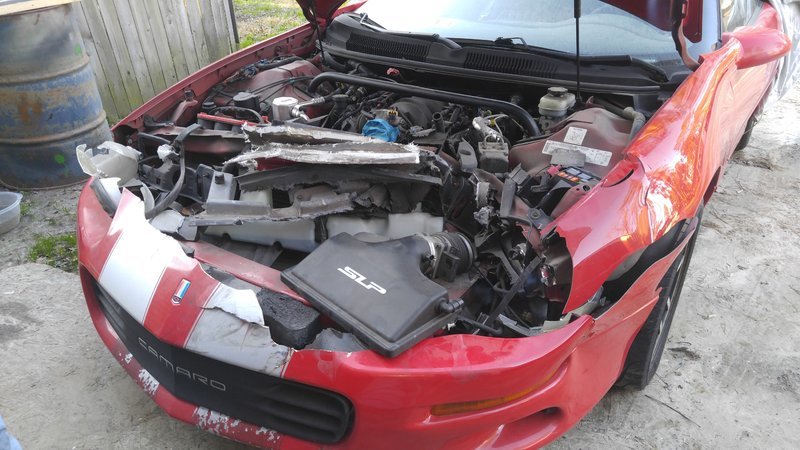

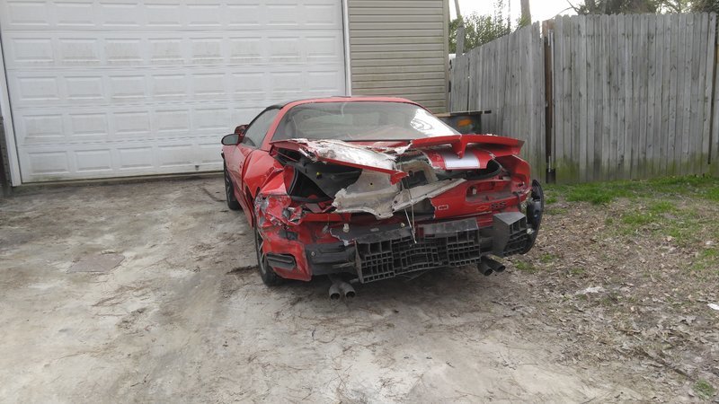

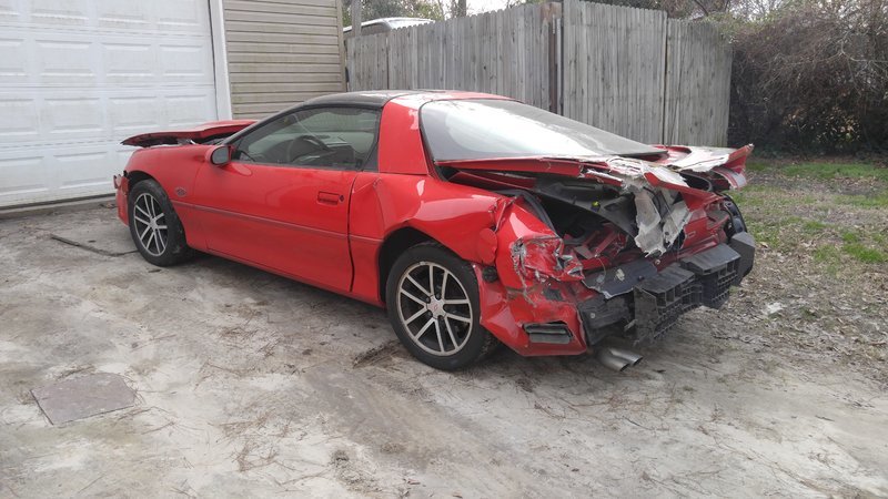

    Here's a pic dump on the trailer box. We still have to still a few drain holes and paint it, but it's almost done. It even has a hood shock from a totalled 35th anniversary Camaro. The Camaro belonged to a buddy of ours. He was the 4th vehicle in a 5 car pileup. He hit the brakes after seeing the first three wreck, but the box truck behind him did not stop, sending him into the truck in front of him.20170125_095805.jpg 20170201_173034.jpg 20170201_212611.jpg 20170202_105449.jpg 20170207_205629.jpg 20170207_213554.jpg
    The Camaro has the LS1 corvette engine, paired to a 700R4 4 speed trans. We bought the car off him for the engine and trans.

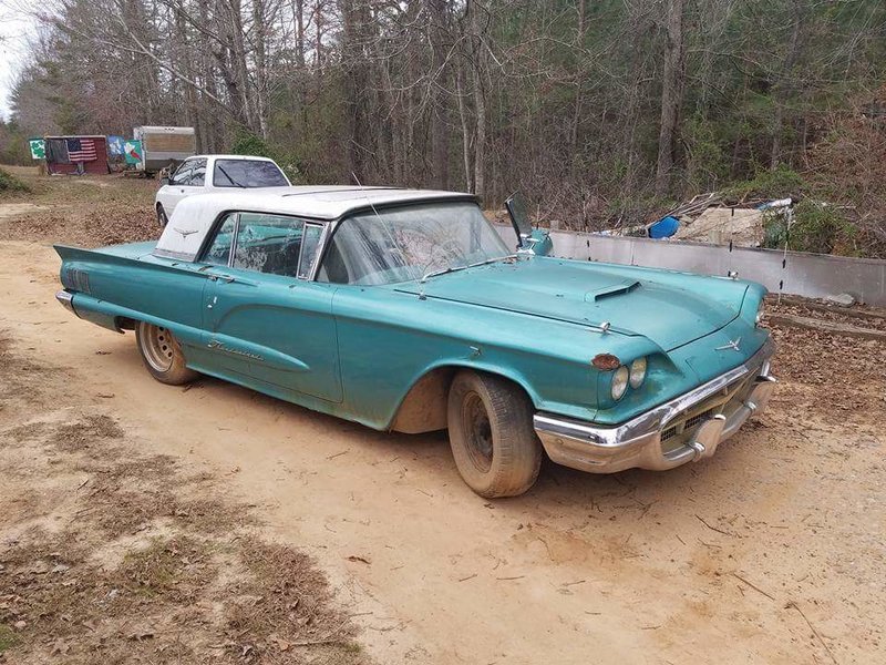

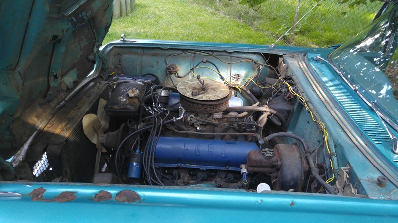

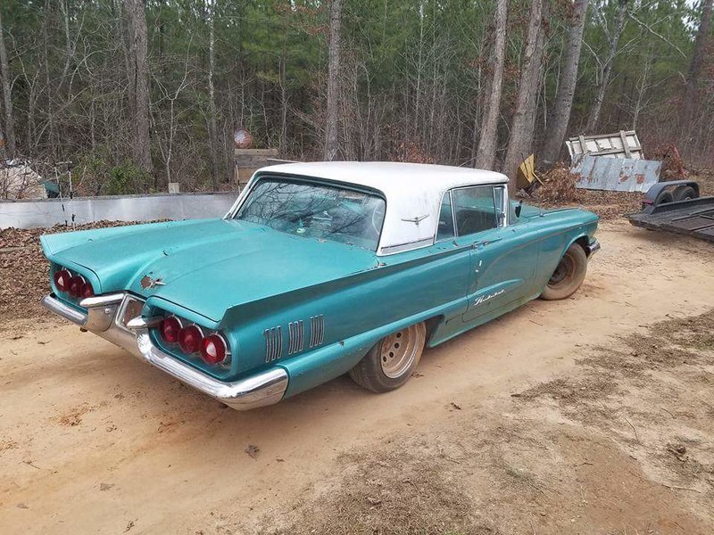

    Got to do an awesome thing today. Some of y'all might remember me and some of my good friends driving a couple hours out to pick up a 1960 Thunderbird. Well today we got it running for the first time in many years. It's got the 352. Drove it around the neighborhood. It shifts into all gears, the generator light came on almost immediately. But we drove it around for a little bit anyways. It died on our return trip at the foot of the driveway. Started it back up with a jump to get it rest of the way.
    Awesome!!

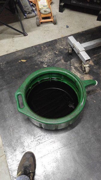

    When a customer says their boyfriend has been checking the oil in their Durango (4.7l) but you only get out a quart when there should be six20170522_231410.jpg
    The 60 Thunderbird we got running last week. It has the 352. Even has power windows!
