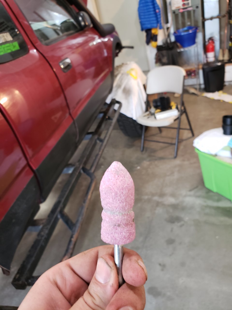

    Going to try and install mine tomorrow. I like the Wotefusi one more than the more ARB looking one. Seems sturdier to me based on the hole location for hitting branches, and I've long since tossed all of my factory intake piping. If I had all that still maybe i'd try the other one but whatever.
    I don't have a dremel, what size hole saw should I buy? 3 1/2" and 3 5/8" were both mentioned, but also added to have a dremel. Actually... Maybe I can find my dad's dremel and use that...

    I cut the hole in mine for the other style using a pair of tin snips. I first marked everything, drilled a 3/8” or so hole offcenter and inside the big hole location, used a stepper bit to make it 1”, then started making the finished cut with tin snips. Only snip 1/4-1/2” at a time. It won’t do like paper will and be 4” long, fluid cuts. I had a half round bastard to dress off any whiskers but there wasn’t any.

    I ended up using a 3 1/4" hole saw and a small grinding attachment fit a drill. Had both lying around.

    I used a 3 5/8”
