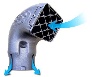

    Has anyone experimented with mounting a different pre- than the one that comes with? The Safari Snorkel has drains built into it to hopefully mitigate the chance of water entering the intake. Something like this?
    http://www.amazon.com/Universal-Rep...sbs_263_1?ie=UTF8&refRID=0VZTPTPRHG2JS5FB979C
    I don't see from the Amazon cheap-o pics that it has the similar drain setup to the actual Safari Snorkel.
    Since the majority of what I'd be doing is warm weather off-roading with a decent amount of dust, these are interesting instead of going with a proper pre-cleaner http://www.amazon.com/Large-Droopie...qid=1439939518&sr=1-4&keywords=safari+snorkel
    And this: http://www.amazon.com/Ram-Head-Cove...bs_263_10?ie=UTF8&refRID=194JZ72RP7M2SPSBGDPW
    Any thoughts? Anybody played around with them?

    Here's from the OP's posts.
    Here's a Safari.
    They both are shaped similar, but the Amazon one doesn't have the holes in it. My understanding is that these hole allow the water to be 'sucked' into the hood with the air. Then the weight of the water will keep it momentum and hit the back of the hood and run out the holes. Something of that nature, but not exactly. The powdery snow would just get sucked in like dust would. Then it accumulate in the tubing somewhere and warm up from the engine heat turning to water. Then that'd cause an issues in the airbox and intake.
    At least that's what I take on the matter.

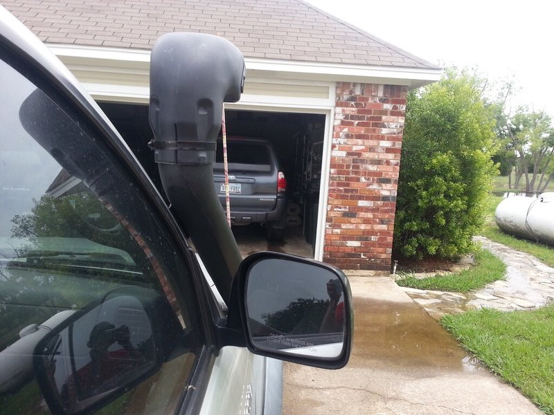

    Got mine installed today. Pretty straightforward install really.
    My solution to the shitty tube. Left the factory intake tube on after cutting a bit of it off, and then I unbolted the 90* piece going into the airbox so it could be rotated. I only needed a very short piece of the rubber tube to connect the two. As is it's probably not water tight, but it is dust tight, which is what I wanted the snorkel for anyways.
    m3bassman and Fernando like this.

    Nice work! That was going to be my next plan if the coiled wire didn't work. I wouldn't trust mine to be waterproof either, but I'd say it is more splash proof than before. Not to mention the dust, which is another reason why I did it

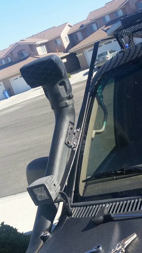

    Anybody fit ditch pods with this snorkel?
  14. Nov 2, 2015 at 6:29 PM
    #114
    RickerRicker19
    RickerRicker19 Dirty 3'
    Oct 16, 2011
    #65283
    169
    Hillsdale, MI
    98 4runner 3rz 5spd
    Snorkel CB Anytime Locker 2" suspension 235/85 tires 2nd Gen 4runner Tire Carrier Custom full length roof rack Sound Proofing Various LED lighting Tundra Brakes LCE Header Diff Breather mods 1st Gen 4runner Roll Bar w/ removable cargo shelf Mostalined body Ditch Lights
    Yep and I used it to secure the snorkel better too 96f73c6ba3e36f401883c5aff9a9f8ea_64273319e3f81ca82f9bee468ed4213cc4fc05fa.jpg
