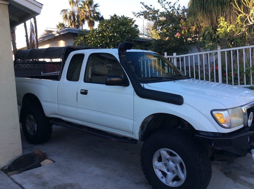

    FYI - Ordering through Amazon brought this to my doorstep in 1-1/2 weeks - shipped out of City of Industry, CA
    12/18/16 - got the snorkel installed.
    Install went pretty smoothly. Should have invested in a new hole saw. Followed the instructions of the OP, I am pleased. Now, I need to see if there is any need to reinforce the rubber connector hosing, re collapsing. I'm not prone to heavy throttle, high RPM driving...

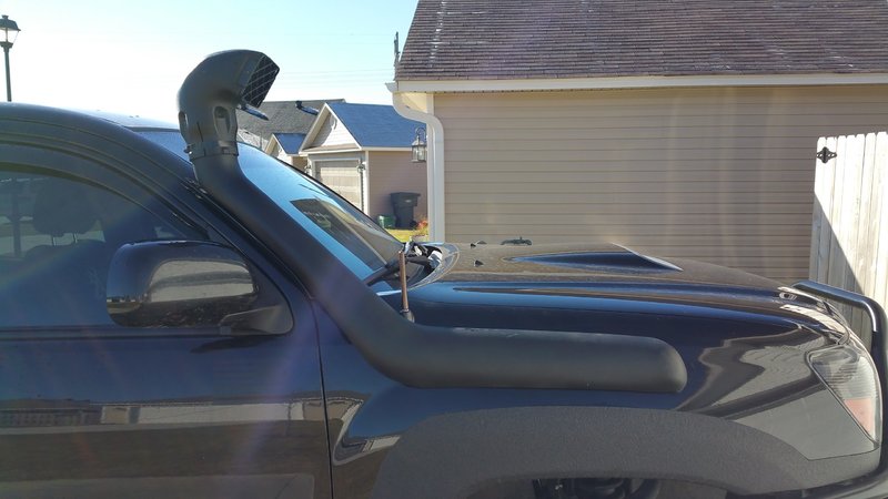

    Don't think i've posted in here. Here's my 1st gen and my buddies 2nd gen twin. Both rocking 167's.
    [​IMG]DSC03717 by Joshua Shipps, on Flickr
