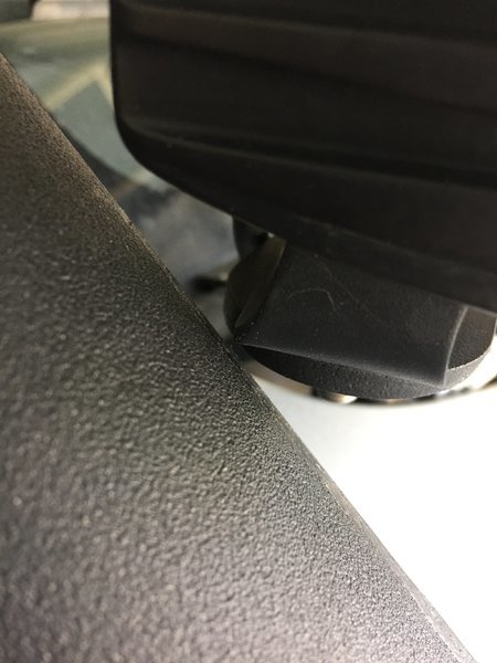

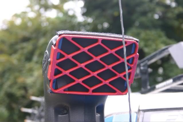

    Probably should have gone with the model 821 or 858 as the outlet is larger. But I didn't want a huge ole mushroom - I like the scale of the 1249 in relation to the truck.
    Ultimately, I found a small section of some PVC pipe (recycled purple - not that that matters) that fit snugly into the 2" opening on the adapter. Cut it down to 1" tall and now there is a 'backing' for tightening the prefilter to the pipe adapter.

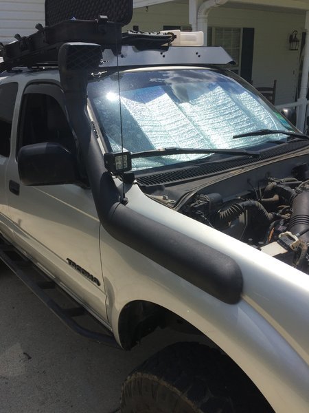

    looks good man, did you have to put washers on ditch light bracket? what did you do about the closing problem, put chicken wire in it?

    Just one on each bolt for the passenger side.
    Just some copper wire that I spun into a spiral. I meant to snag pics but was too busy getting it on

    I had to move my ditch bracket and I couldn't get the fender off enough so I said fuck it, took off my hood. I also needed to install my hood struts so that also helped with the taking of the hood off. Just haven't had enough room on my phone to get a pic :anonymous:
