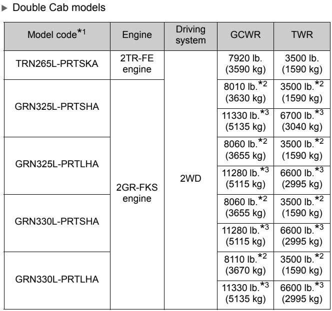

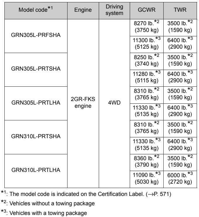

    The only thing that affects towing capacity is curb weight. So, 4x2 ACs have the highest. 4x4 DCLBs have the lowest.

    In regards to transmissions, towing is typically restricted by cooling (AT) and clutch force and robustness (MT). In the case of the Tacoma, neither are the bottleneck so towing values are similar. This isn't always the case because heavy towing is brutal to the clutch in a take-off situation and people don't always want to deal with the stiffer or longer clutch that comes with beefing it up.

    In your list, GRN305L-PRFSHA and GRN305L-PRTSHA are both the DCSB 4x4 SR5 with the only difference being MT and AT, respectively. Both have the same rated tow capacity which means they both share the same weak link. The only difference is GCVR where the MT is 20 lbs heavier - the same difference in curb weight because the MT config is 20lbs heavier.
    Other towing differences in the chart are related to config (DCLB is heavier, 2wd lighter, ACLB ligher, Limited has more weight from equipment, Pro has softer suspension). Either way, the Tacoma isn't transmission limited like Jeeps frequently are, for example.

    I never said that either gearbox was less capable, just that truck weight was what governed towing capacity as shown above.
