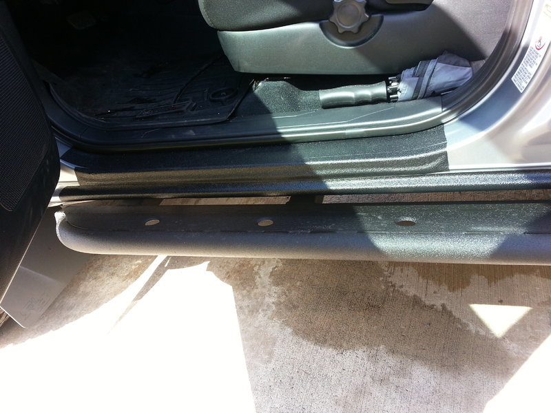

    kept hitting the rocker panel hopping in and out of the truck. Had some non skid leftover from the door sill to lay down over there. Pelfrey-life problems.

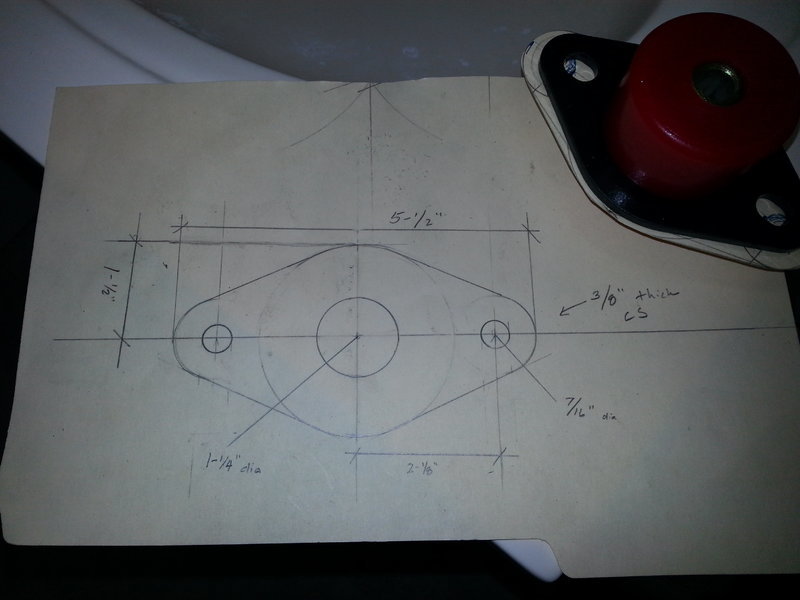

    Ordered energy suspension body mounts. Nothing out for 2016 but figured i would give the 2nd gen kit a try. Unbolted the body and jacked it up. Took out the rear bushing and ... not the same. Distance between bolts is different so going to have new plates made. Took dimensions and put everything back. Damn.20160820_181441.jpg
    Edit: need to move bolt holes in 1/16"-1/8" in. Maybe slot be better.

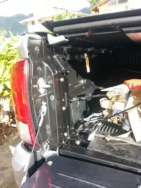

    Got bored and was looking through the project pile and found the bussmann rtmr mount. Found a place for it tucked up and out of the way but still accessible. Supposed to be weatherproof right?

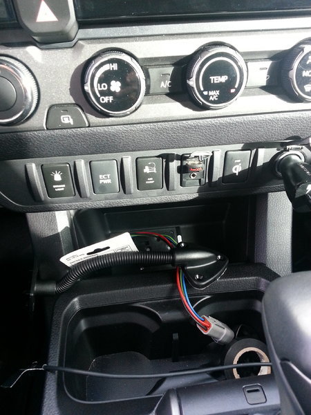

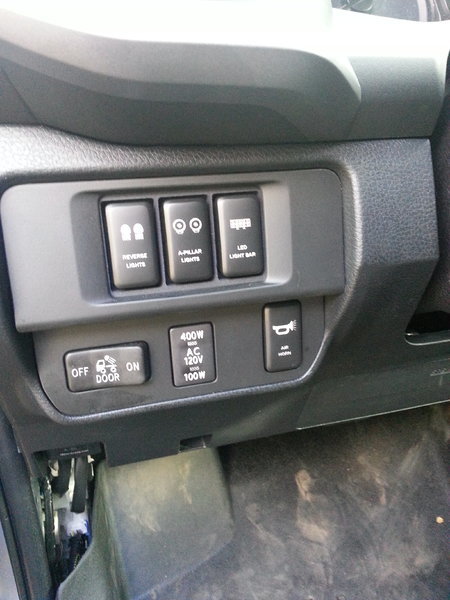

    Knocked some stuff off the list this weekend.
    Cab mount chop courtesy of Hackmans garage.
    Hard wired my dash cam

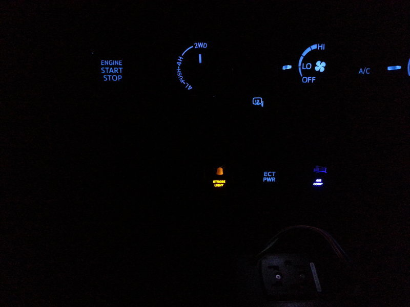

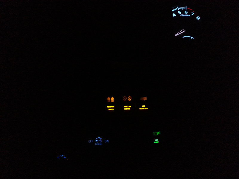

    And installed some switches. They're not hooked up to anything yet but I'm just excited they light up. Tried to set up my puddle lights but after half a day trying to find the right wire i gave up.
    edit: add daytime pics

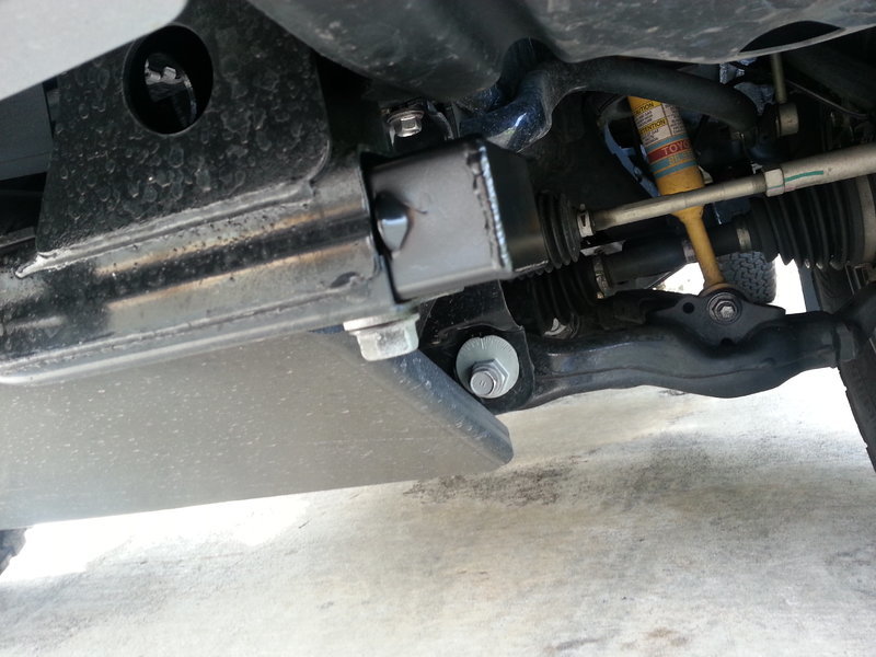

    Since all the cool kids were getting rid of their factory d-rings i got rid of mine.

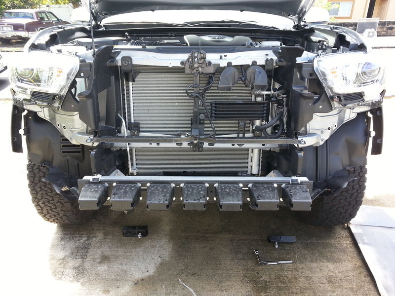

    Swapped out cab mount and rad support bushings. Pain in the ass. This was my second try. When i first tried i found out that the 2nd gen body mount bushings are different. The two bolt holes to the frame are spaced further apart on on the 3rd gens. Had some new brackets made and tried again last night. I measured wrong and i had to bring the bolt holes in about 1/16". Once that was taken care of, everything bolted up pretty easy. Nothing wrong with the original bushings. Went and swapped out the front rad mount ones and and those were actually pretty chewed up. Passenger side was almost cut all the way through and drivers side was creased but not tear.

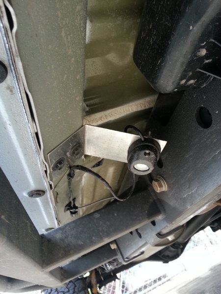

    Practicing my welding.
    Pic of the rock light bracket i made.

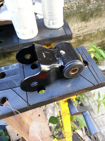

    Today's project. Replace bushings on the shackles. Putting energy poly bushings. Drilled and tapped for zerks fitting. Not sure if it's really needed or if it'll do anything but it's been an idea in the back of my head for a while.
