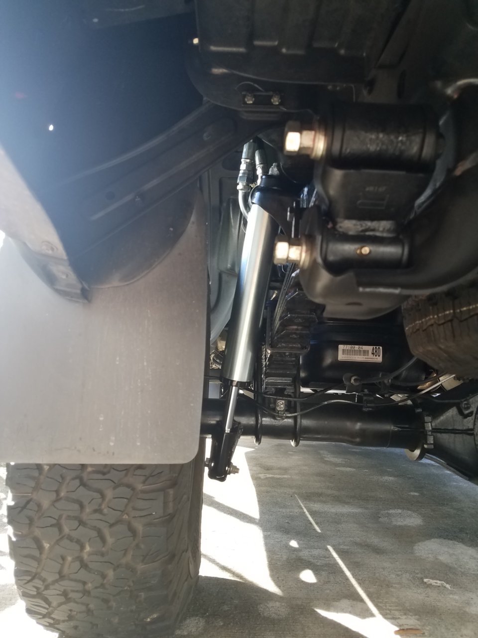

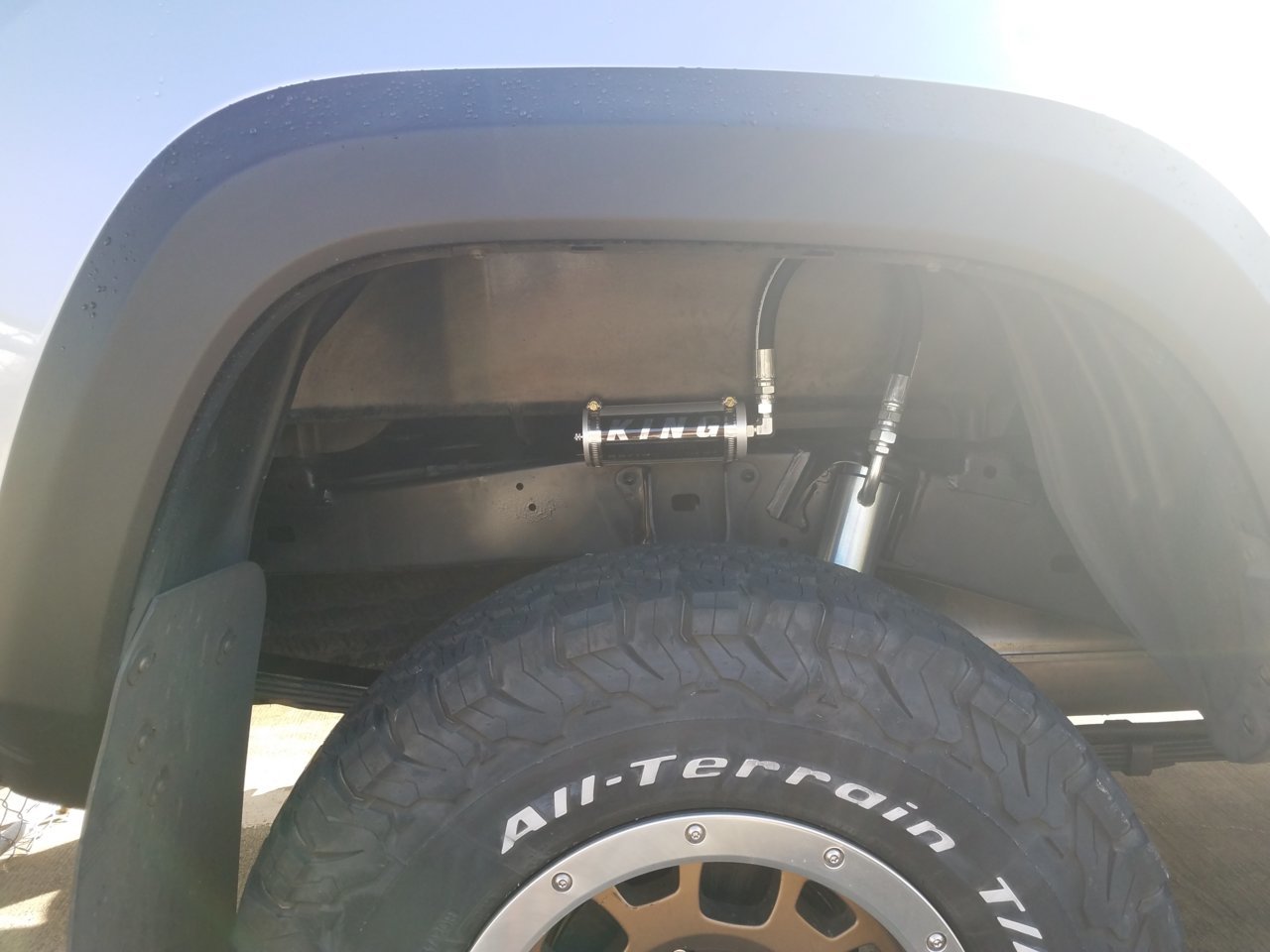

    16 double cab short bed OR
    had the factory over loads in before this. i took them out because i wanted to get less rake. i knew the drivers side lean was bad so i added a 3/8" spacer on the driver's side. still have 1" difference between the drivers side and pass side. going to try a 1" block on driver's side. and i guess ill need new u bolts.

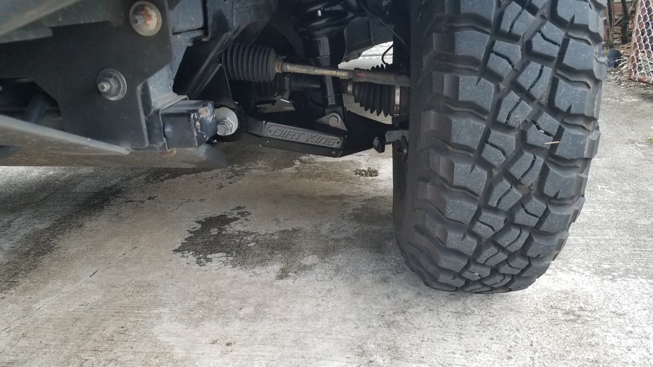

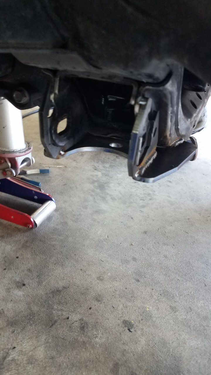

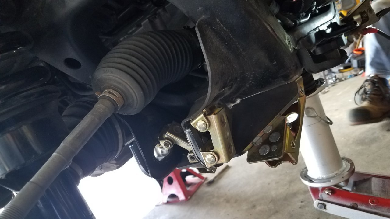

    this past weekend's project in deeezys chop shop. limit straps and bumper reinforcement.

    yup. slowly. gotta fab a new bumper brace. new lights coming in soon ... nothing fancy, just the tabs were breaking so ocd is bugging me. @RedLantern get in touch with @deeezy when you ready for cmc. he welds nicer than me.

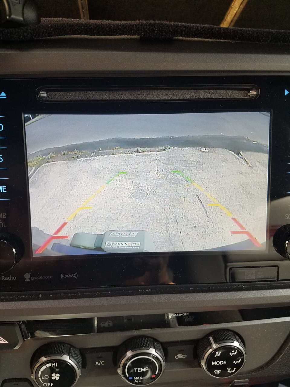

    more cameras ...
