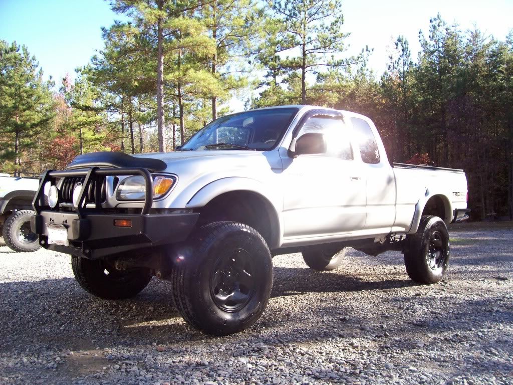

    truck001_92564a92cff4453780a4ab0530f13b2cad19fd29.jpg truck001_92564a92cff4453780a4ab0530f13b2cad19fd29.jpg

    Is that an ARB?
