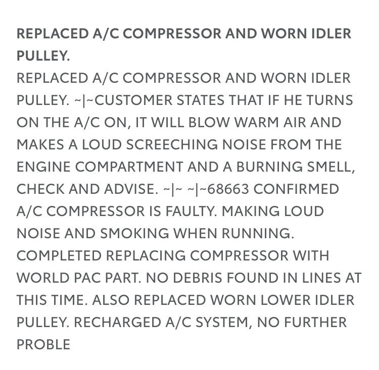

    Not sure but I logged into my owners account & pulled the paperwork. Hope this helps - not entirely sure about the clutch p/n or whatever because they did that for free & stayed monetary close to my quote, but here’s some screen shots.
