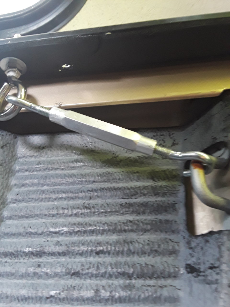

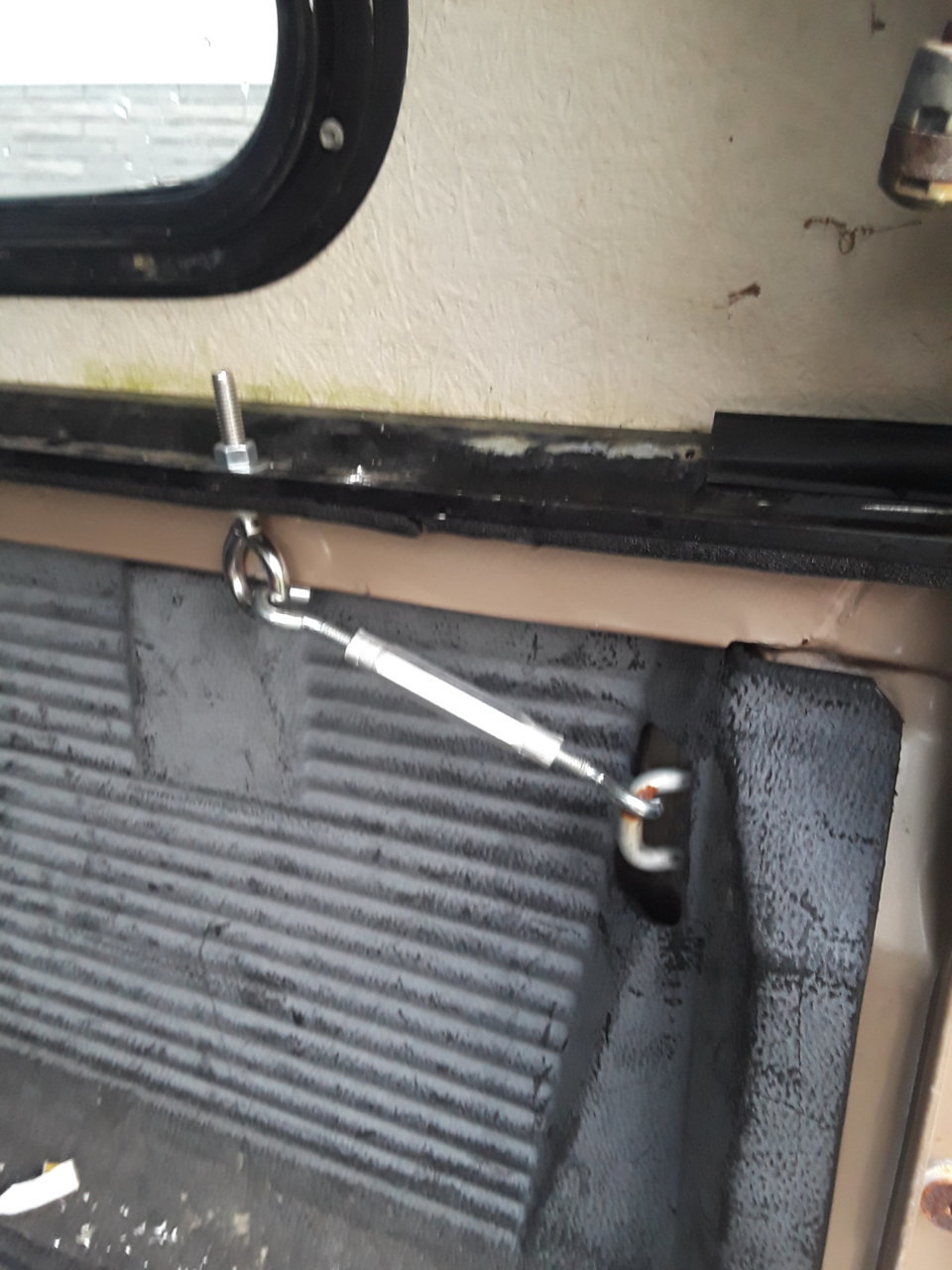

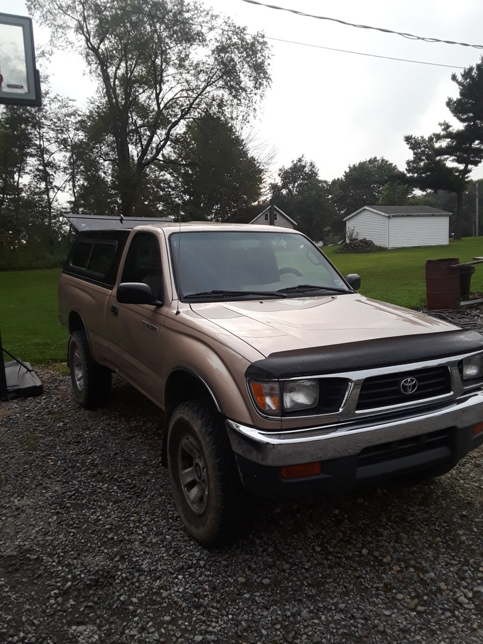

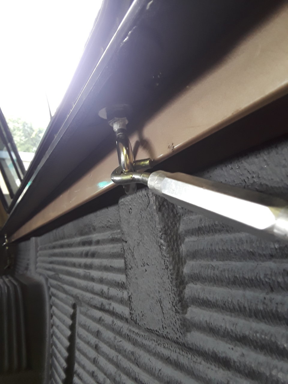

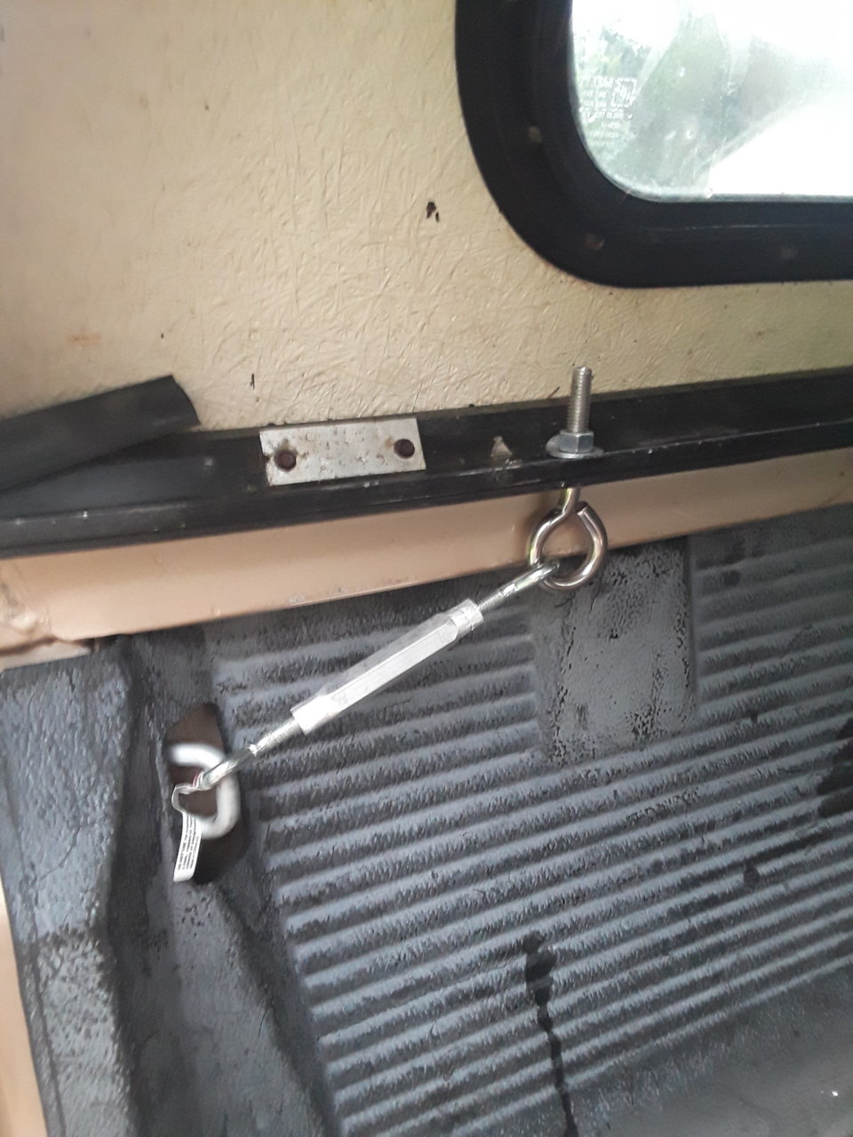

    Camper shell is on. I had the usual problem with the traditional clamps. The inner rail of the cap was mug deeper than the bed rail. So I devised my own system. These eye bolts and turnbuckles are in each of the four corners. I am going to reinforce the cap rail since it is pulled down slightly. Thoughts on this system?

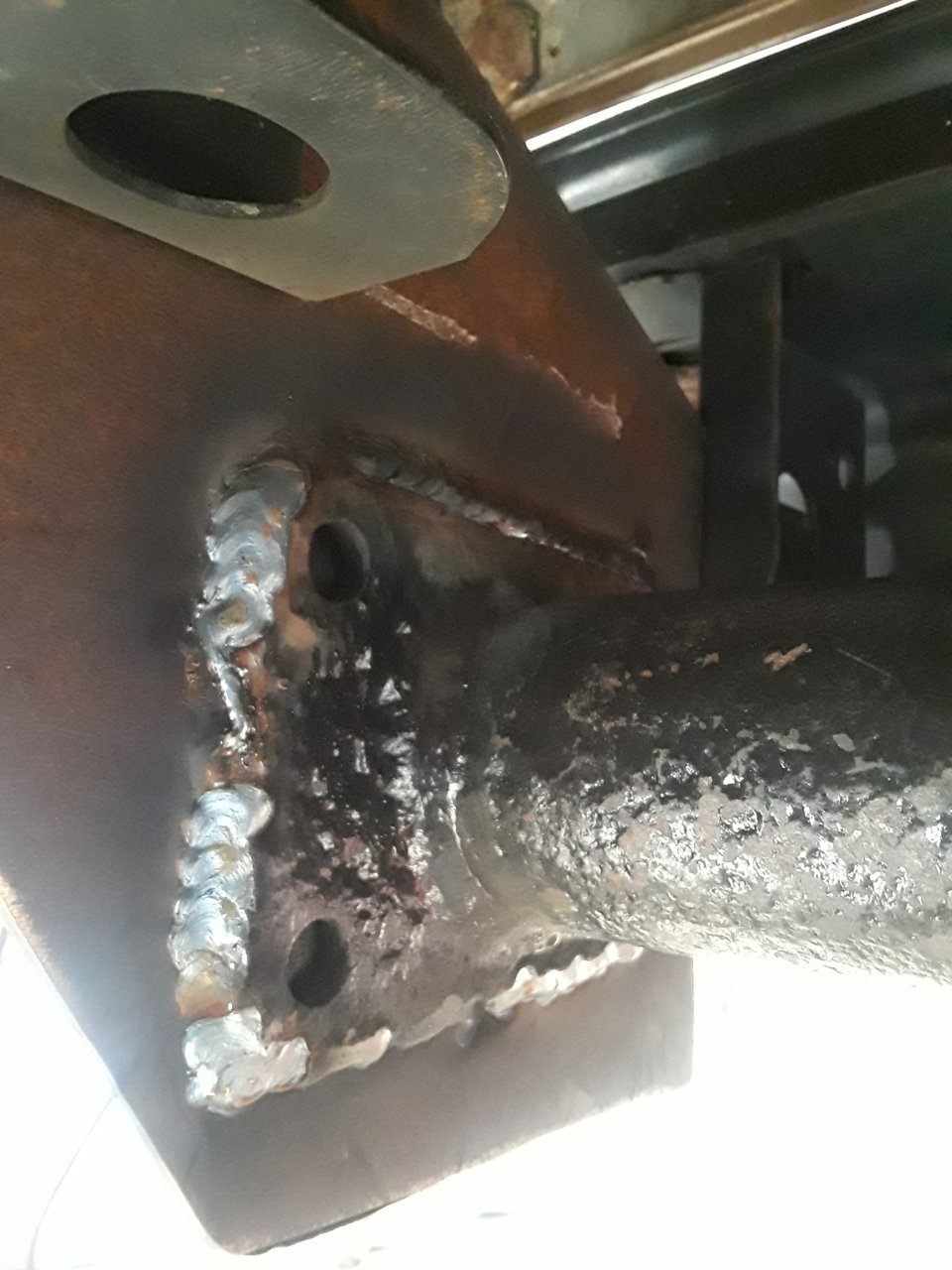

    Next...hitch install. Every plan starts with a piece of cardboard and a marker. Since the hitch I was given didn't have the frame plates, I decided to make my own. A few templates later I had this shape and transformed it into 3/16" steel. The plates are sandwiched between the frame and bumper brackets, welded to the brackets and attaches with the bumper bolts. Next I need to do some trimming and paint everything. I'll snap more pics later.

    not sure how well that system will hold your shell down, need the turn buckles to be more vertical

    I was thinking of that but it would require a substantially smaller turnbuckle. I couldn't find shorter ones without going smaller in thread diameter.

    Keep an eye on those eyes. I snapped one of the other day carrying a table saw

    Interesting camper shell mounting system. I’ve never seen that before.
    I ran the clamps linked above, but when I took it home I ran C clamps. Plenty strong, it even held another bed on when I took one home for my other truck.

    I use these type for mine and they're awesome, don't get in the way of anything

    That's what I'll likely go with in the end but for now to test drive and see how this is going to work out, I decided to try to turnbuckles. So far in 200 miles of commuting (all highway) it has not moved.

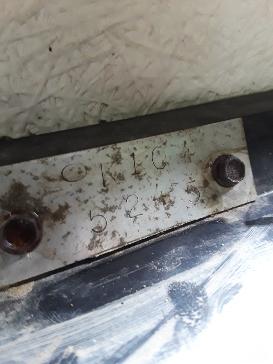

    Craigslist freebee!! I have not seen a manufactures tag on it yet. The lip of the cap extends a full 1.5" inward more than the bed rail. A deeper clamp would engage the bedrail better but would then be clamped onto the wiring chase instead of the flat surface.

    Hunting season is fast approaching so I'm test fitting and getting the bugs sorted through.

    Here is the overhang I was talking about.

    Another view.

    This is the only tag I can find on the entire cap.

    Hard to tell from your pics, but other then you have one rear latch and mine having two it looks the same as mine which is a leer

    Shouldn't be a problem with the clamps I posted, that's about how mine sits

    It’s defintely not a LEER. The name plates usually explicitly state the MFG. My camper shell says SnugTop in the same place, and most LEER shells I’ve seen say LEER on the back window and LEER on the nameplate.
    There are so many different shell manufacturers I wouldn’t worry.

    All the caps my family ever had were lettered up heavily with the maker. This one is certainly lacking...but it fits the truck, keeps water out of the bed and actually look pretty good.
