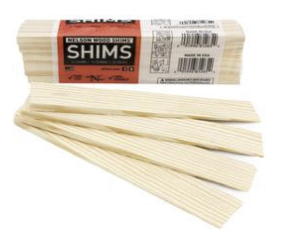

    Cedar shingle. Just drive it in between the receiver and the hitch.
    I use to drive them in a barge that that sprang a leak. They would swell up and stop or slow down the leak until the barge was off loaded then sent to dry dock to have a steel plate welded over the crack.
