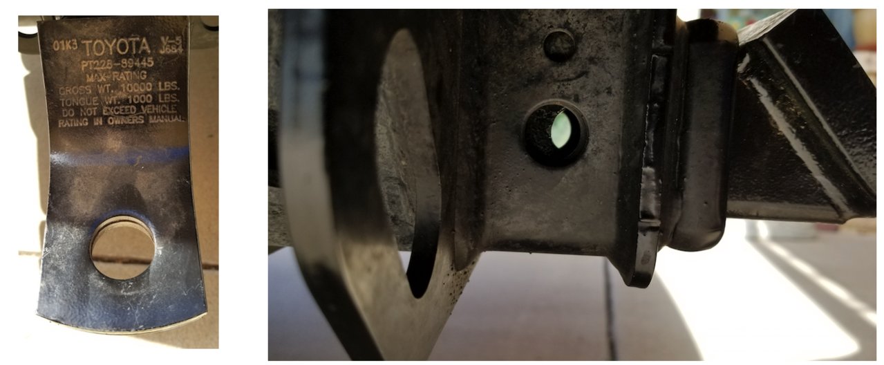

    I got this ball mount and I put it in the hitch. The hole doesn't line up. Is it ok to drill it out or is that not safe?

    Why does it not line up? Is your hitch bent?

    It doesn't go in far enough to line up. The outside part hits before the hole lines up.

    Getting a ball mount that fits properly would be easiest.
    It would not be easy to drill that out using a hand drill, and as it doesn’t line up, attempting to drill it while left in place would probably cause the outer hole of the hitch to become larger and oddly shaped.

    Can you make some adjustments to the mount with a grinder?

    It took me a minute to get over the optical illusion in the photo, I thought you just had to back out the ball mount a bit, but I see what youre saying now. I wouldnt grind or drill, just go buy a curt ball mount for 20 bucks and be done with it. 20 bucks is way better ( and safer!) than toasting a nice drill bit trying to kludge that one into place.

    Thats a class 3 draw bar in a class 4 receiver. Get the proper draw bar.

    Go buy one that fits and be safe. I'm normally a guy who will hammer to fit and paint to match. On a receiver it's important to have proper fitment. If the pin isn't in there square it could cause a point load which should shear your pin. Imagine pulling a trailer at 70mph and hitting a bump and all of a sudden you're not pulling a trailer anymore.

    As @daddy_o said, get the proper hitch. You certainly can't enlarge the current hole as this will give you an oval hole that will allow movement and eventually shear the pin.

    I thought it would not be smart to drill it... sometimes you need to be told "don't be a dope!"
