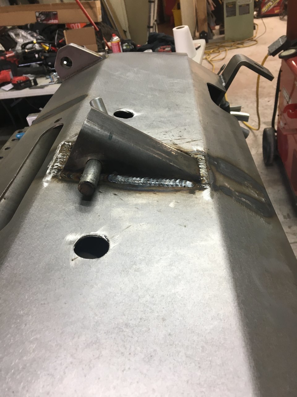

    Now to level out the hoop on the SSO Slimline Hybrid bumper, the bumper arrived with the hoop a little less than 1/4" lower on one side than the other....Grrrrr.
    Factory weld on the hoop. I'll cut this weld out, remove some material and then we will re-weld the hoop so it's level like it should be.
    I cut through the weld using both a skinny wheel and my favorite tool a Porta-Band.
    Next up remove some material so the hoop sits lower and level, any nicks will be blended back out before paint.
    With the hoop now level my father is working his magic with the tig torch.
    After the bar is welded back in place my father re-welded the other side to match. Much nicer looking than it started out....and the hoop is now level!
