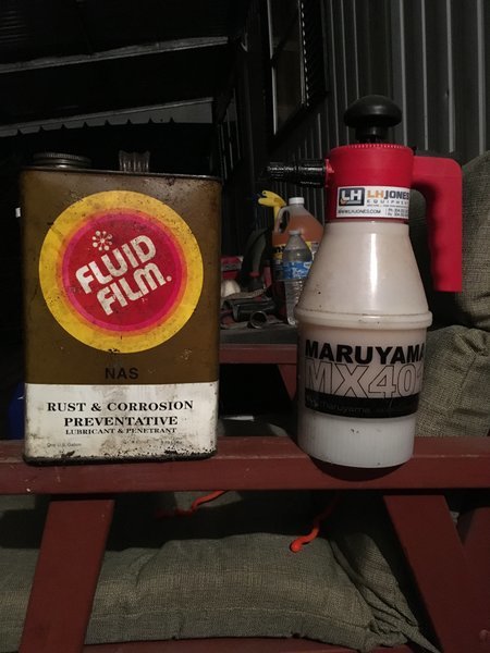

    I would say fluid film on the inside and outside of the frame would be your best bet, check with the locals to see what they do to prevent rust.

    So Im assuming you just apply this yourself?

    I wouldn't even go that crazy with the fluid flim. Do the boxed portion of the frame and get under it and wash it and treat any surface rust you see. Guam isn't that bad, not anywhere as bad as rock salt in the northern winters.
