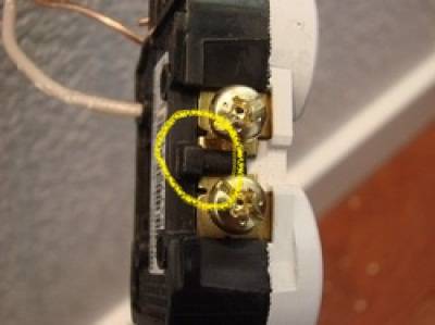

    so you have half of an outlet switched and half constantly hot (half hot)...have you pulled this disposal plug out to look at it? there are two screws each for the hot and neutral side. With a half hot, you want to make sure the tab it cut on the hot side so the two screws are seperate. It's hard to explain but I'll try to find a picture. If that tab isn't cut that, it's another possibility to what's causing that GFI to trip

    this is true. regardless...I would double check that the tab is cut correctly.
    here's an example of the tab that would need to be cut.

    Yea the little tab is broken

    just on the side with brass screws, correct?

    I'm not saying this is the 100% guarenteed solution, but try replacing the under sink receptacle, they're less than $1. the dishwasher would trip the gfi regardless of which outlet it was plugged into if the issue was the gfi receptacle as both outlets under the sink are protected by the same gfi.

    from the info given I would say the under sink receptacle is the issue. my suggestion is that you replace the under sink receptacle (remember to remove the tab between the 2 brass screws).
