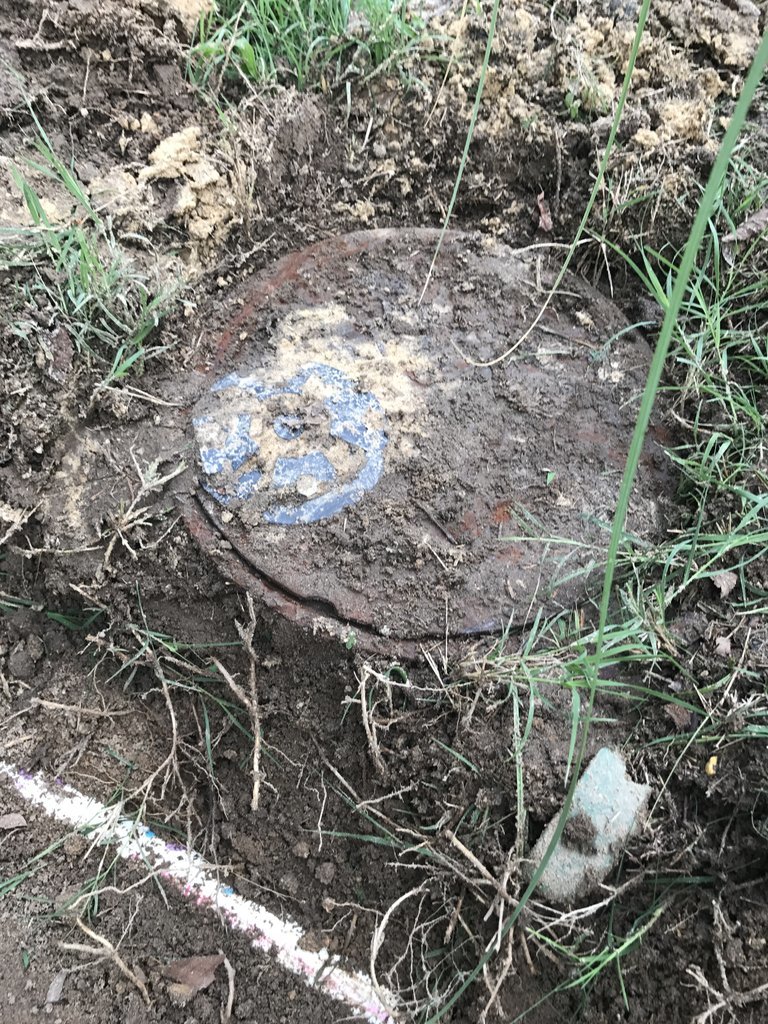

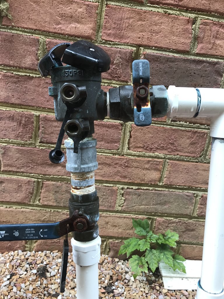

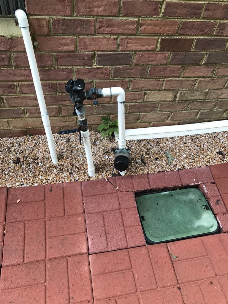

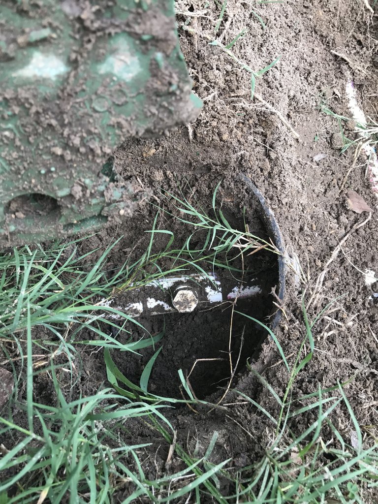

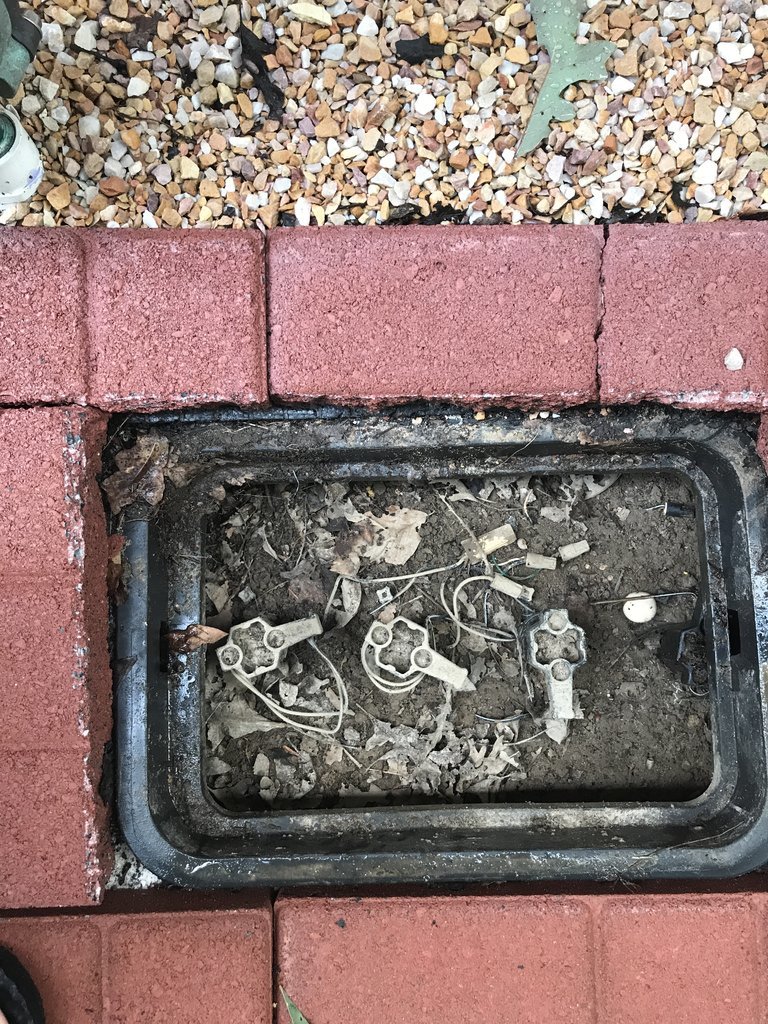

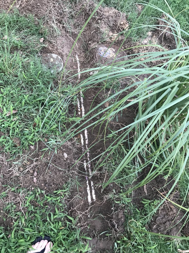

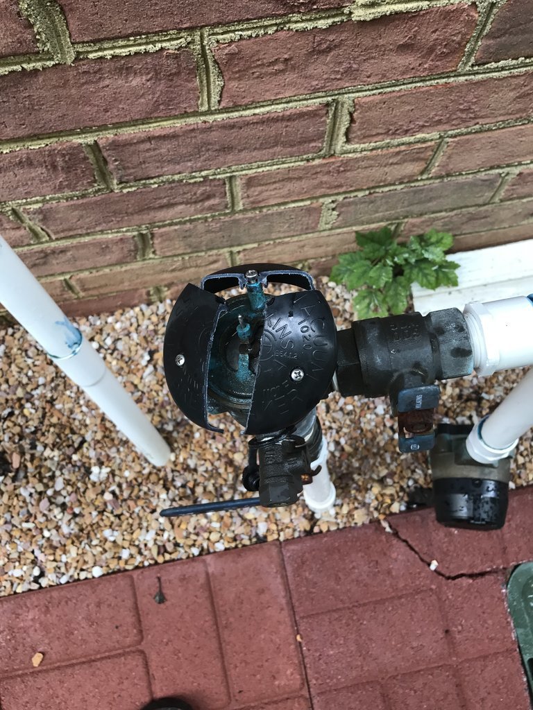

    Bought my house this past December and had to have someone come out today to test my back-flow system on the house and it failed and they quoted me $75 to cap the system or $280 to fix it so i asked them to cap it and when i got home my wife tells me they couldn't cap it because they couldn't find the cutoff valve and said that i needed to dig up the yard till i find the valve and have them come back out to cap it. I have to have this done ASAP but i have no idea where to start and i don't want to just start digging where they were digging and risk cracking the PVC pipe. Where should i be looking for a cut off valve?
    here is what i am dealing with.
    back flow system
    under the green box
    closeup of the back flow valve that is destroyed. (was like this when i purchased the house)

    Looks like a pvb Backflow. We don't use them much here,just rp and dc. What's the pipe coming out of vent? Looks like that's where water valve may be. And you can replace that yourself as a homeowner here but can't test it unless your licensed tester.

    Can you get a rebuild kit?

    Those aren't worth the trouble.

    Well i took the day off and got back at it this morning and found the cut-off valve which was directly below the drain in the front. Luckily i wanted to clean out the box in the front and while i was doing that i saw the pipe turned down and the valve was right there. The guy came back already and shut off the water to the back flow and capped it so now i don't have to worry about it any more.
