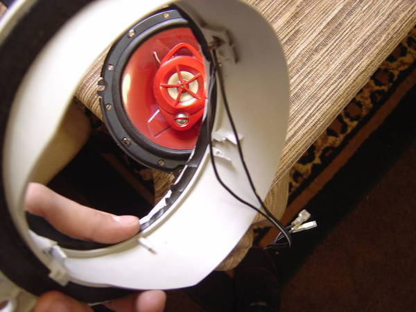

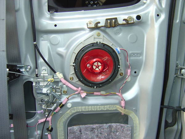

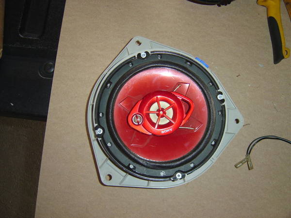

    I decided to be cheap and make my own baffles. Here is a write up of what I did if any one out there tight on money, here is a way to save :D

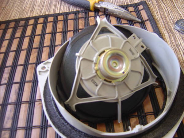

    1st
    take old speaker out and cut it, yes cut it.

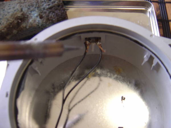

    Then I solder the wires to the old ones.
    Hook up speaker.. I used a sony xplode 6 1/2 and just screwd in onto the plastic
    You can used the old connection

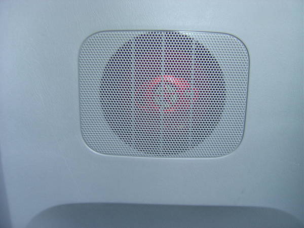

    No problem fitting the door panel back

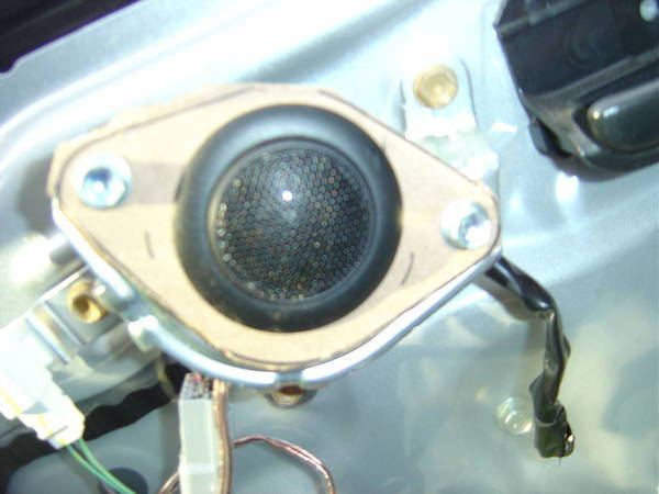

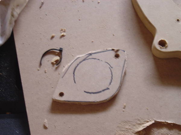

    Had to make my own tweeter baffles... I used some type of cardboard...( dont remember the name )
    Simple, trace and cut.. Not the cleanes cuts but it worked.
    Im happy with results....

    In you pics I saw a wood baffle, did you make that one as well?

    yup..i resused the stock tweeter to mount my front tweeter to. looked a little ghetto, but once the door cover was back on, couldn't tell.
