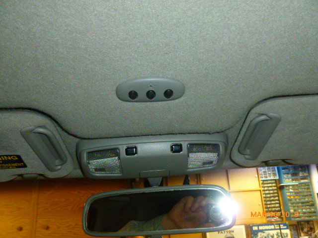

    Just ordered, I was going to install in the visor but that location looks great!

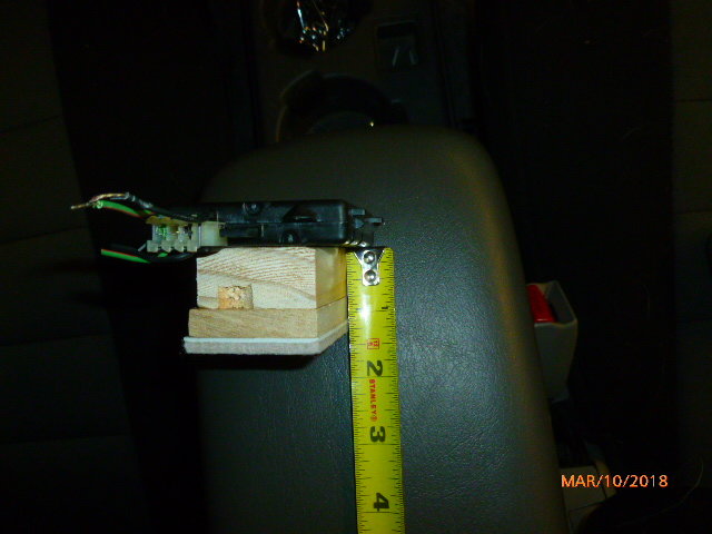

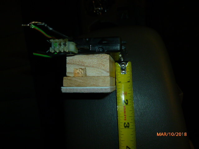

    I found the same thing. Great mod by the way, thanks for posting. I picked up one of the $20 gray Homelinks from FleaBay. I ran power from my passenger side kick panel and up the side pillar to roof. I also ended up using a couple wood blocks and some thick 3M foam tape to secure the assembly to the cab roof. There is quite a bit of wiggle room up under that roof liner and the transmitter needs a firm backstop for the buttons to work right and not rattle on rough roads. Some pics attached. The gray bezel matches up nicely.

    I used a screwdriver to pry apart carefully. On each end is a nylon stud that is kind of diamond shaped in the middle to anchor the bezel to the transmitter. It is meant to pry off/push on.
    One other thing worth mentioning: I did have to trim the backside of my headliner as another poster mentioned. The tolerance between bezel and transmitter is pretty narrow. I did the trimming from below with an exacto knife held at an angle. The bezel snapped on nice and tight after that.
