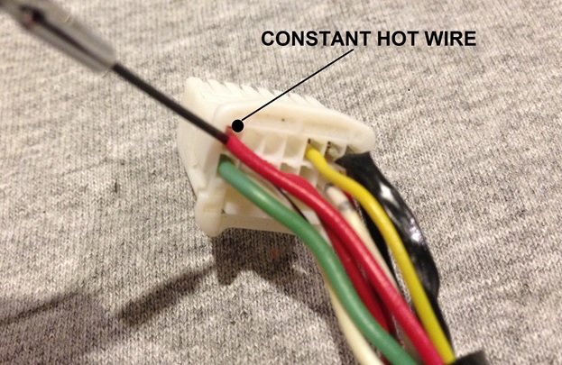

    I'm not sure where it goes, but the red wire on the plug is the constant hot.
    (Credit goes to Bob's Automotive Mirrors and More, LLC for the picture.)
